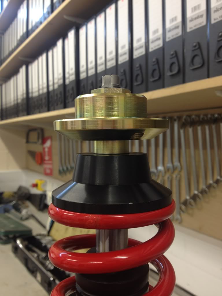

Placed my top mounts on them today tho for a trail fit.
It goes,
Spax collet, pure spacer, pure top mount, put nut which then meets up with the spacer when tight.
Is that the correct order? I think it is:)
