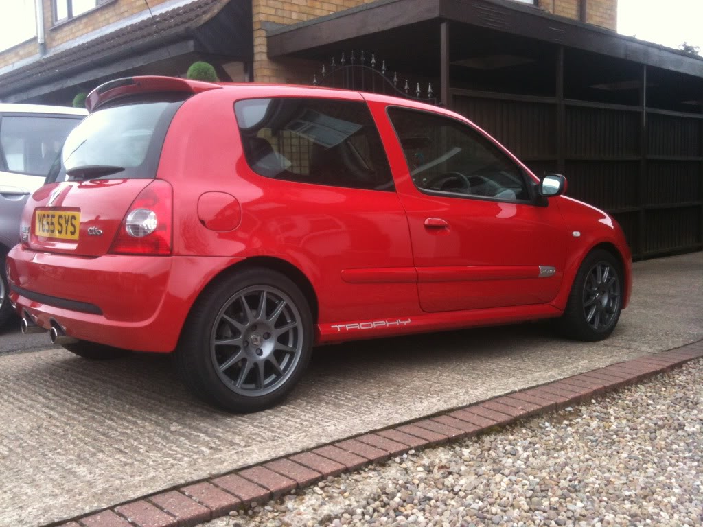

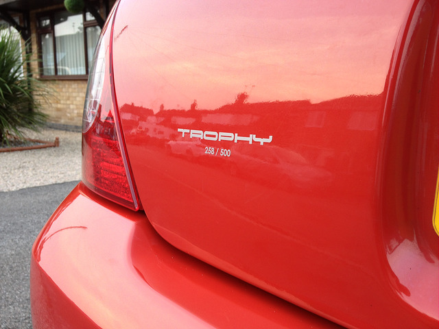

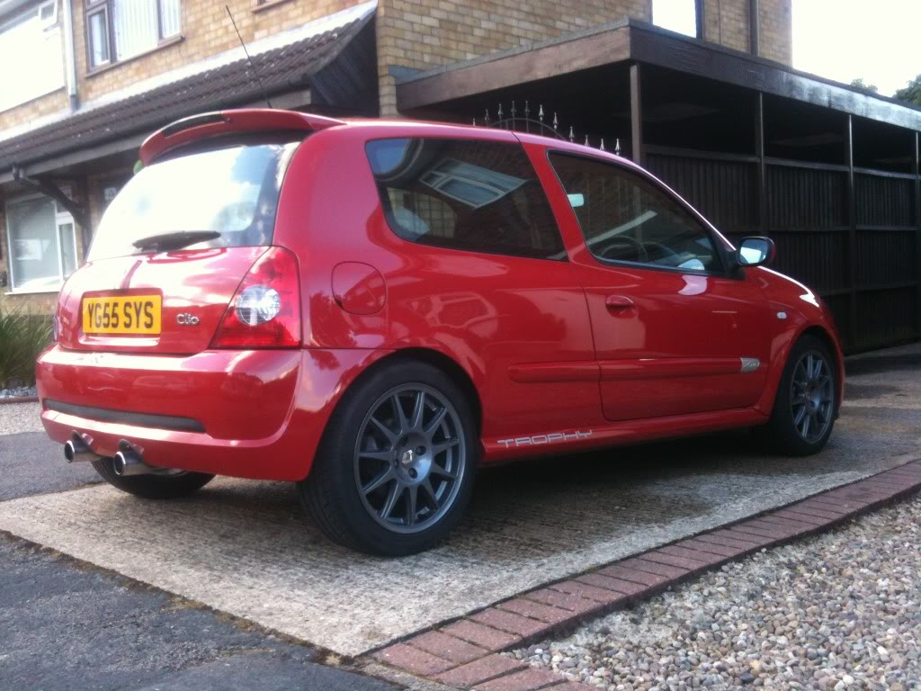

Well ive had my trophy for over a year now so i thought that its about time i started a project thread!
I have previously owned a 1.2 clio, a C2 1.6 GT, an Ibiza 1.9tdi 130 FR, and two FF 182s.
After going from a 182 to the seat, its safe to say that although it was fast and cheap to run, it was nowhere near as fun as a 182, so i quickly decided it was time to get another clio, and then decided that it needed to be a trophy!

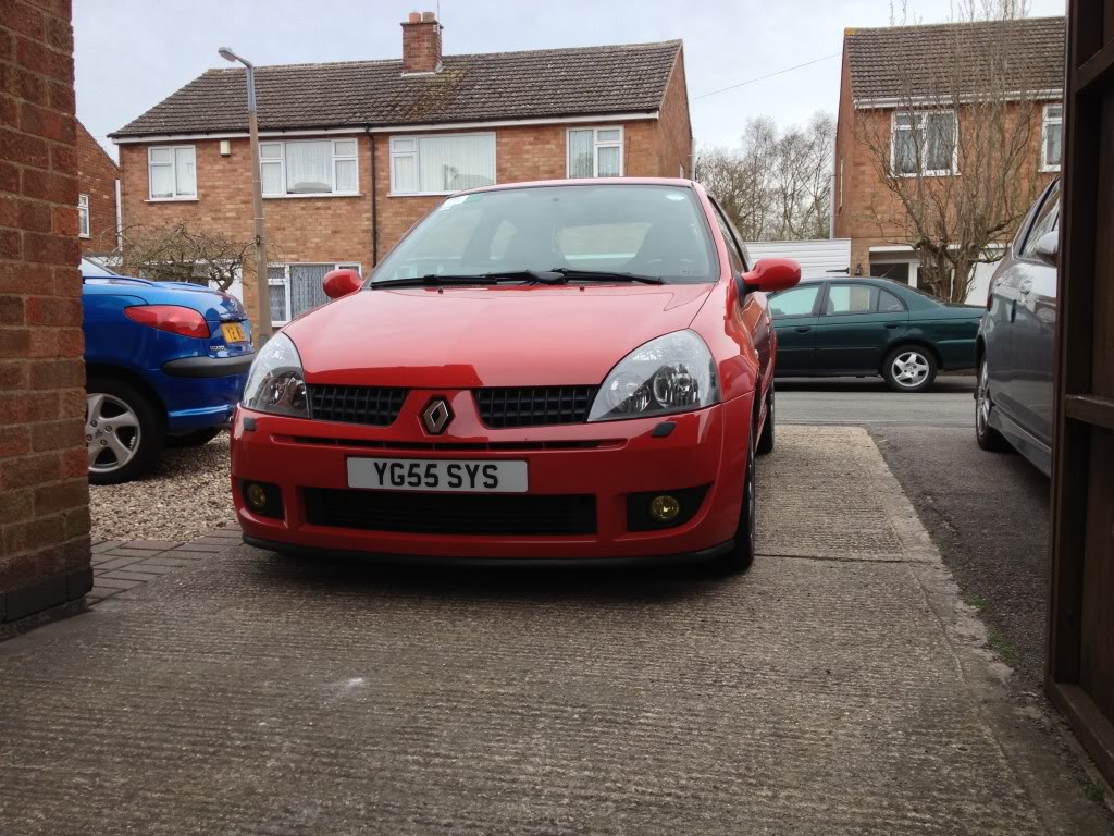

So i then bought trophy #258, with around 39,000 on the clock back in april 2012.

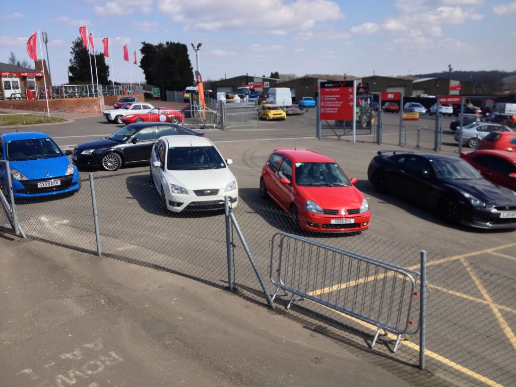

A few photos from the day i bought it (and some of the guys renaultsport and ferrari collection!)

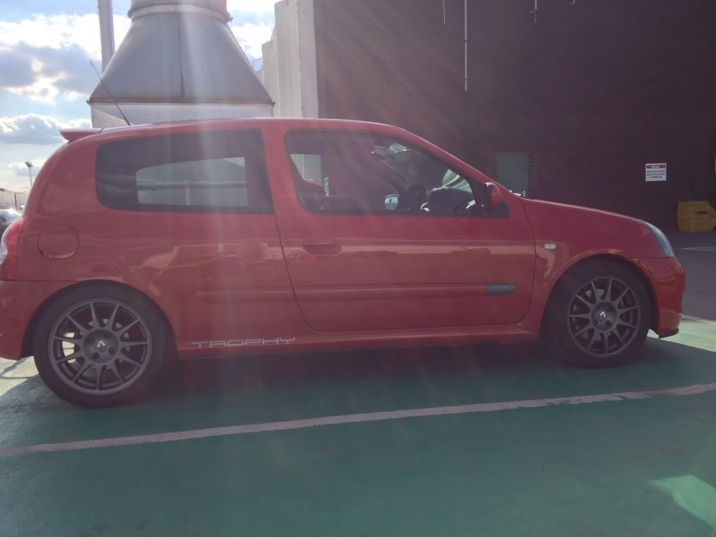

and the trophy..

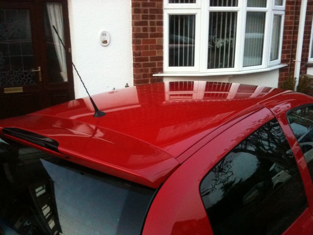

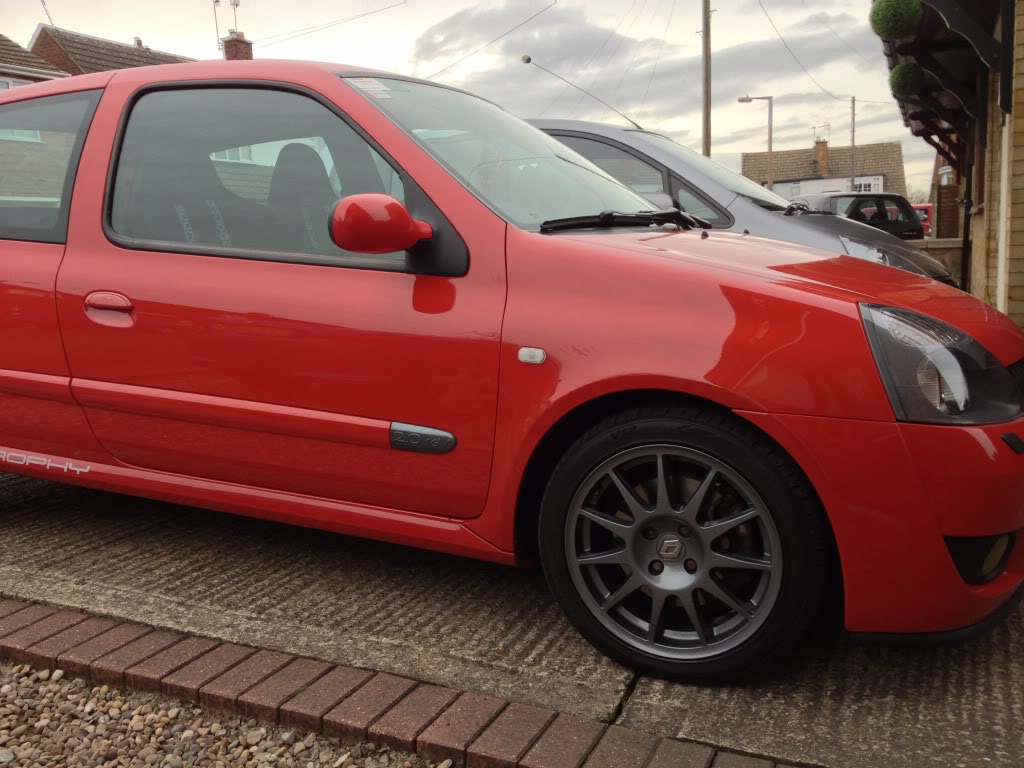

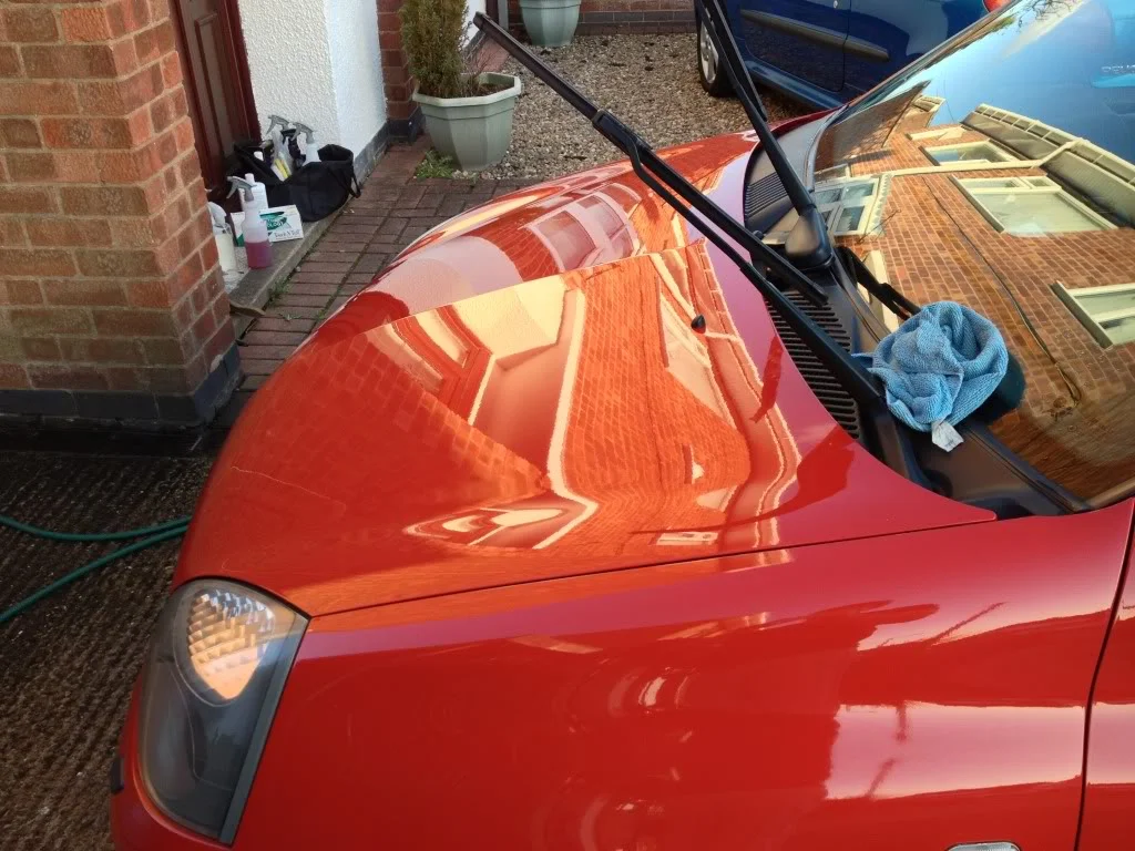

first things first, i gave it a good polish

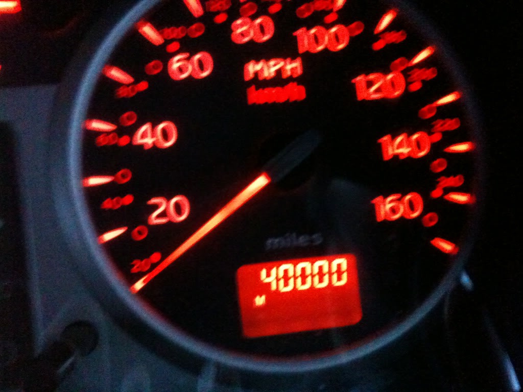

just hit 40k

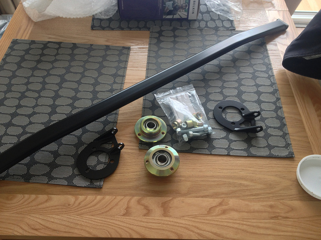

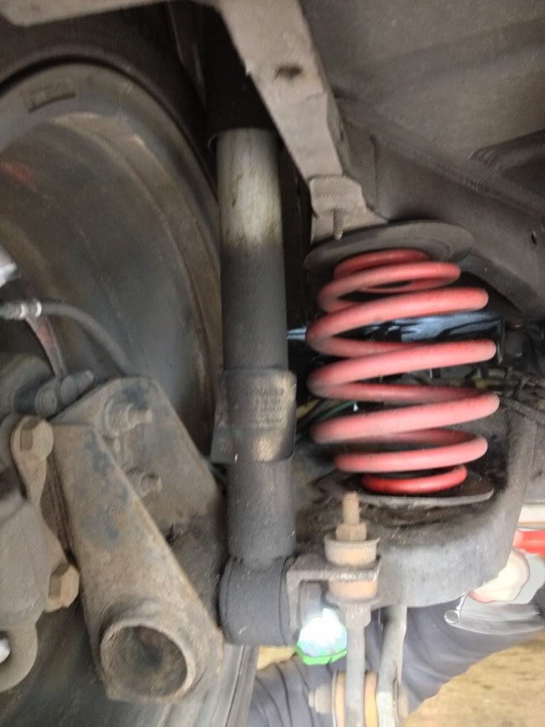

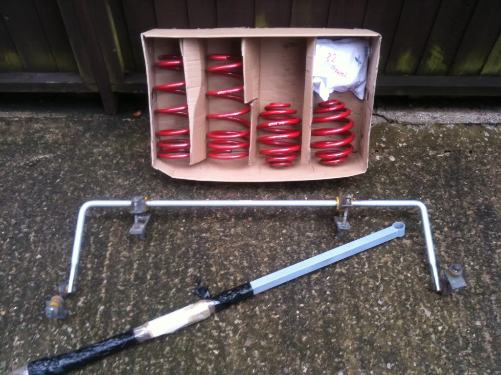

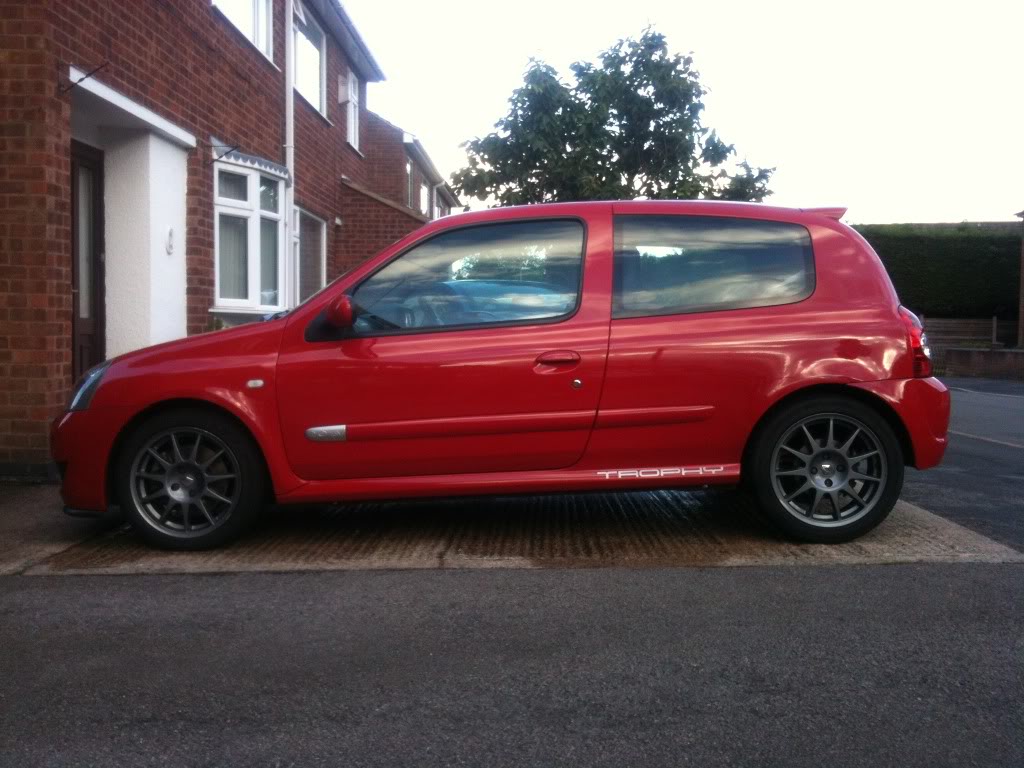

then i decided i wanted a few light mods.. so purchased a rear strut brace, whiteline ARB, and eibach sportlines from some forum members
sportlines and rarb fitted

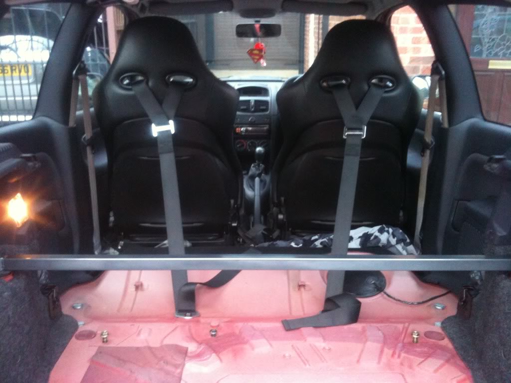

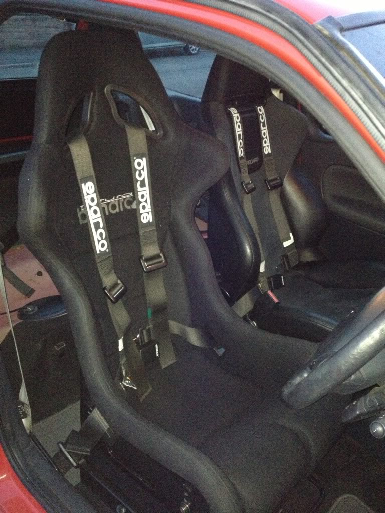

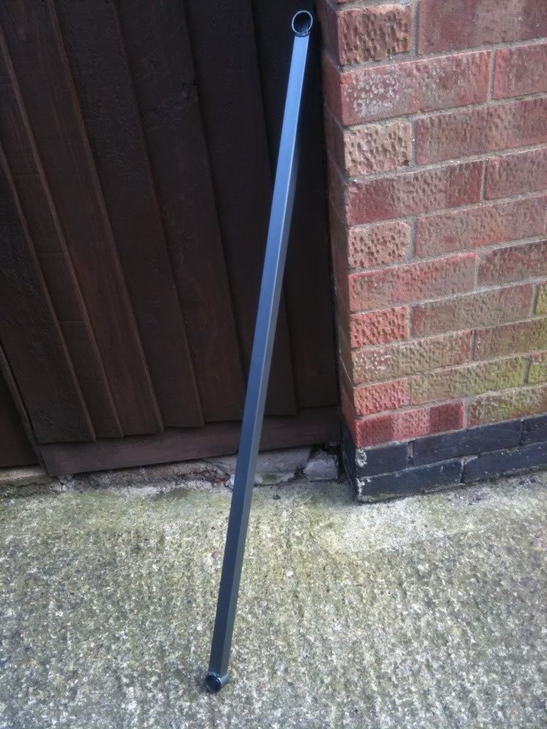

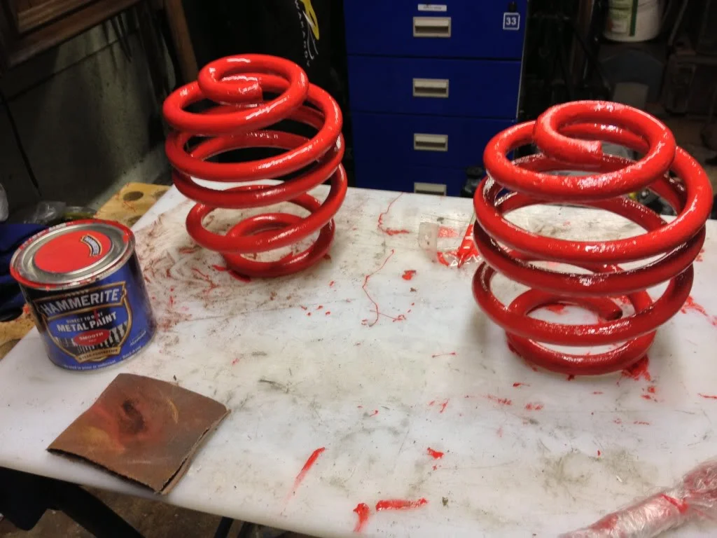

i then painted the strut brace and fitted it, along with some 3 point harnesses than i purchased

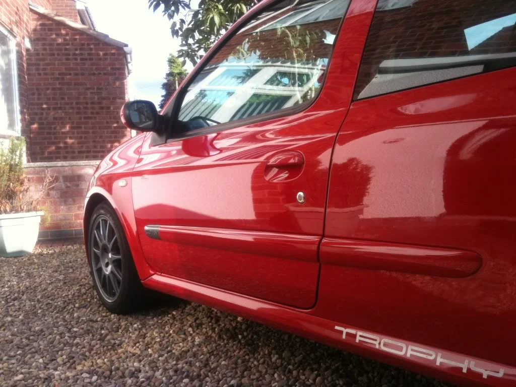

another clean and polish

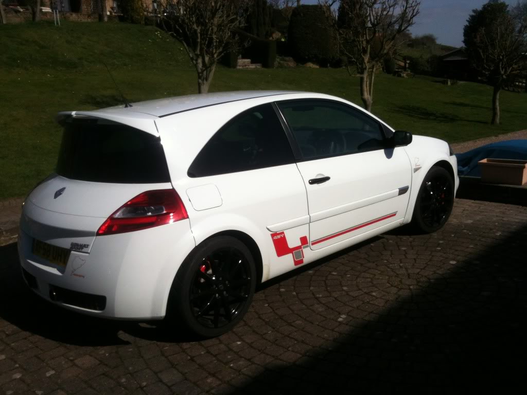

photo with my neighbours RS250

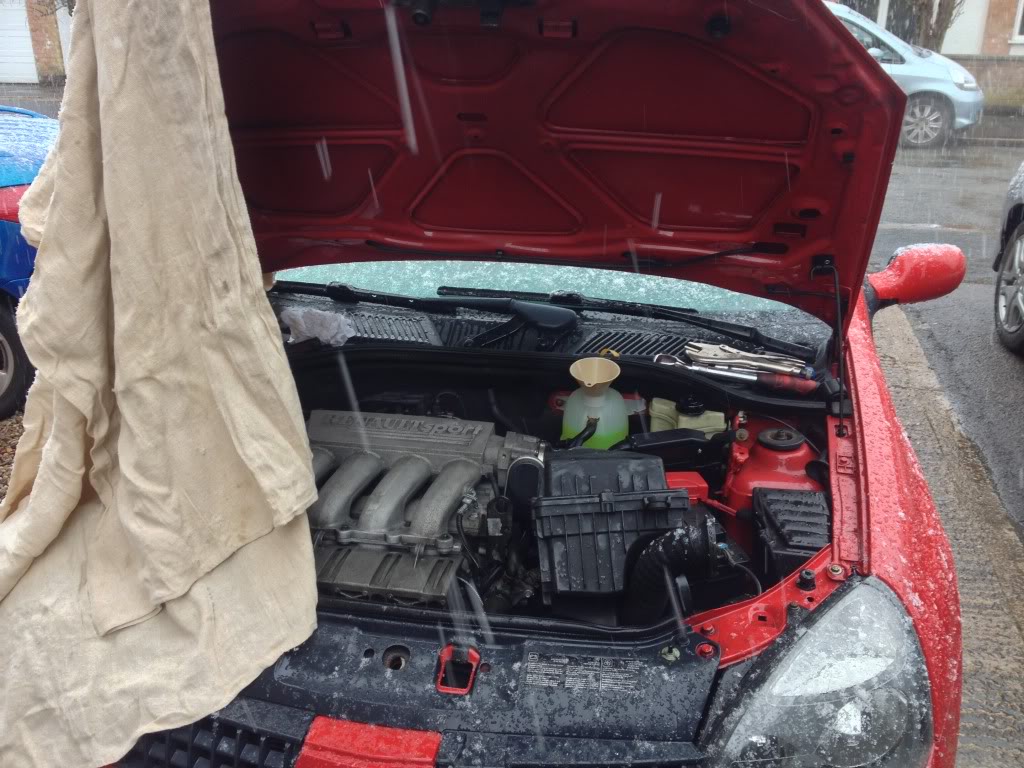

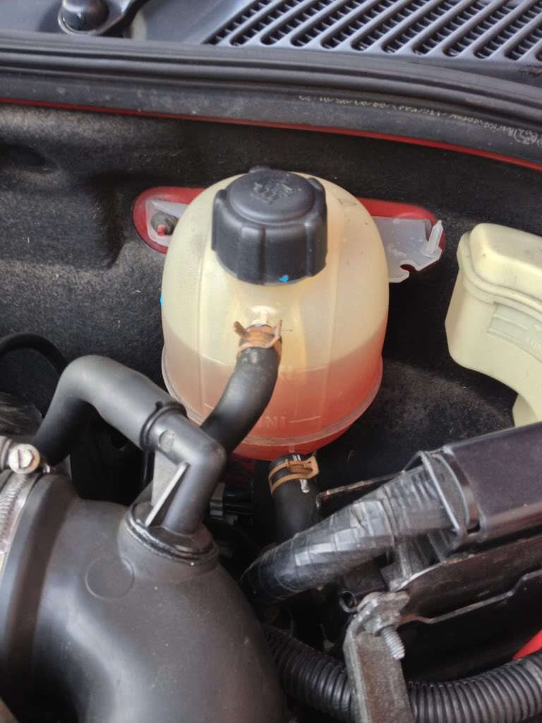

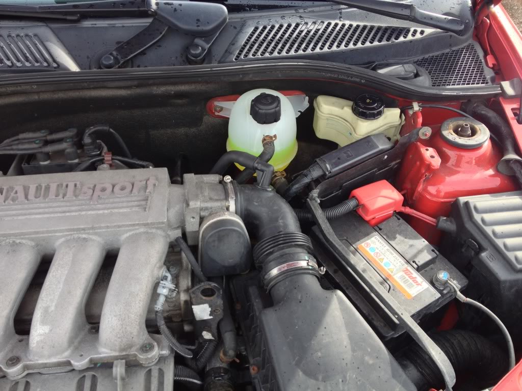

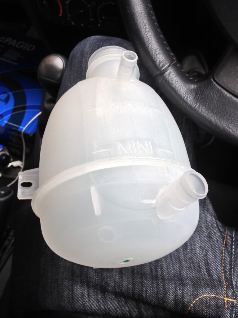

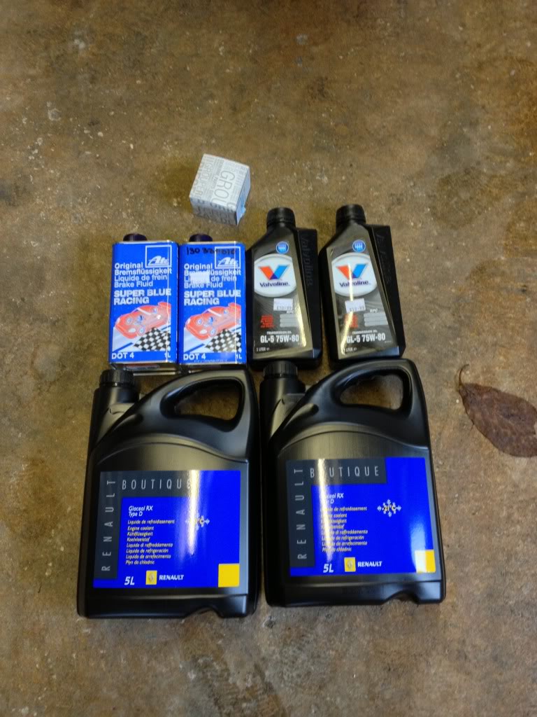

i then decided to give the trophy a full coolant change using renault type D and a genuine renault thermostat, and put on a new expansion bottle while i was doing it as the old one was pretty dirty

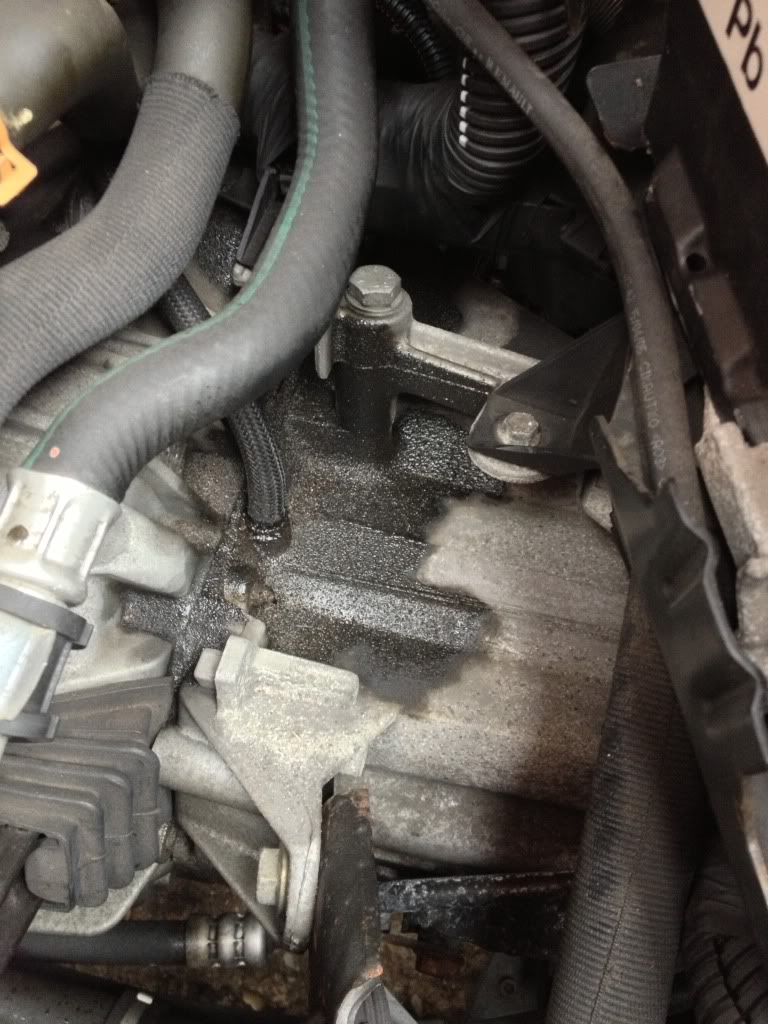

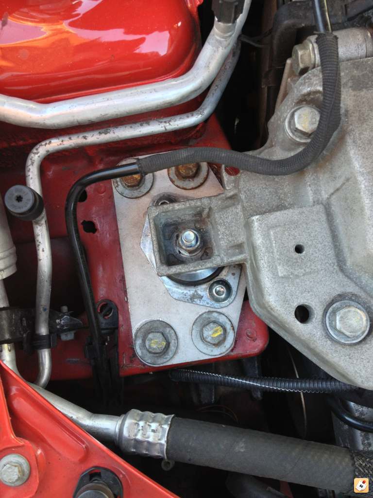

found a slight leak on top of the gearbox, anyone know what that might be?
then it decided to snow..
all finished and looking fresh!

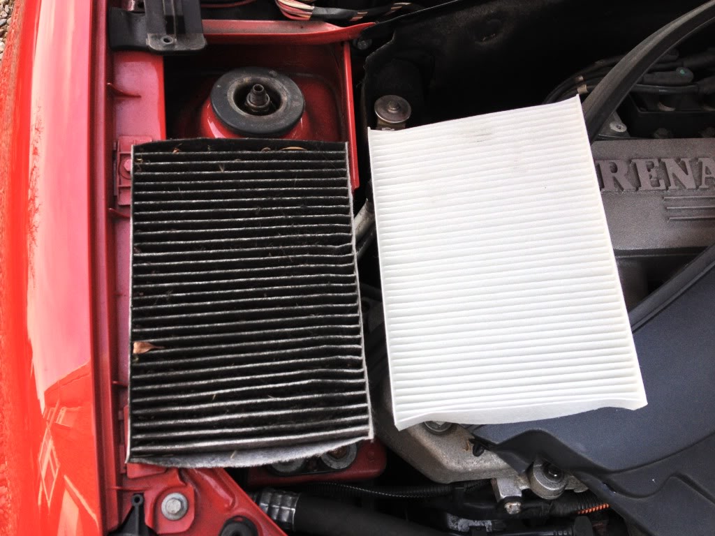

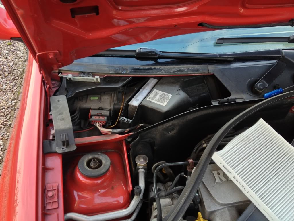

also changed the pollen filter as i found one i had sitting in the garage for ages

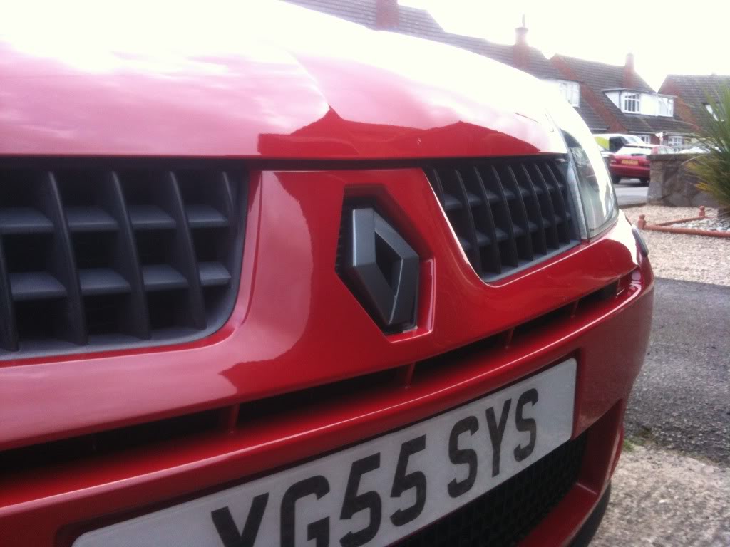

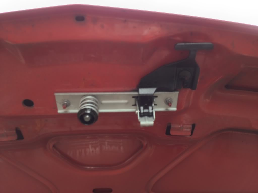

then got a letter through the post telling my about the bonnet catch recall.. so booked in at renault leicester

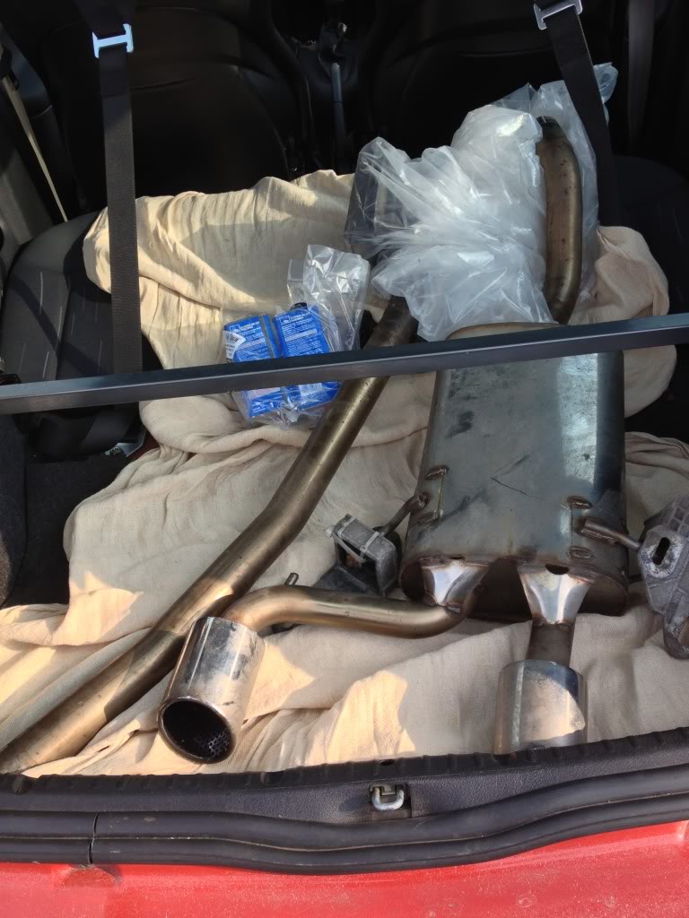

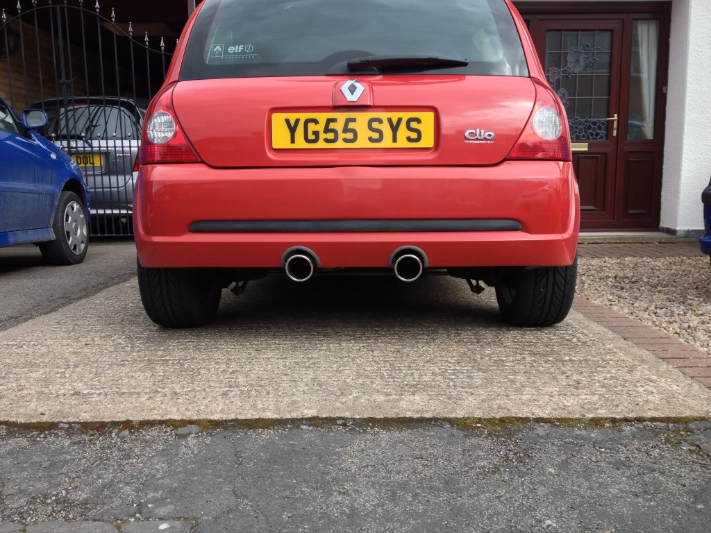

decided then to chance the standard exhaust, as i wanted a better look and a little more noise, so picked up a ktec/janspeed cat back and decat from a forum member

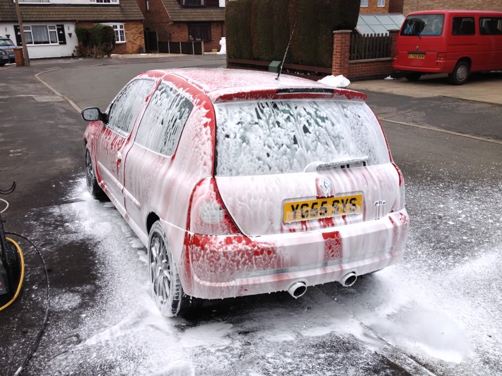

a few more cleaning photos using a friends snow foam lance

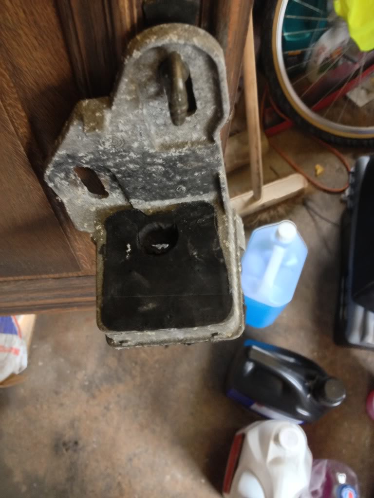

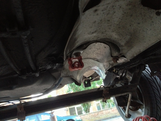

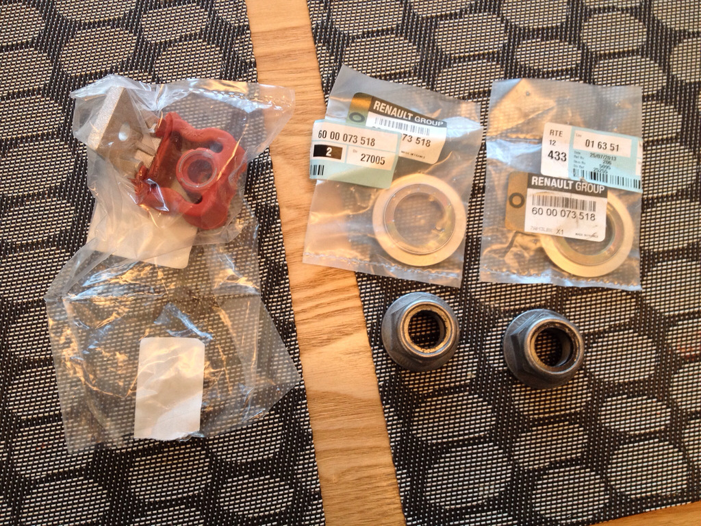

thought i would make up some better exhaust mounts as the standard renault ones are useless! so picked up a tube of tiger seal
cheeky photo of my dads TT which i also drive

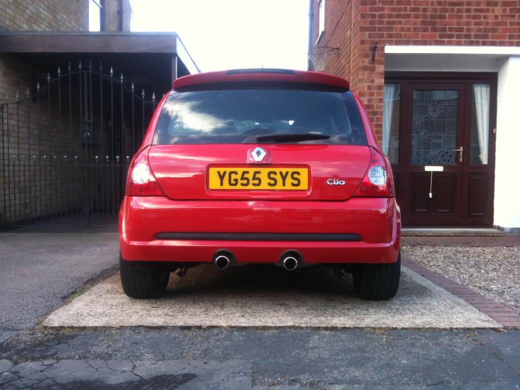

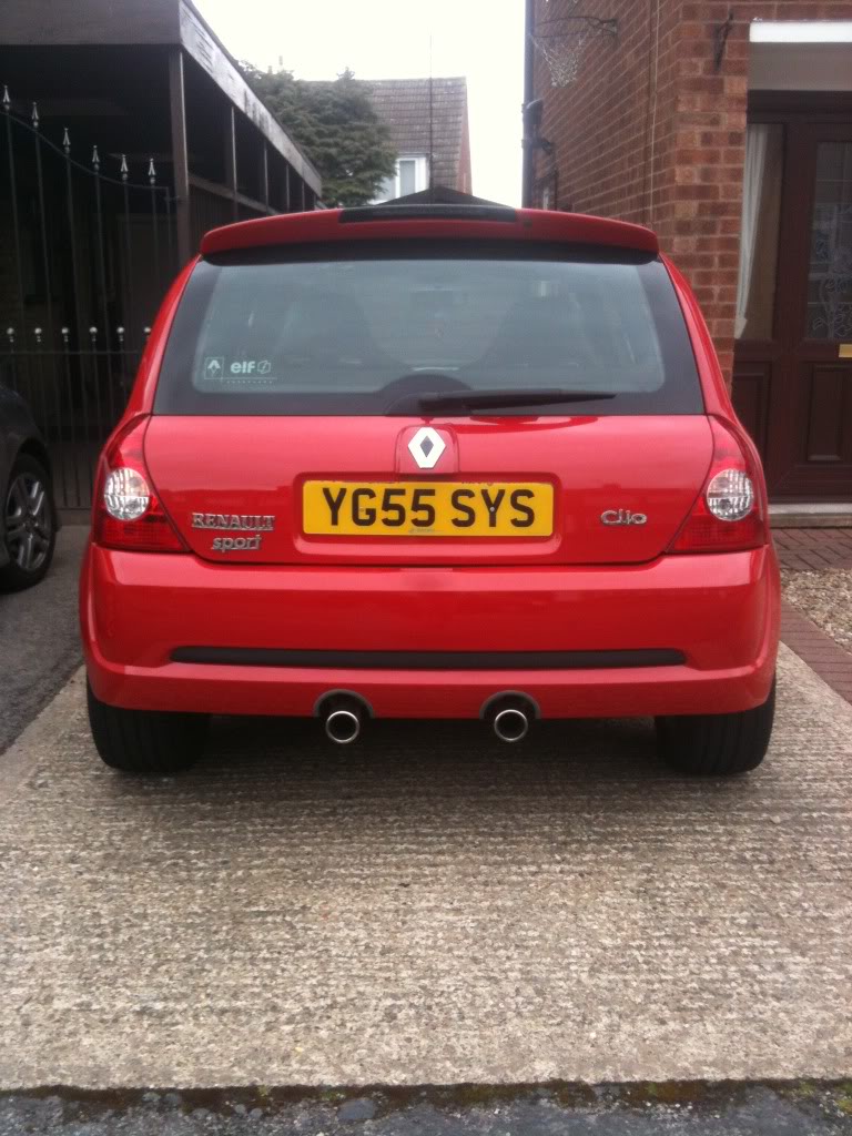

exhaust fitted and looking much better than the standard pea shooters!

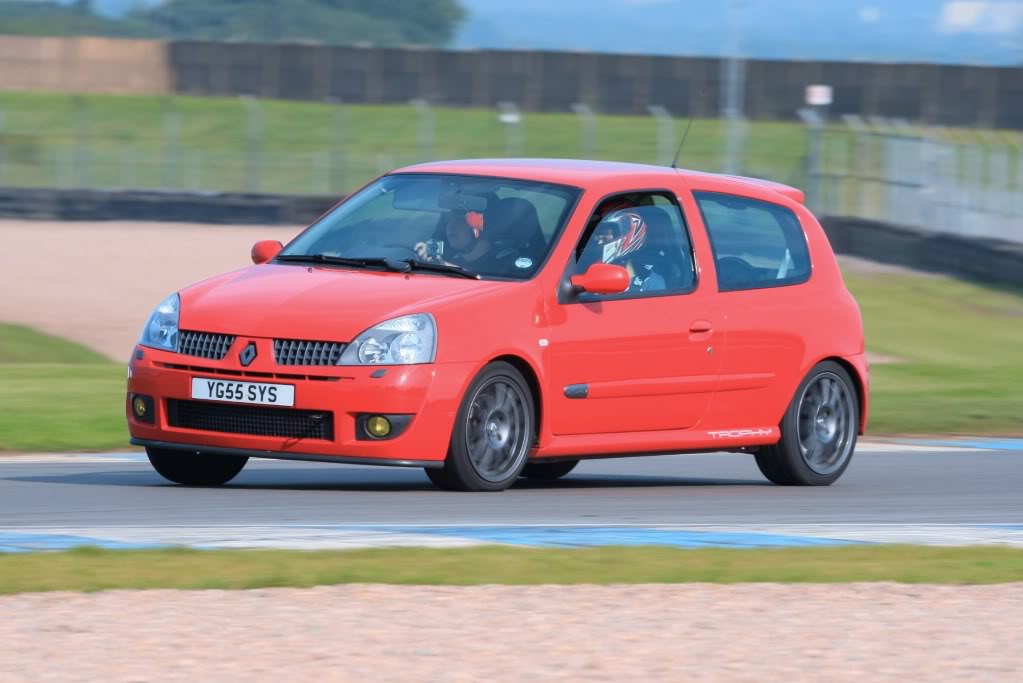

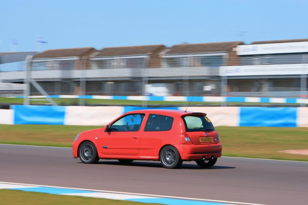

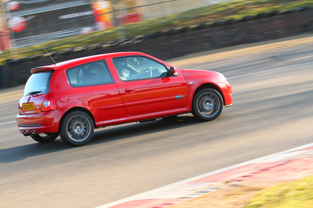

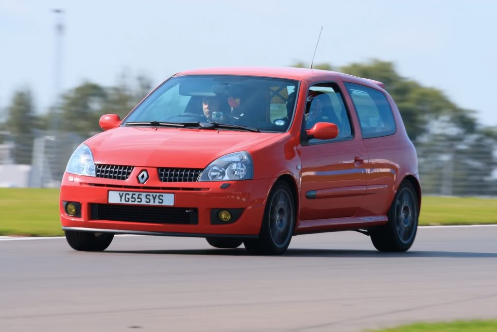

a few photos on track
finally got round to getting the brake fluid changed with ATE super racing blue dot 4, so i thought i might as well put on some braided lines at the same time, so picked some up from Fred

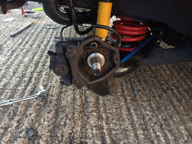

whilst changing the fluid discovered a leaky rear shock! (wondered why the car felt a bit funny when cornering!)

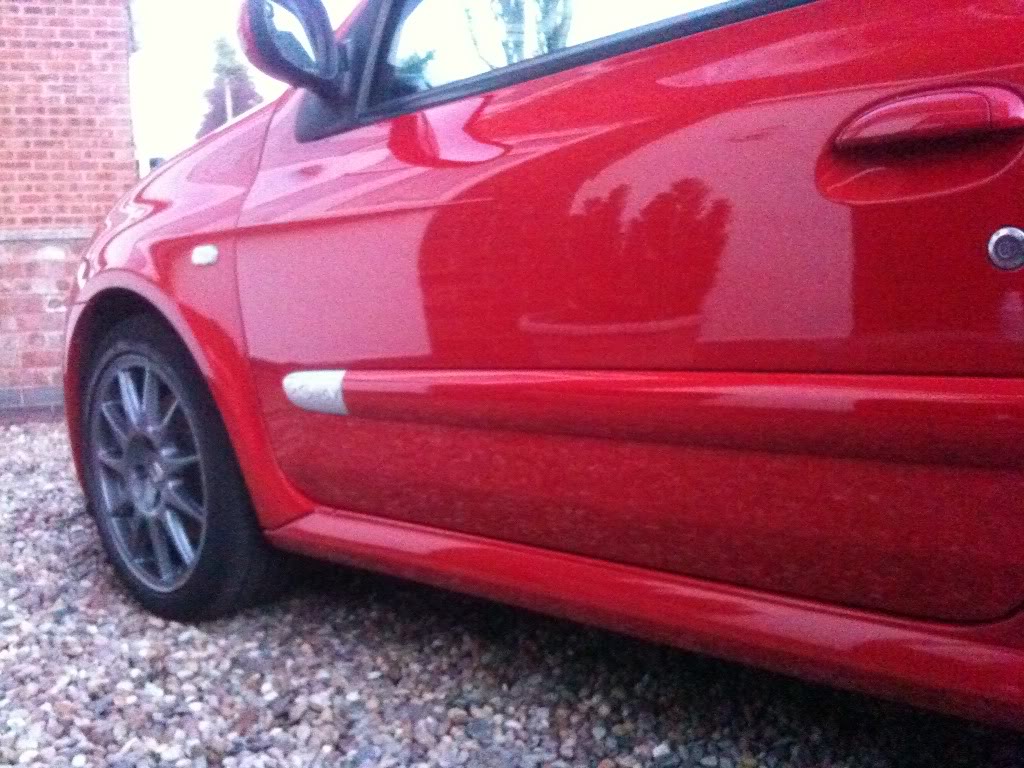

few detailing photos, gave it a nice coat of wax with meguiars tech wax 2.0

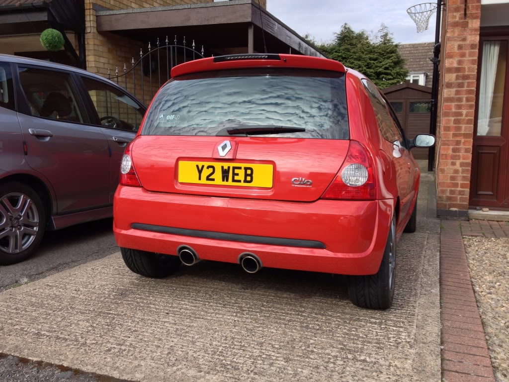

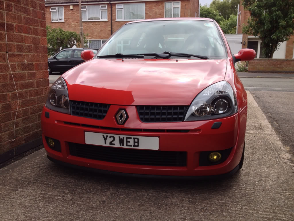

then got my private plate on at last!
after having done a few track days, i decided i wanted some more supportive seats, so picked up some bimarco futuras from a forum member (apologies for rubbish photo)

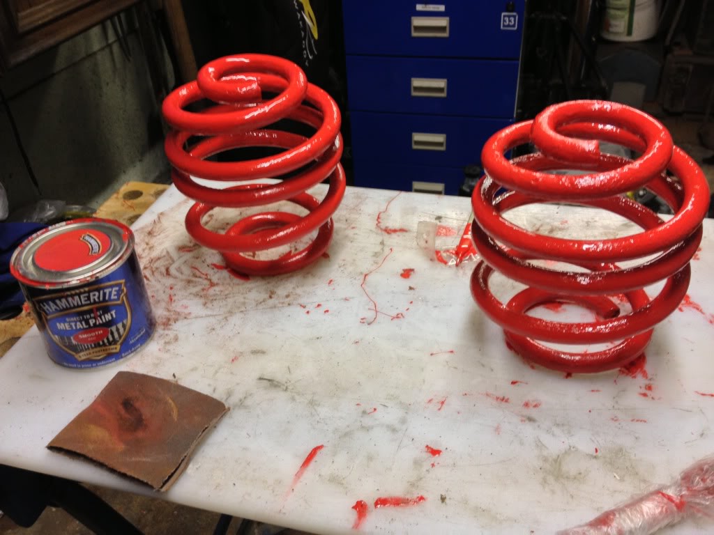

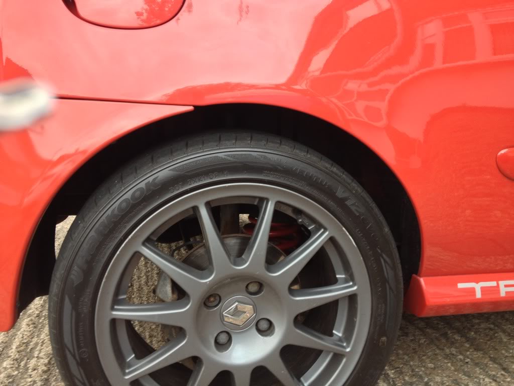

at this point i was unhappy with the height of the rear on sportlines as it was stripped out..
so i bought some h&r rear coilover springs off of a forum member to get it to the correct height, gave them a clean and a lick of paint before fitting
the rear now sits much better, but cant help feeling that the front needs to be a little lower now!

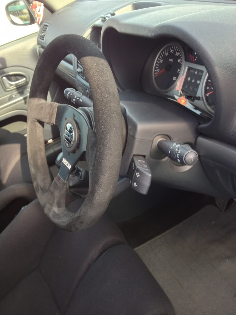

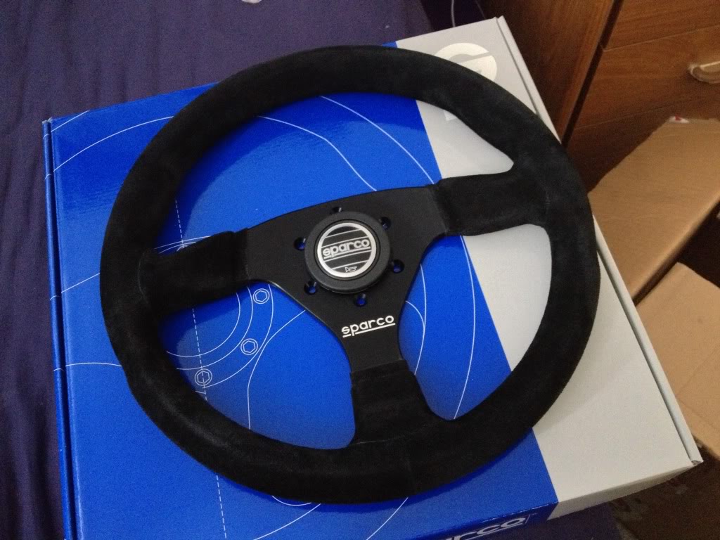

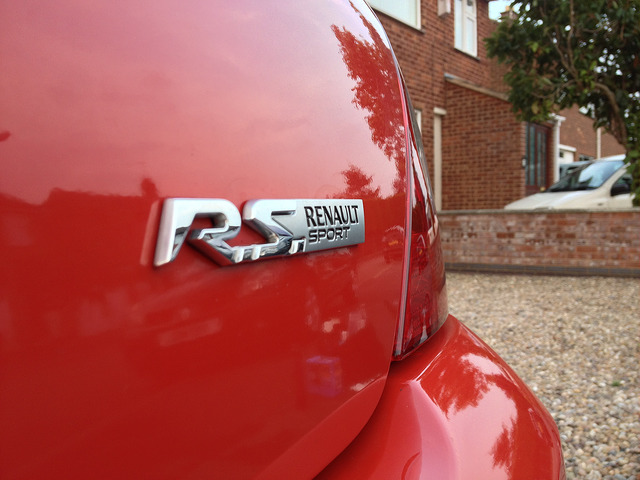

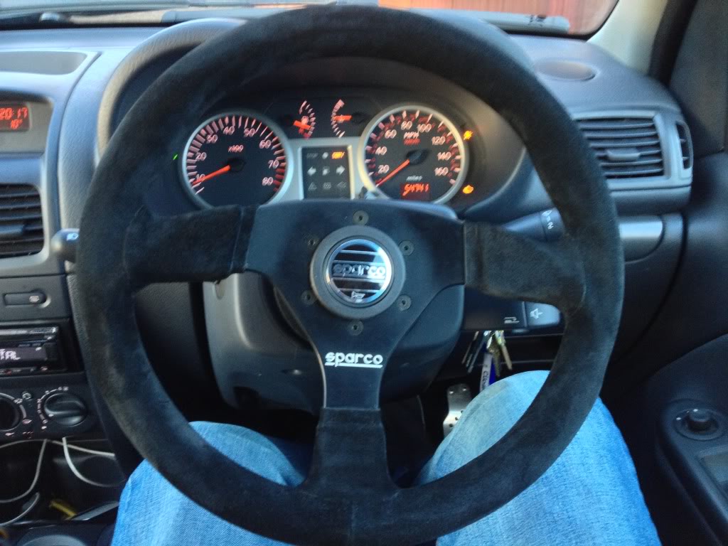

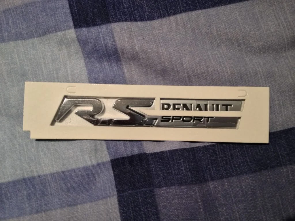

then decided i wanted a few more little things.. RS rear badge, sparco 383 wheel with momo boss, more solid gear level with short shift pin (which i am yet to fit)
steering wheel fitted

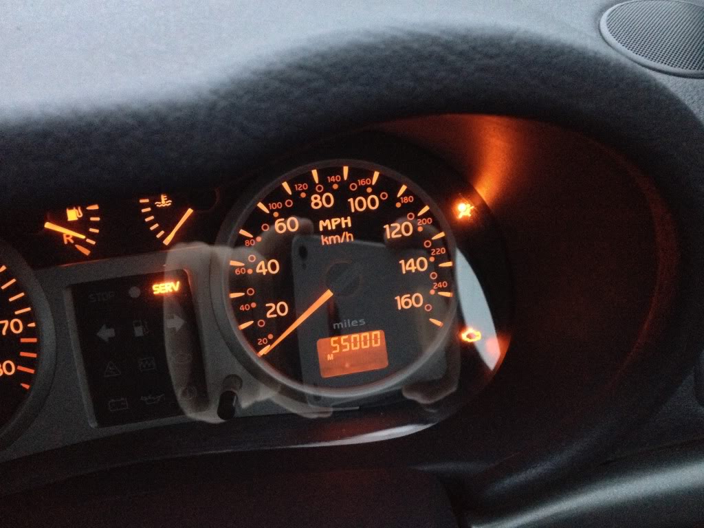

then clicked 55k!

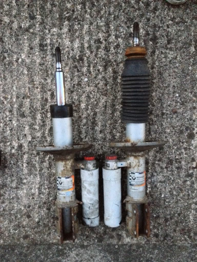

i was then greeted by a leaking front sachs! not such a big issue as i was planning on getting them refurbished anyway, and this will just push me to get a front end refresh done

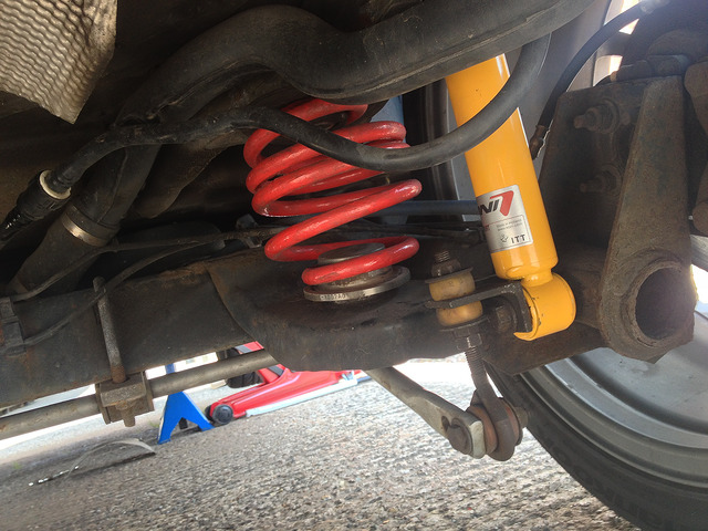

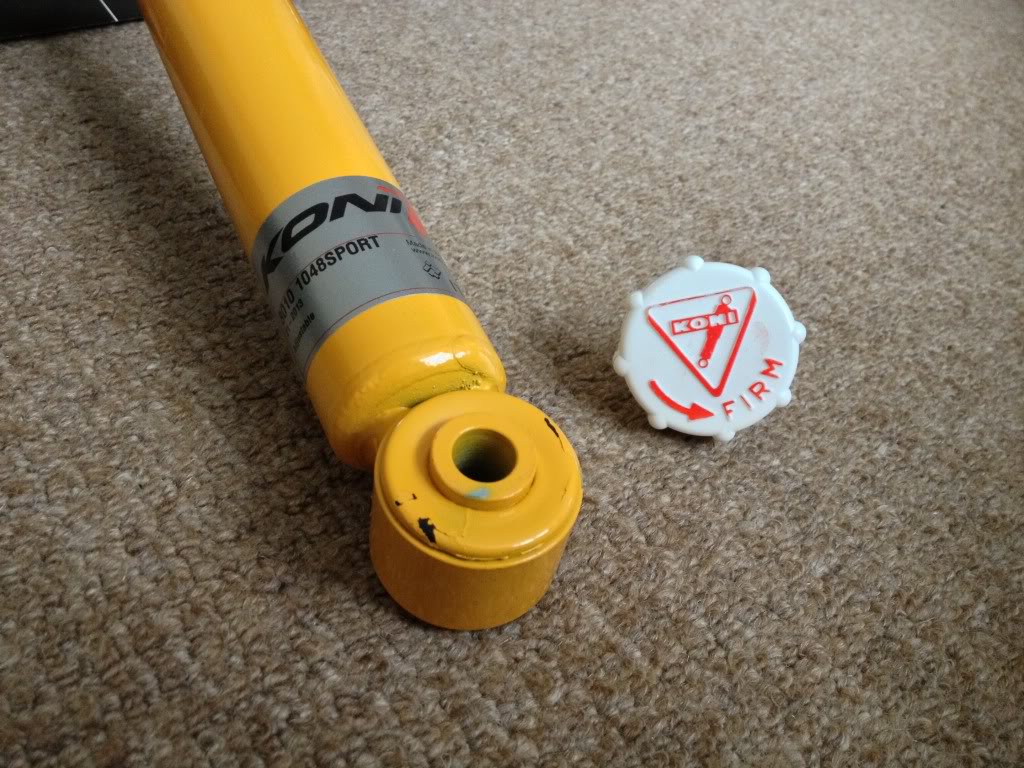

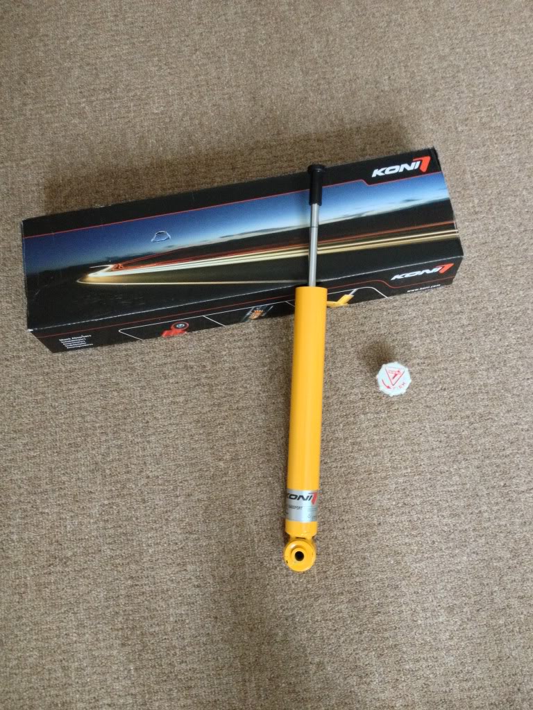

i ordered some koni rear dampers (which finally turned up after waiting over a month!) and some camber bolts

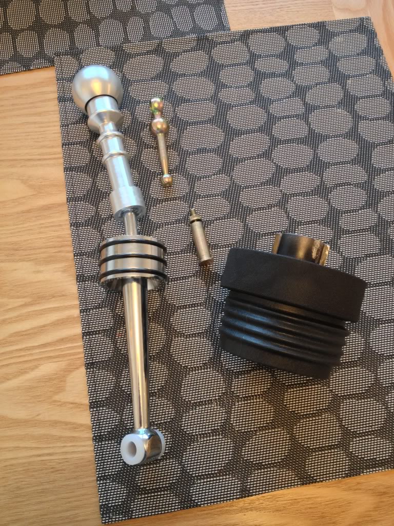

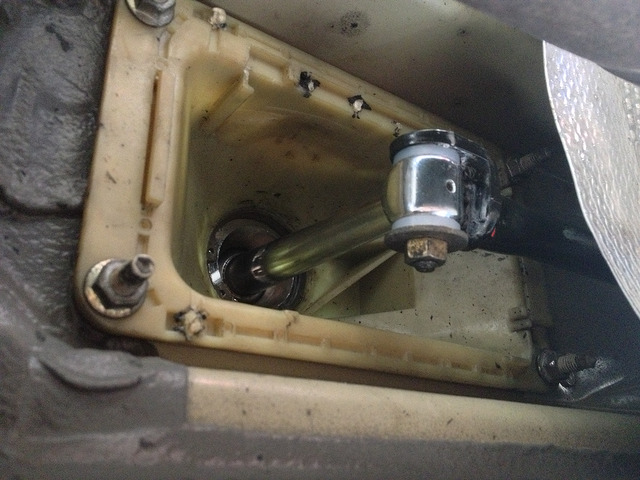

  • fit the gear lever

You need to give your neighbour a good shake! That wheels on the megane are horrific! I hope they were winter wheels?

They were indeed his winter wheels while he was having his others refurbished! Think they were Volvo wheels which he picked up very cheap with tyres.

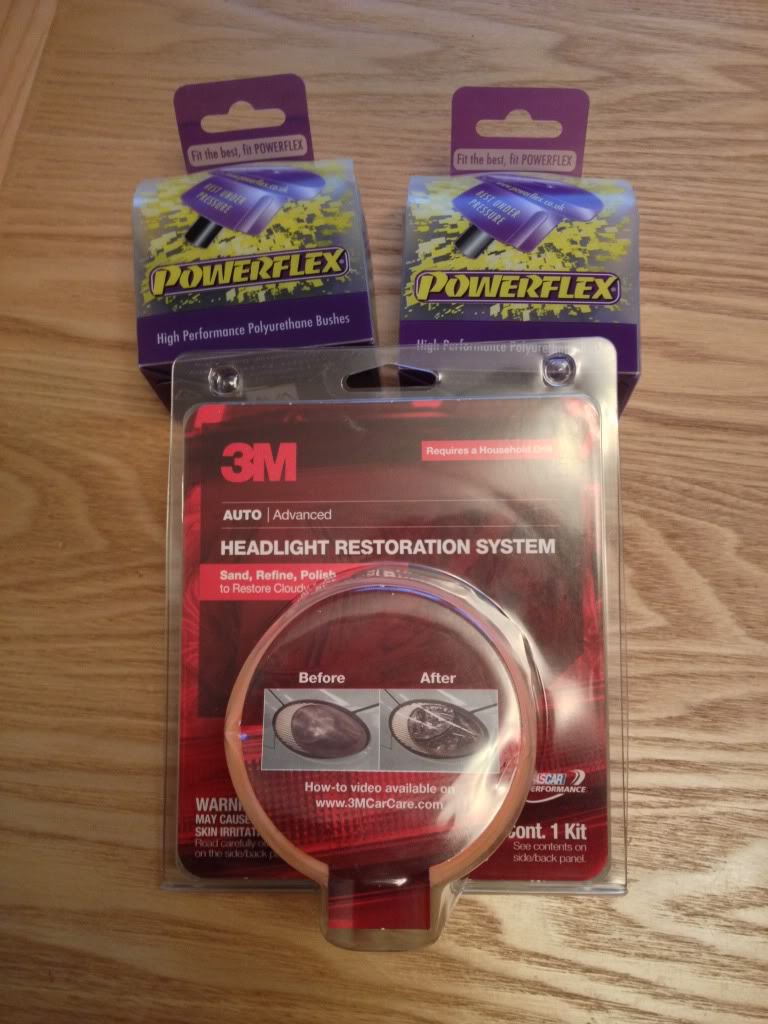

powerflex arb bushes for the front end refresh and a 3m headlight kit.
Still not sure whether I should get powerflex wishbone bushes or get genuine Renault wishbones!

Forgot about the photos from track days I've done! Here's a few of my favourites.
Bedford
donington
brands hatch

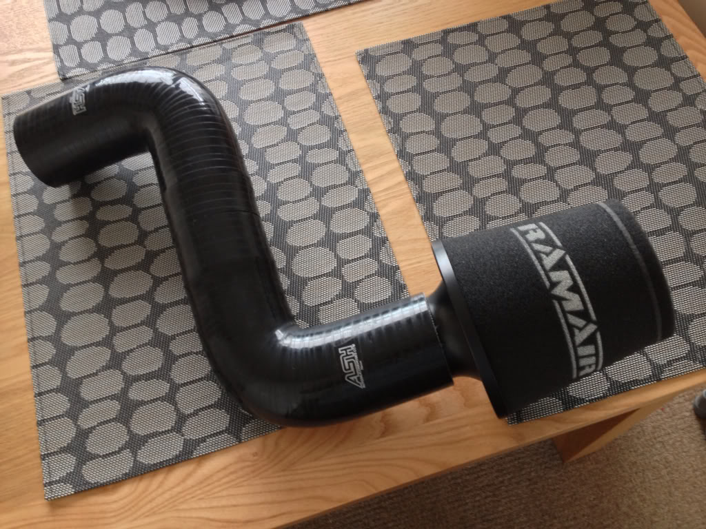

Small update.

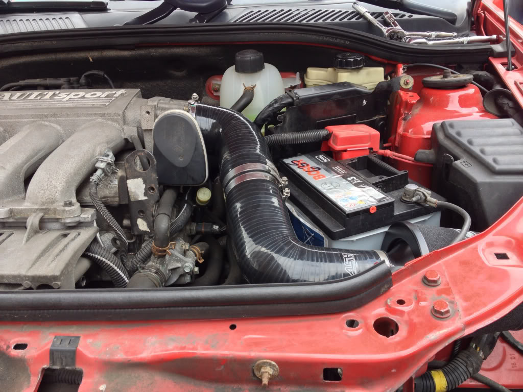

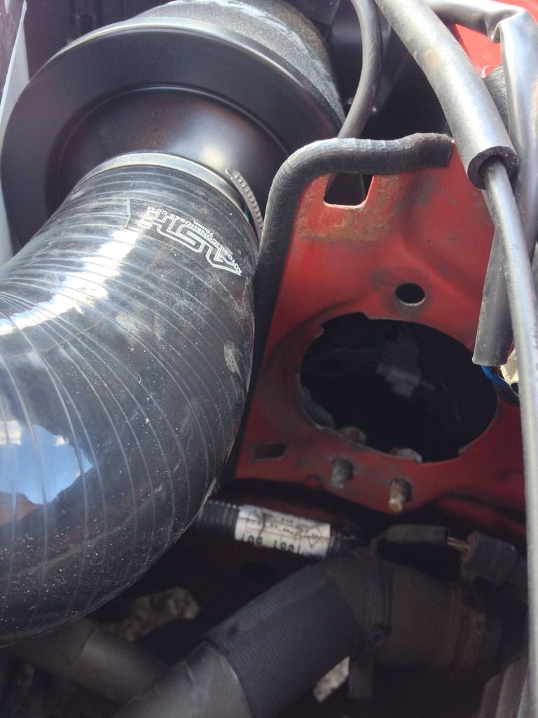

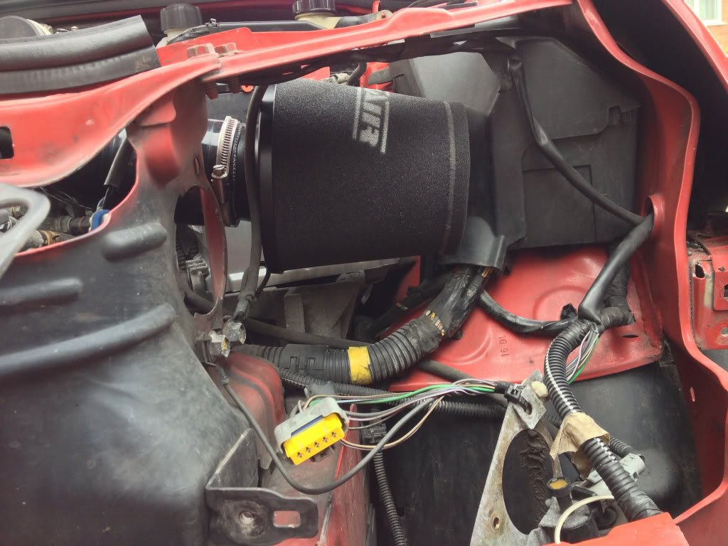

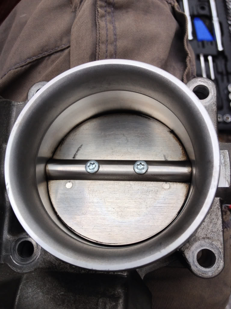

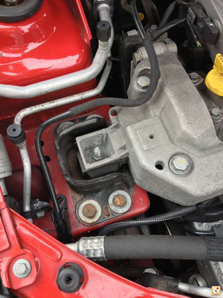

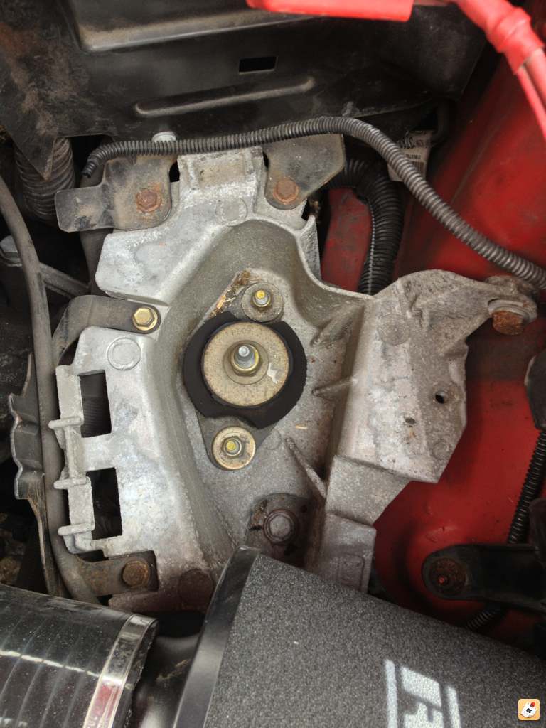

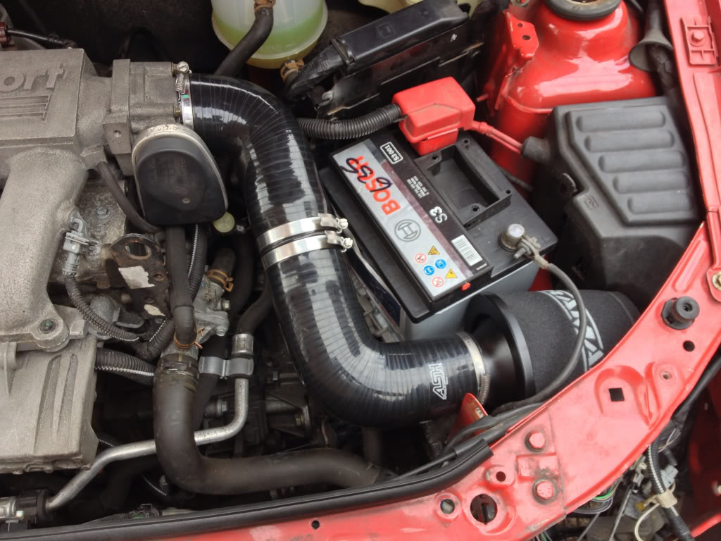

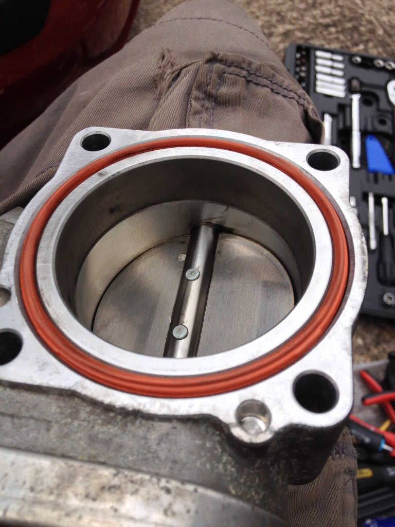

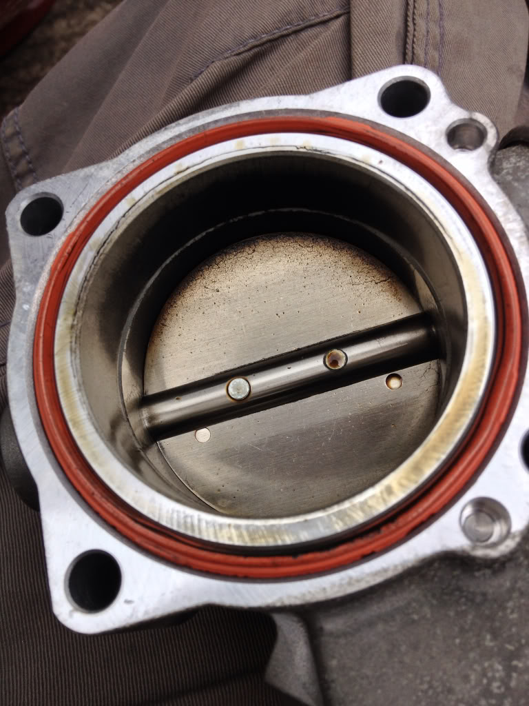

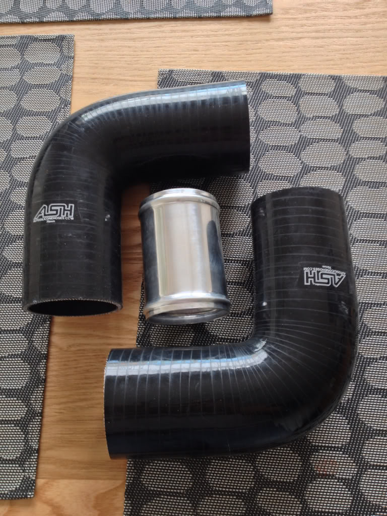

Few bits came through the post today for my ktec style induction kit
being impatient I had to fit it straight away! And whilst I had the intake off I thought I would give the throttle body a quick clean, glad I did because it had a fair bit of oil in it!
before
after
and a few photos of the intake
In the third photo you can see that the bottom bit of silicone nearest the filter is touching the metal that the ecu bracket and air box mount bolted to.. Anyone got any ideas to prevent it from rubbing and damaging the hose?

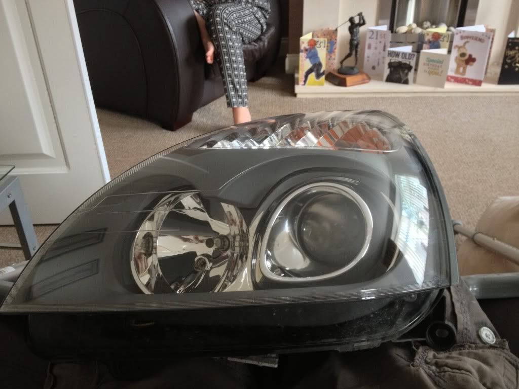

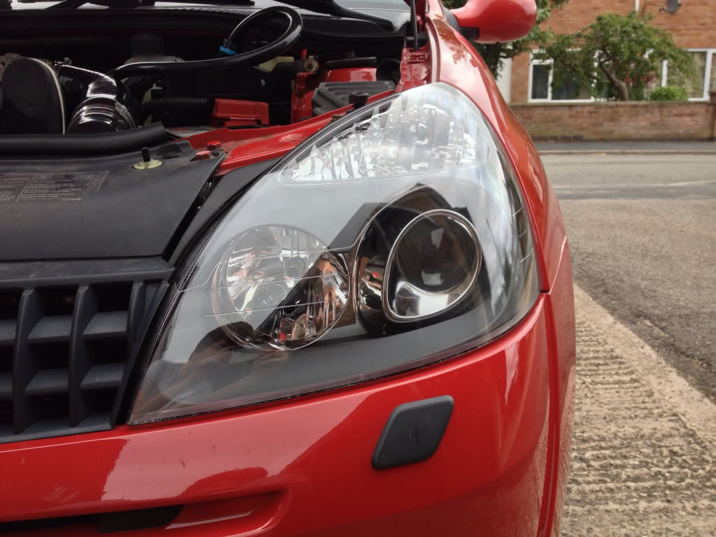

also thought I would fit my xenons being as I was working on the car anyway
not 100% sure whether I like them or whether I prefer the more oem look, but they can stay for now!

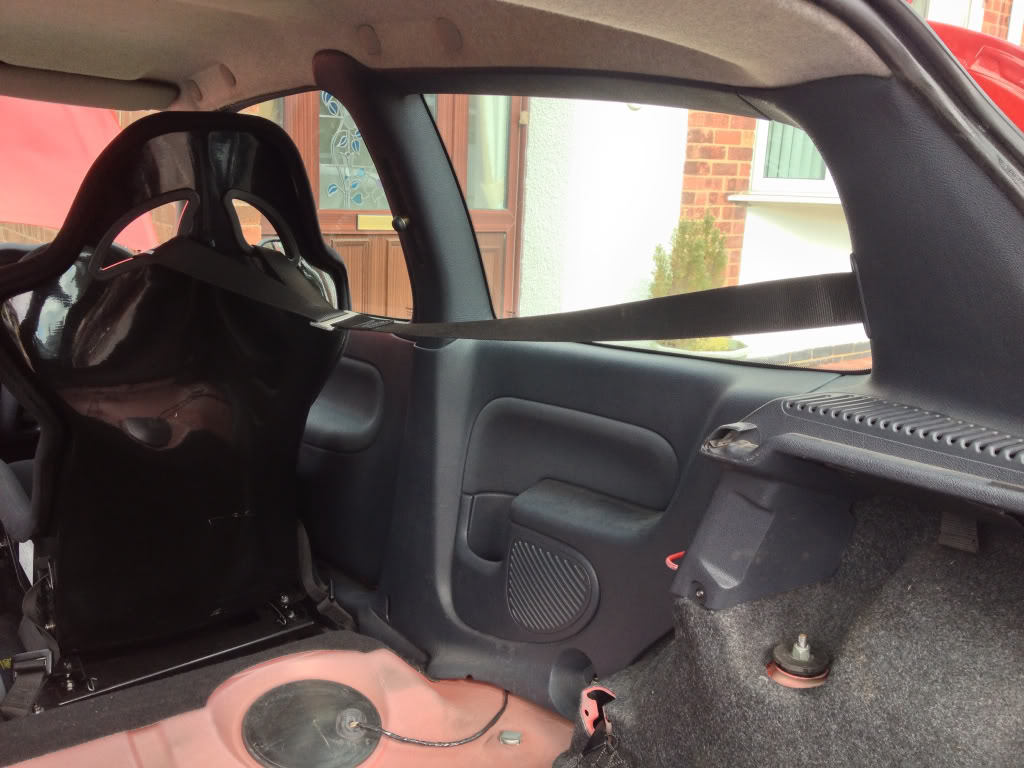

also thought I would mount the rear of my harnesses in a safer position after reading how they should be mounted properly

Looks good :) Abit of spare silicon if you have it attached to the bracket works to stop the rubbing, the official KTR kit comes with a piece of rubber to stop the hose rubbing against the metal. Regarding your gearbox, as far as im aware abit of oil around the breather is fine and 'normal' on all RS Clios, ive had it on both of mine.
  PH1 Track Car
Cheers mate, yea I've used a bit of breather hose for now, but I've just ordered some of this rubber edging off eBay for £2.30! http://bit.ly/VgiGrW
Ah that's okay then! Ill give it a clean one day when I get chance and see how quickly it comes back, cheers for the reply :)

For anyone wanting to know what I used for the ktec style induction kit...
  • 2x 90 degree 70mm ID black silicone hoses (made by autosiliconehoses) http://bit.ly/14rb9OH
  • 70mm OD 150mm alloy joiner http://bit.ly/12DO9qD
  • 70mm OD ramair foam filter with alloy neck http://bit.ly/12DOf1k
  • 4x jubilee clips with an adjustment range of 70-90mm (silicone has an OD of 80mm)

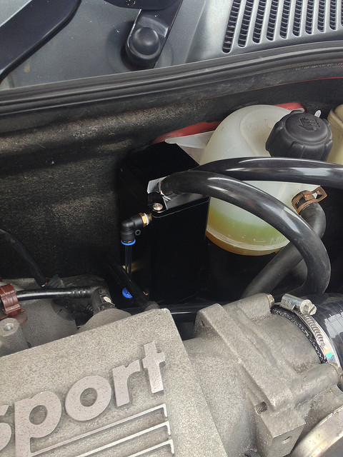

  • and however you choose to set up the breather, whether its catch can or back into the inlet, I used 13mm vacuum hose which gave a nice tight fit
  • If you want to prevent the silicone hose from rubbing on the thin metal that the ecu bracket and front airbox mount bolt to, then I've ordered some rubber edging from eBay http://bit.ly/VgiGrW
if anyone wants any more info feel free to ask!
Greeny.
  440i + 182
Thats the rubber edging the KTR kit comes with, or at least it looks exactly the same!

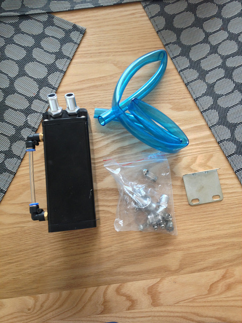

What oil breather did you use? I ordered the ramair one off the bay. I've just sold my KTR induction silicon to get some of the above, plus a 45 degree bend and another joiner to put the original ramair KTR filter a little further down outta the way, will be a tight fit though as I don't wanna remove the headlight adjuster, as its handy being able to see where im going in the dark :)
Edit: Just re-read your post, your already said what you've done with your breather :p

Yea I was going to vent it back into the inlet until I saw how much oil was on my throttle body, so now going to run a catch tank.

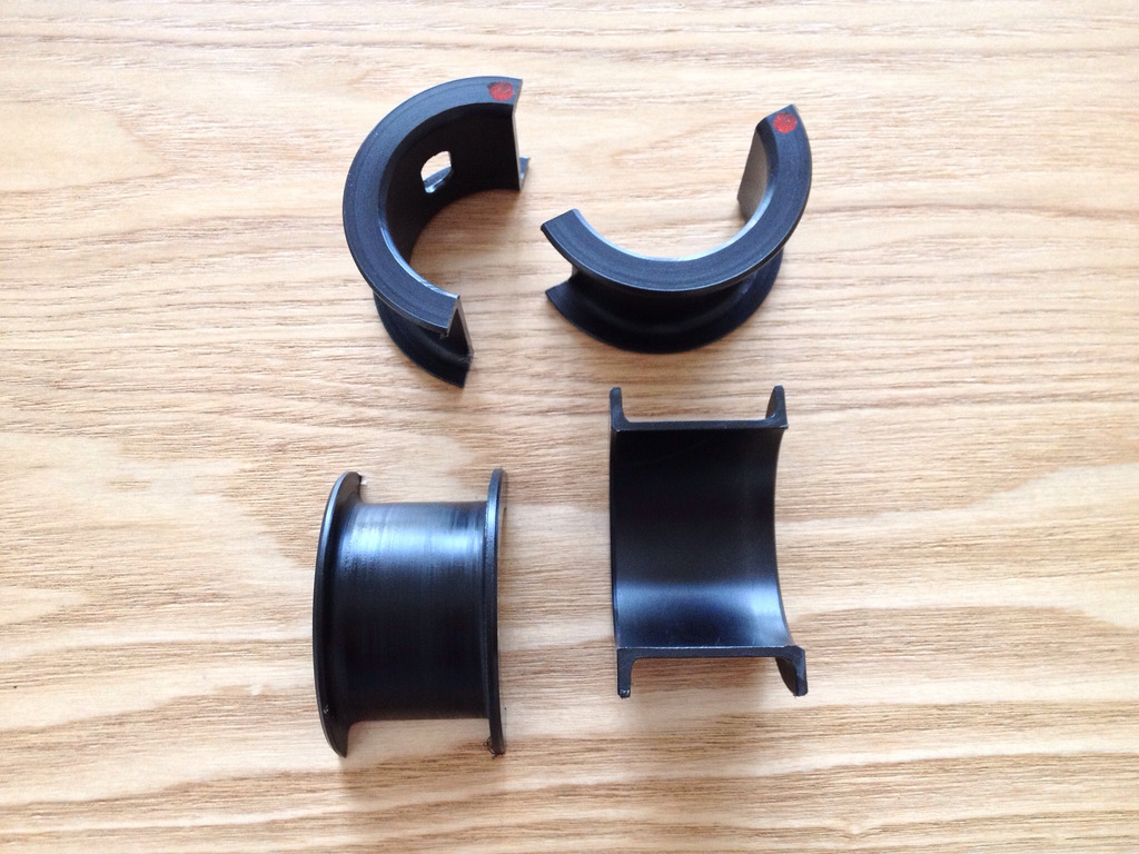

Bit of an update...

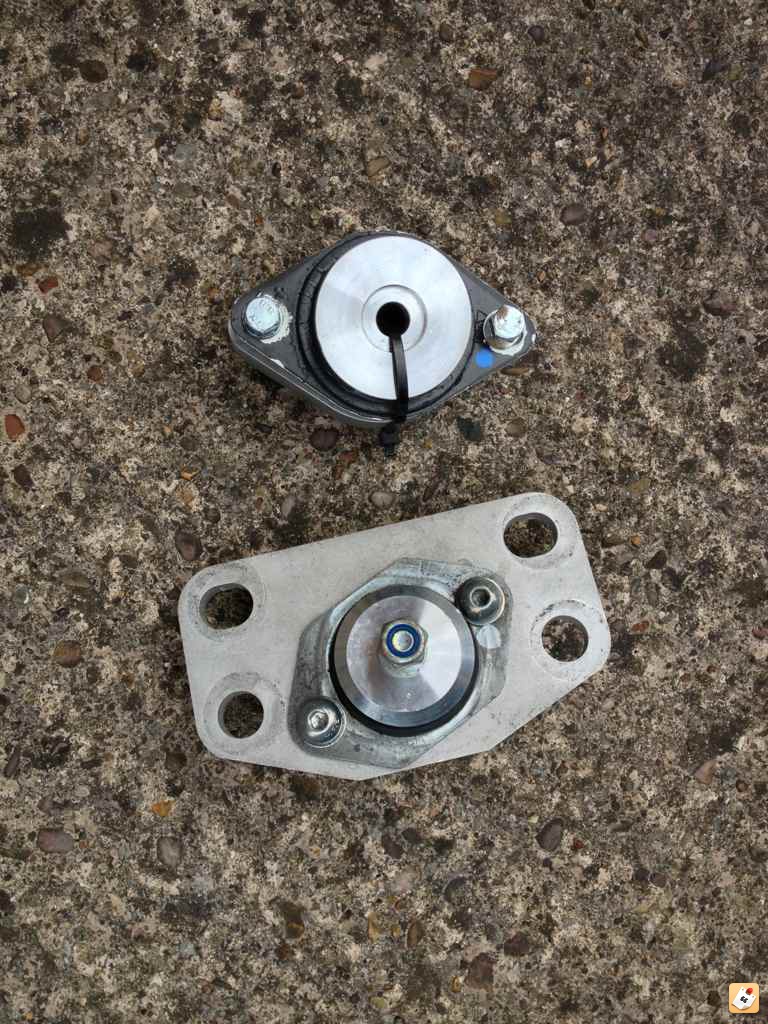

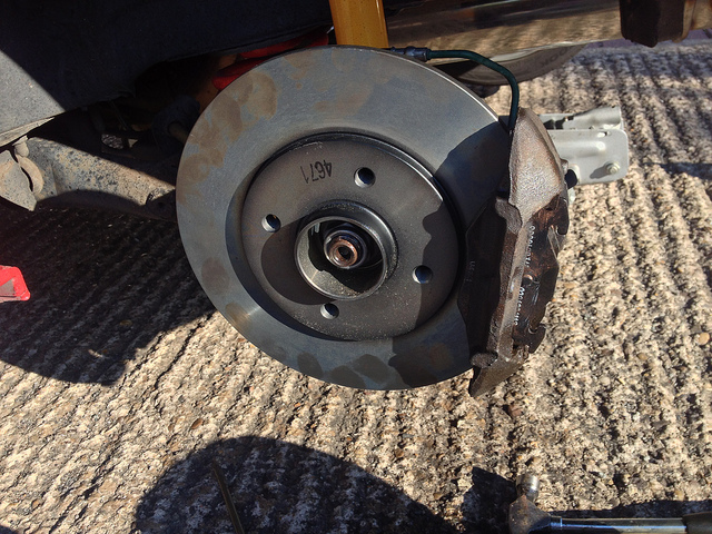

My PF97 pads and nylon steering rack bushes came.
Nylon rack bushes by AshWebb_Trophy, on Flickr
i got the rubber edging I ordered for the induction kit
Untitled by AshWebb_Trophy, on Flickr

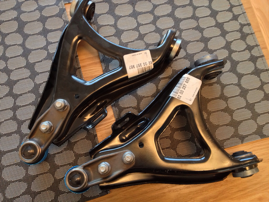

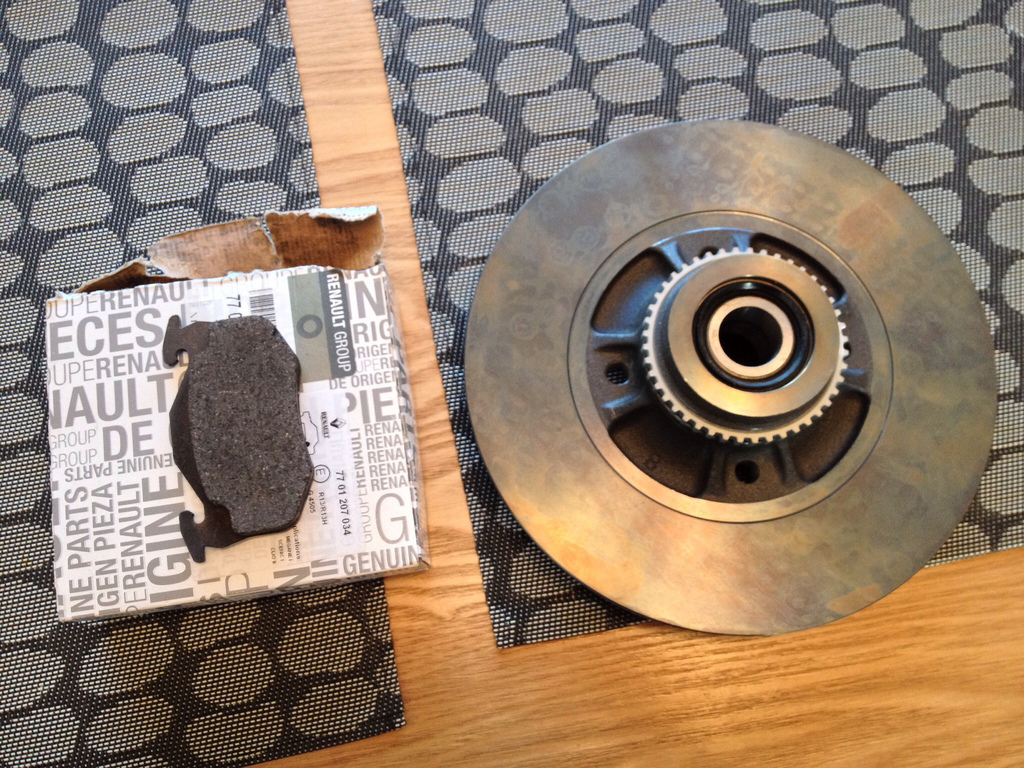

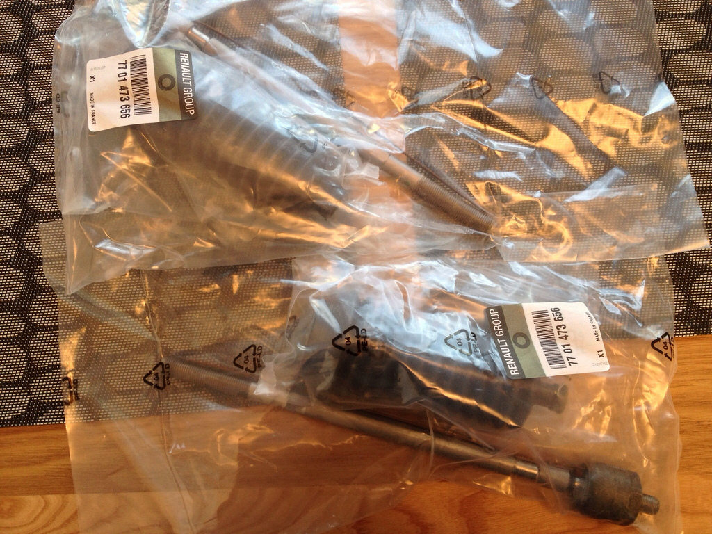

I also took a trip over to Adam at Renault Wolverhampton parts this afternoon for some more bits for my suspension refresh... Wishbones, tie rods, rear discs, pads, bearings, abs rings, hub nuts, and disc spacers, and also a centre exhaust mount.
Wishbones by AshWebb_Trophy, on Flickr
Rear brakes by AshWebb_Trophy, on Flickr
Tie rods by AshWebb_Trophy, on Flickr

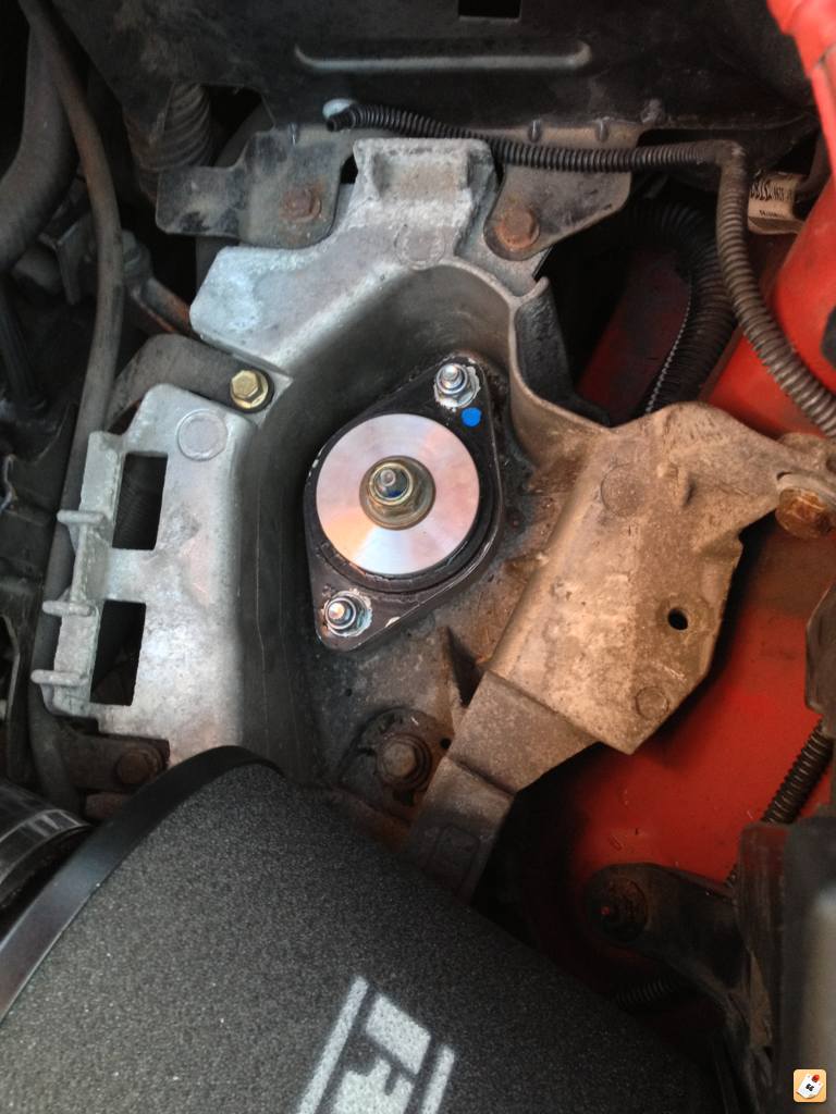

Ive also ordered a pure motorsport top mount and strut brace package as part of my refresh, so now I've got all the parts, they will be going on soon, followed by a suspension geometry check and setup, spacers all round, and shims if necessary... So watch this space!

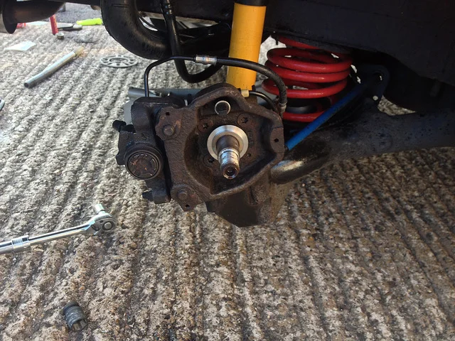

Havent updated in about a month so thought I would do one.
Started fitting some of the suspension components but havent really had the time to do all of them so they are slowly getting done!

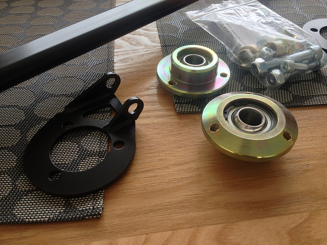

PMS top mounts and strut brace arrived, looks like a really nice bit of kit!
IMG_1429 by AshWebb_Trophy, on Flickr
IMG_1430 by AshWebb_Trophy, on Flickr
Fitted my koni rear dampers, really nice shocks, loads of adjustability, really seem to improve the way the car responds when you set them to hard, and definitaly keep the rear end nice and flat, definate improvement!
IMG_1434 by AshWebb_Trophy, on Flickr
Fitted my uprated gear lever, overall not bad, an improvement over the original, but as i went the the cheap ebay option the build quality isnt the best, if you can get over that then it isnt too bad.
IMG_1435 by AshWebb_Trophy, on Flickr

Got round to fitting my new rear discs, pads, bearings, abs rings, spacers, and hub nuts.
IMG_1490 by AshWebb_Trophy, on Flickr
IMG_1491 by AshWebb_Trophy, on Flickr
Picked up an oil catch tank off my mate who had one in his garage
IMG_1499 by AshWebb_Trophy, on Flickr
IMG_1501 by AshWebb_Trophy, on Flickr

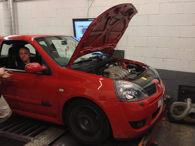

Got my car dynod at a local place, partly out of curiosity to see what it was running, partly for my college project! It made 171bhp with the ktec style induction kit, not bad but a little less than i would have hoped, but a few bhp isnt going to make a world of difference anyway.
IMG_1505 by AshWebb_Trophy, on Flickr

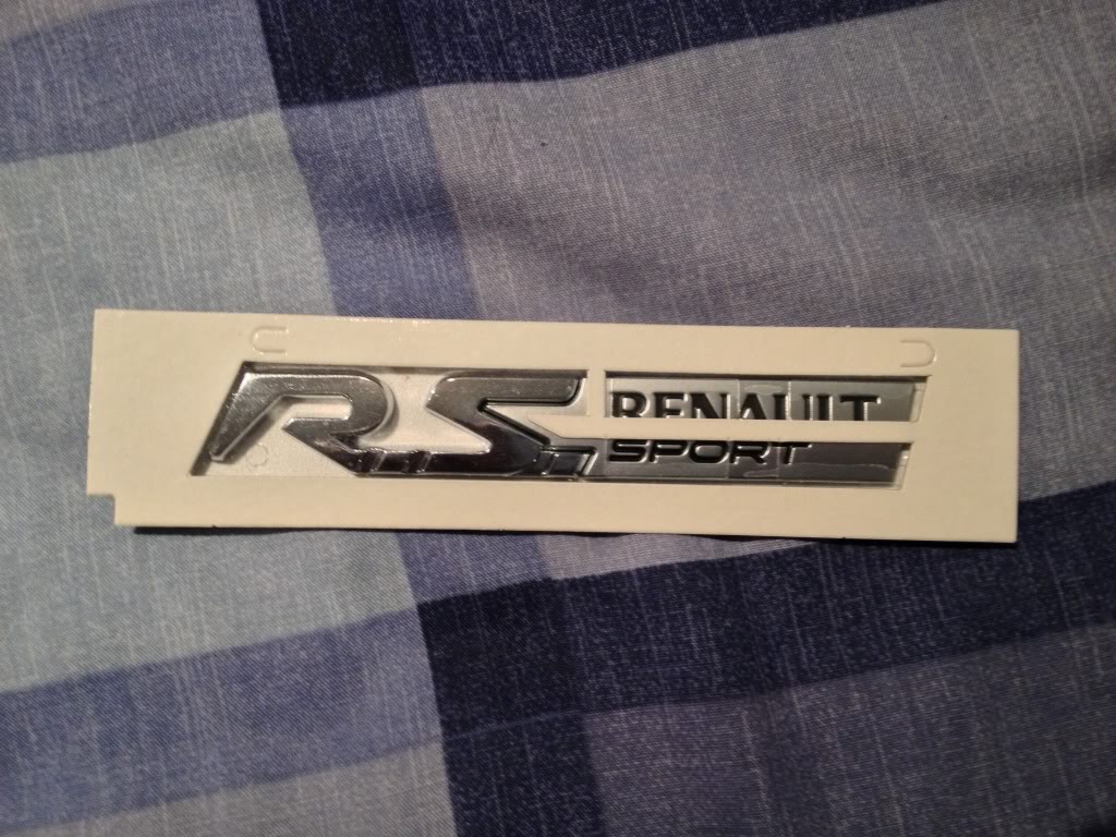

Few photos of the new style RS badge, and the trophy decal fitted to my boot
IMG_1562 by AshWebb_Trophy, on Flickr
IMG_1564 by AshWebb_Trophy, on Flickr
Then went to the Llandow trackday in wales over the bank holiday weekend, so a few shots from there (thanks to SharkyUK)
IMG_1580 by AshWebb_Trophy, on Flickr
IMG_1582 by AshWebb_Trophy, on Flickr
IMG_1584 by AshWebb_Trophy, on Flickr

Where did you get the nylon steering bushes?

got them off a group buy on here, not sure if its still going on! They look decent though

Oh yeah, as for the dyno reading... 171bhp isn't a bad result at all. If Llandow was anything to go by then you've got nothing to worry about!
  PH1 Track Car
Small update.
The Sachs have been sent off to cornering force for refurbishing and powder coating, and I also picked up some vibratechnics engine mounts off a friend and got them fitted.
Before:
After:
Bit more vibration on idle. Not massive amounts more when driving. But overall feel is improved and the engine no longer rocks backwards and forwards on acceleration so worthwhile.
Just looking forward to getting the Sachs back now!
