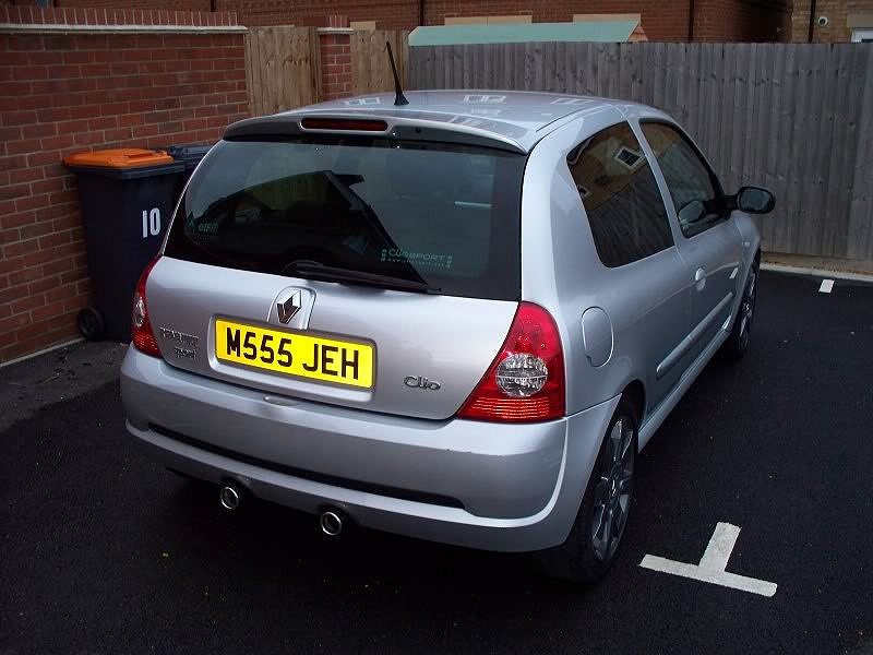

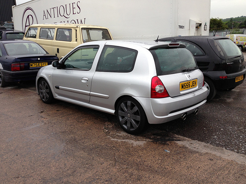

Few photos of it from the previous owner..
Clio 182 by Lawro1988, on Flickr
The car had covered just over 65,000 miles at this point and was to date pretty much standard so I thought I would start with a full suspension refresh to keep things tight.

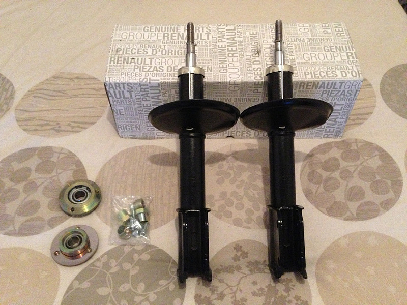

The car was fitted with both cup packs from factory and after toying with the idea of coilovers I decided I would prefer something a little less harsh on the road so opted for the spring and cup shock combo.

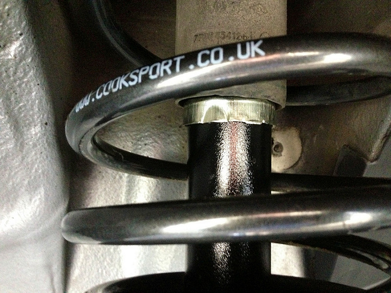

Being friends with Josh from Cooksport he mentioned he was producing some springs for the clio so we came to an agreement and my car was fitted with the first set to trial them for him. I then decided to replace the front and rear shocks with genuine cup items along with new Lemforder ball joints and track rod ends, powerflex wishbone bushes and genuine inner & outer anti-roll bar bushes, steering rack bushes and inner tie rods. I also opted for a set of the lovely Pure Motorsport Solid Top Mounts over the standard items.
Suspension by Lawro1988, on Flickr
Cup Shocks by Lawro1988, on Flickr

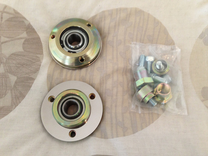

PMS Top Mounts by Lawro1988, on Flickr

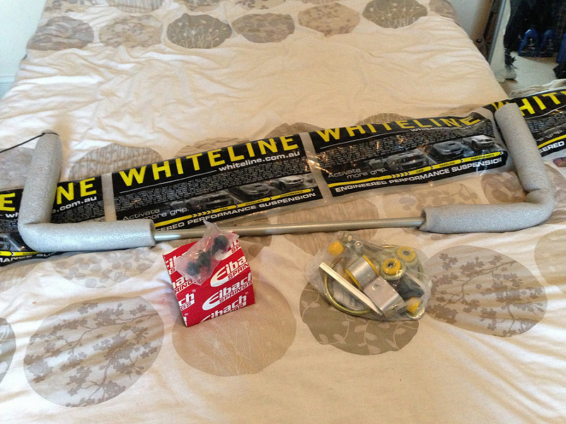

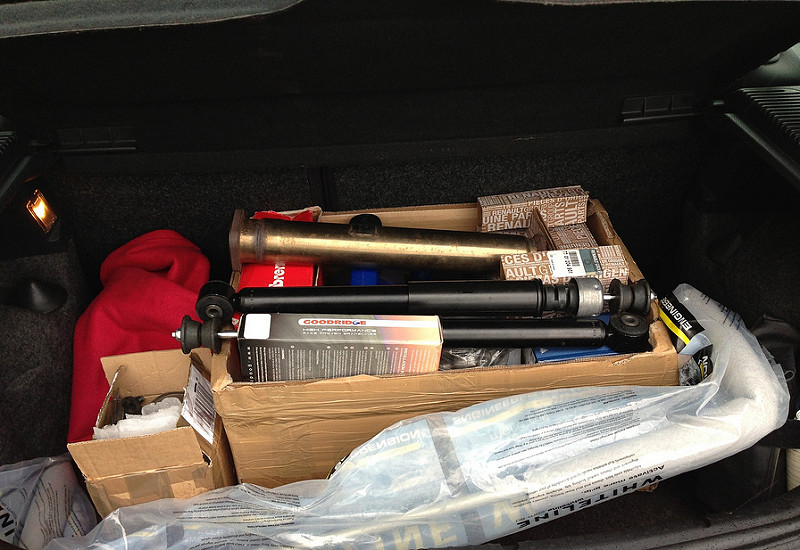

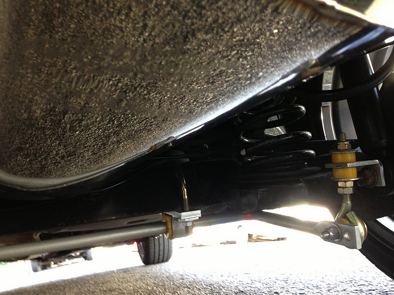

I decided to couple this set-up with a Whiteline rear anti-roll which I purchased from Demon Tweeks taking advantage of their price match offer and some Eibach camber bolts.
RARB by Lawro1988, on Flickr
Before fitting, I had the Whiteline RARB sprayed in Titanium Silver and gave it a few coats of wax in order to try and prevent corrosion that the standard powdercoat seems to suffer from.
Painted RARB by Lawro1988, on Flickr

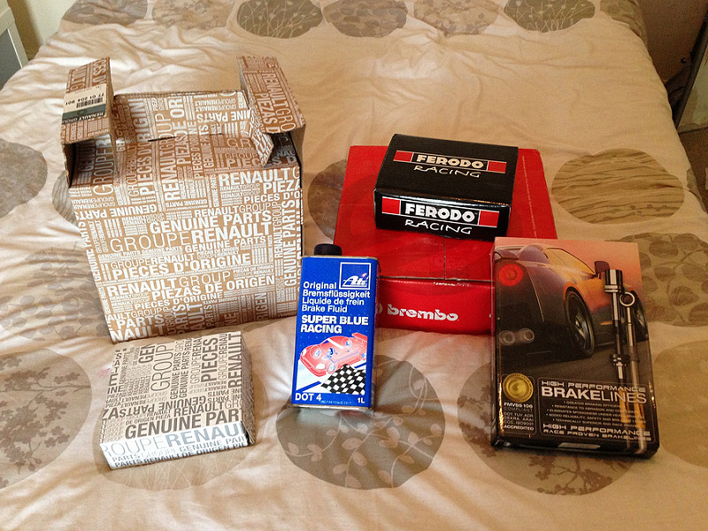

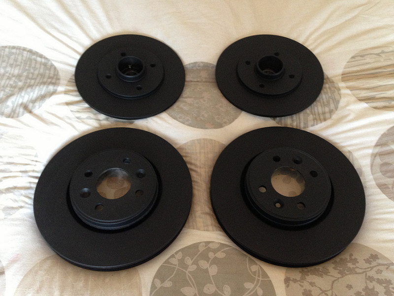

Brakes were next on the list. With the car currently being fitted with EBC Green Stuff pads by the previous owner, its safe to say they’re horrific!
After a bit of research I decided on Brembo HC front discs along with Ferodo DS2500 front pads, these were purchased from G172 and genuine rear discs and pads from Adam @ Wolverhampton Renault. I finished the brakes off with a set of Goodridge braided lines and a brake fluid flush with ATE SuperBlue.
Brakes by Lawro1988, on Flickr
The brake discs were coated in satin black to try and prevent the corrosion of the hub area. Quality looks brilliant.
Powdercoated Discs by Lawro1988, on Flickr

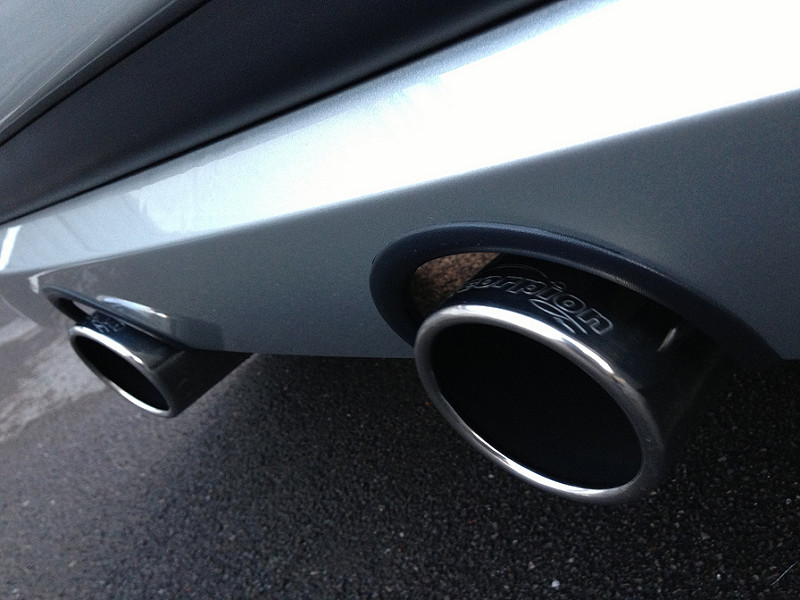

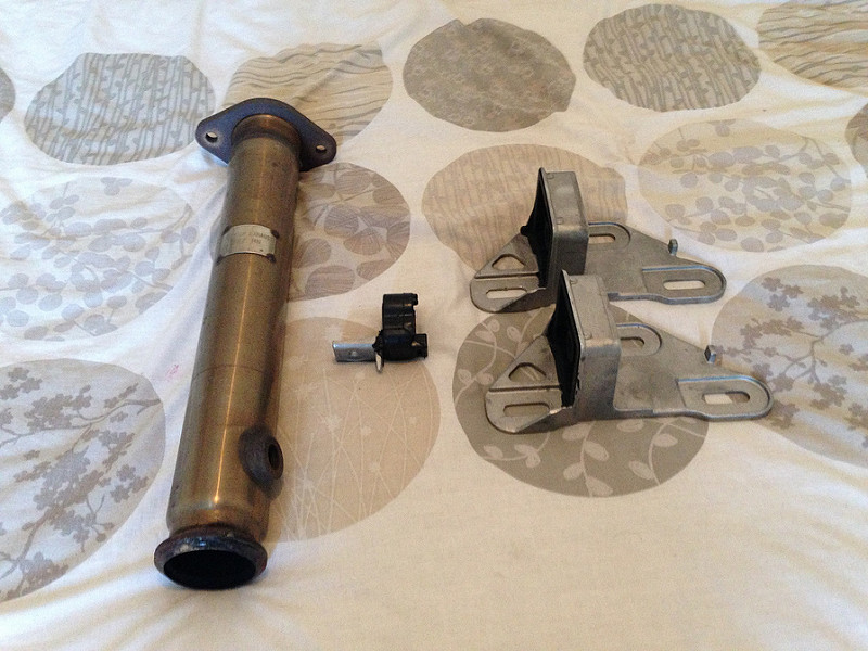

The exhaust was replaced with a Scorpion RS192 system that was beginning to look a little droopy on the current mounts, so I took the liberty of purchasing a full set of genuine rear and centre exhaust mounts. I also decided to purchase a Scorpion decat too as I fancied a little more noise from the system.
Exhaust Mounts by Lawro1988, on Flickr

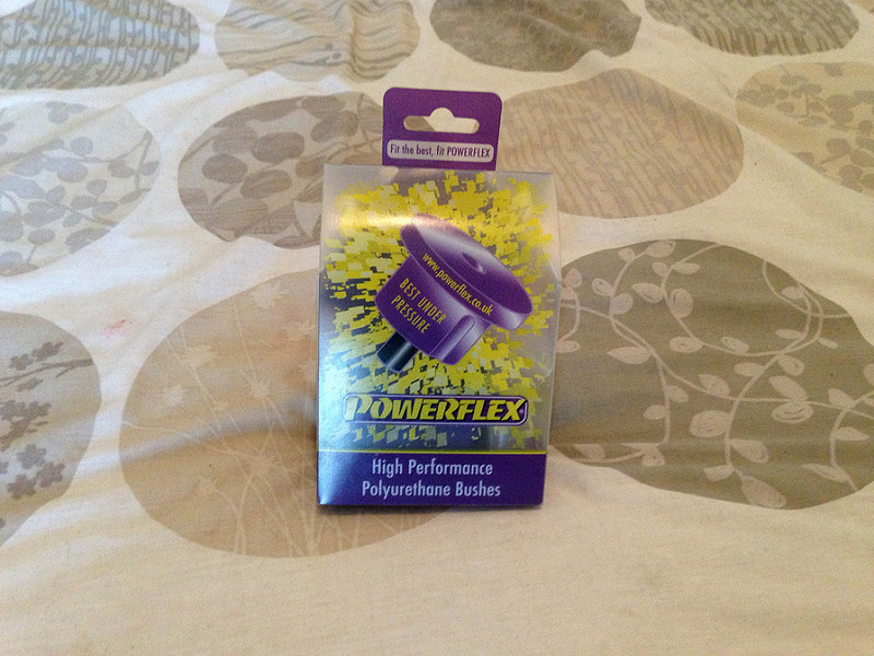

Having already purchased the powerflex wishbone bushes I decided to replace the dogbone mount as it was beginning to wear so ordered a powerflex bush for that from a forum member.
Powerflex Dogbone by Lawro1988, on Flickr

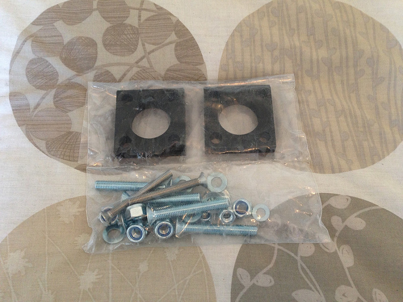

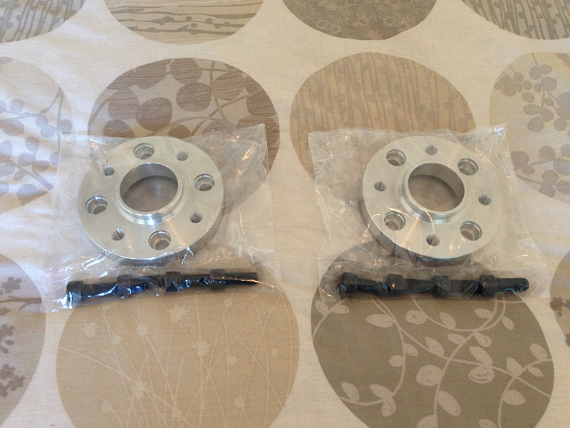

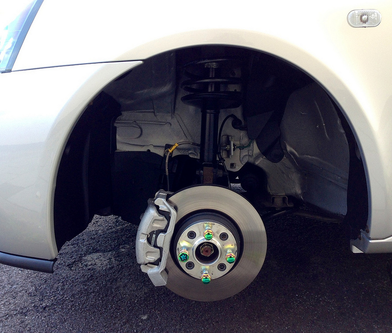

With the Cooksport’s fitted it was immediately noticeable how lost the cup wheels looked in the arches, especially with a touch of camber on the front end. After a fair bit of research I decided on some 15mm bolt to hub spacers for the rear and 20mm hubcentric spacers for the front. These were purchased from Dan at M.A.D, really pleased with the quality.
Hubcentric Front Spacers by Lawro1988, on Flickr
Rear Hub Spacers by Lawro1988, on Flickr

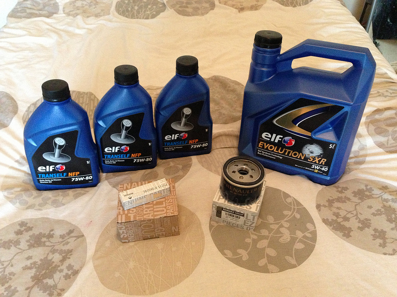

Finally a good service. I purchased some Elf Evolution 5w40 for the engine and Elf Tranself NFP 75w-80 for the gearbox along with some new spark plugs, oil filter & sump washer again from Adam @ Wolverhampton Renault.
182 Service by Lawro1988, on Flickr
With all the parts together I dropped the car off to Leighton @ Pro Garage to have everything fitted along with a fresh MOT.

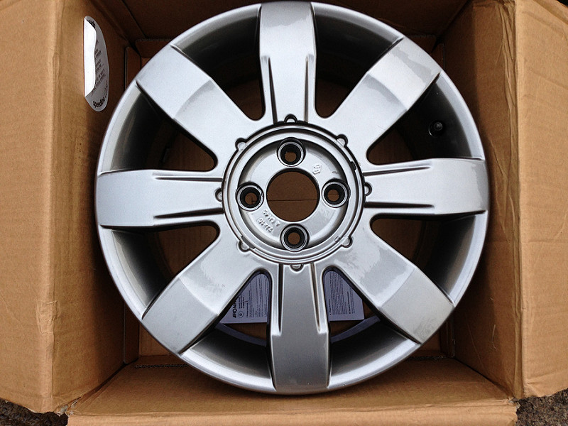

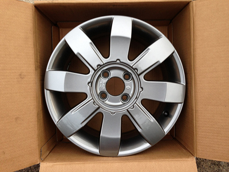

Finally the wheels.. After months of debating on whether to keep the cup
wheels or purchase something different I decided to keep the cup wheels and have them refurbished as they were beginning to look a little tired from stone chips and bedded brake dust. I had them blasted and fully refurbished inside and out in standard cup ‘205-110’ anthracite.
Cup Wheels by Lawro1988, on Flickr

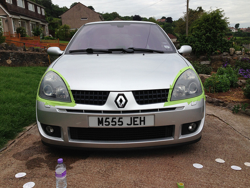

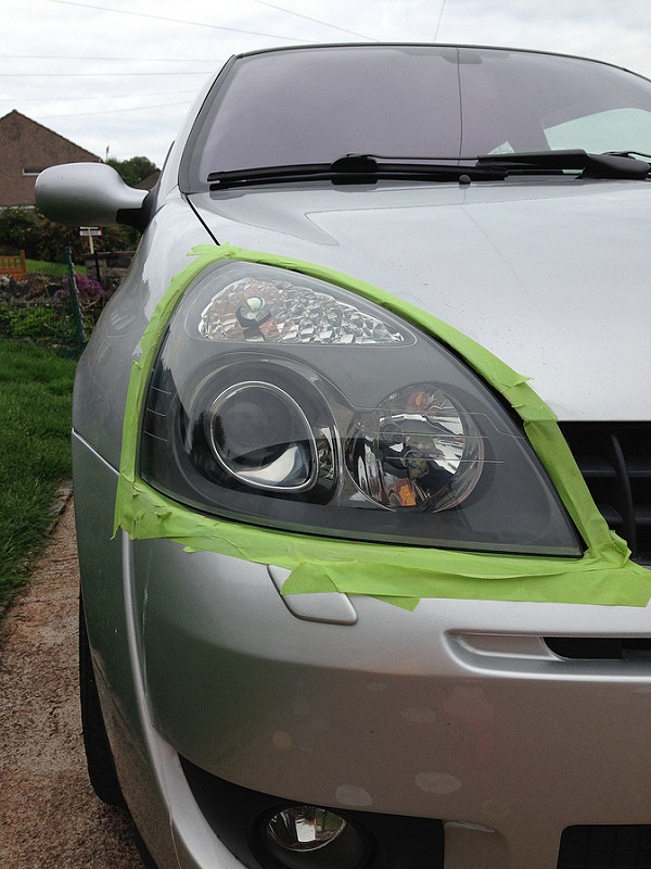

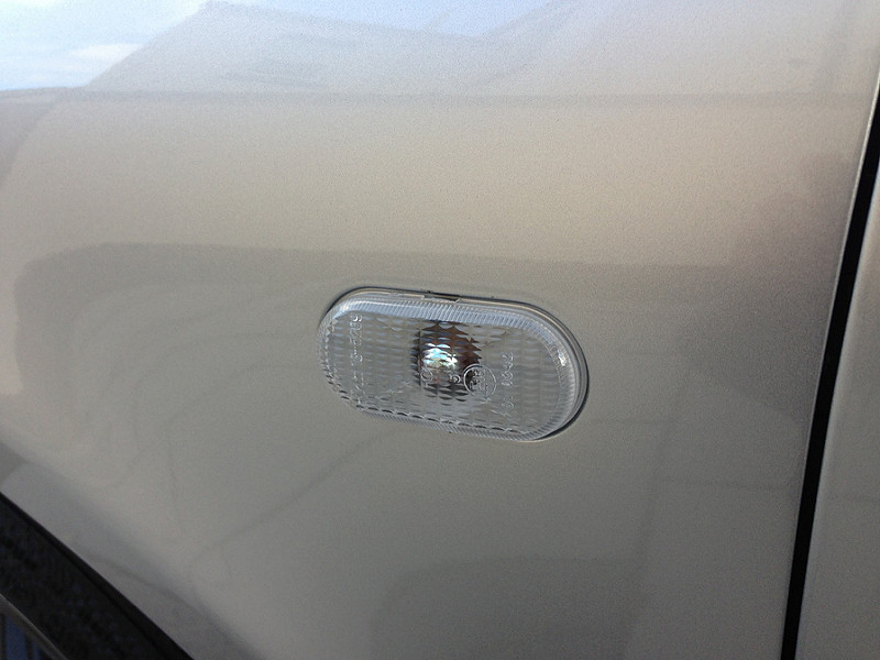

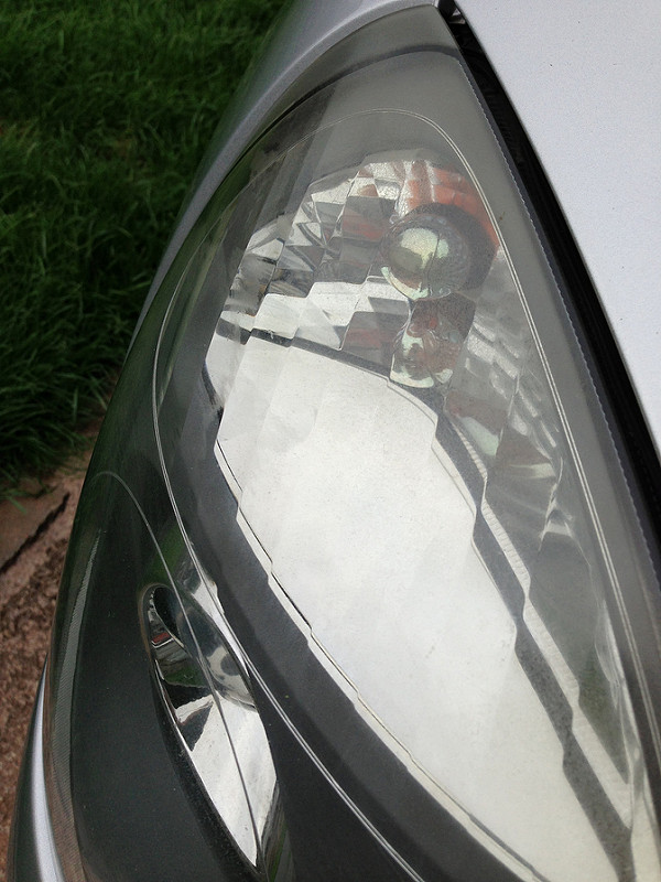

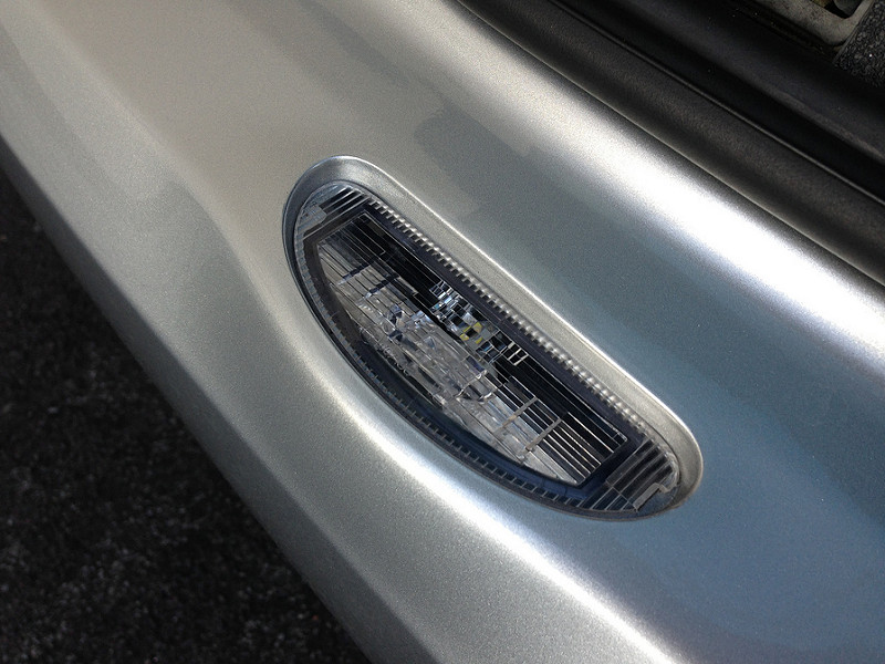

With the car collected from James @ Restomod I gave the headlights a full correction using the 3M Headlight Restoration kit, replaced the rear number plate light with a new unit along with an LED Bulb and replaced the side repeaters along with some silvertec bulbs.
Headlights previously by Lawro1988, on Flickr
Taped up by Lawro1988, on Flickr
During Restoration by Lawro1988, on Flickr
Completed by Lawro1988, on Flickr
Side Repeaters by Lawro1988, on Flickr
Numberplate Light by Lawro1988, on Flickr

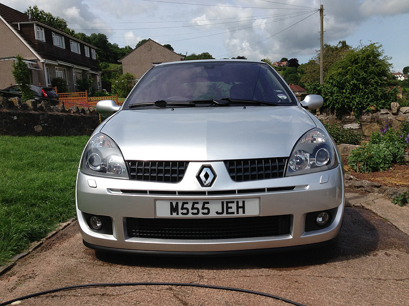

A few photos of the car on a drive out after collecting it:

Over the next few days I got the car up in the air and spent a fair amount of time cleaning and tidying up the arches and underside of the car. Cleaned with G101, treated the plastics with 303 Aerospace and exhaust with Auto Finesse Mercury.
The front and rear calipers were painted with VHT Silver paint to tidy them up and replaced a few clips on the arch liners that were damaged or missing.
Front Arches by Lawro1988, on Flickr
CookSport Springs by Lawro1988, on Flickr

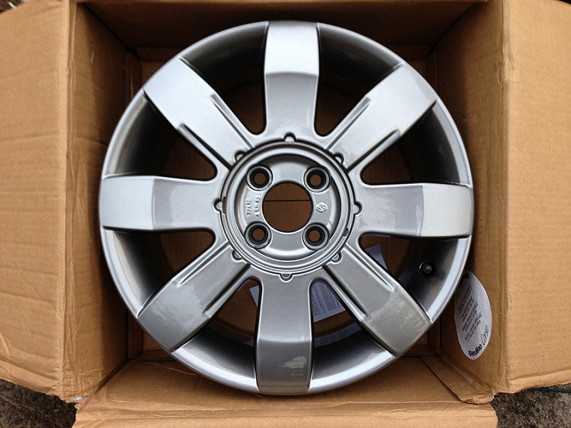

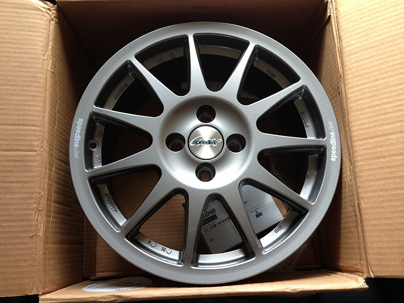

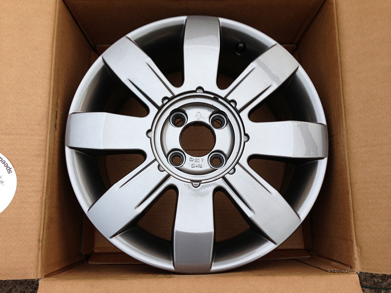

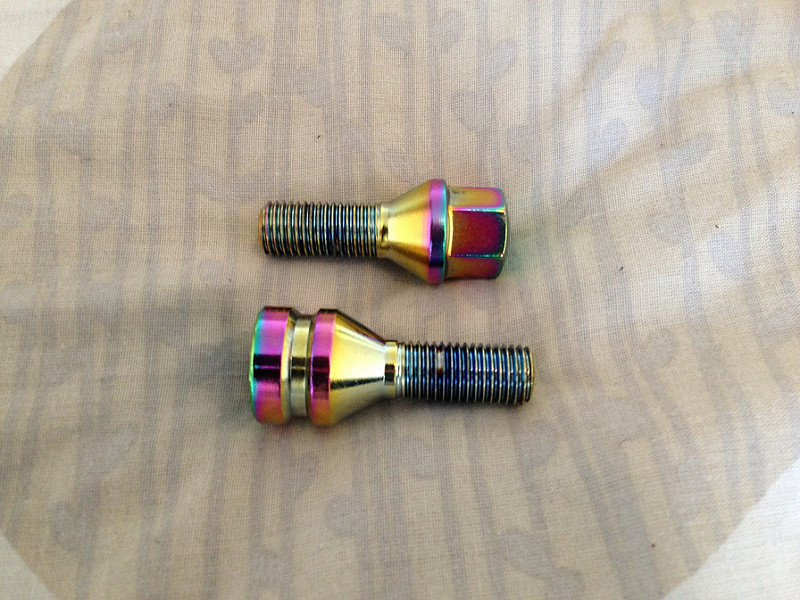

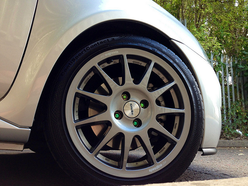

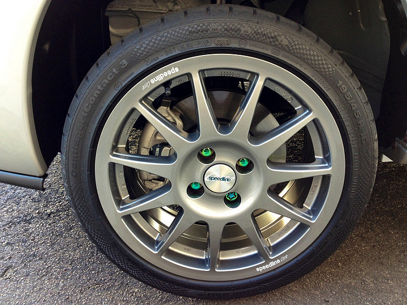

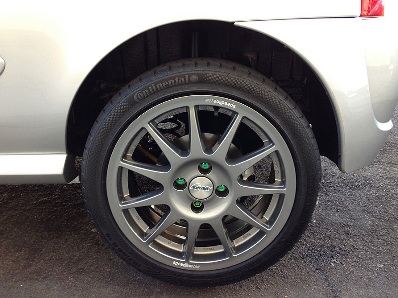

A few weeks later I had a moment of madness and after paying £240 on a wheel refurb I decided to fork out on a brand new set of Speedline Turini's along with a set of TPI polarised wheel bolts.
Speedline Turini by Lawro1988, on Flickr
TPI Polarised Bolts by Lawro1988, on Flickr
Gave them a coat of G-Techniq C5 Sealant and fitted up with a set of Continental Sport Contact 3's.
Speedline Turini's fitted by Lawro1988, on Flickr

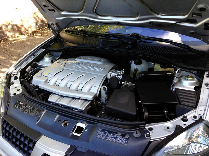

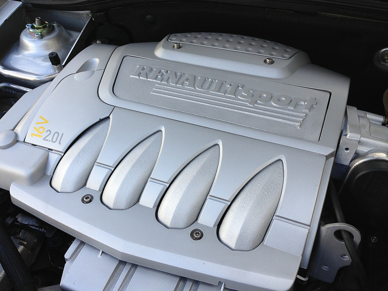

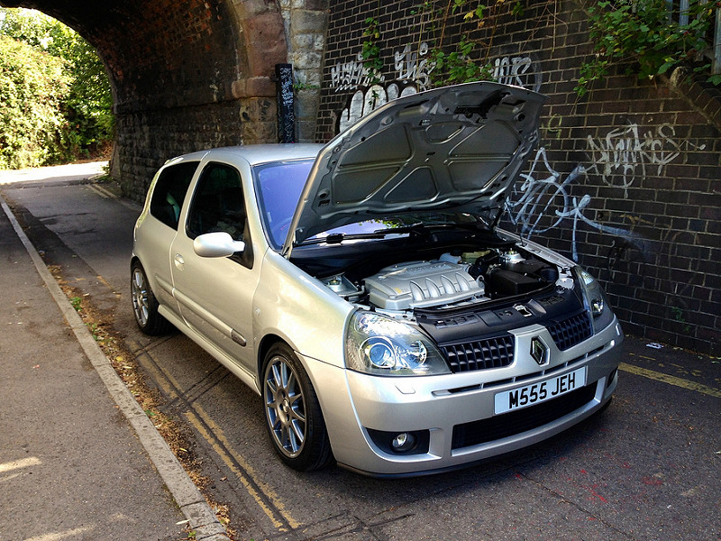

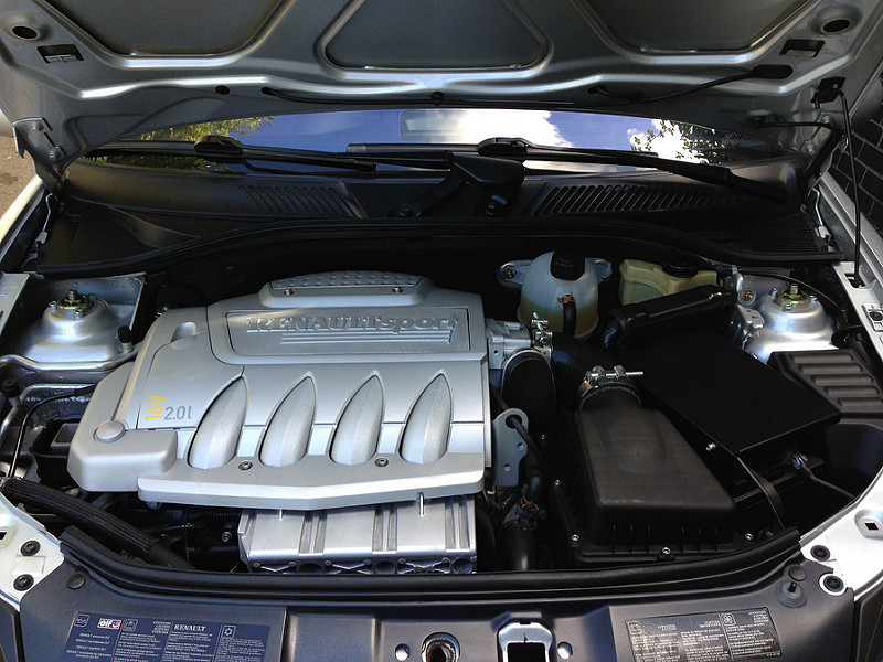

I then decided to clean up the engine bay as it was really letting the car down. Unfortunately I don't have any photos of it before, safe to say it was awful! The previous owner painted the inlets with tipex or similar and it was just generally a mess.

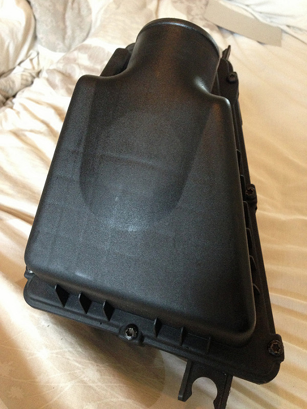

I started off with the inlets and got myself some 519 Automotive matched inlets from a forum member. Coated those in Silver along with the fuel rail guard, throttle body and engine mount bracket.
I replaced the JMS V6 style airbox that came on the car for a standard tidy 182 airbox as I think they look a lot better. Replaced the hose with a Silicone item and the filter with an ITG panel.
Powdercoated Inlets by Lawro1988, on Flickr

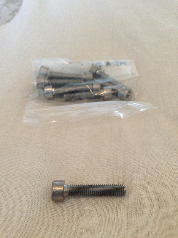

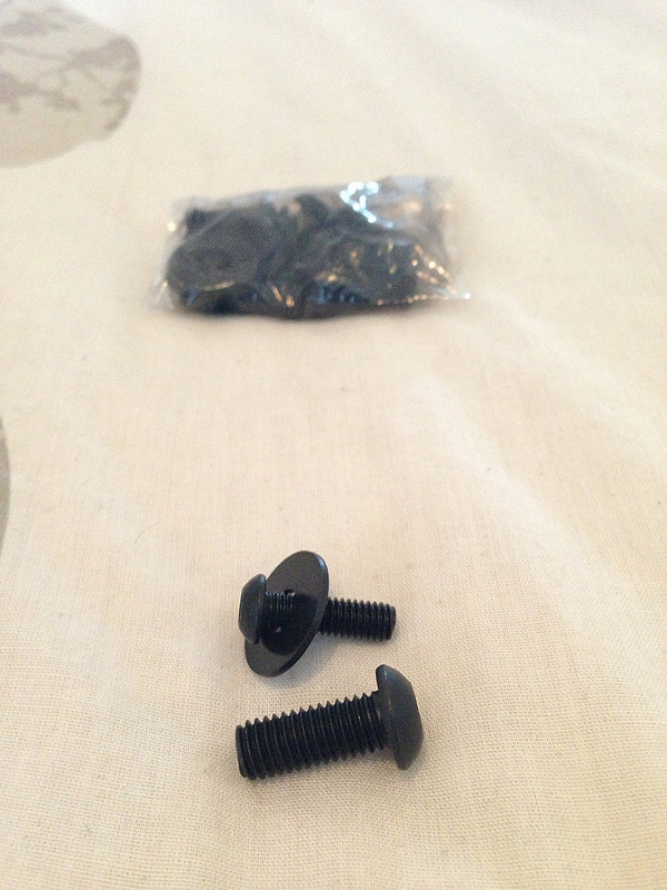

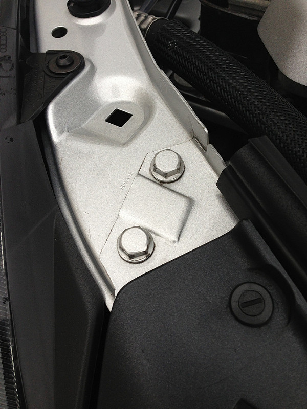

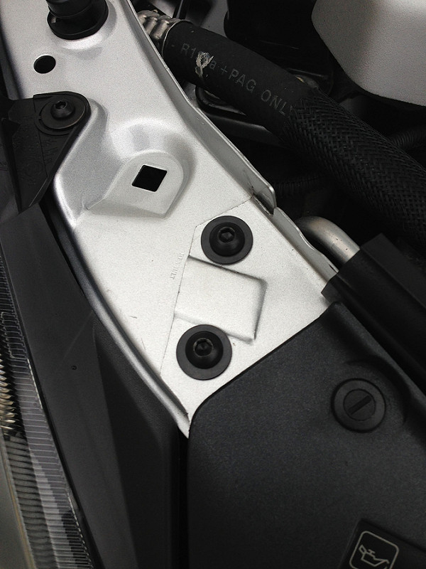

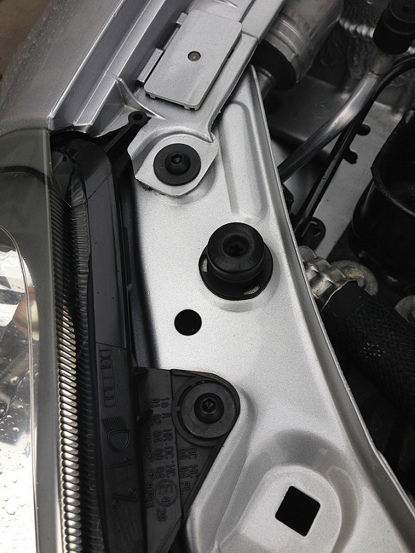

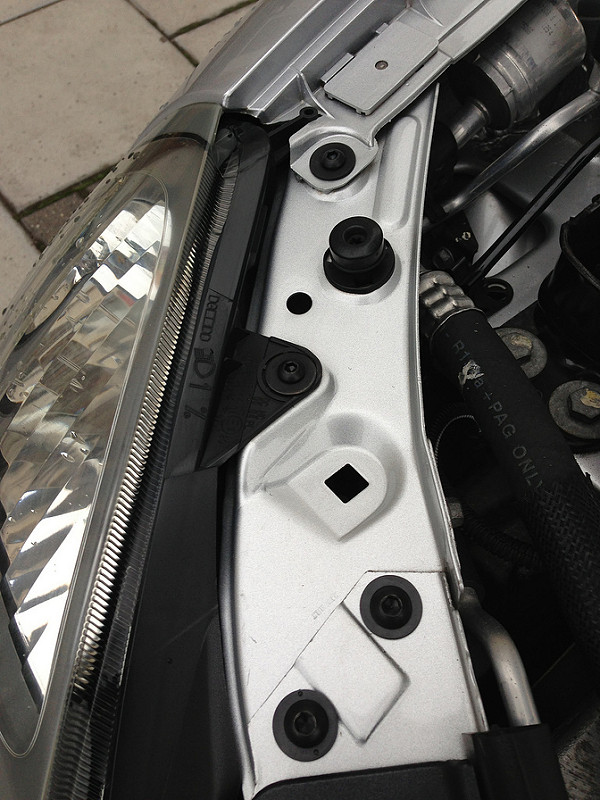

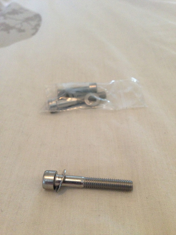

I then decided to replace all the bolts with stainless items. I replaced the slam panel, headlight and wing bolts with stainless black items and the airbox, fuel rail and engine cover with stainless steel bolts.
Stainless Airbox bolts by Lawro1988, on Flickr
Stainless Engine bolts by Lawro1988, on Flickr
Headlight/Slampanel bolts by Lawro1988, on Flickr
Before:
Before by Lawro1988, on Flickr
After:
After by Lawro1988, on Flickr
Before:
After:
Complete:
Complete by Lawro1988, on Flickr
Before:
After:
Engine Cover by Lawro1988, on Flickr

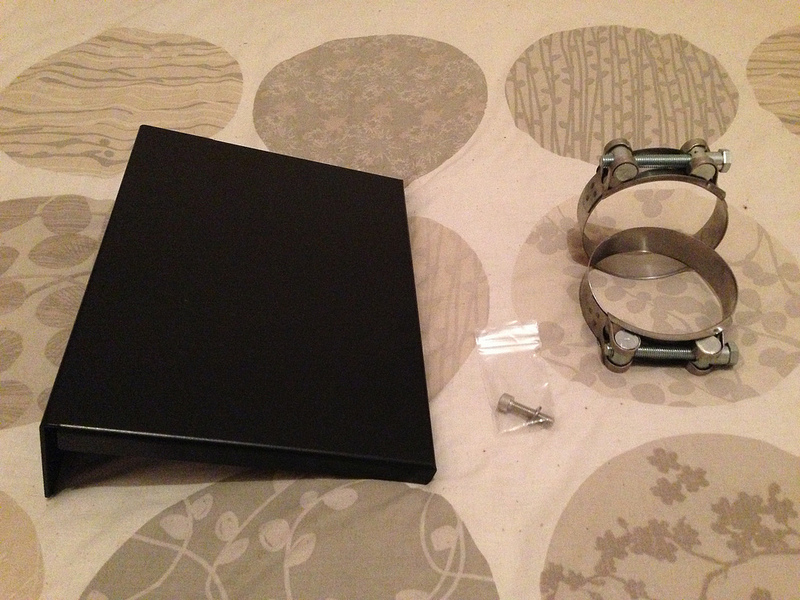

I then purchased a powdercoated black battery cover from Dan @ M.A.D, again lovely quality and some nice T-bolt stainless hose clamps to replace the jubilee clips.
Battery Cover by Lawro1988, on Flickr

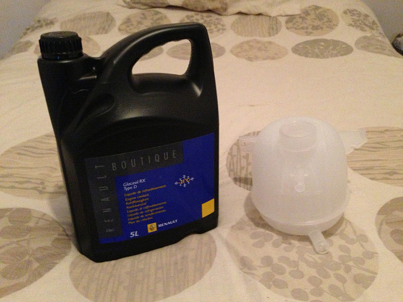

Finally, the expansion tank was replaced with a nice new item from Adam at Wolverhampton Renault along with some Type-D coolant and replaced the grill and scuttle panel clips.
Expansion tank by Lawro1988, on Flickr
Clips by Lawro1988, on Flickr
Fitted by Lawro1988, on Flickr

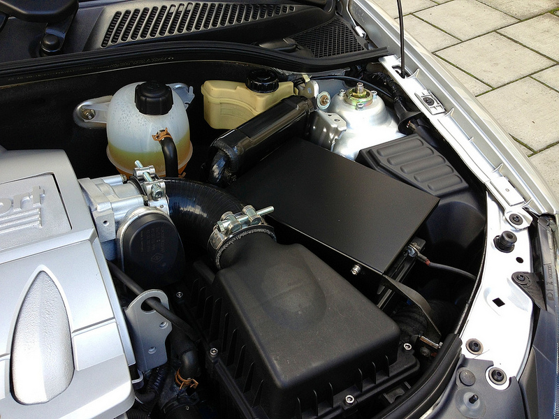

I then gave the engine bay a good clean, polished the air con pipes with Auto Finesse Mercury, treated the plastics with 303 Aerospace and deep cleaned the bay with G101 and some Swissvax fabric cleaner.

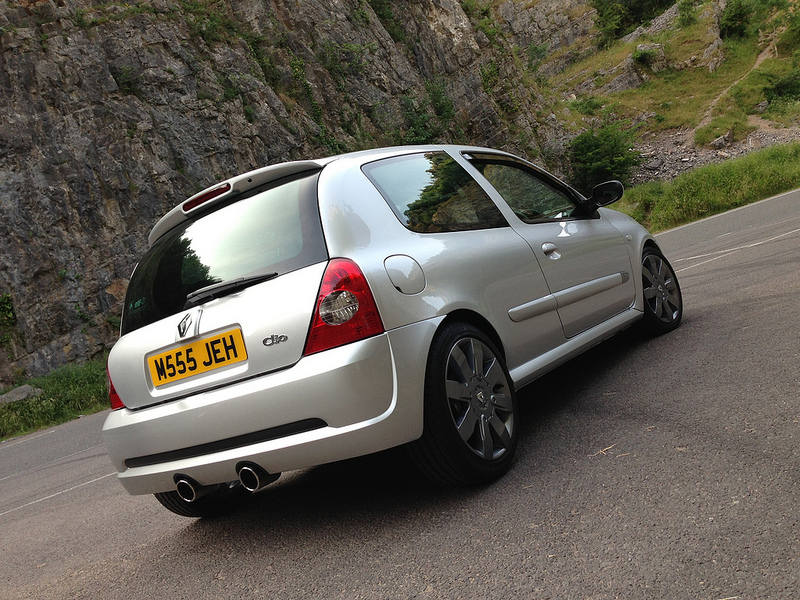

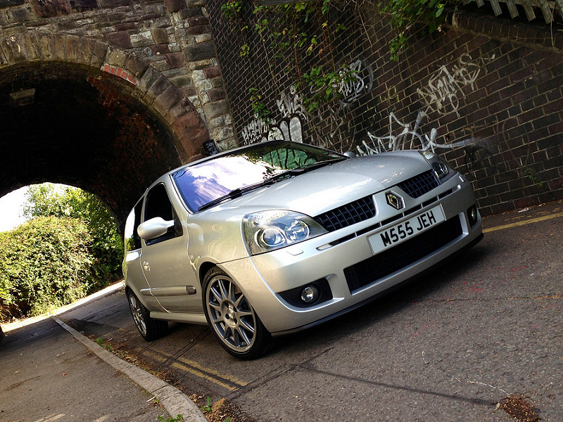

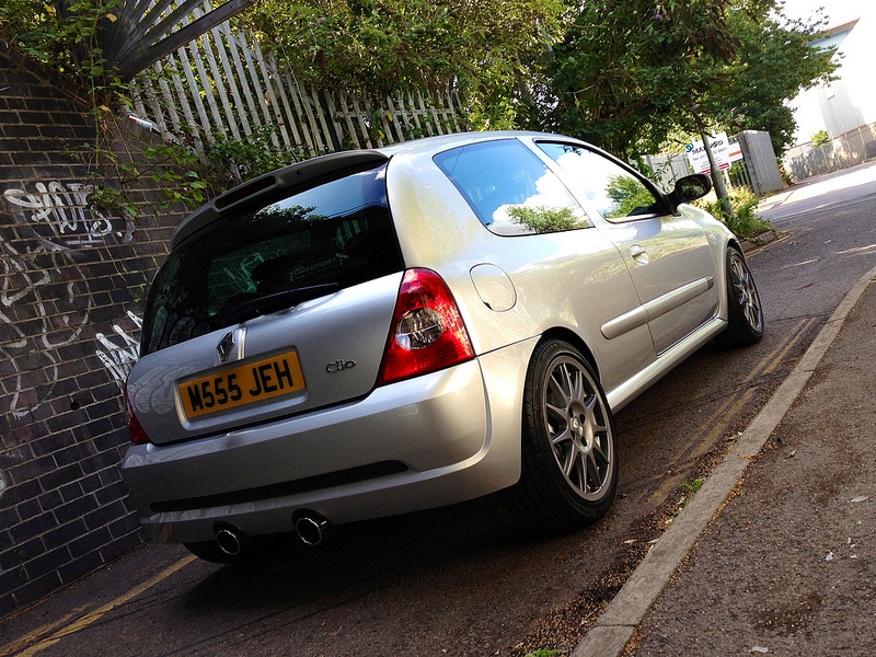

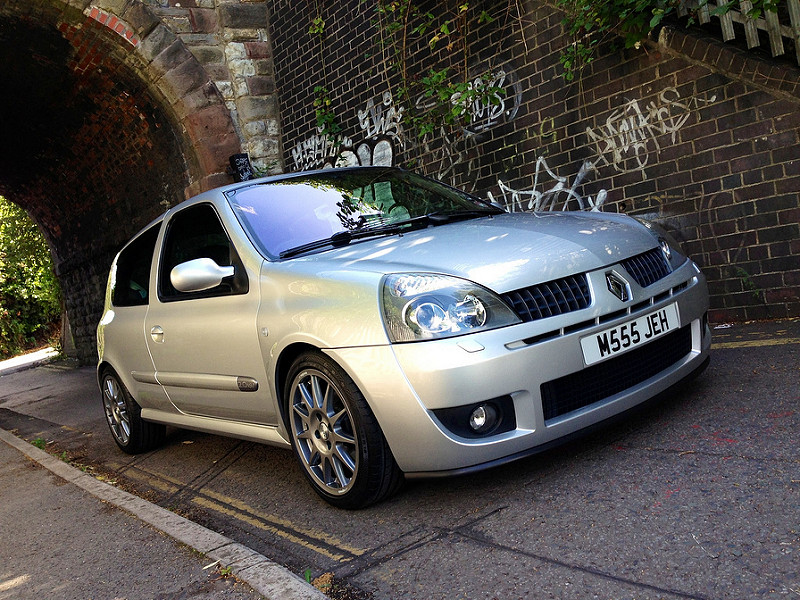

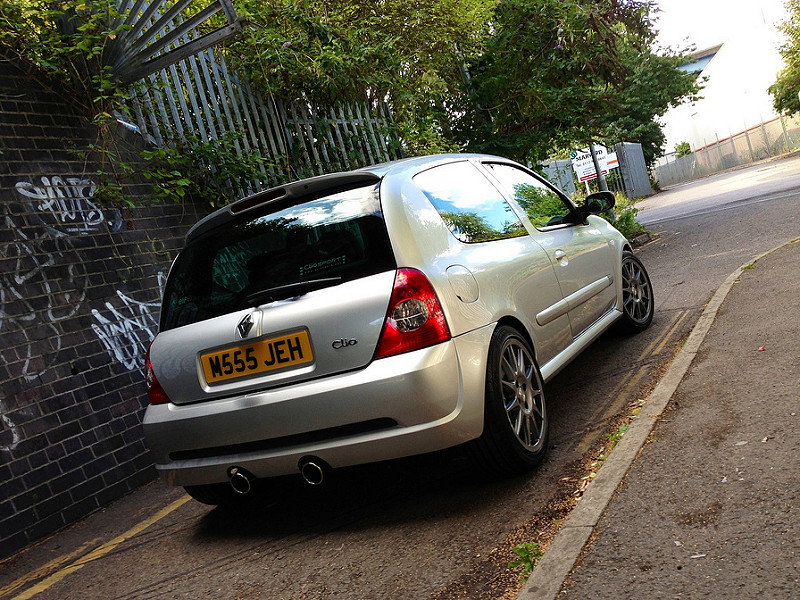

A few photos of how it currently stands after a quick detail this weekend:
Thanks for reading, More to come.. Lawro :cool:

I take it the satin black on the disks just rubs off?
Thanks! Yeah, the coating will be worn off the faces pretty quickly and just leaves the hub and outer edges of the discs protected against corrosion. Nothing worse than rusty discs ;)
Real tidy car mate, lots of hours spent no doubt.
Out if interest, I like the idea of coating the discs, what type of satin paint did you use, VHT?

Nothing short of incredible, love the shots up at Cheddar gorge!

Lol, I was trying to think where I had been this year. Thanks buddy!
Thanks mate, yeah lots of man hours involved but it's worth it in the long run.
I had mine powdercoated in Satin Black but I couldn't see any real issue with painting them with VHT paint, how long it would last though I'm not sure.
