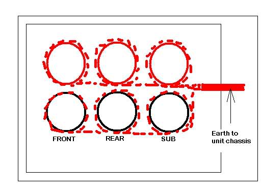

You will now need to earth the RCA plugs outer sleeves to the head units chassis,(i usually use the head units rear support screw location), this fix should solve most cases, but on occasion it can be necasary to also earth the head units mounting cage to the cars chassis....
Head Unit RCA pic
