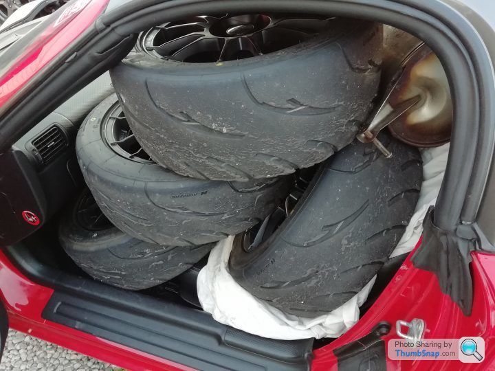

As mentoned I'd go with a second set of wheels with dedicated track rubber like AR1's. You can fit a spare set of wheels (and exhaust) in there even with the passenger seat in situ :LOL:
Dicky Belly 3
I'm really surprised by that, looks like there's far more room in yours there than mine. I have a fixed bucket seat in mine though whereas that looks like the standard seat slid backmaybe?
