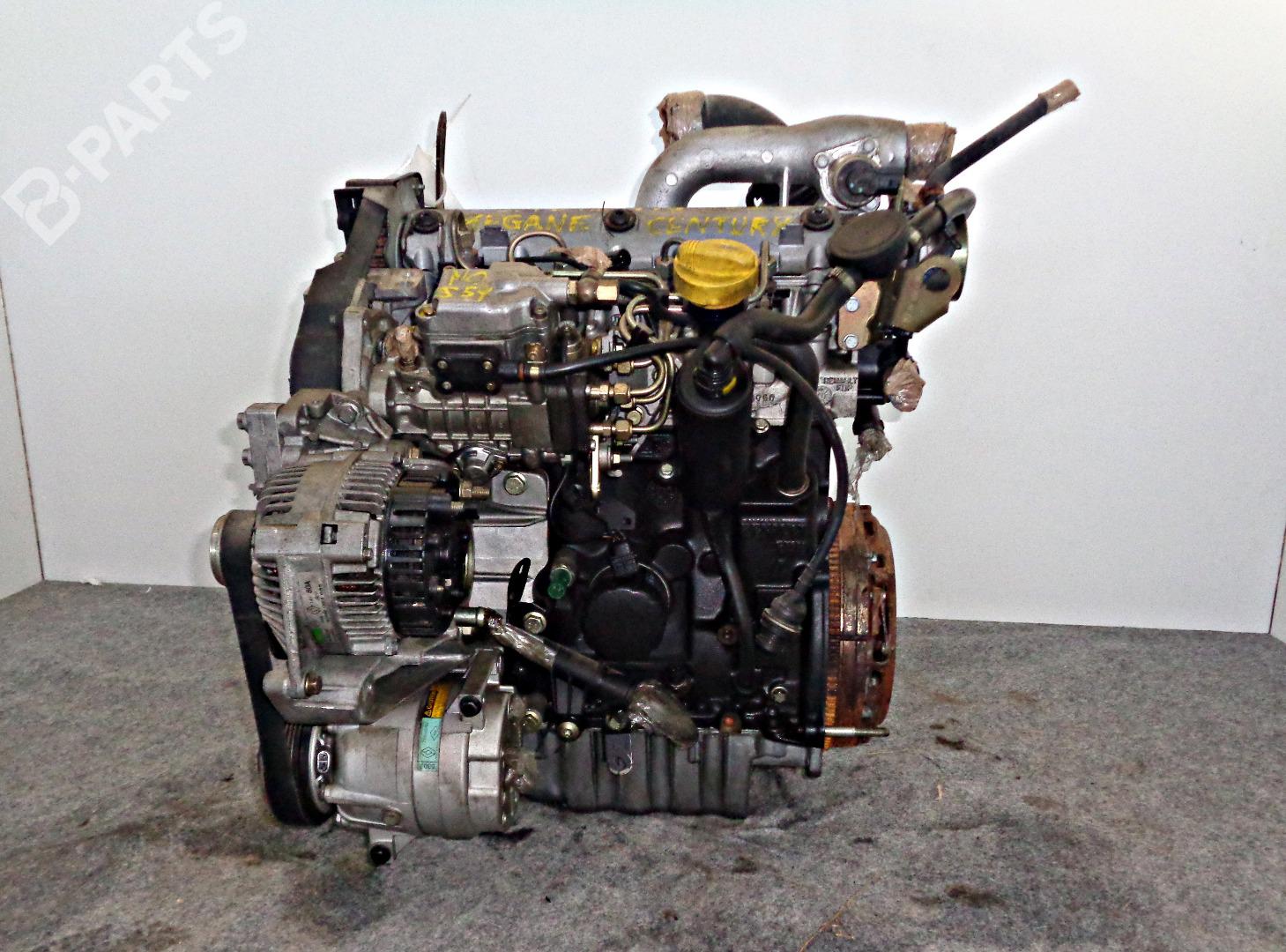

U Usr117063 Mar 17, 2021 #1 I swear someone was talking about this but I cant find it now. Its from a laguna dci or something, aircon pump with alternator and no pas pump.

YorkshireKyle Not all gingers stink of piss. But I do. ClioSport Club Member Car 535d & Monaco 172 Mar 17, 2021 #2 The old 1.9 dTi Renaults and 1.7 Petrol Volvos had them

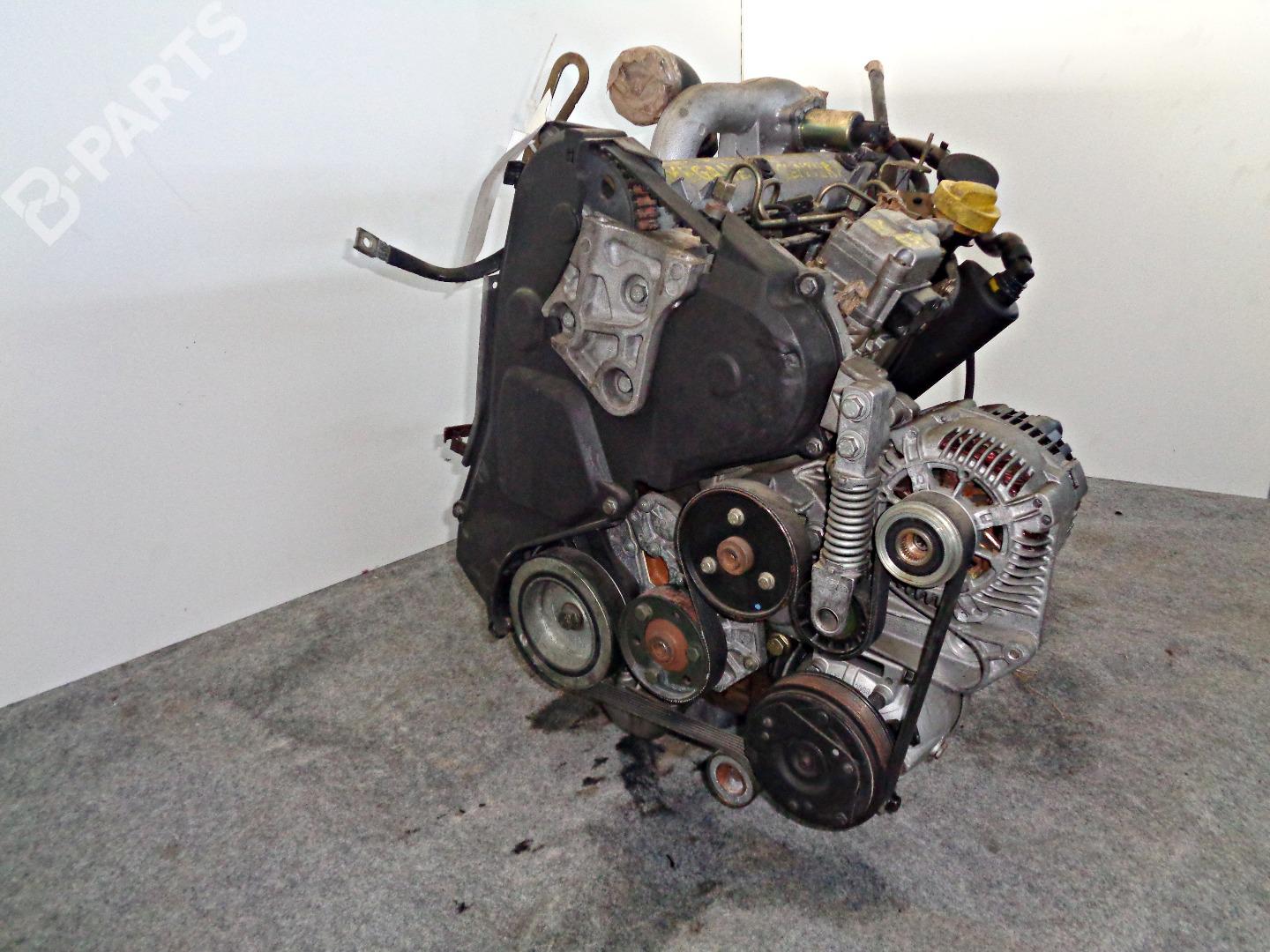

U Usr117063 Mar 17, 2021 #4 Is it this setup and you dont have to run the pas pump? Because this has a pas pump and aircon, looks way neater than whats on the 182

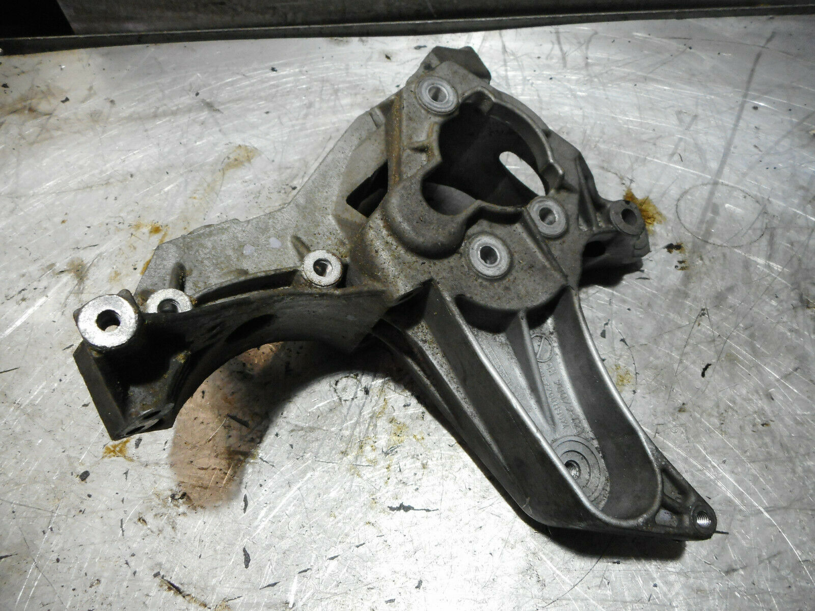

YorkshireKyle Not all gingers stink of piss. But I do. ClioSport Club Member Car 535d & Monaco 172 Mar 17, 2021 #5 Aye you can use that one but there's one where the alternator and AC pump have a separate mount Uts a triangle upper one and a square lower

Brigsy ClioSport Club Member Car T.Turbo Mar 17, 2021 #6 Traffic diesel bracket bolts up to f4r, can retain alternator and a/c. Can use megane 225 aux belt tensioner.
