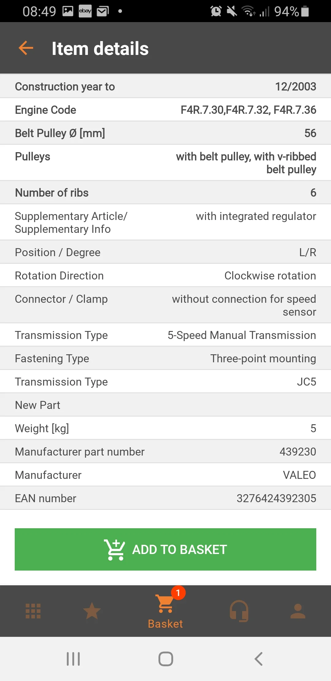

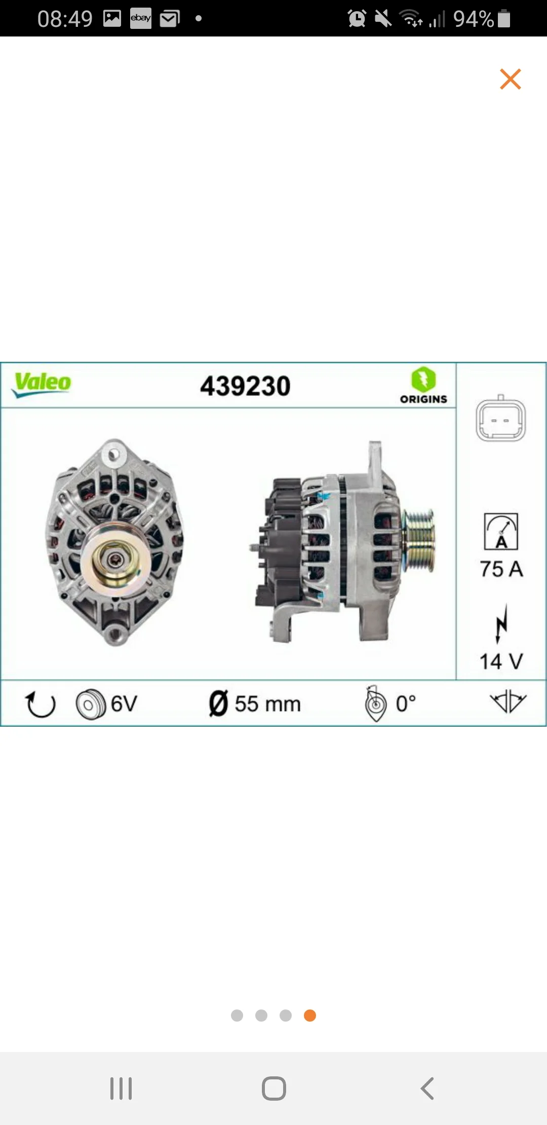

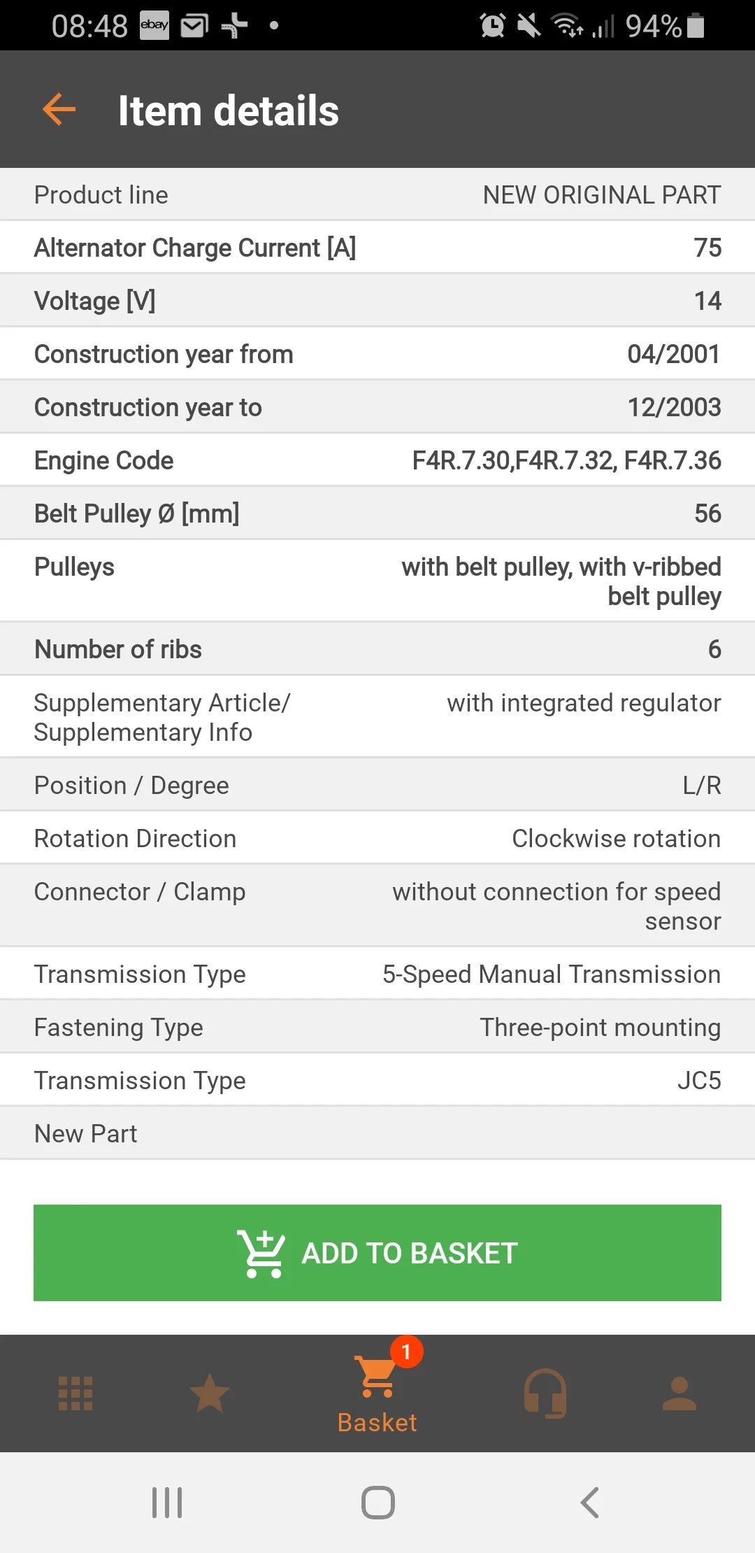

I have seen i can get a cup one fron RPD.
Does anyone know if this is the cup one ?
  172 Ph1
Yes that’s a cup alternator .
As it’s in-line top to bottom also it has no thread for the swing bolt .
You will need to buy a long bolt and nut to accomplish securing it to the block bracket .
75amp works fine with EPAS , just be cautious when using all the electrics at once if a road car , is it a road car or track car .
