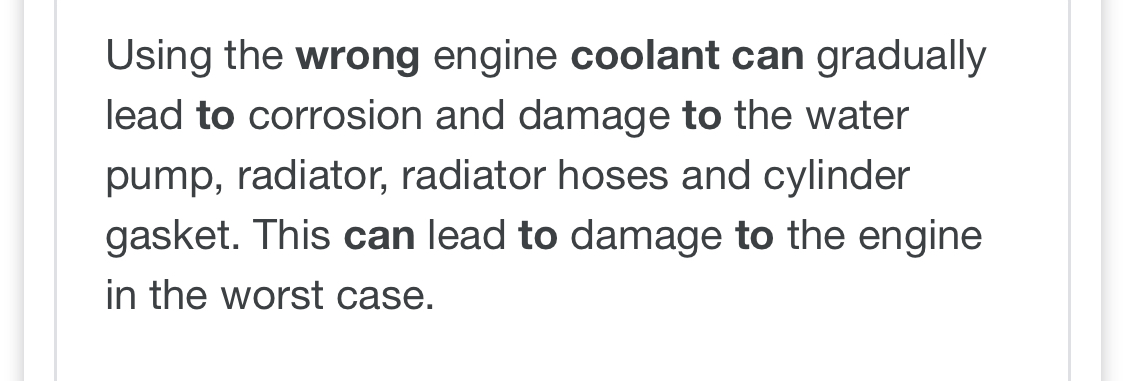

If you don’t and you fill your 172/182 with generic red coolant, it reacts badly with the OE Type D.... 🤦‍♂️

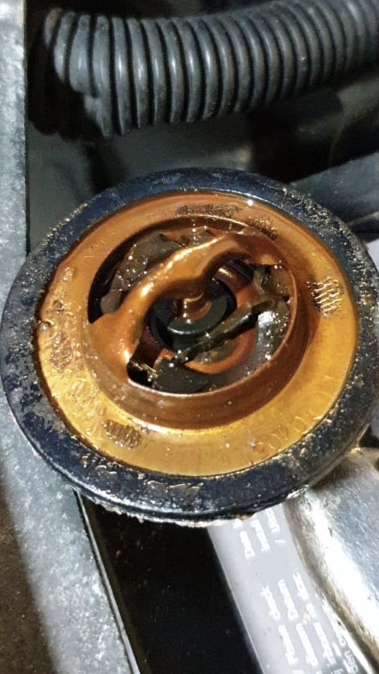

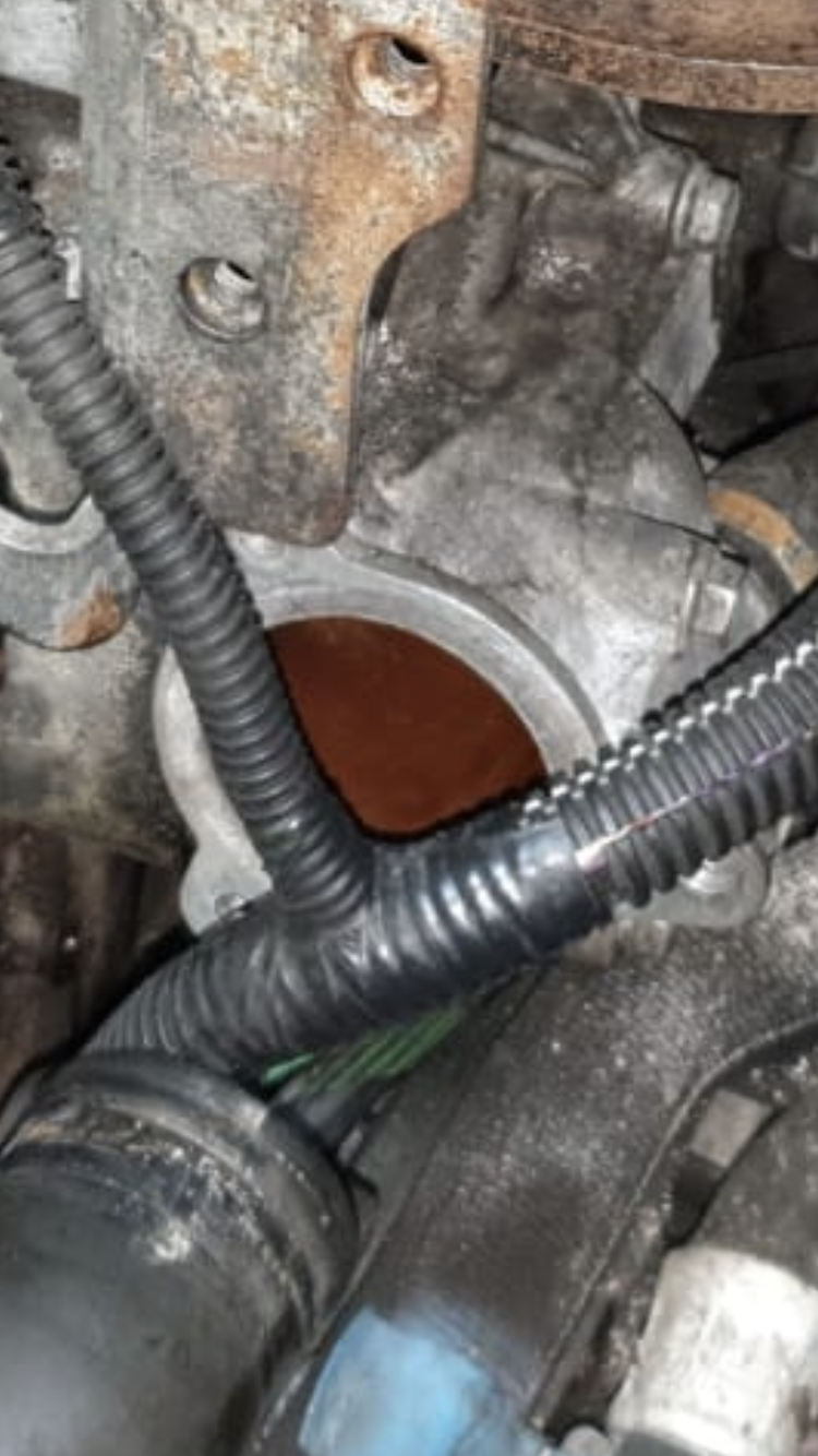

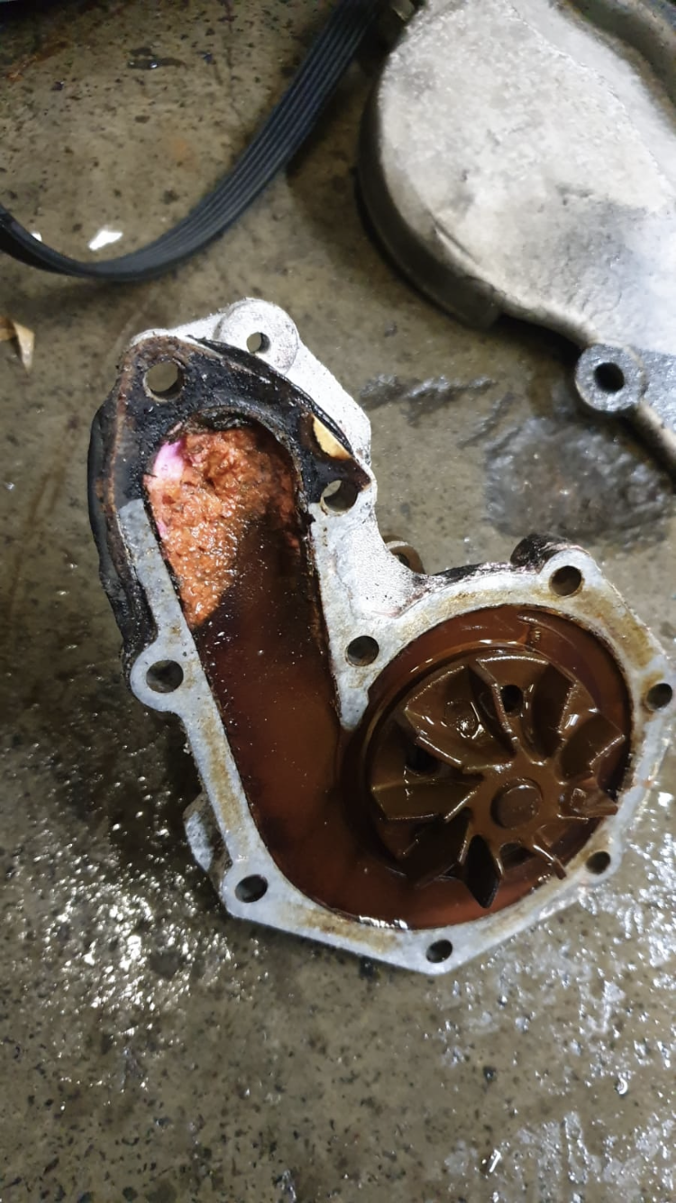

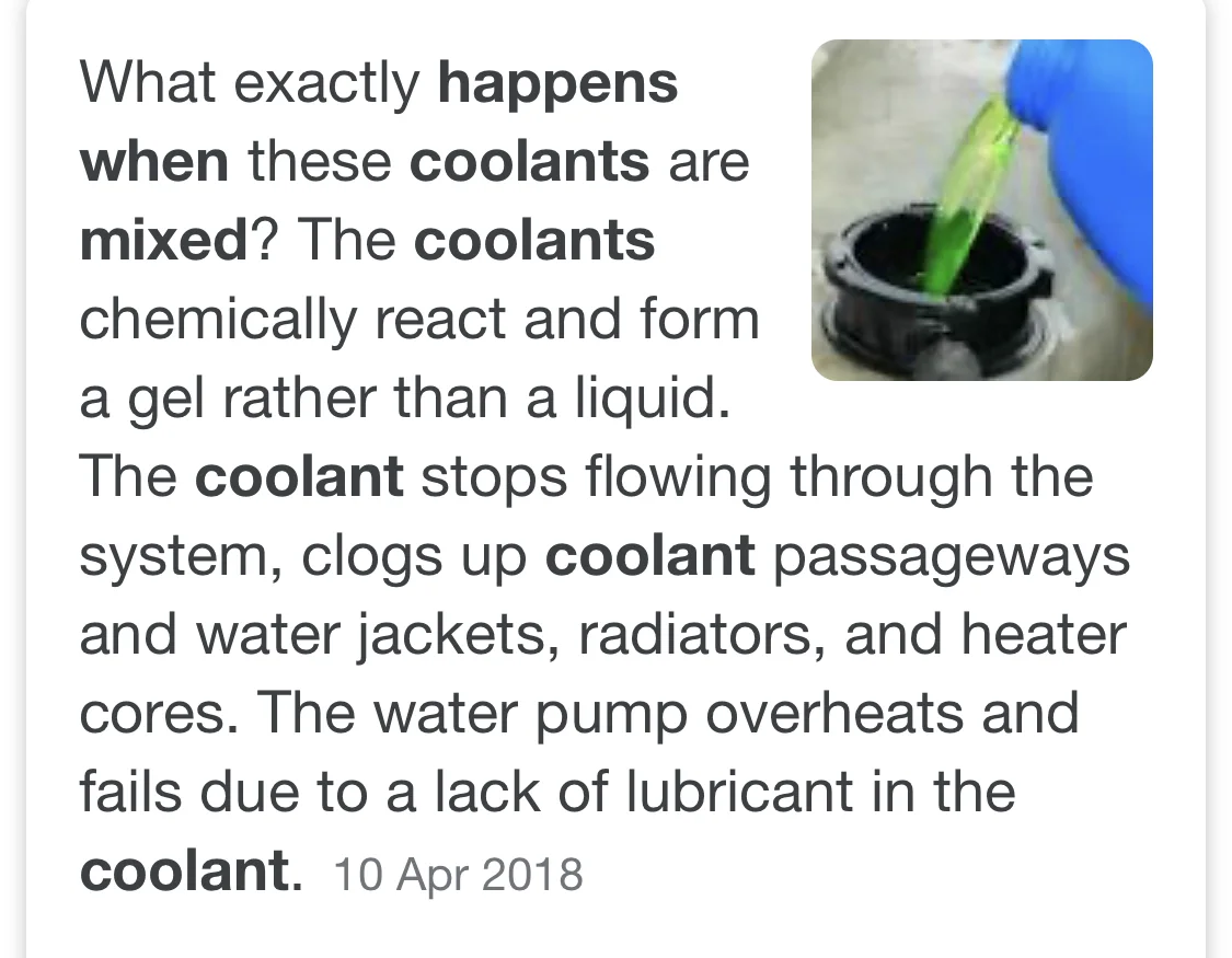

Type d is dirt cheap, no idea why somebody would substitute the cheap red cooIant for it. I know somebody who refilled their megane with red coolant without flushing the type d out properly and it blocked the heater matrix.
So it's a chemical reaction basically between the Dtype and cheap red.
Yes.
Using a different coolant is fine I’m sure, but I’d only do it if I’d flushed out every last bit of the OE stuff first. Or, save the hassle and just stick to Type D as it makes life much simpler.
