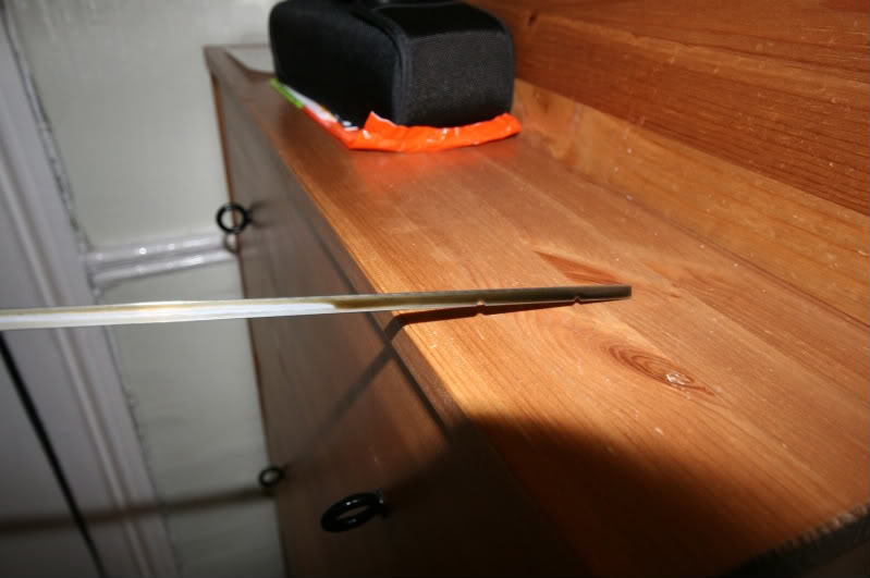

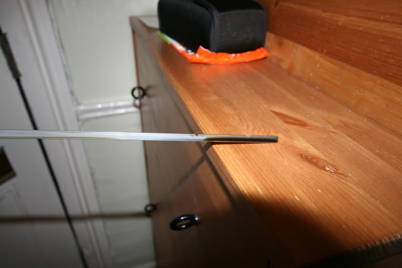

have dipped and wiped multiple times now and both sides are telling different stories. surely this is not normal or am i mad?

i think the high reading is due to oil in the dip tube from multiple dips, clean dip stick, go make a coffee, then check it

Drive it around, let it get warm and the oil well circulated park on the flat and leave it for a while... that should "reset" your dipstick tube for you. Failing that, I would use the measurement from the not so high dipstick reading, and check the digital oil level display as well...
