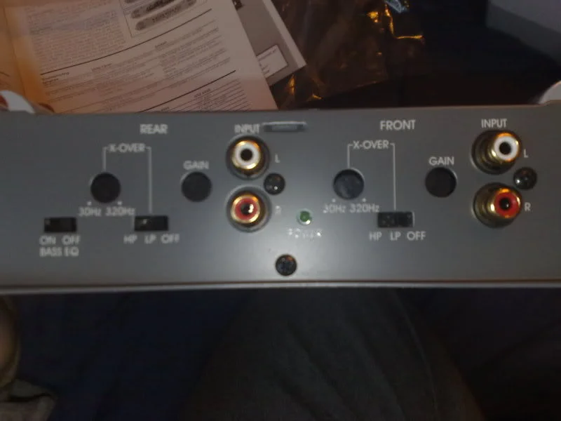

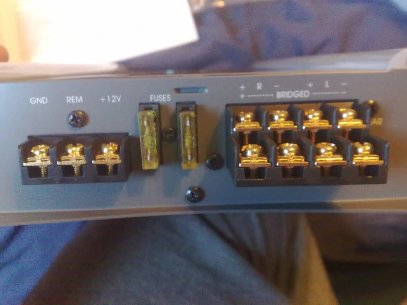

Also, quick question, where on the amp with the RCA connect to, and where will the sub connect to?
Thanks again
yeah that will work with fuses in the right places
well it's a 4 channel amp so just use the rear channels and the will be the outer connections on the rear speaker terminals
Sub Connection;
RCA Connection & base settings to start tuning from;
FILTER---LP, (Blue)
CROSSOVER FREQ---80Hz, (Green)
BASS BOOST---OFF, (Red)
GAIN---MIN, (Light Blue)
