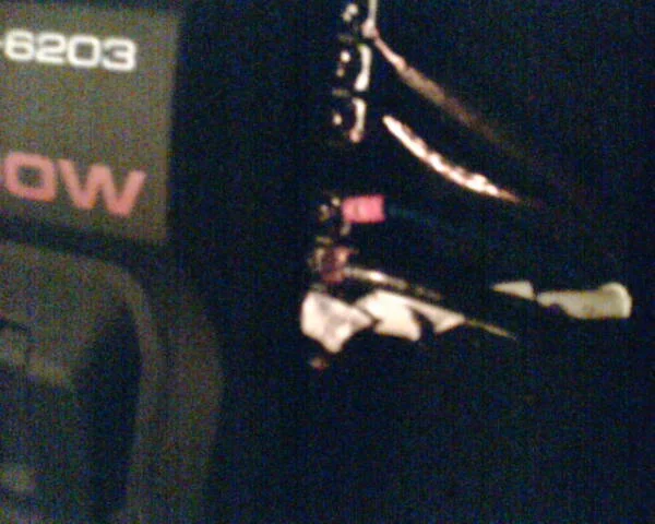

mate has been trying to get his sub and amp working in his 172
Sub and amp have worked in the previous car without problems (same wiring kit), when wiring up there was a spark, however no fuses have blown at the amp or powercable near battery
when turning on the headunit the amps power light flickers on, then goes back off, when the engine is started the light is on properly for half a second then goes out
Last night, wanted to check the wiring was all ok, so I took round an old kenwood 200 watt amp, used the same earth points and wires and the amp worked and powered his sub
wondering whether something in the amp has gone, or maybe if his cables just aren't big enough, although they were before
his amp is a kenwood 600 watt, not that old
as you can see from the crappy picture below, his earth and power cable (same size) are not that big
crap wires, or something gone in the amp?
it's earthed to the bottom of the right side of the rear seats
i'd say it's the earth point tbh

the wiring does look liek a small guage as well but I think it sounds like there might be a amp problem mate.
