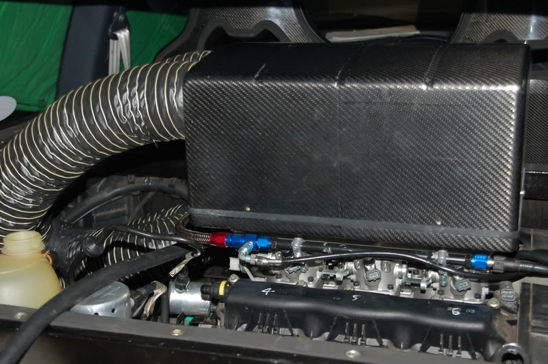

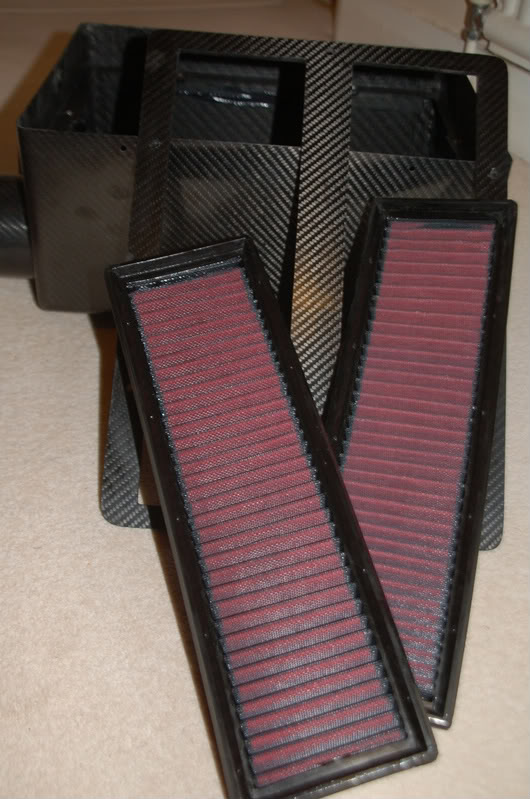

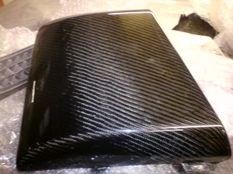

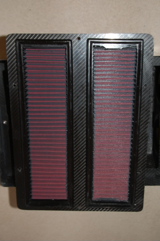

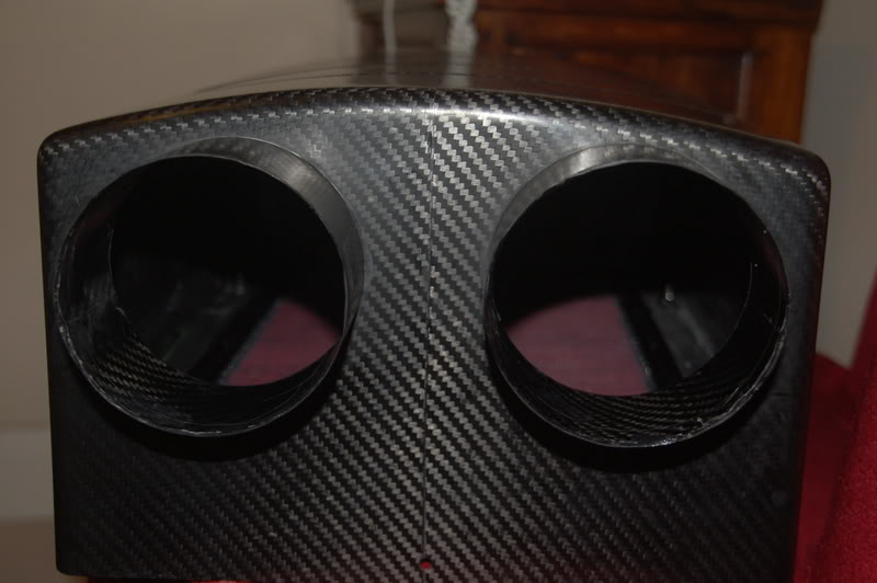

Airbox is back from Reverie, its had a custom filter tray made housing 2 x K&N pannel filters
now with twin 100mm ports (old ones were 85mm)

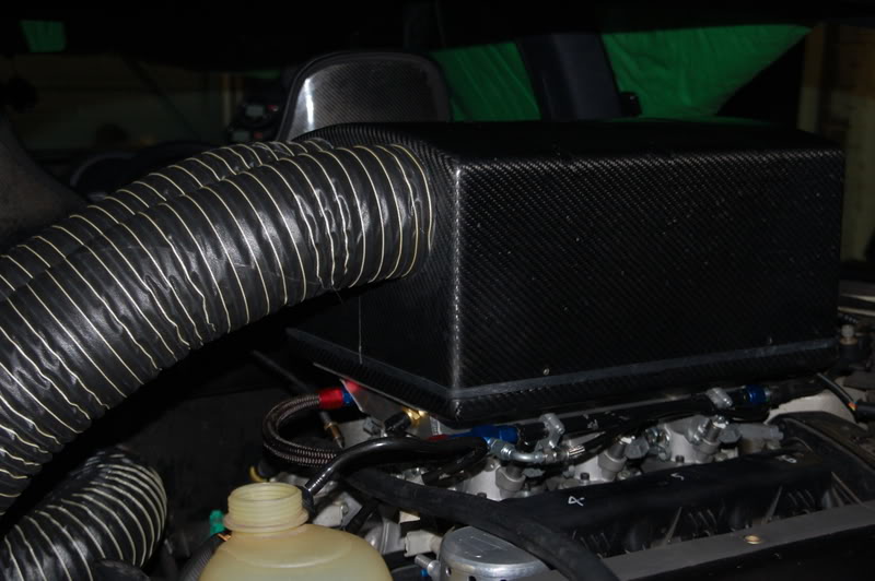

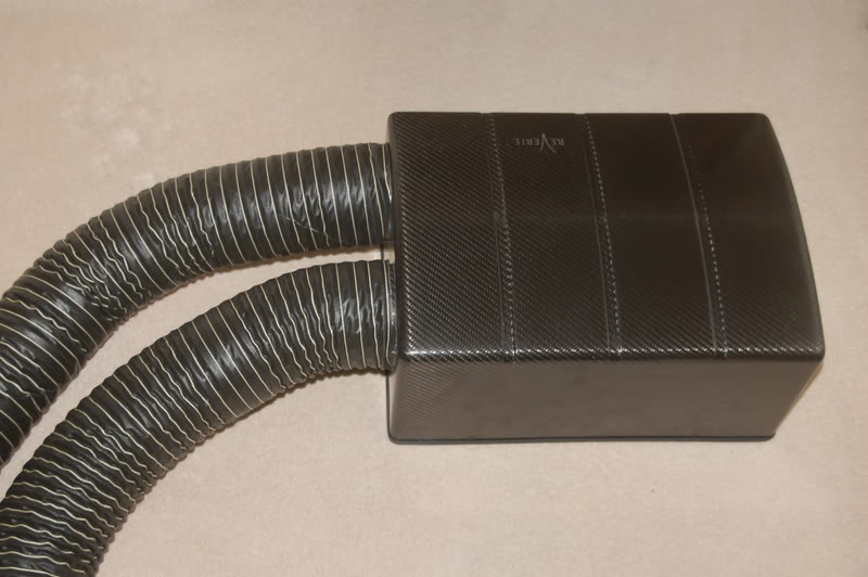

some 4inch "donkey dick" arrived from DT, apparently its safe upto 180degC

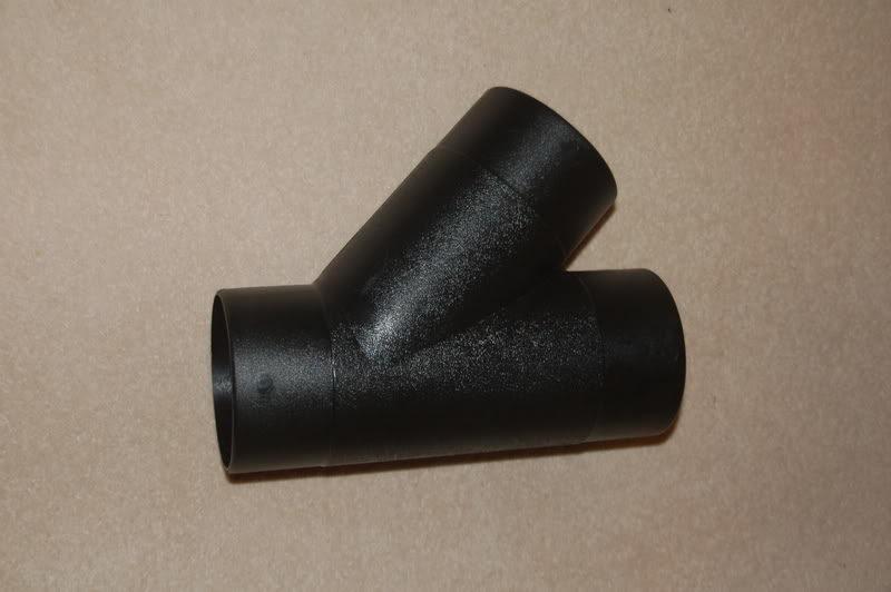

for those of you that know, the V6 only has 1 air intake behind the factory passenger side pod, it also happens to be 100mm (4inch) now my fancy airbox has twin 4inch ports
now how do you split 1 4inch feed into 2?? you can either pay for someone to fabricate a 4inch "Y" pipe or fabricate one yourself, which is what i was about to do, but by the time i buy the material, spend 2 hours cutting/welding blah blah blah it was easier to busy this
£8 from a dust extraction company!
