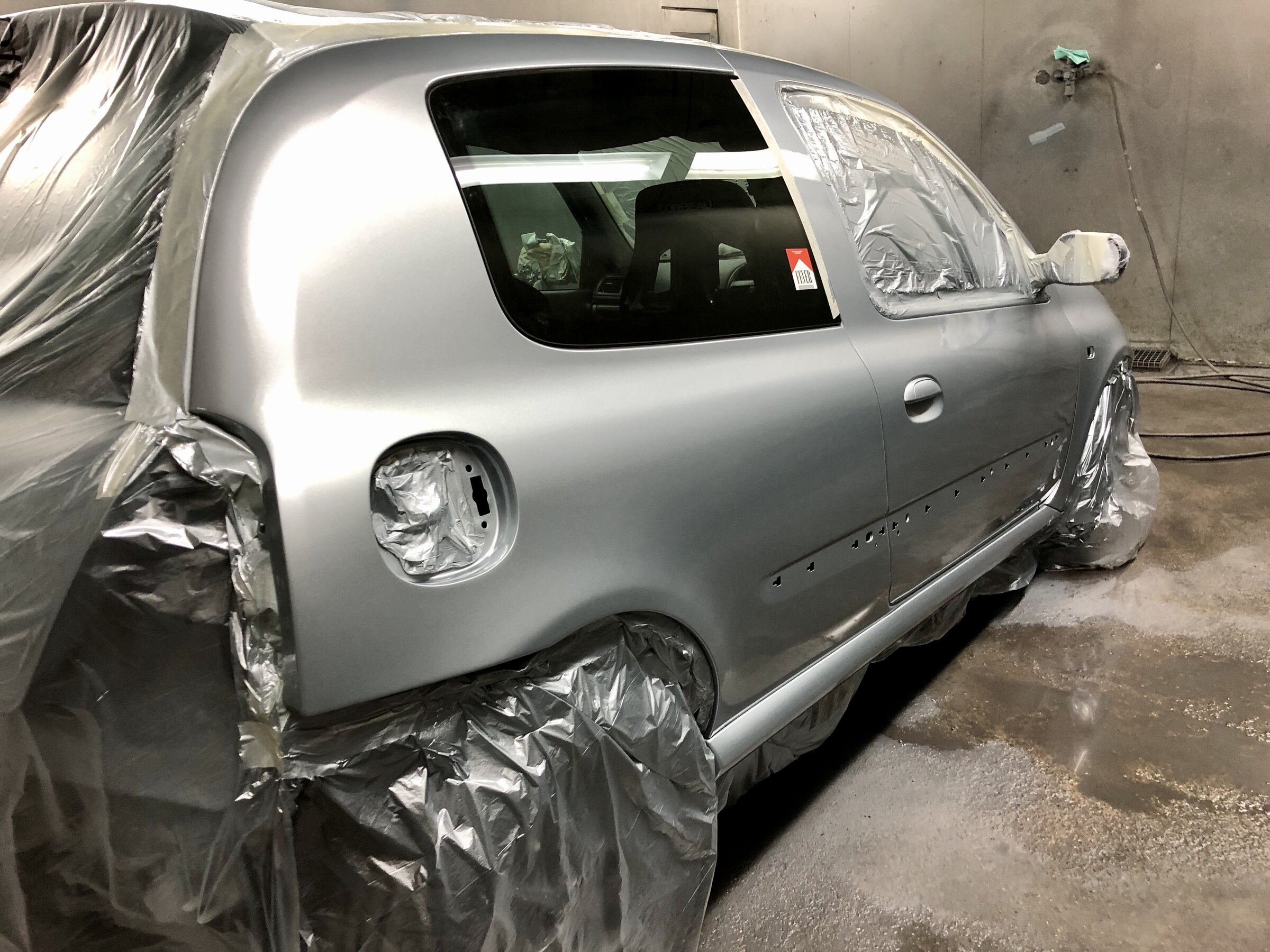

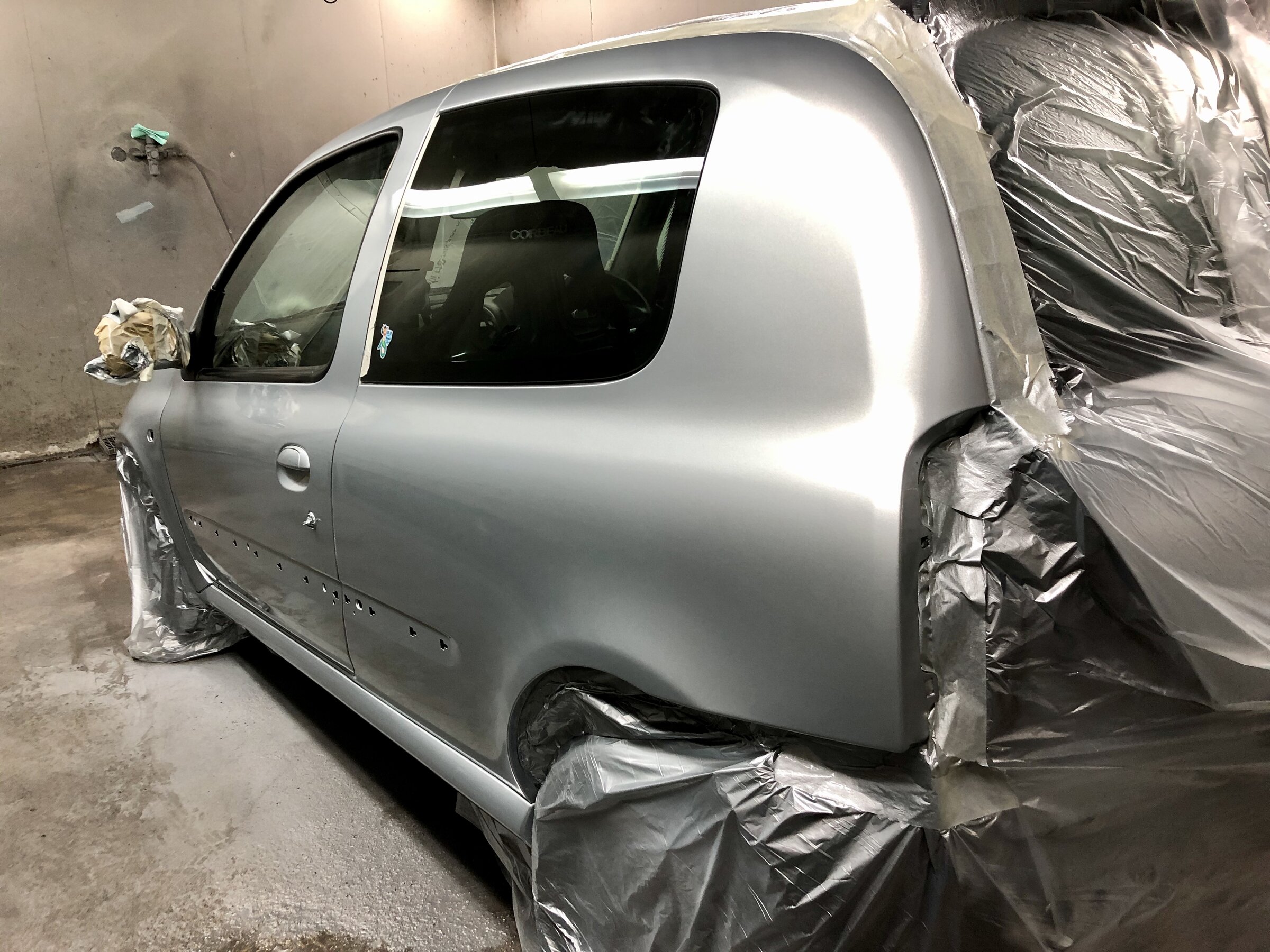

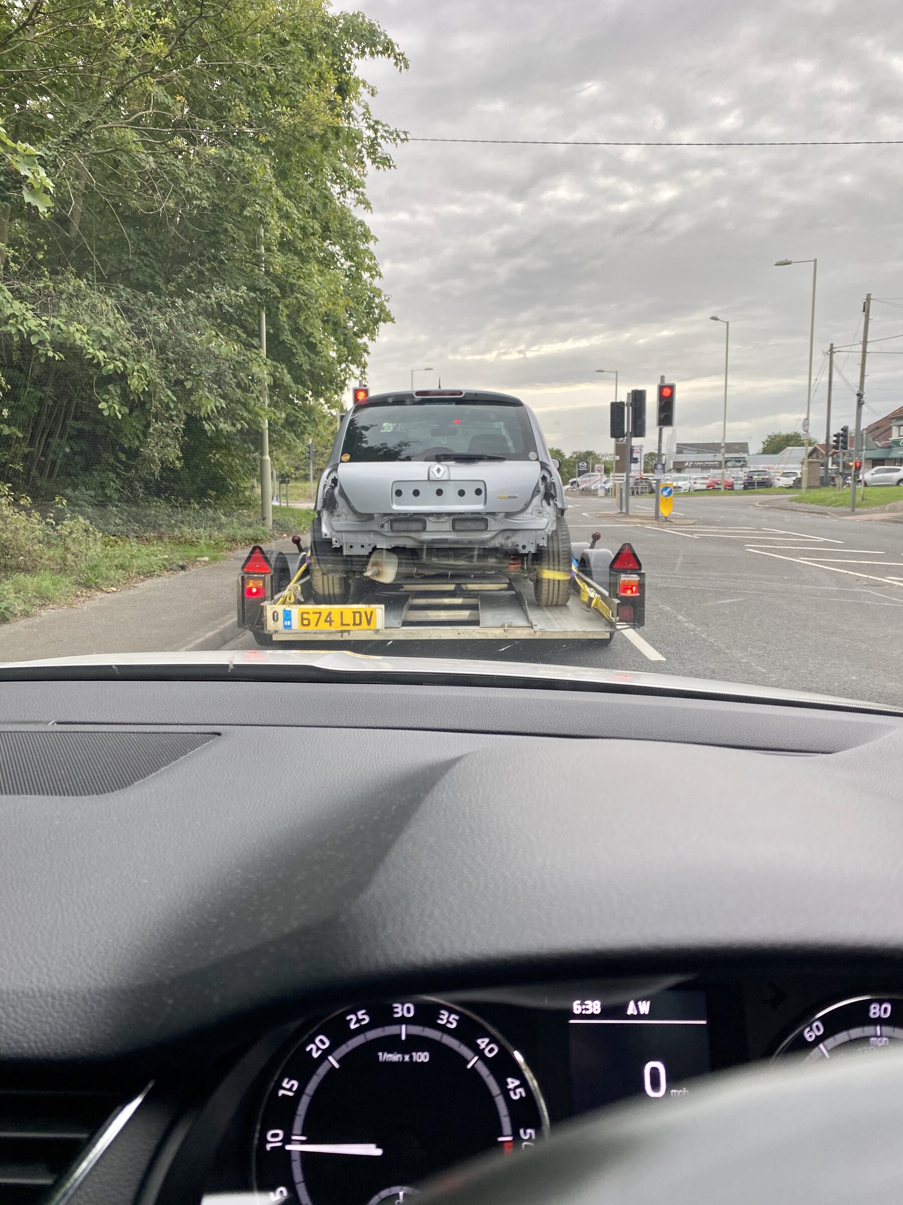

More updates from paint. Likely to be a few more days before she’s ready and looking into PPF for when it’s all done - I believe there are no templates so it’ll have to be a bulk custom job. As this ramps up the cost I need to decide whether it’s cost effective. I’ve only picked up one major chip in 10,000 miles so might be simpler to periodically have the bumper redone.
Week away in Wales took the edge off not having the car although the roads up there are begging for a roadtrip when she’s finally back!

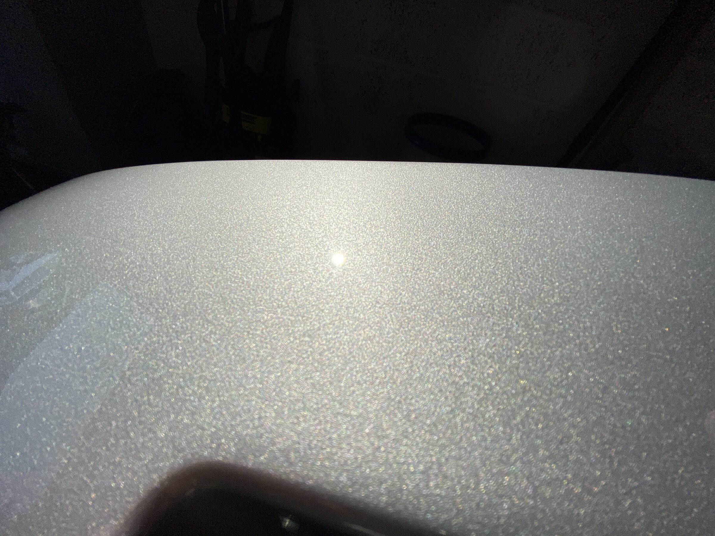

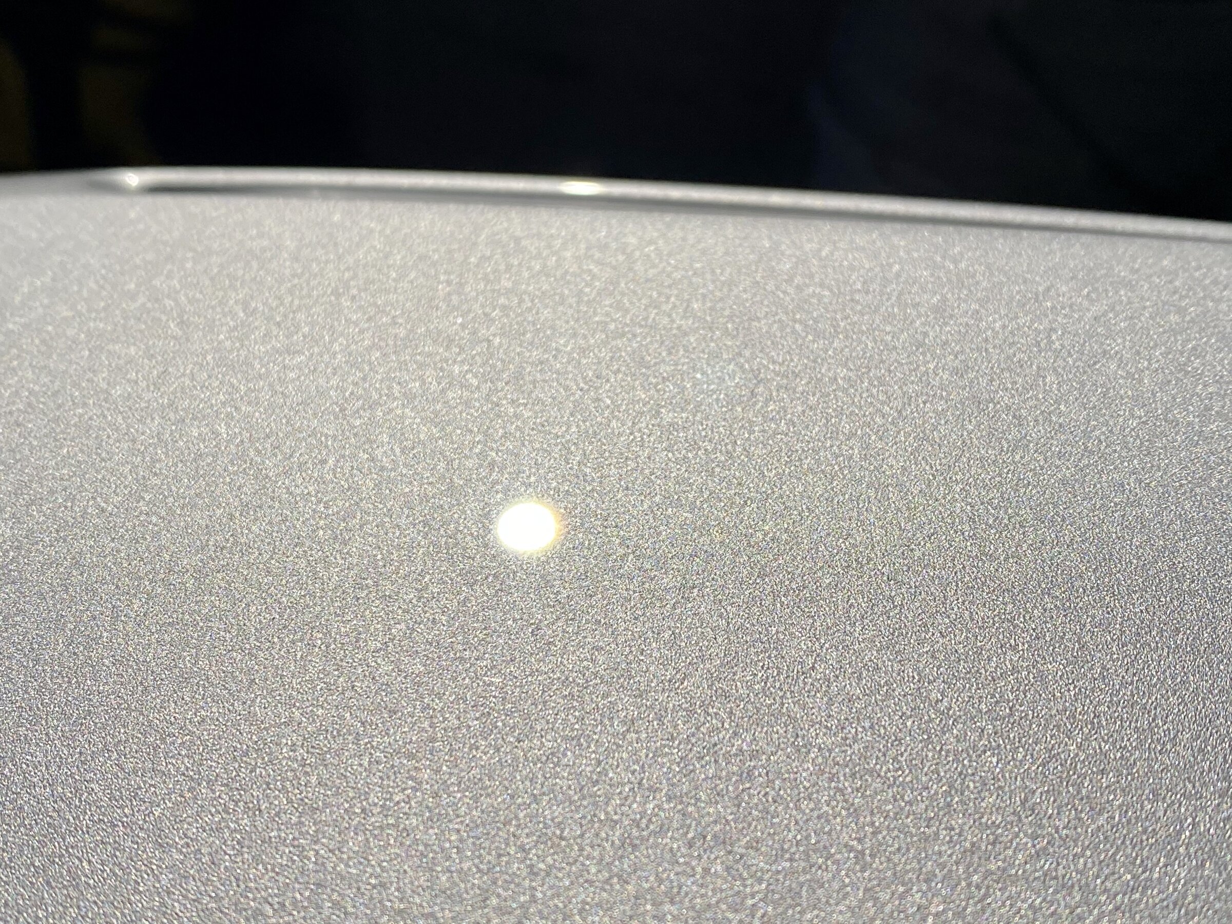

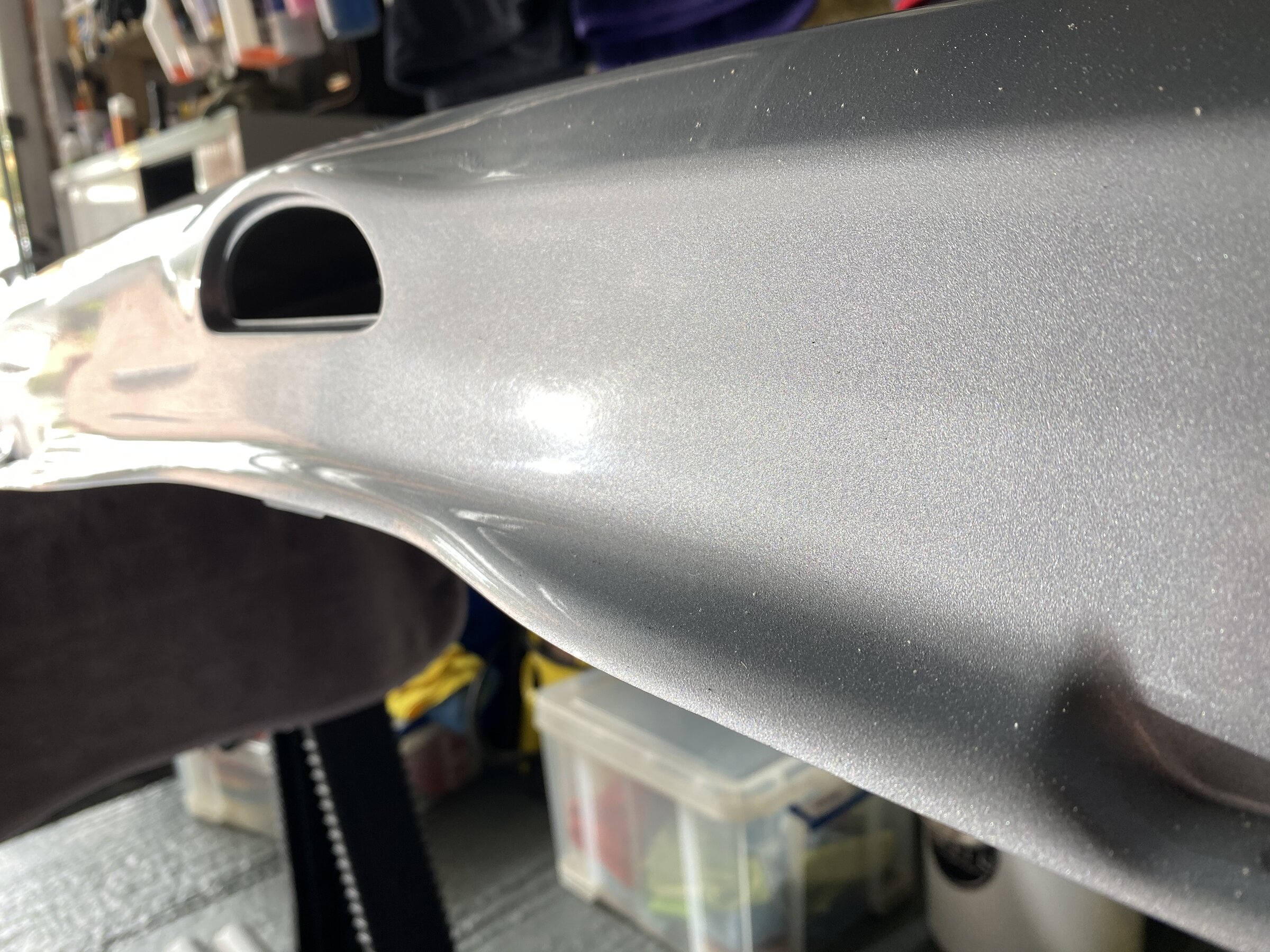

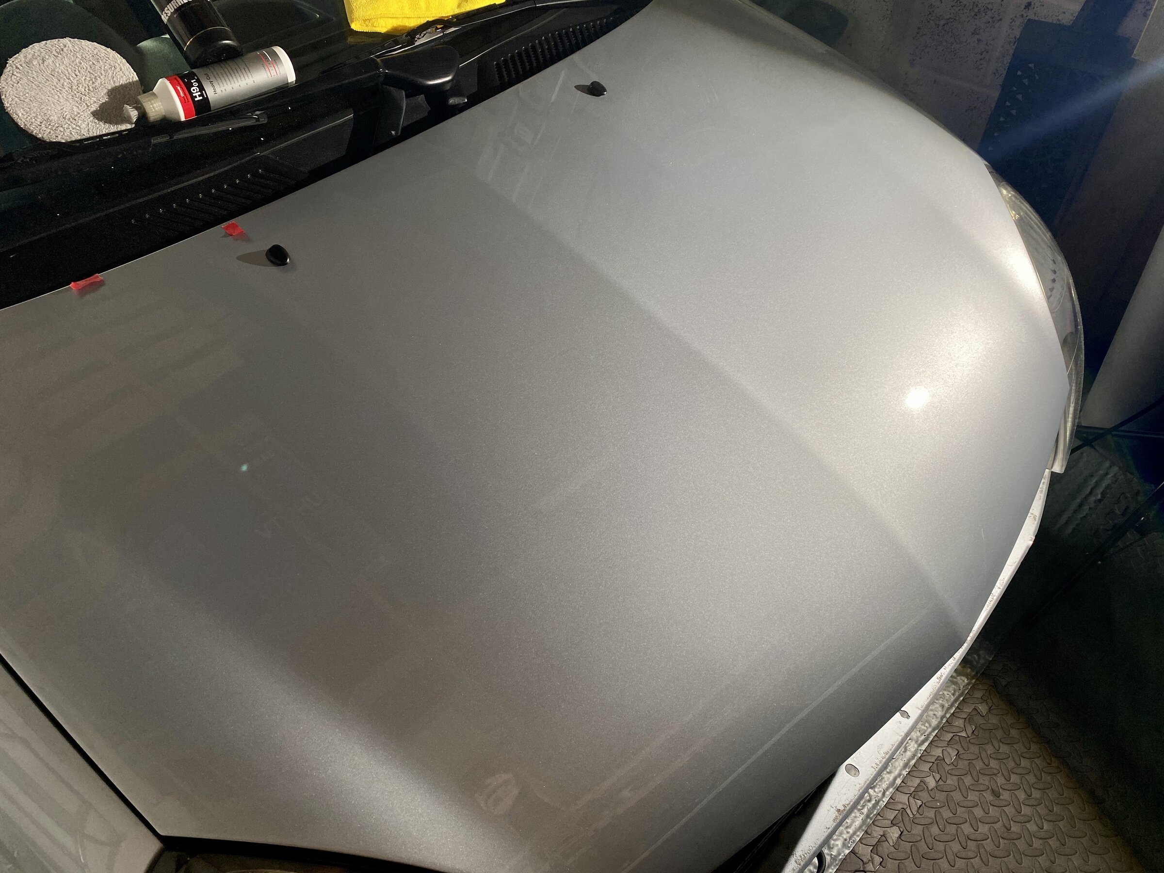

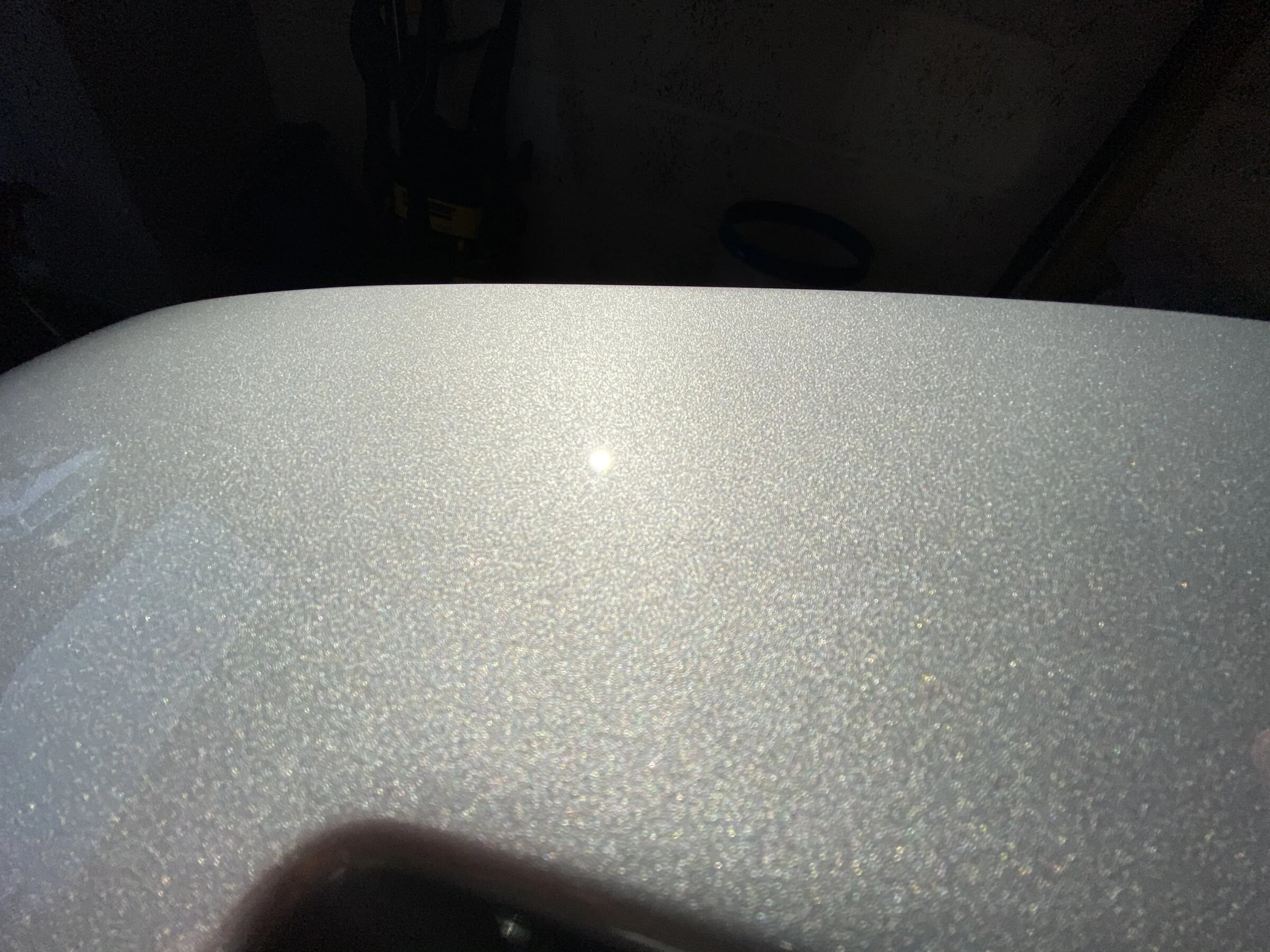

Polishing underway. I’m a simple chap so the goal is equally simply - to take a car which was tidy and take the paint to the next level. Tricky with silver as it doesn’t usually get really, really deep and glossy but I’ll get there. A few sanding marks to chase out but nothing I wasn’t expecting and progress is on point.

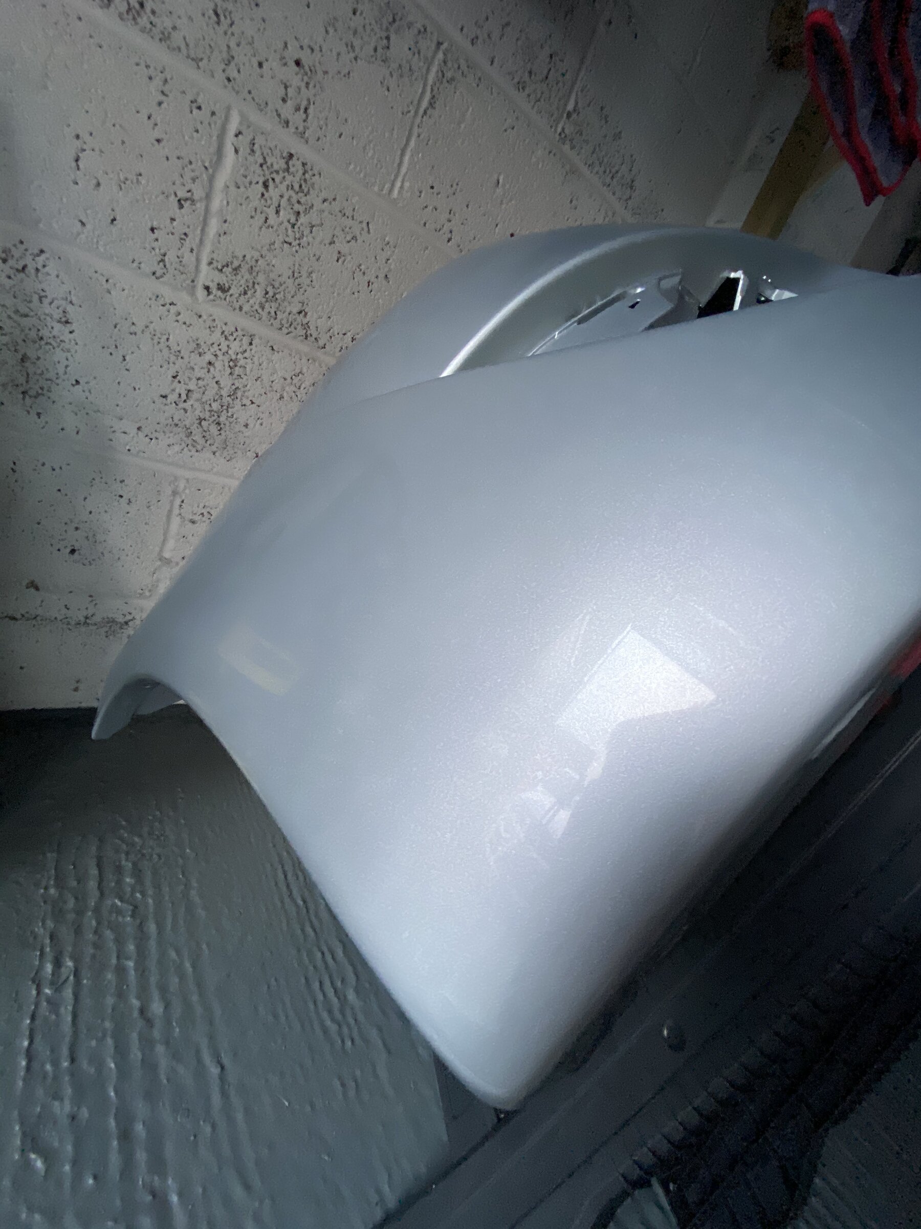

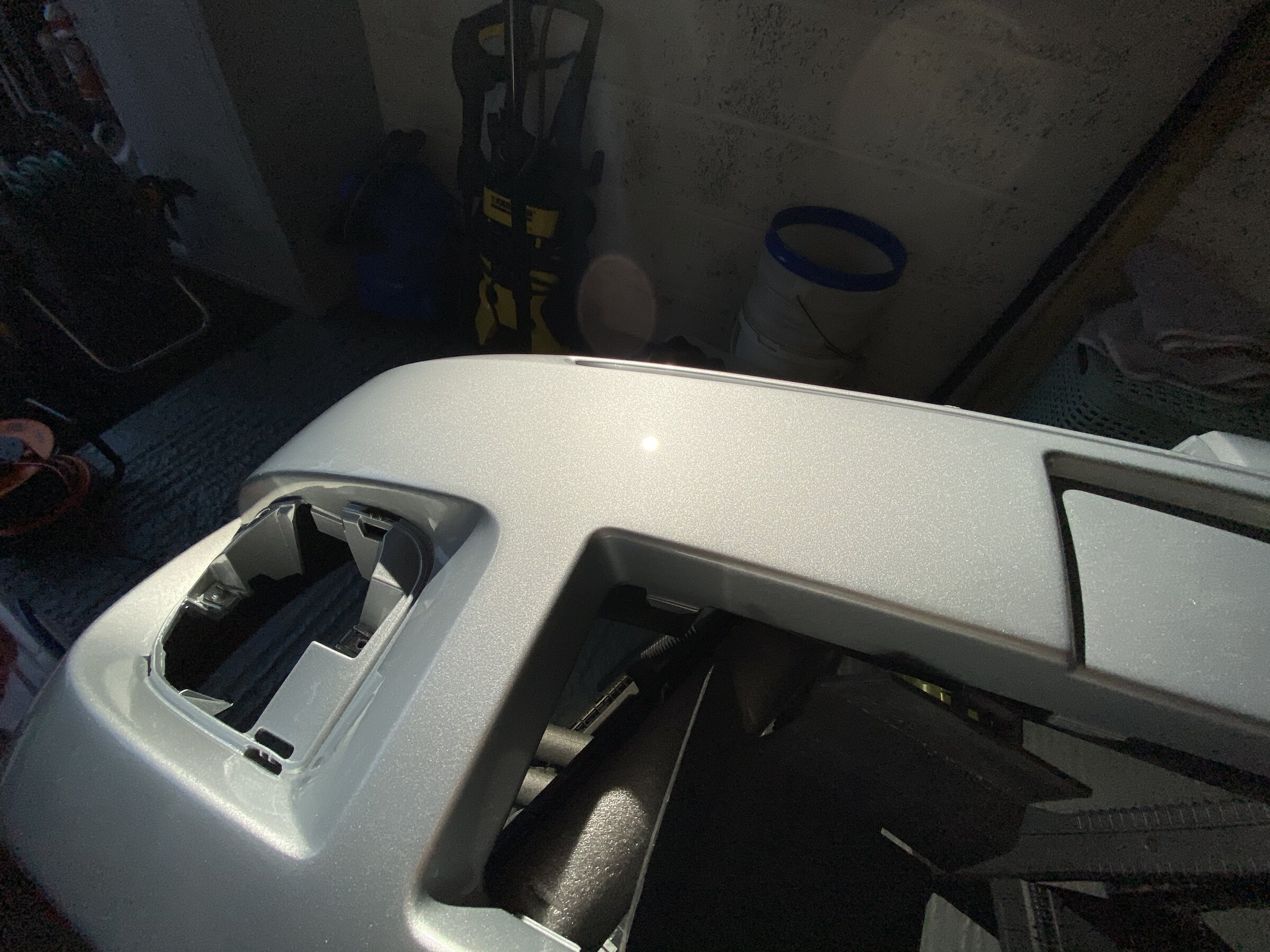

Finished polishing both bumpers using Koch Chemie H9 to compound and Car Pro Essence to refine, add a bit of a gloss and lay down a primer coat for the ceramic top coats.
Built both back up and I’ve also bitten the bullet and ordered the genuine black inserts for the front from Renault as the reproductions didn’t fit quite as right as I’d wanted.
Car should be back shortly. Hopefully it’ll come up as nicely.

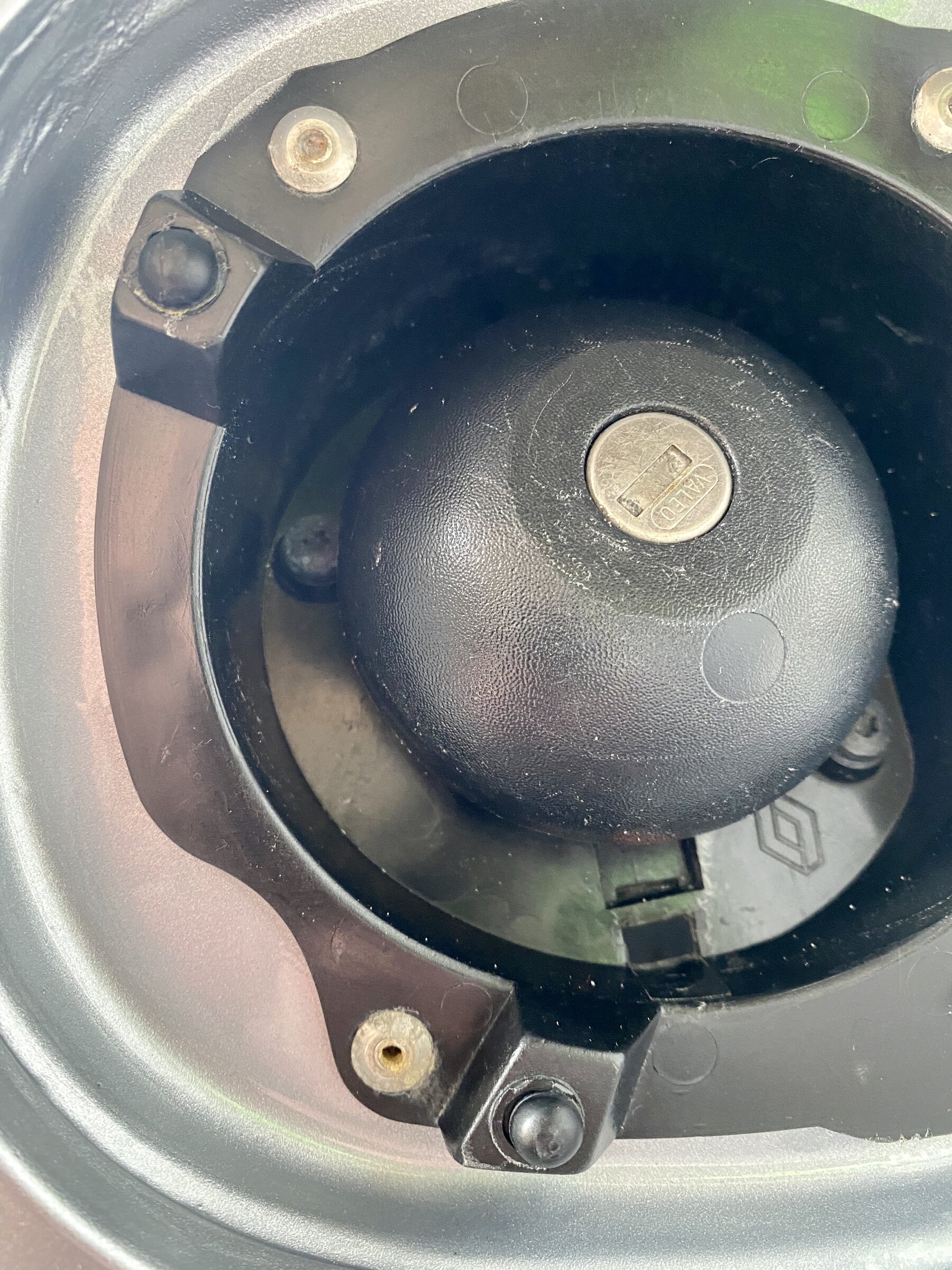

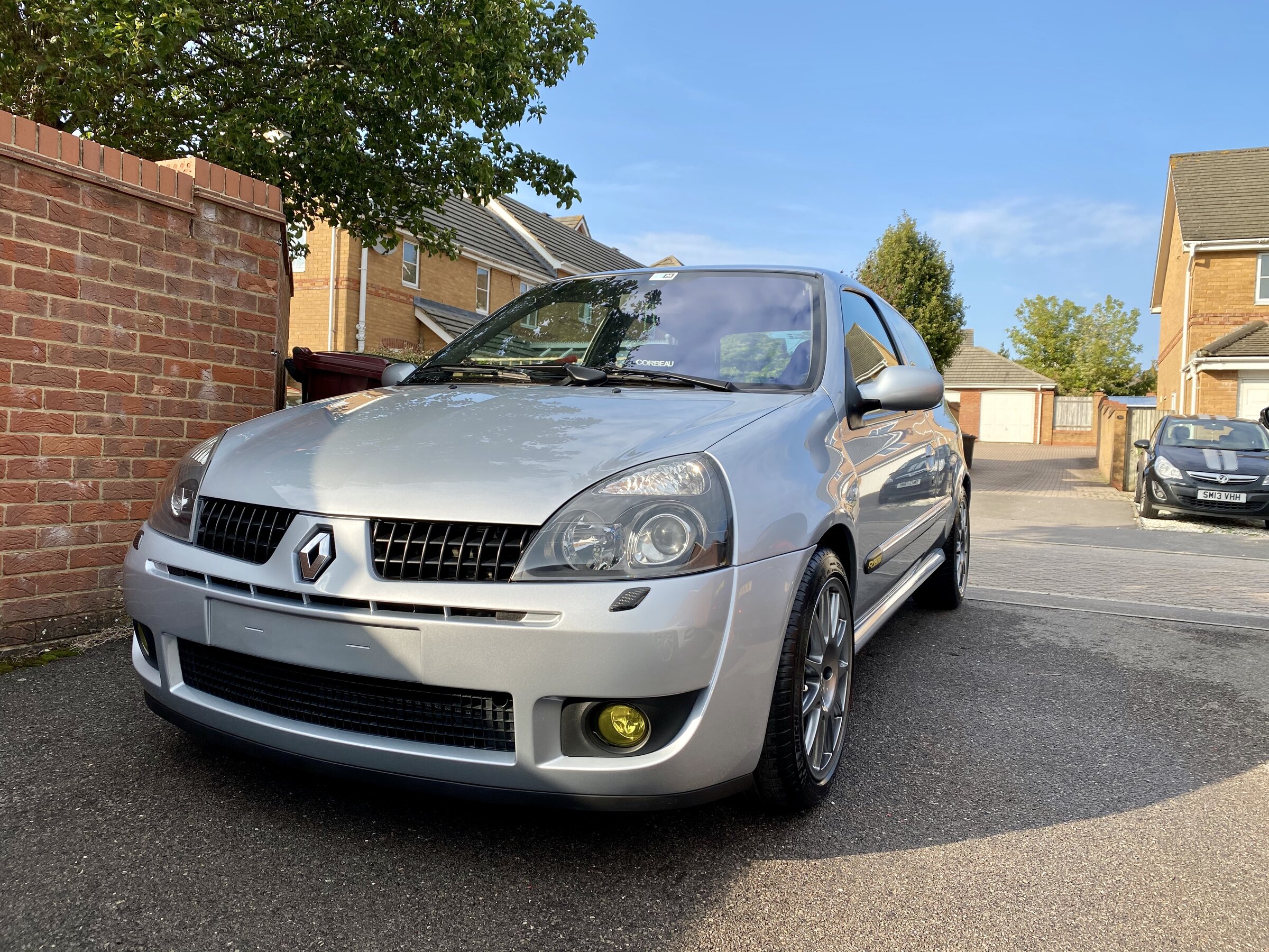

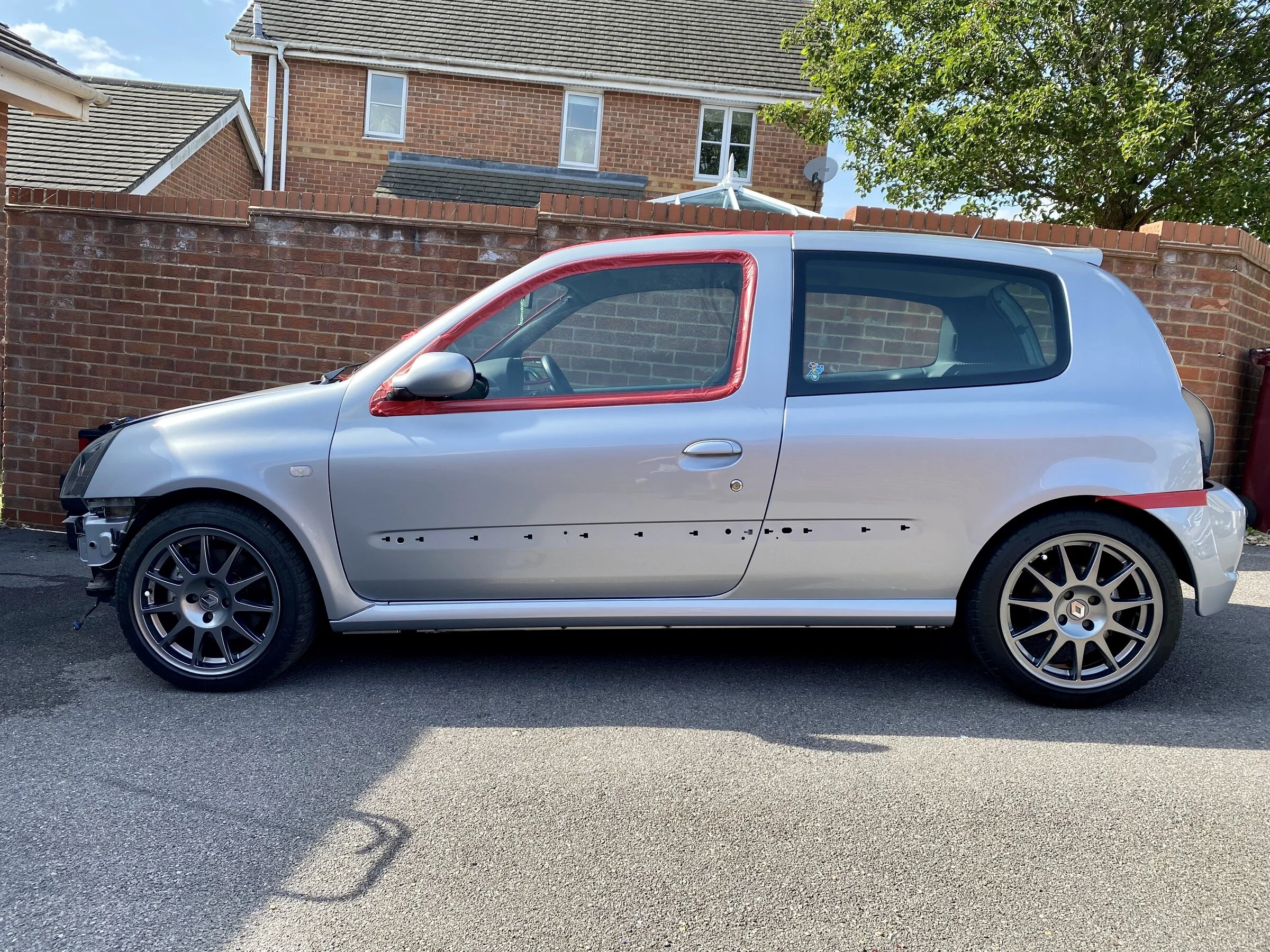

Almost there! Still needs to be flatted and polished and there’s still the petrol cap and side trims to paint but I’m happy. Very happy. Almost happy enough to counteract the utter s**t show that was Legoland today 🤬😘

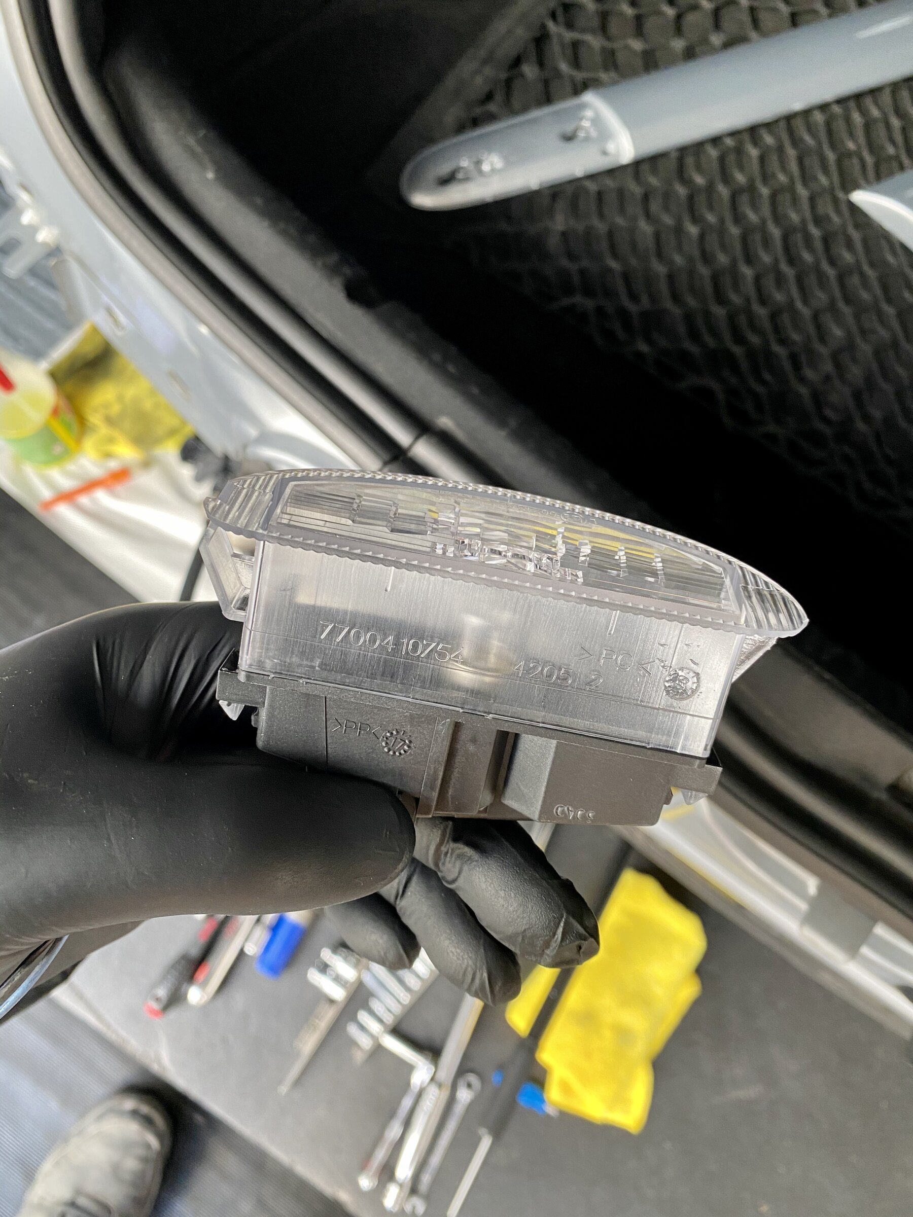

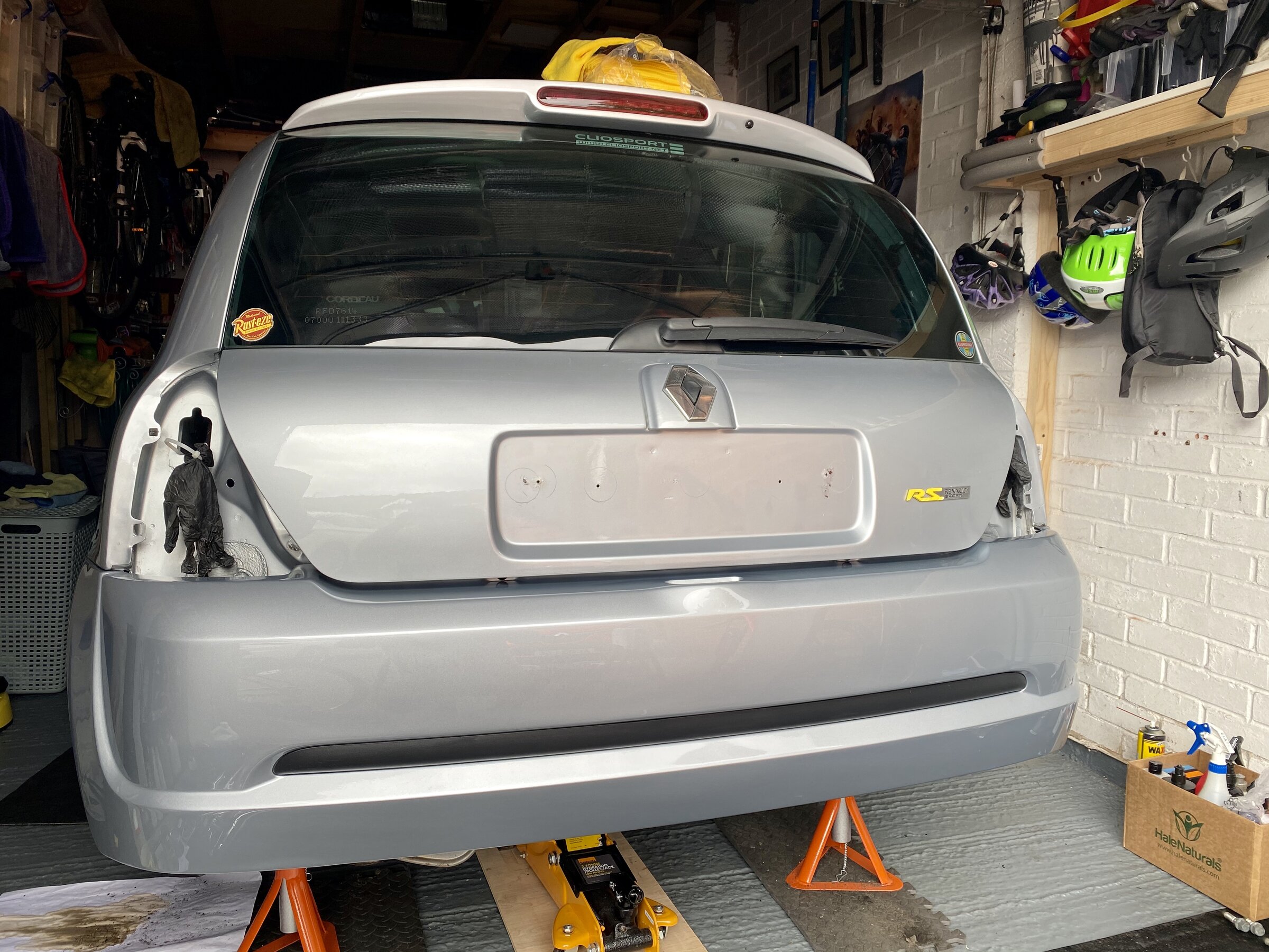

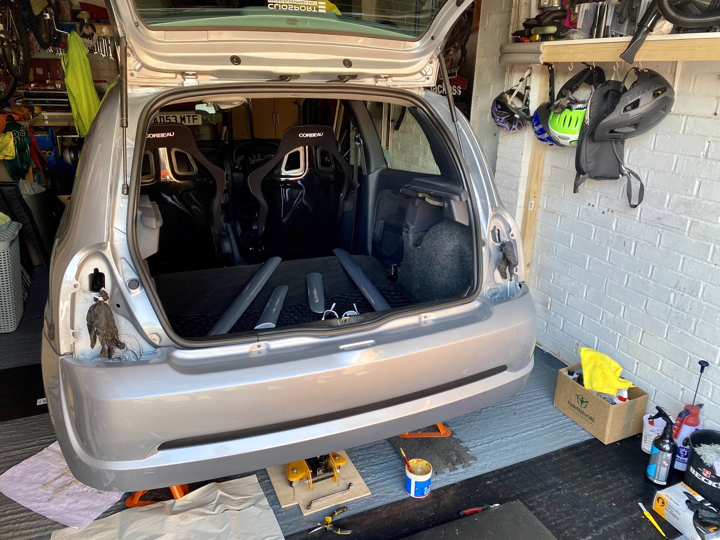

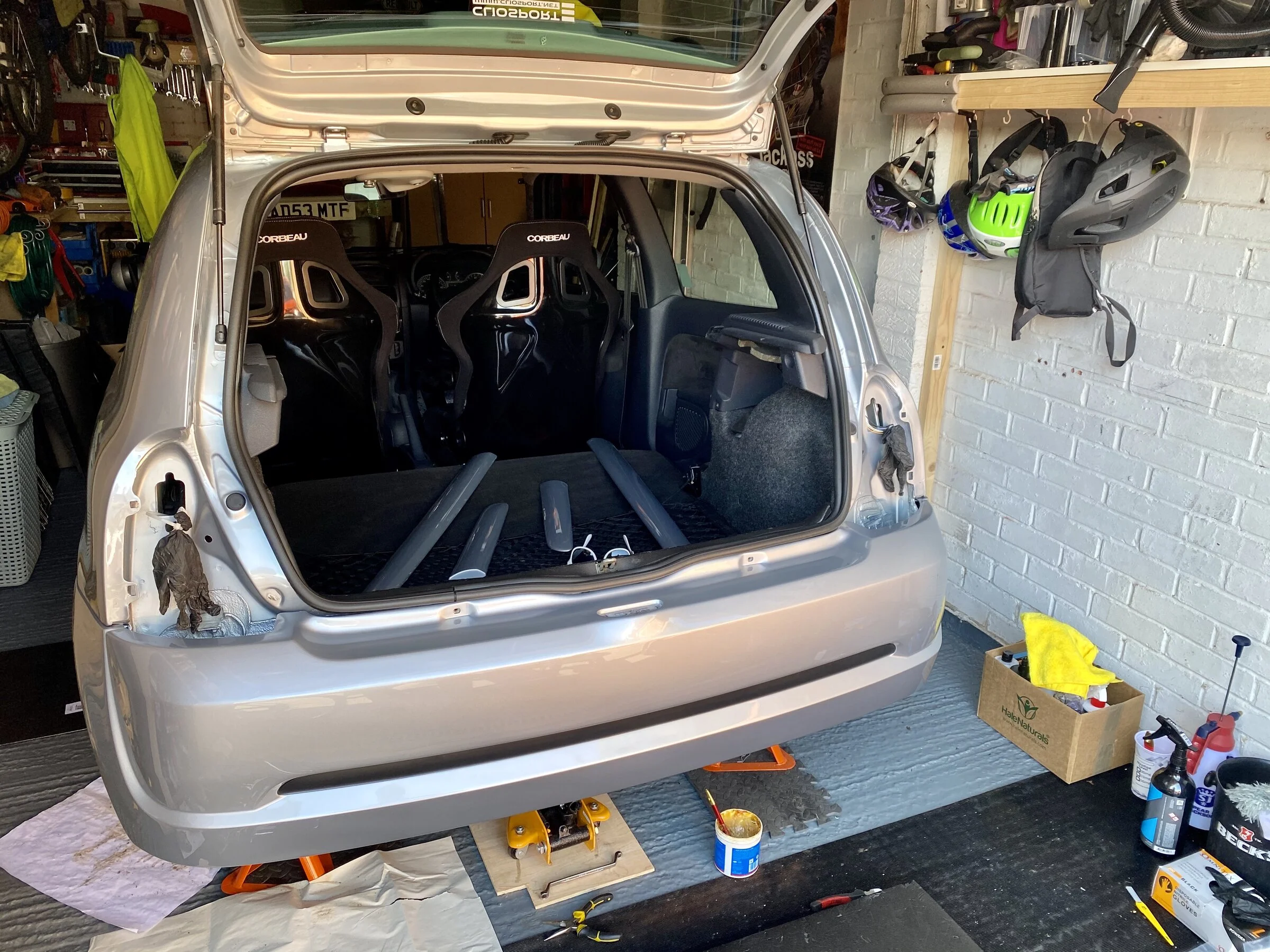

Back bumper refitted. New bolts for fuel filler and waxoyl behind to protect. Rubber bumpons added. New genuine number plate light fitted. Polishing started. Lots to do.
I kept looking underneath and realising how much work it needs too. Perhaps a winter project.

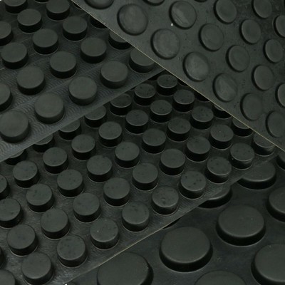

Do you have a link to those bumpons?
Fancy painting my flamer?
There you go. I’m nowhere near talented enough to paint sir! This was done by these guys.

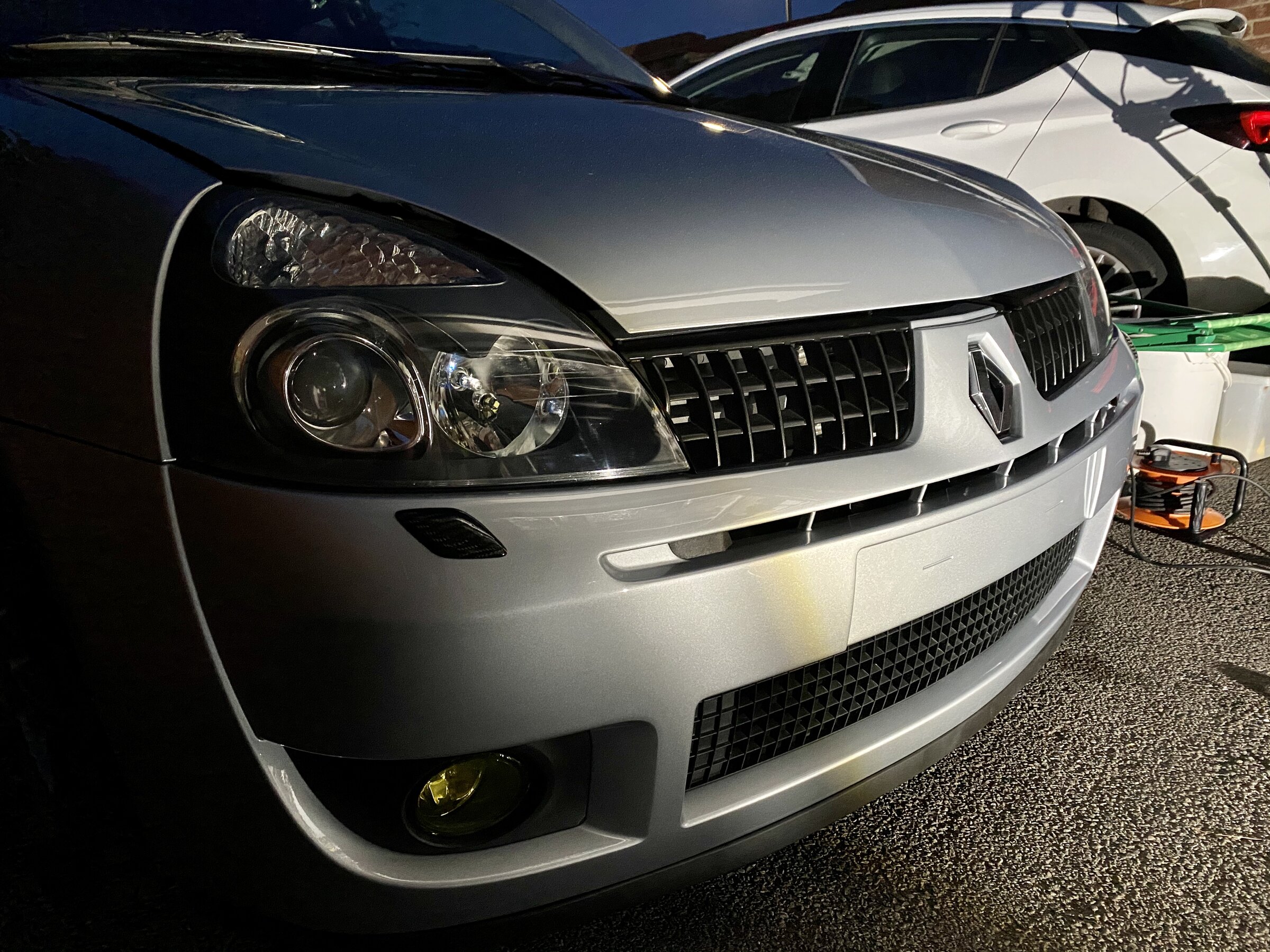

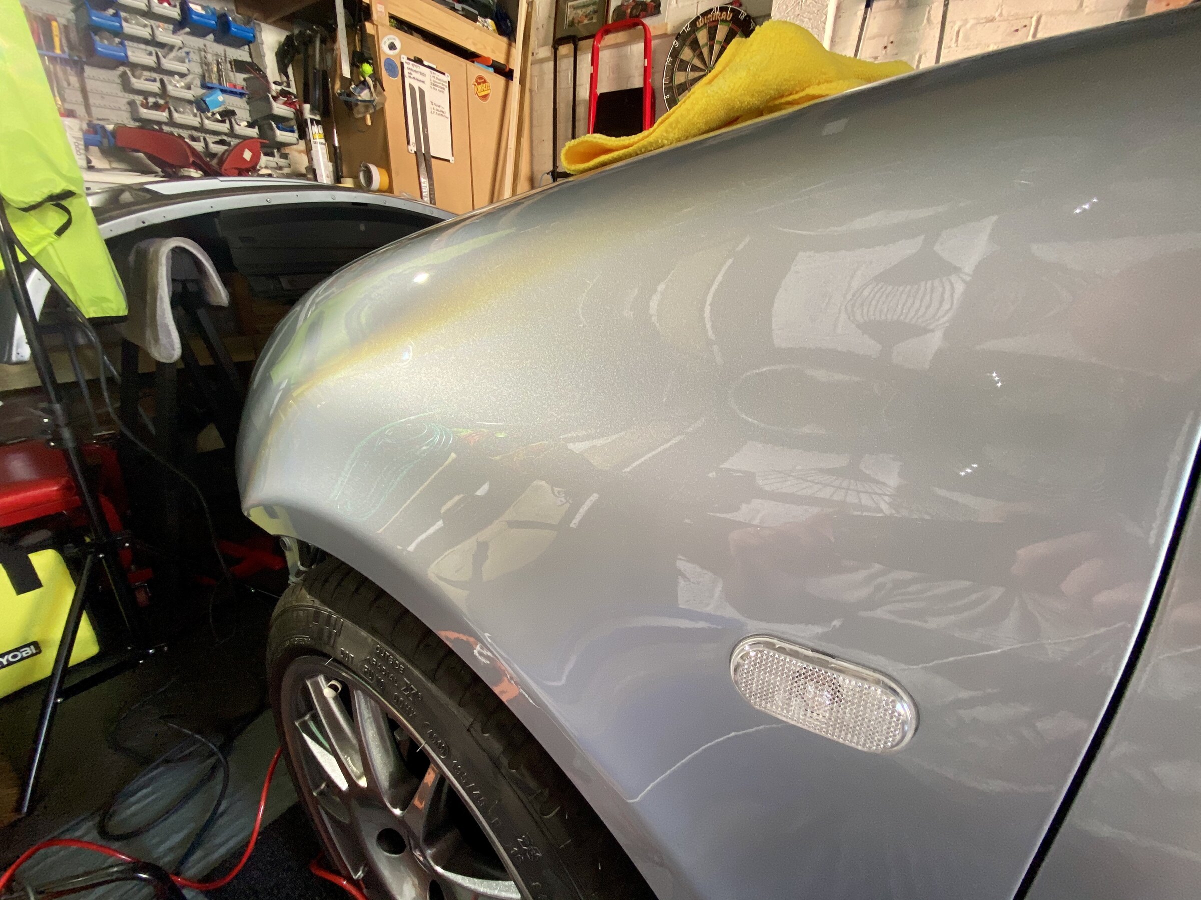

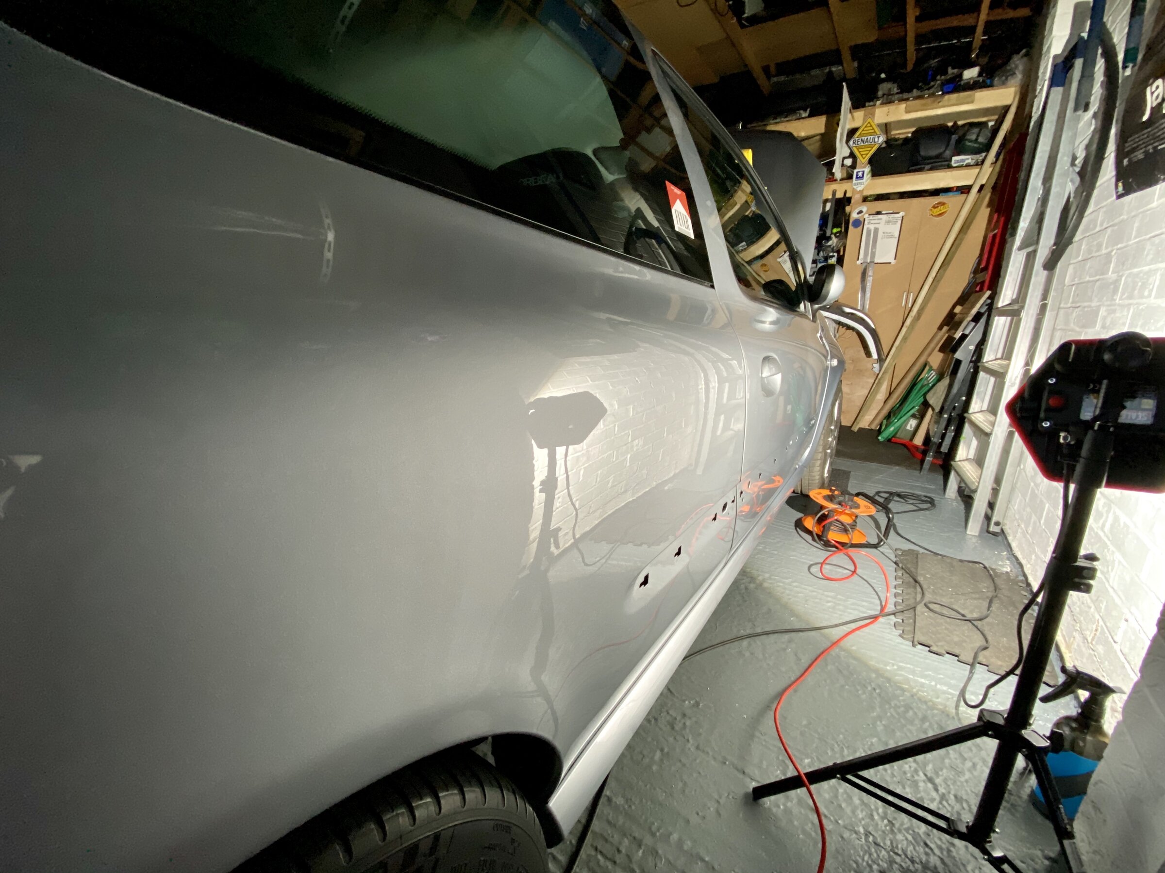

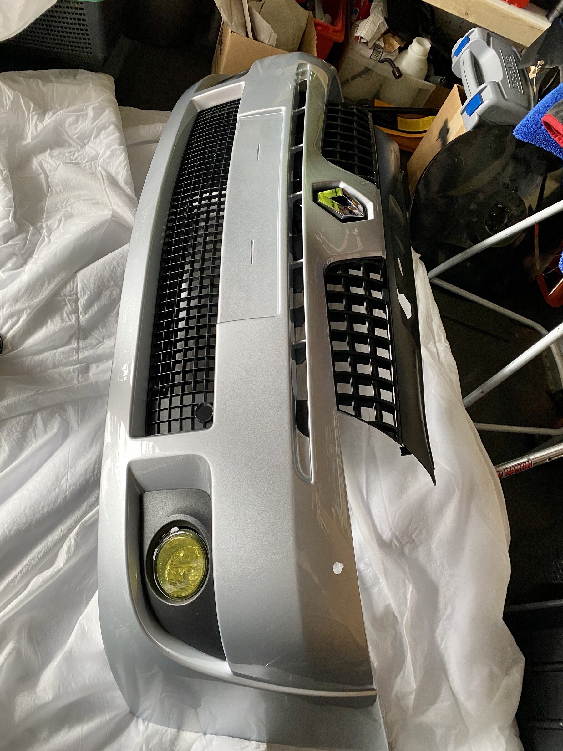

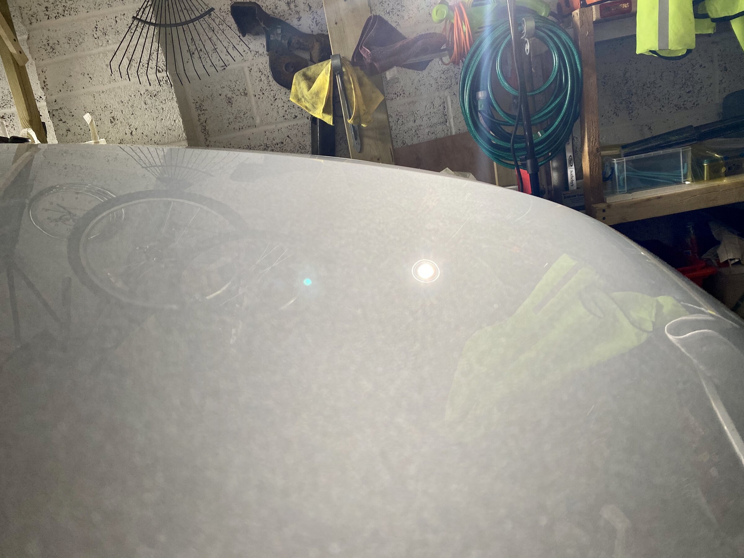

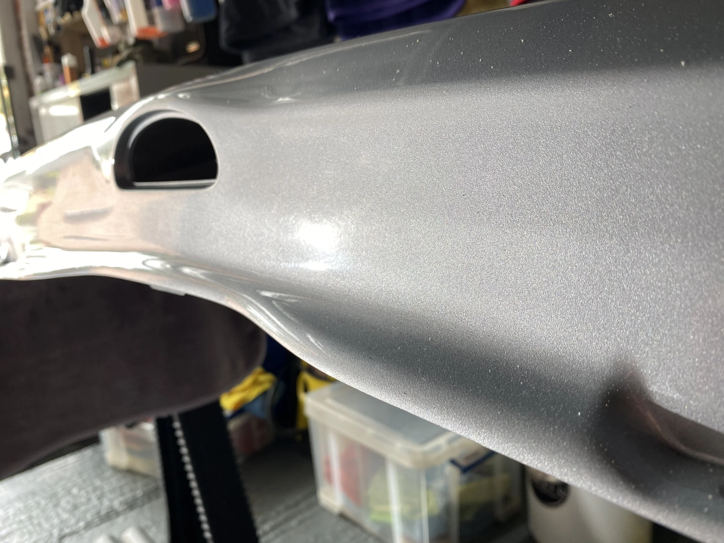

More progress. Driver’s side cut using Meguiars microfibre pads and 205 polish. Switched between this and Koch Chemie H9 and used both DA and smaller rotary with wool pads.
Replacement washer jets to be fitted and my front bumper inserts turned up too. Bloody expensive but they fit perfectly.
Going to refit the Fabia splitter temporarily as KTec aren’t likely to get more CF ones in before the end of October.

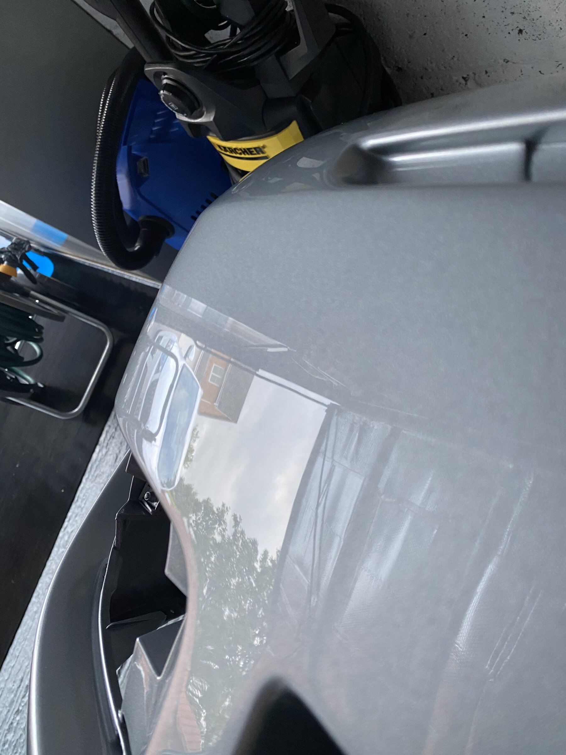

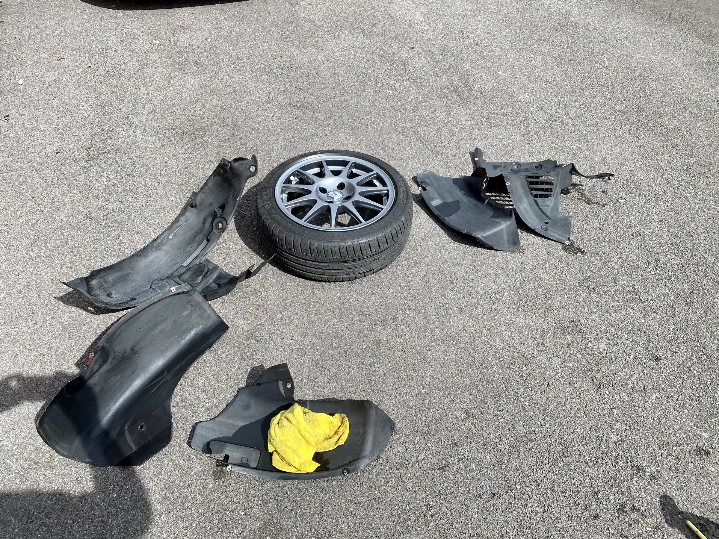

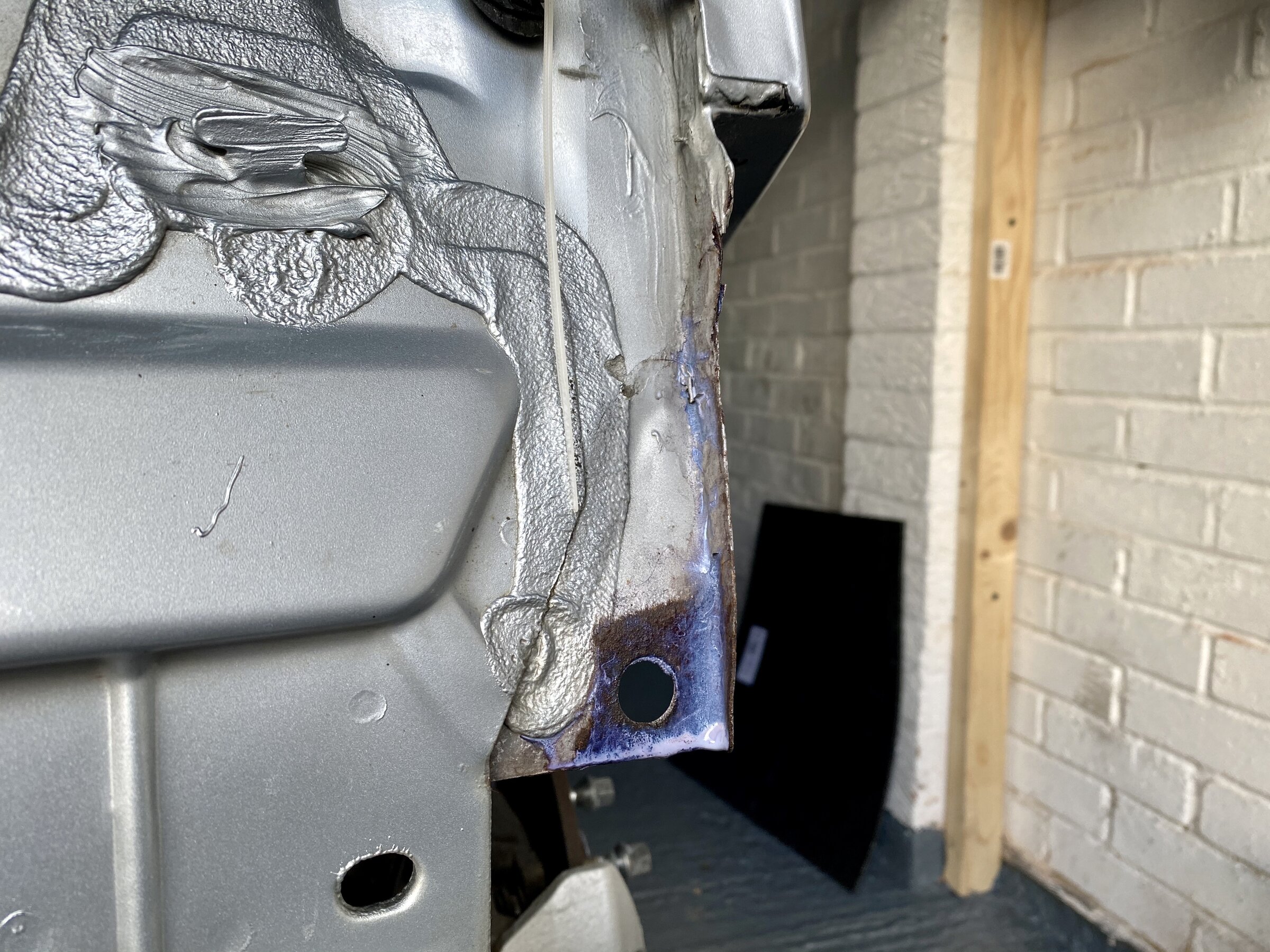

Compounding done. I also removed all of the arch lines, cleaned them and also the arches themselves with a few surface rust repairs too. Cleaned out half a ton of muck from the front of the sills, recoated the wheels and repainted the hubs while I was there. I did refine too but after 10 hours on it too knackered to take any photos apart from the front wing 😂

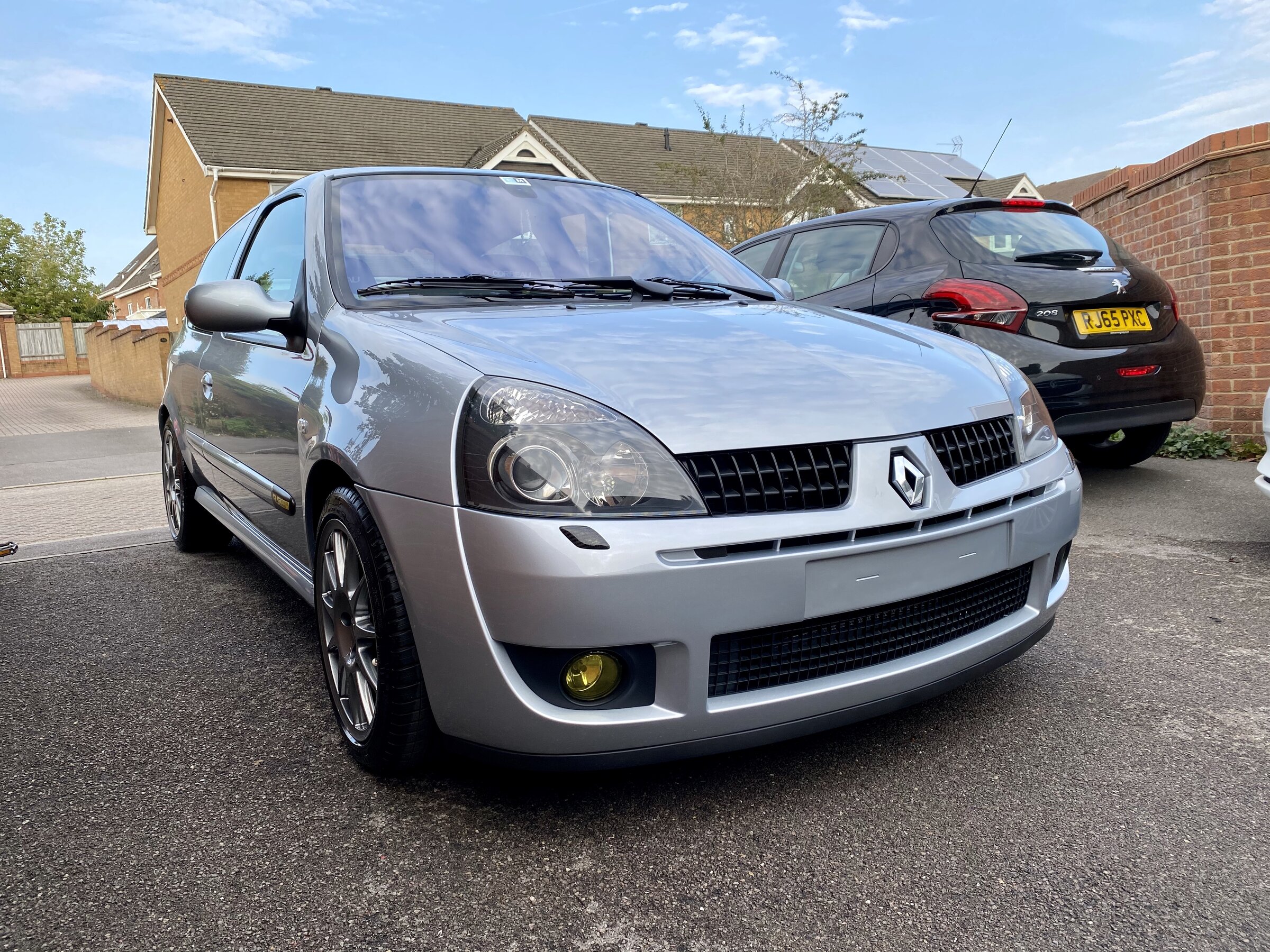

And she’s finished. Everything back together, coated with 3 layers of cquartz UK and 2 of Gliss. Still got to hoover inside but washed the dailies today as well so proper knackered. Brief scare earlier as she ran like a bag of spanners briefly - hopefully just a gremlin from sitting around for 3 months!! Really pleased with where she’s at now. Few little projects to work on including an alcantara headliner and I also need a new scuttle panel as mine’s curling along the seal and looks poo - anyone...?

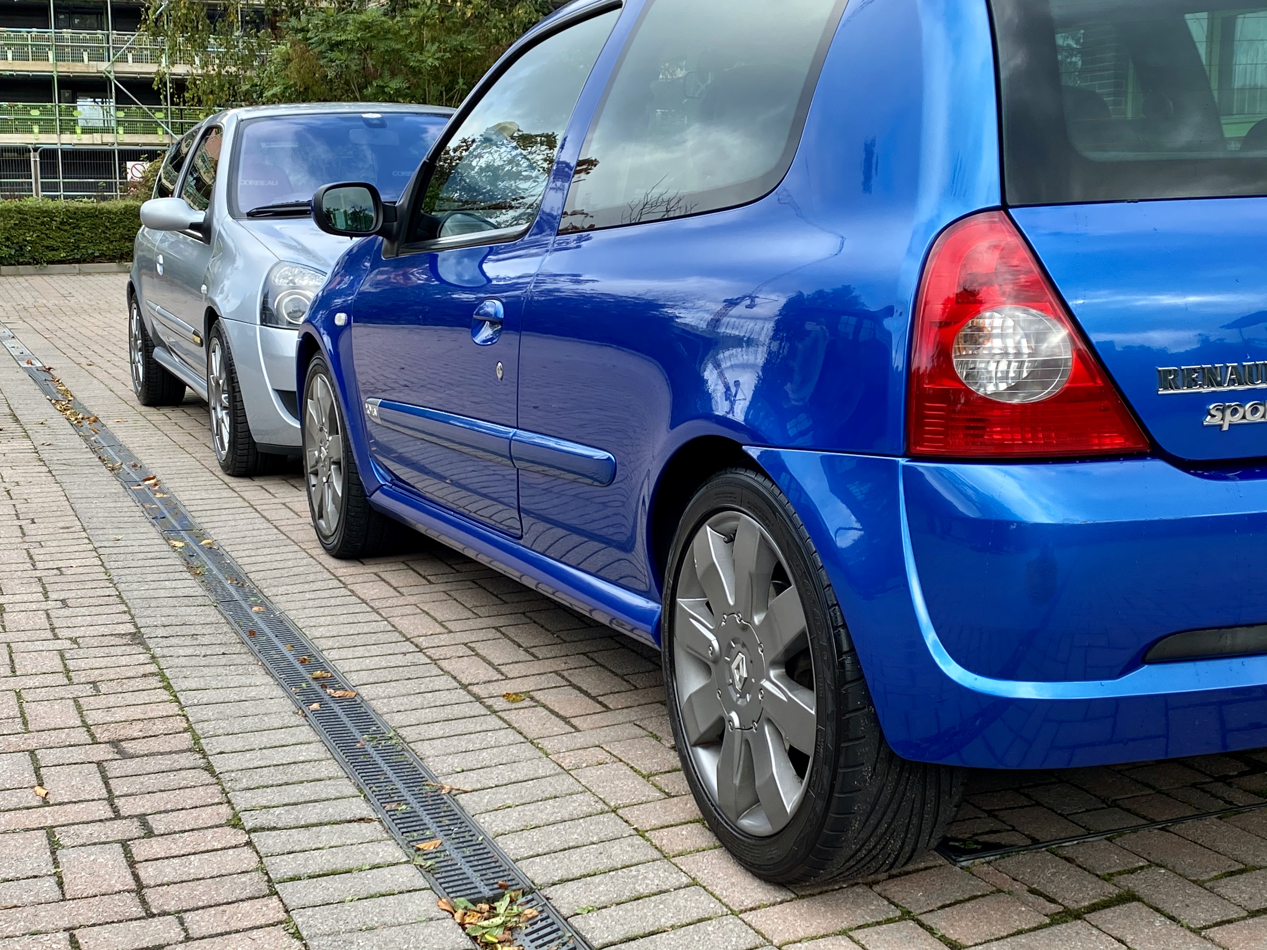

Thanks fella. Lives in the garage but it’ll get used - no point having a car to look at. This is why I’ve protected the paint as best I can so it won’t deteriorate (I hope!)
I was quoted close to £4K by another painter who took great pains to show me a car midway through a full repaint with a finish in the door shuts as good as the exterior. He then looked at mine and basically said “you won’t want to spend that” - needless to say he didn’t get my business.

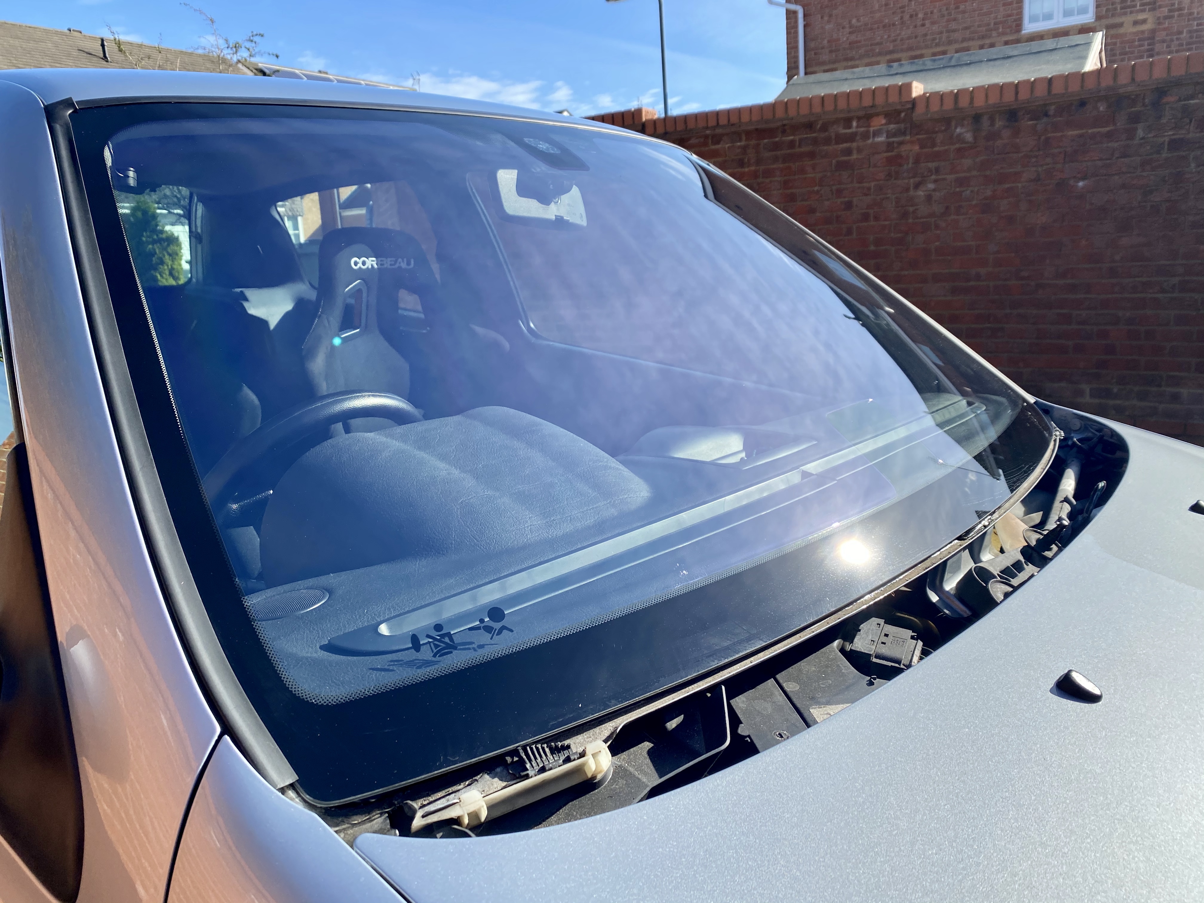

New windscreen fitted today. Been putting this off but managed to pick up a big chip a fortnight ago so bit the bullet.
Made me realise how completely buggered the old screen was. I bought a screen trim kit years ago when RPD had them on offer so that was fitted at the same time.

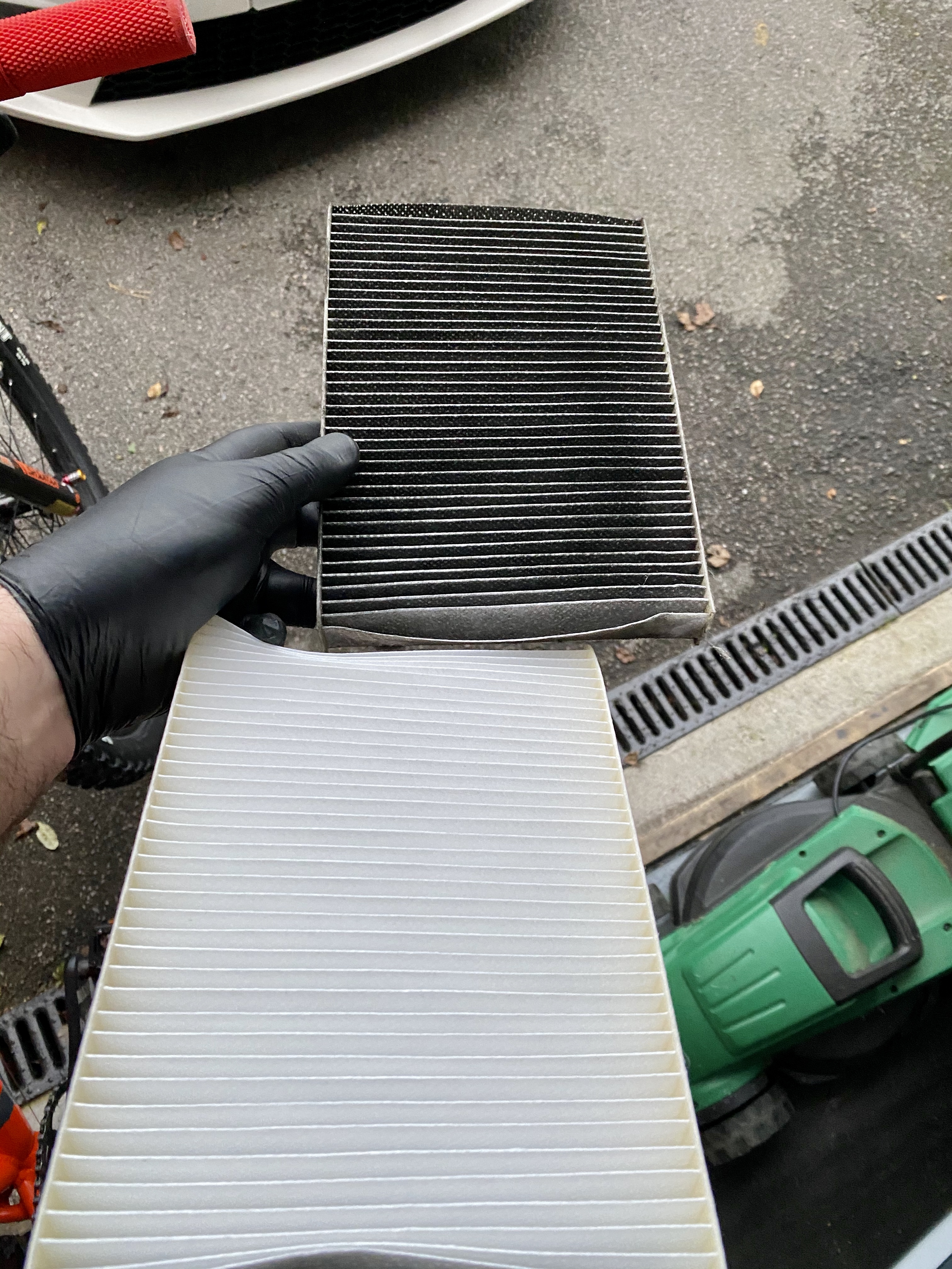

Changed the pollen filter and fitted new scuttle panel this evening courtesy of @Mbeau and coated the new screen with a drop of Gtechniq G1.
Few little jobs still to do inside before embarking on the underneath. Not looking forward to that...
