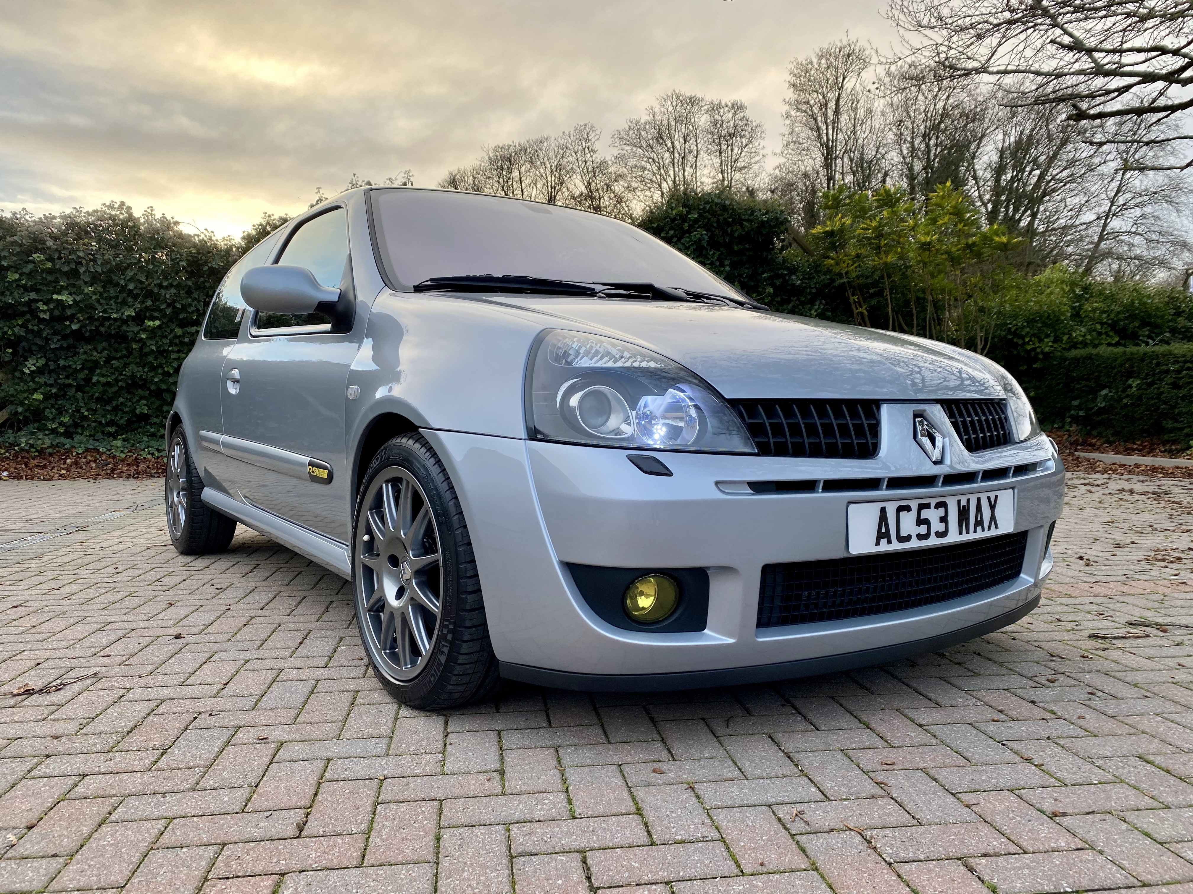

Car really does look amazing mate 👌👌

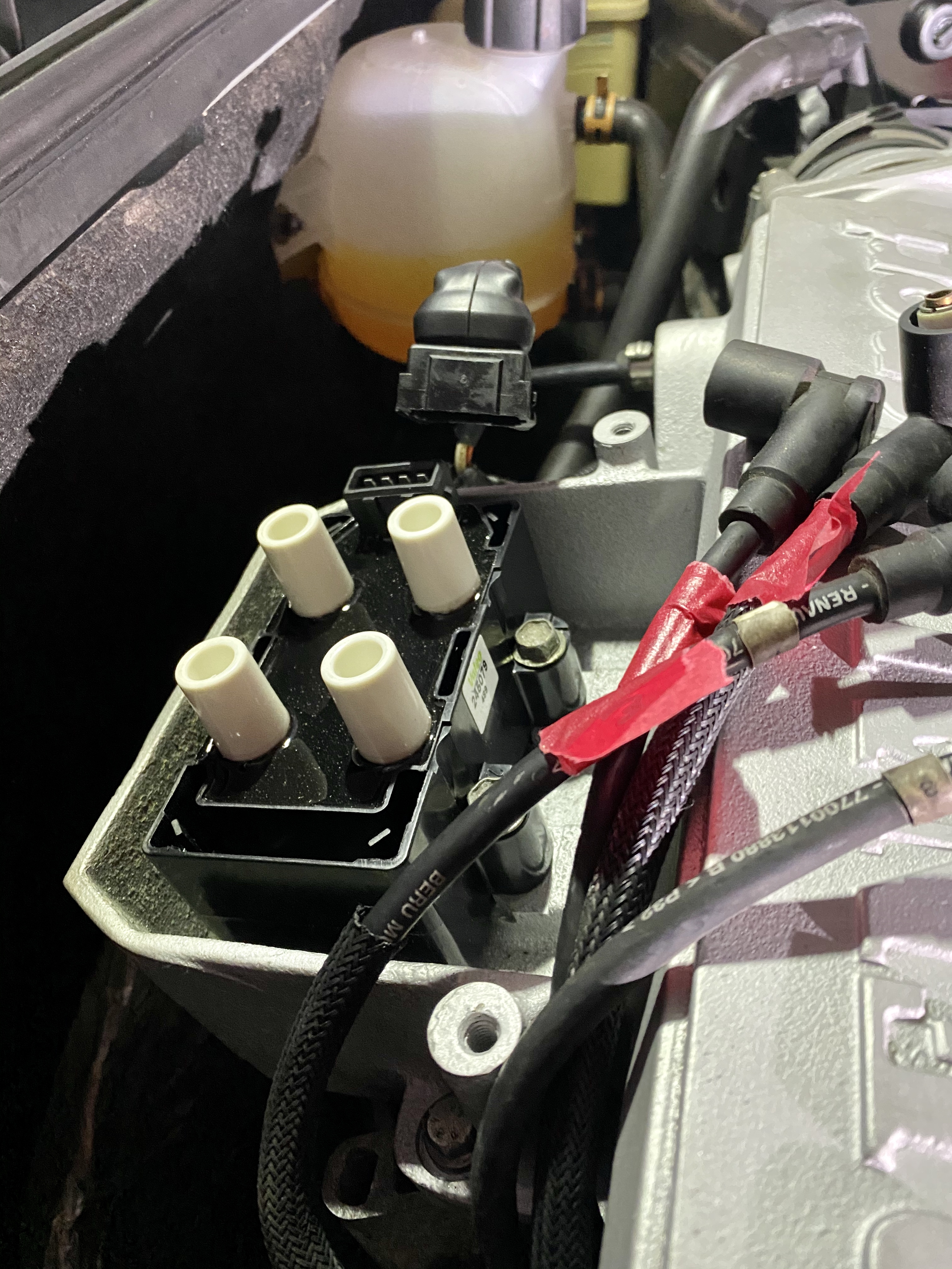

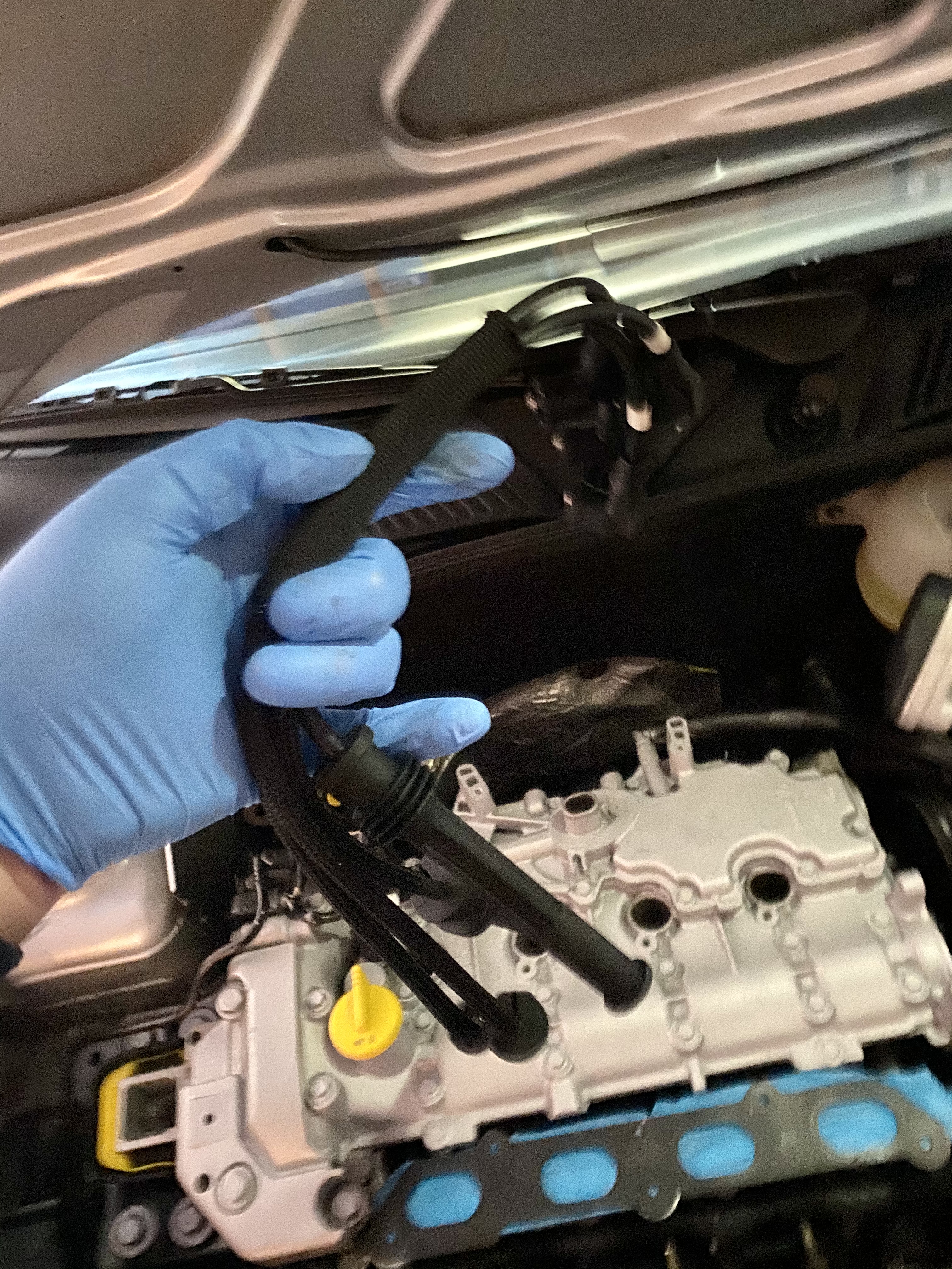

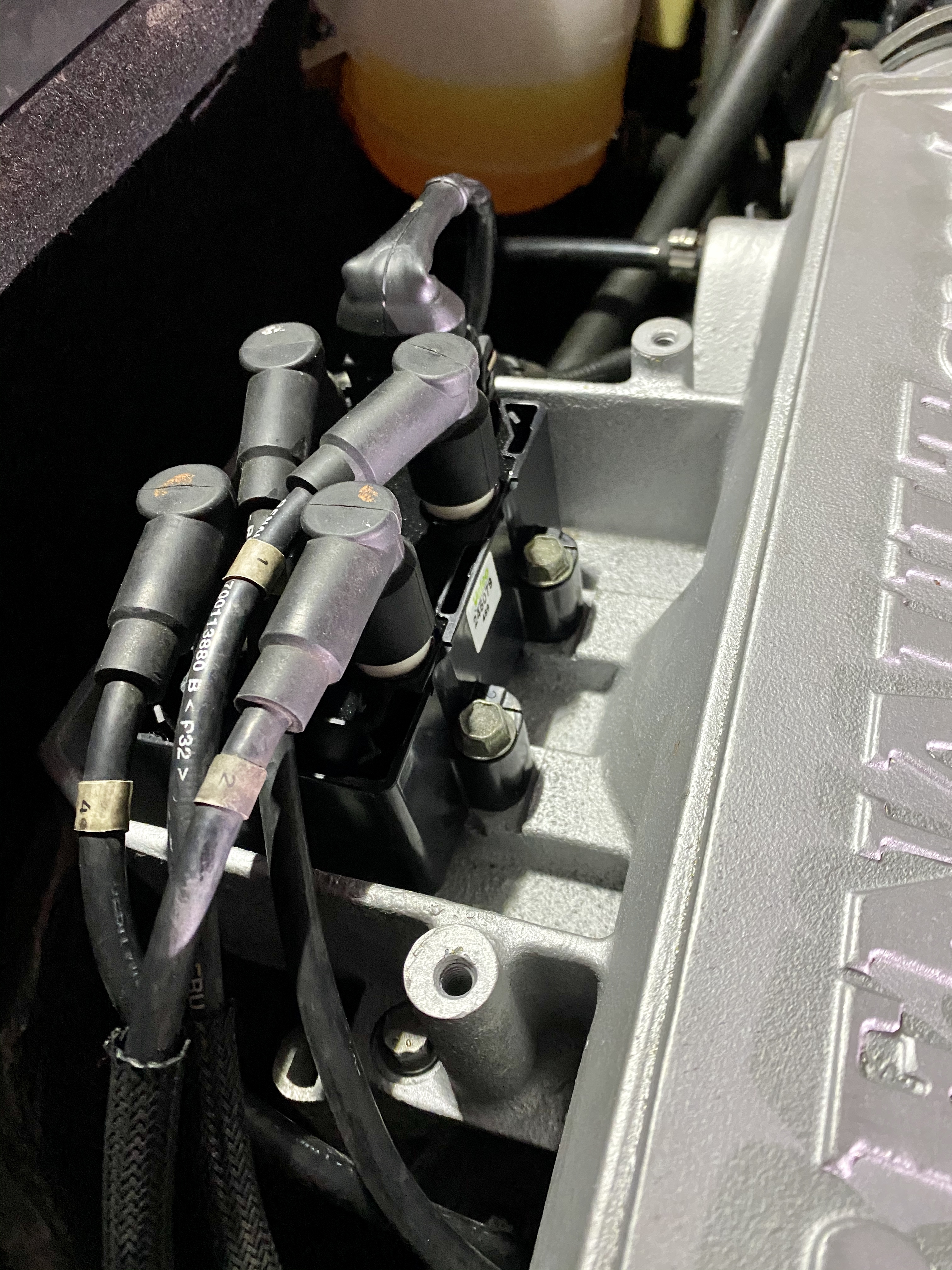

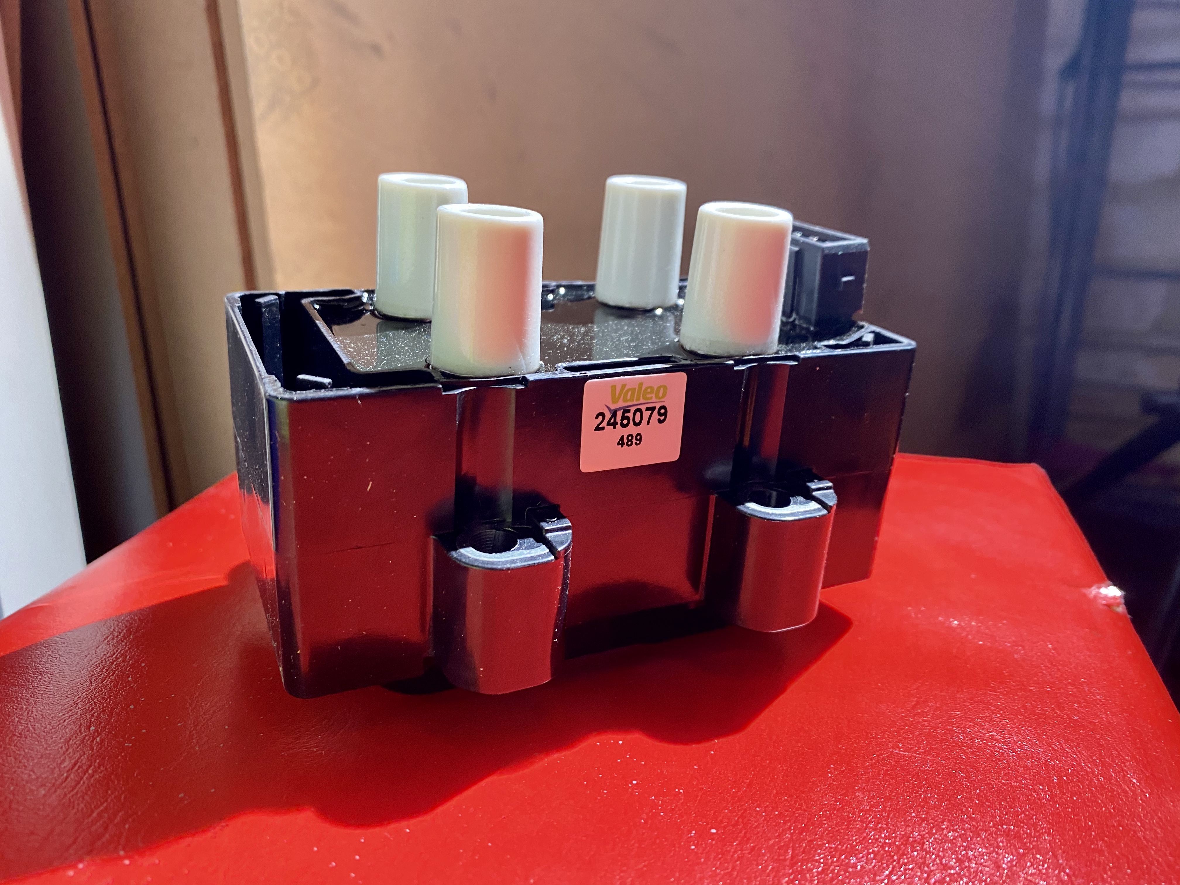

New Valeo coilpack fitted today. All leads checked and cleaned with contact cleaner. Not the most exciting update but it should cure the hesitating and cutting out. Car idling fine anyway.

I’d also be inclined (if you haven’t already) to get into the fuse box in engine bay and remove and clean up all relay connections and fuses. Seems unlikely a bump cut it out because of leads.
My money would be on a relay shutting things down going off mine having a similar issue before. Gave the fuse box a prod when mine wouldn’t restart and heard a relay click on & was able to start right up. Took the relays out and the blades were really oxidised, quick tickle with some wet n dry and wd40 & been fine for last few years.
Thanks - great info and I’ll definitely add to my to do list 👍

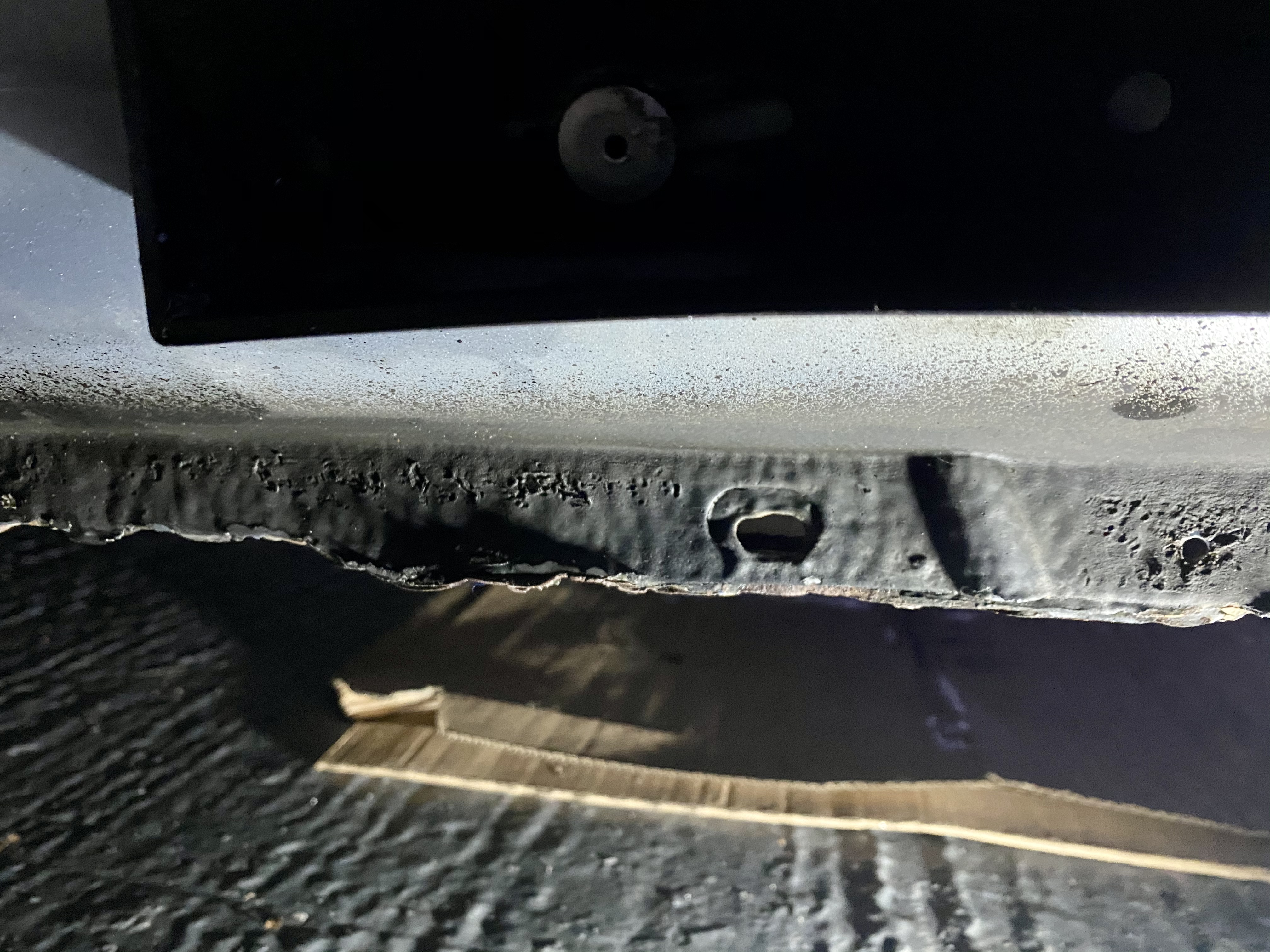

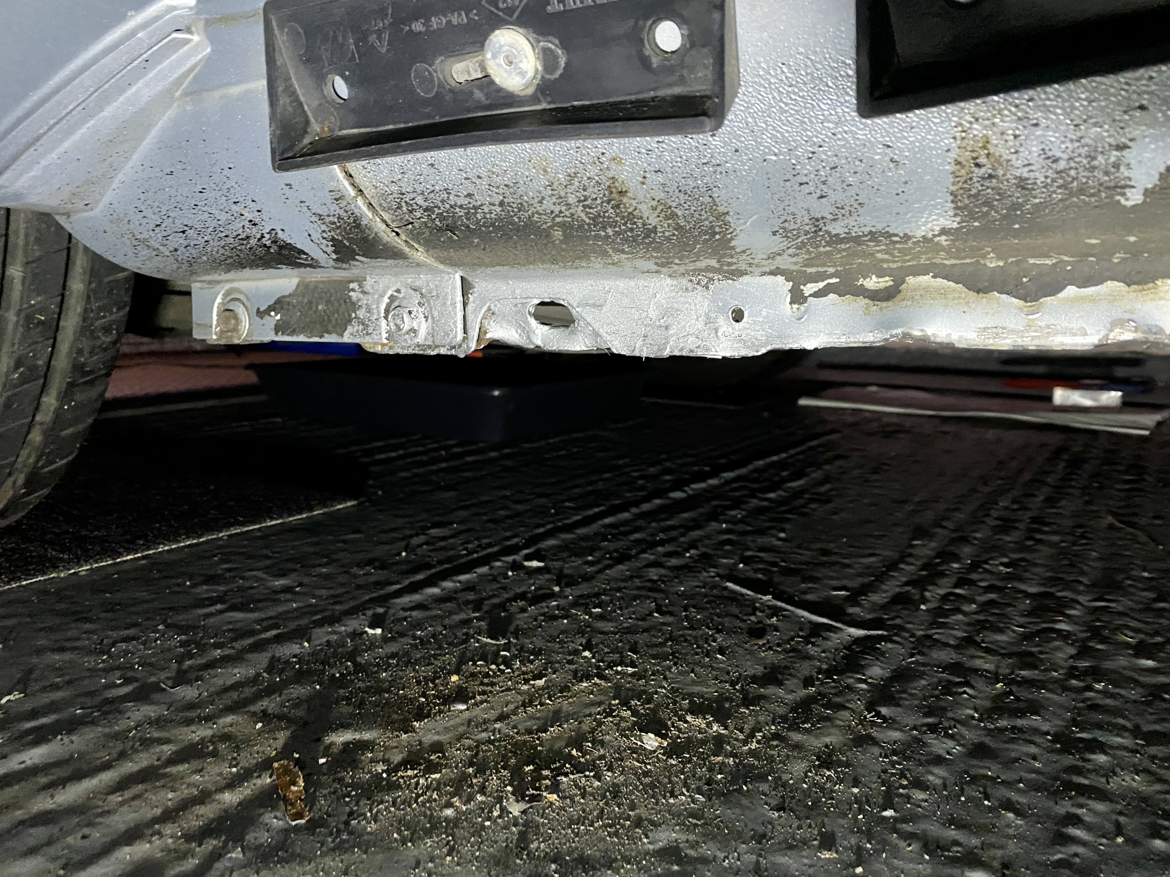

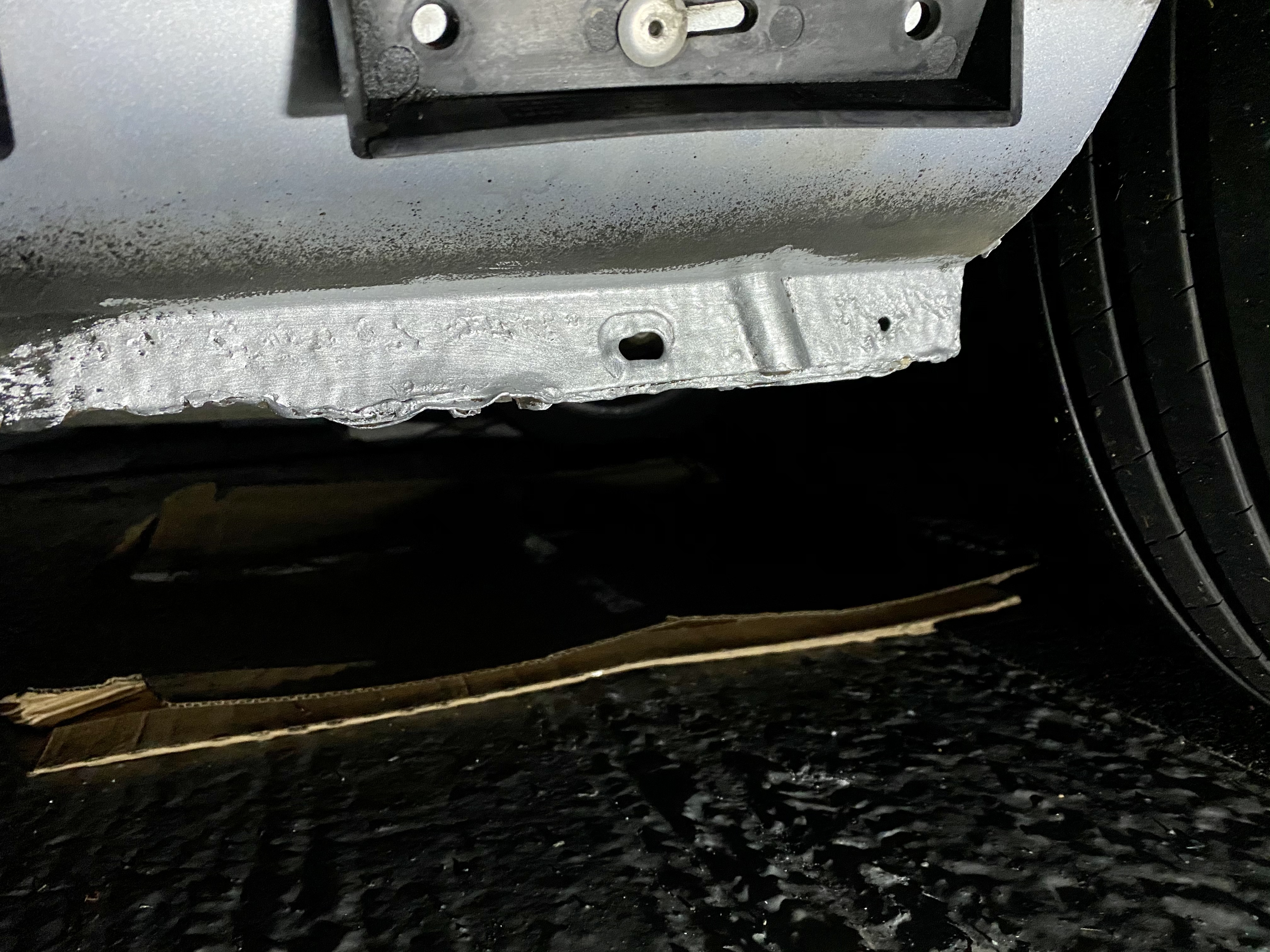

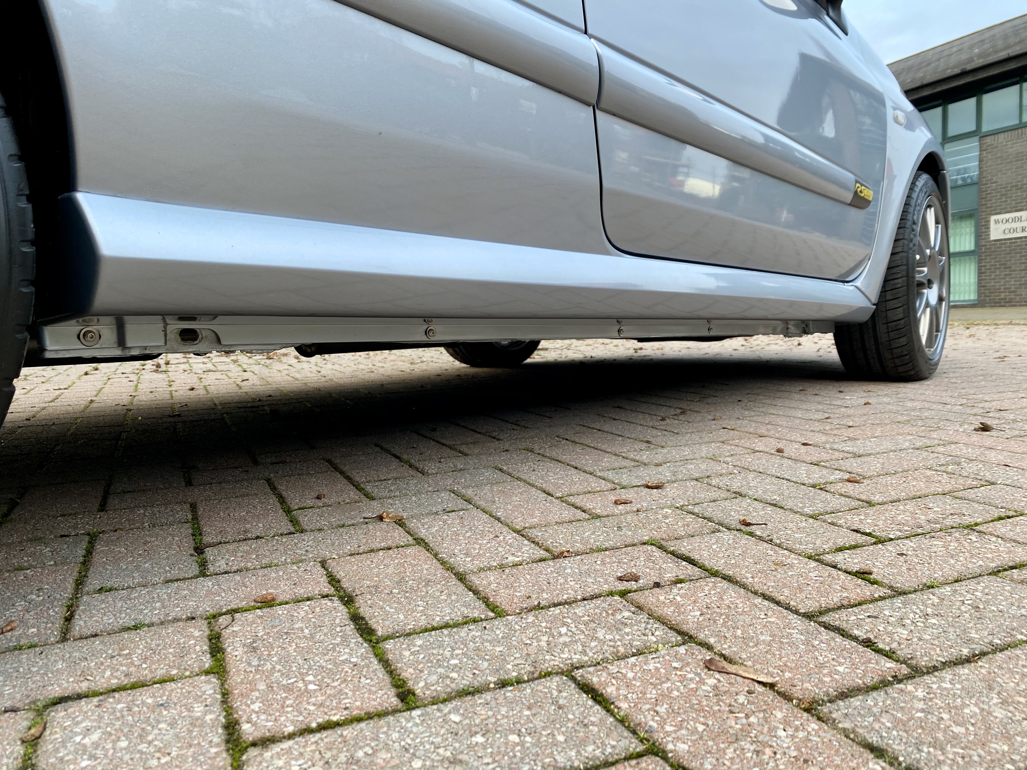

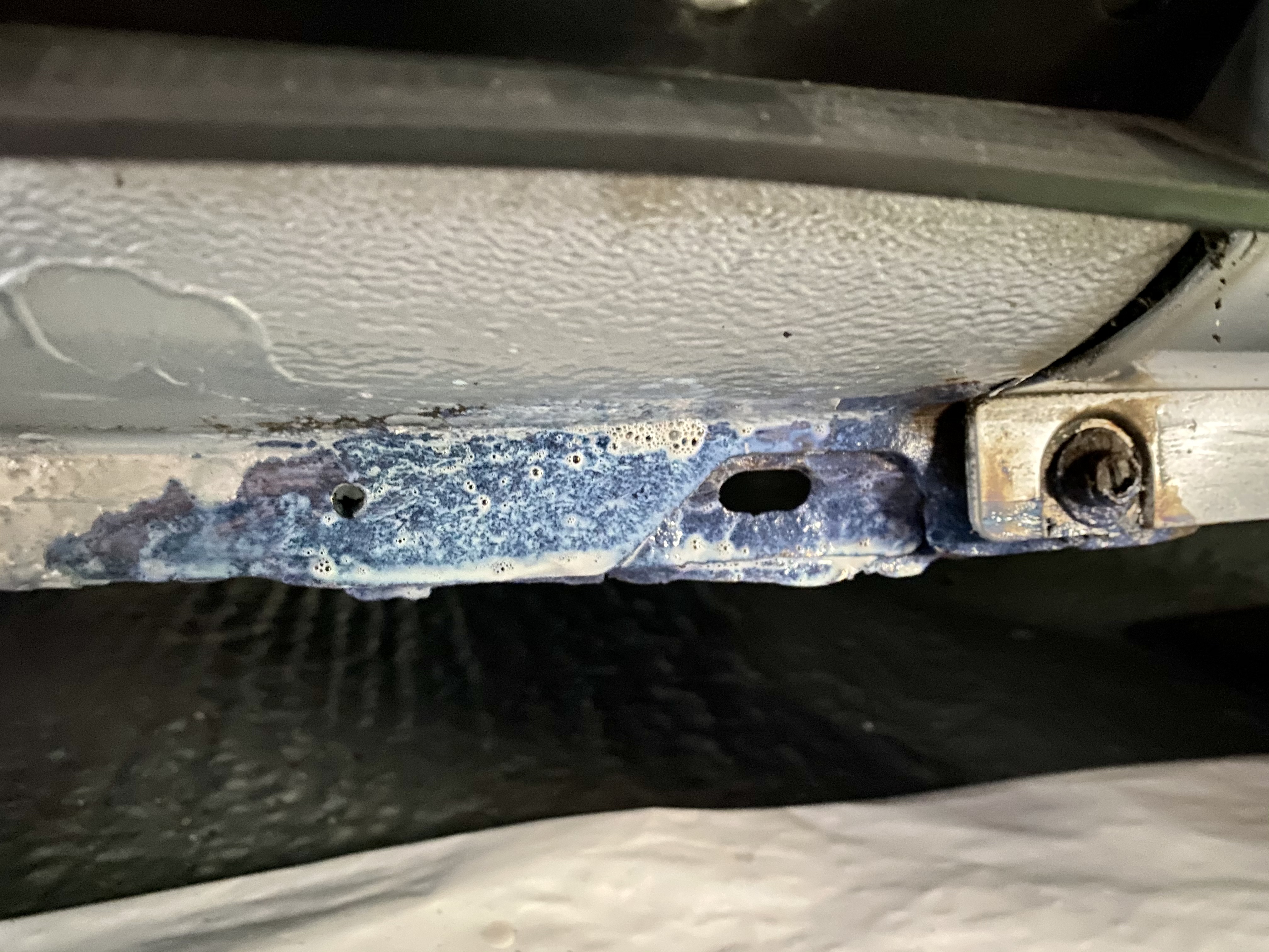

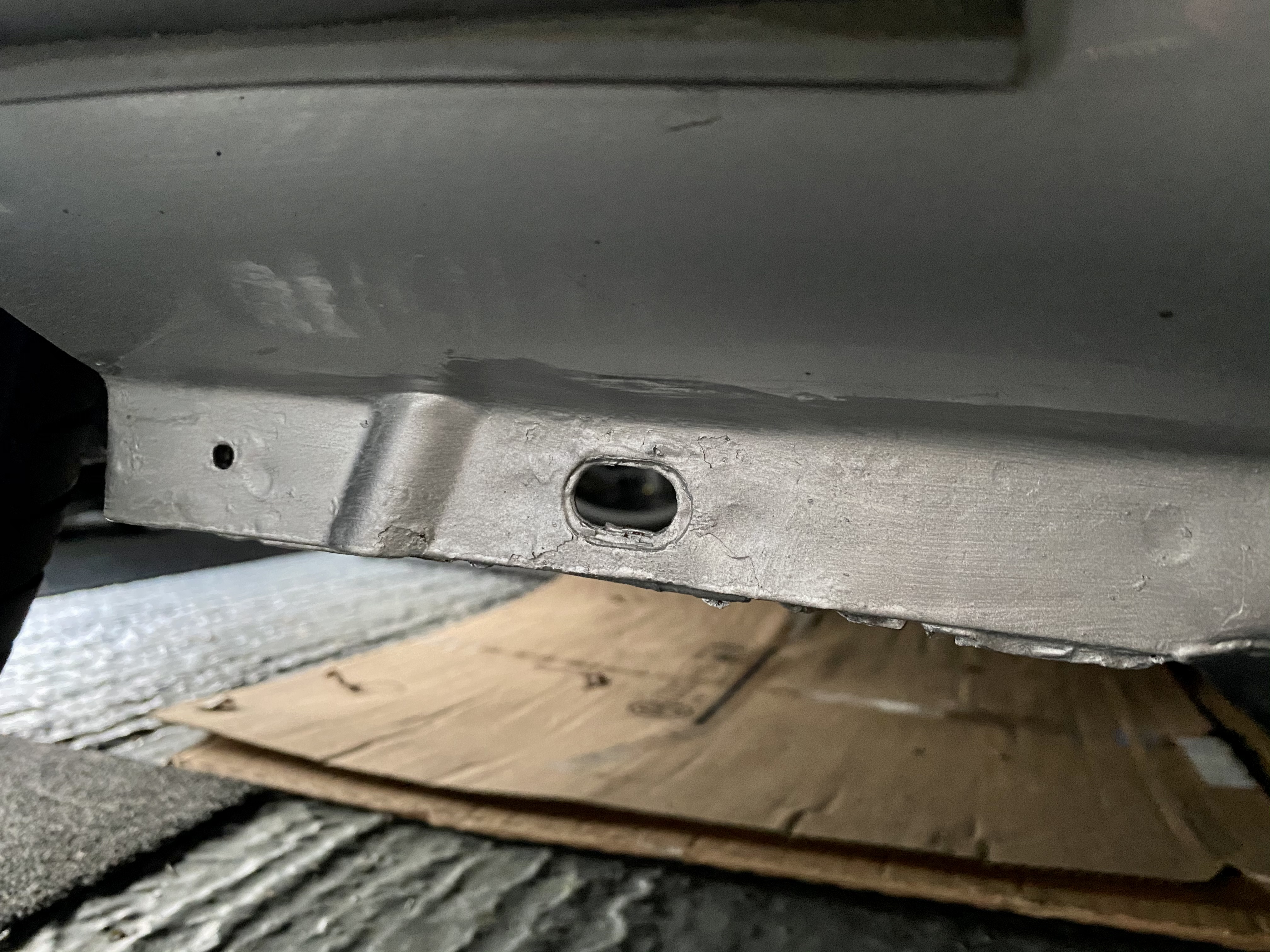

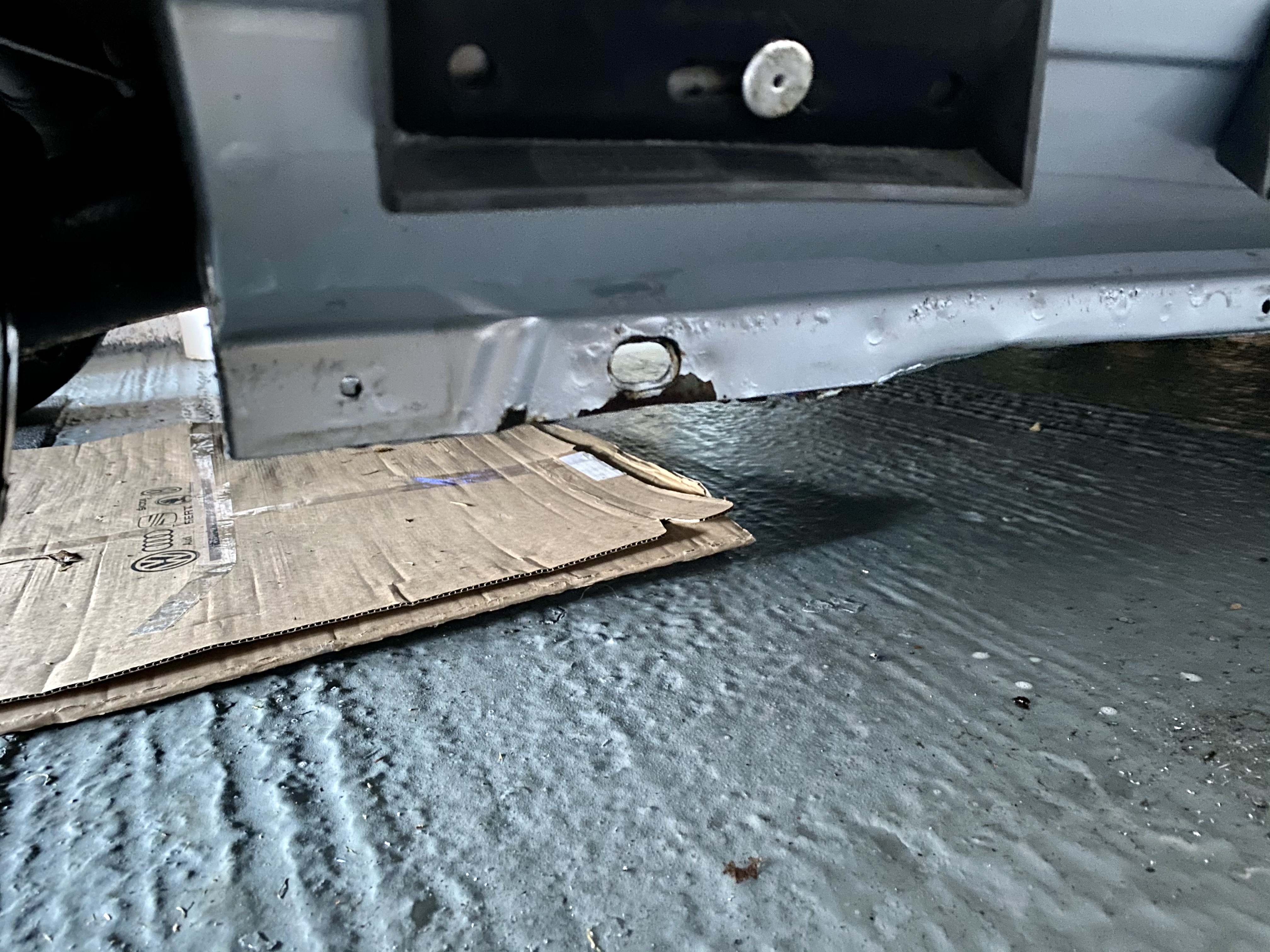

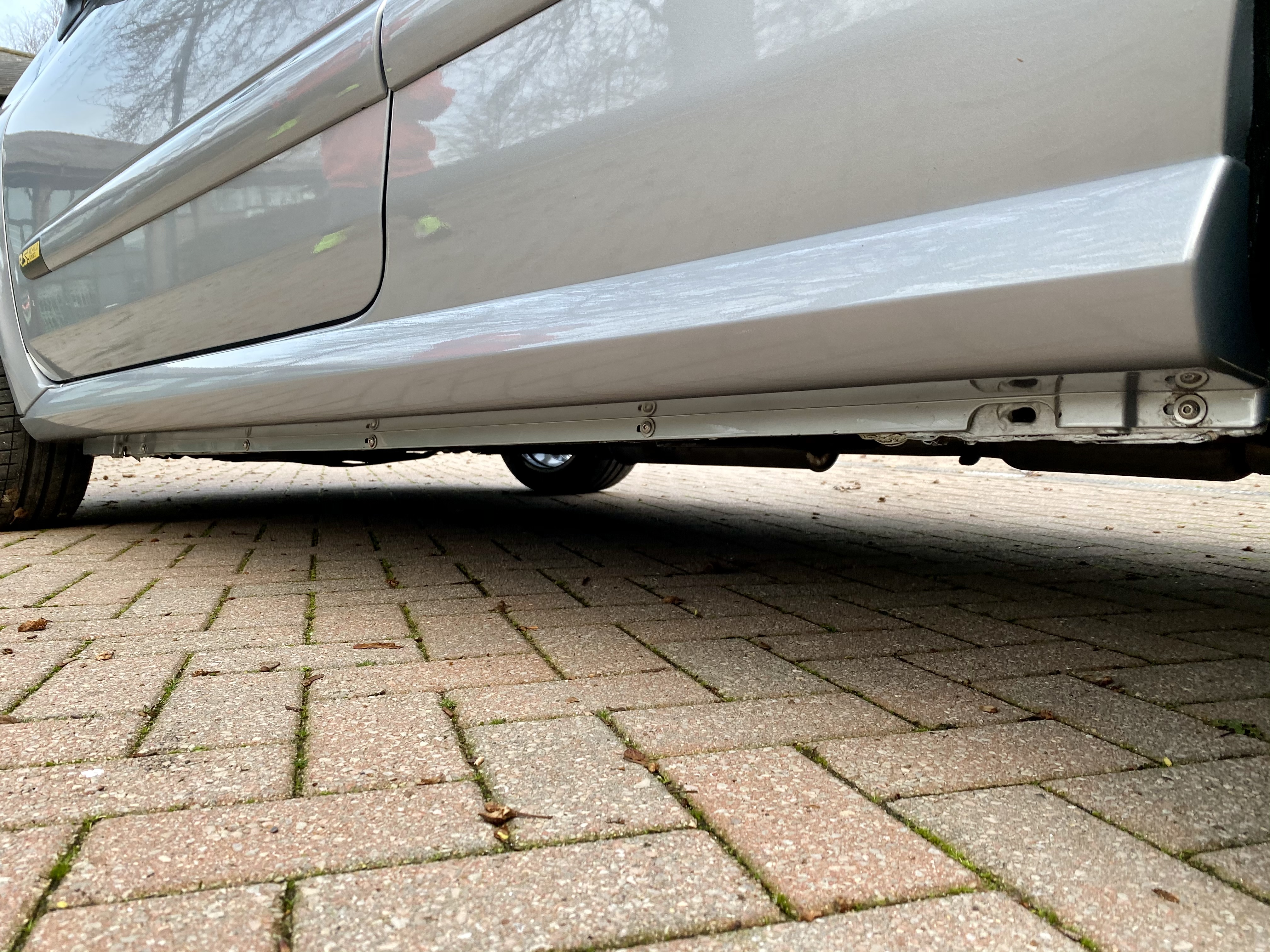

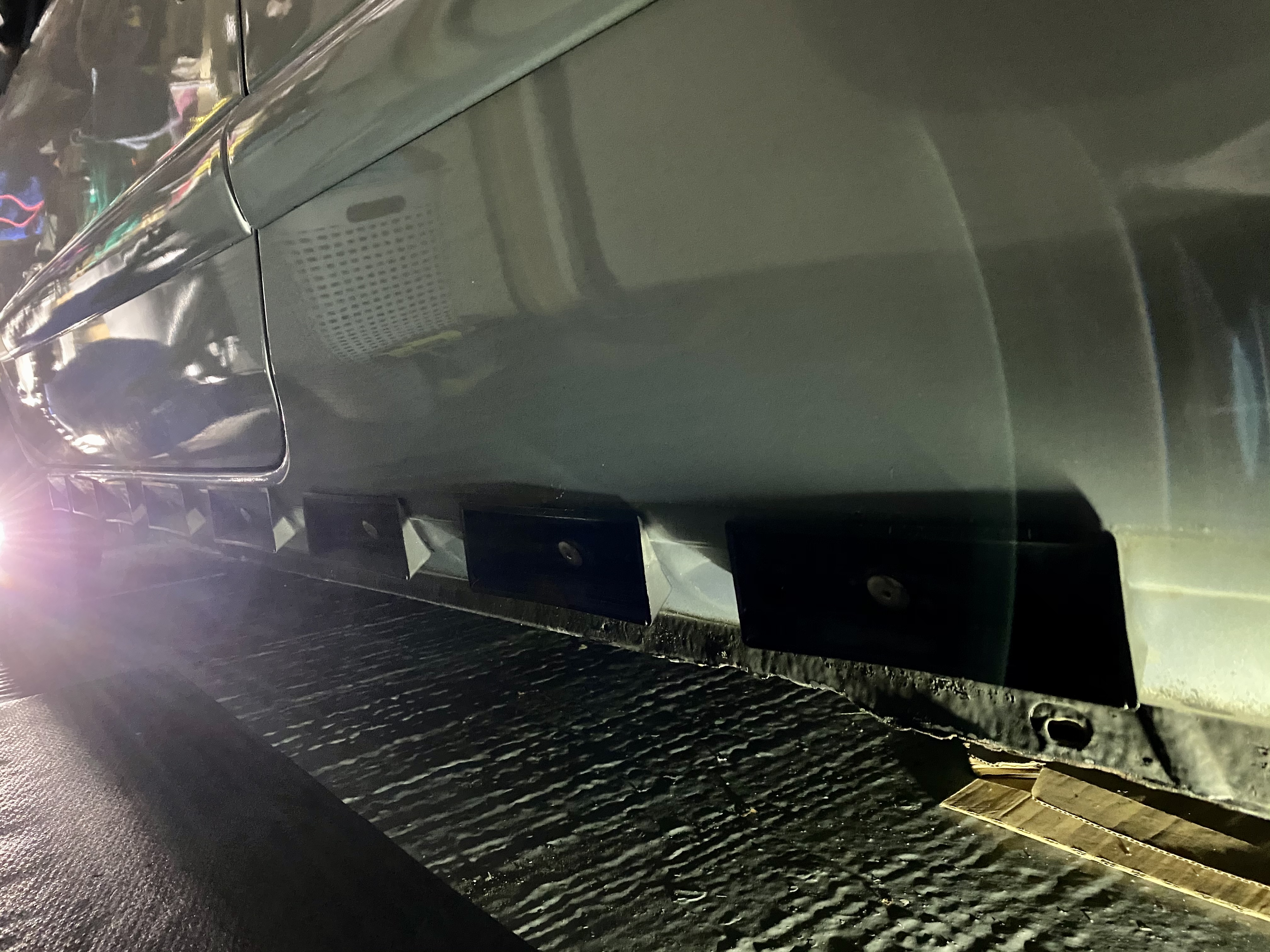

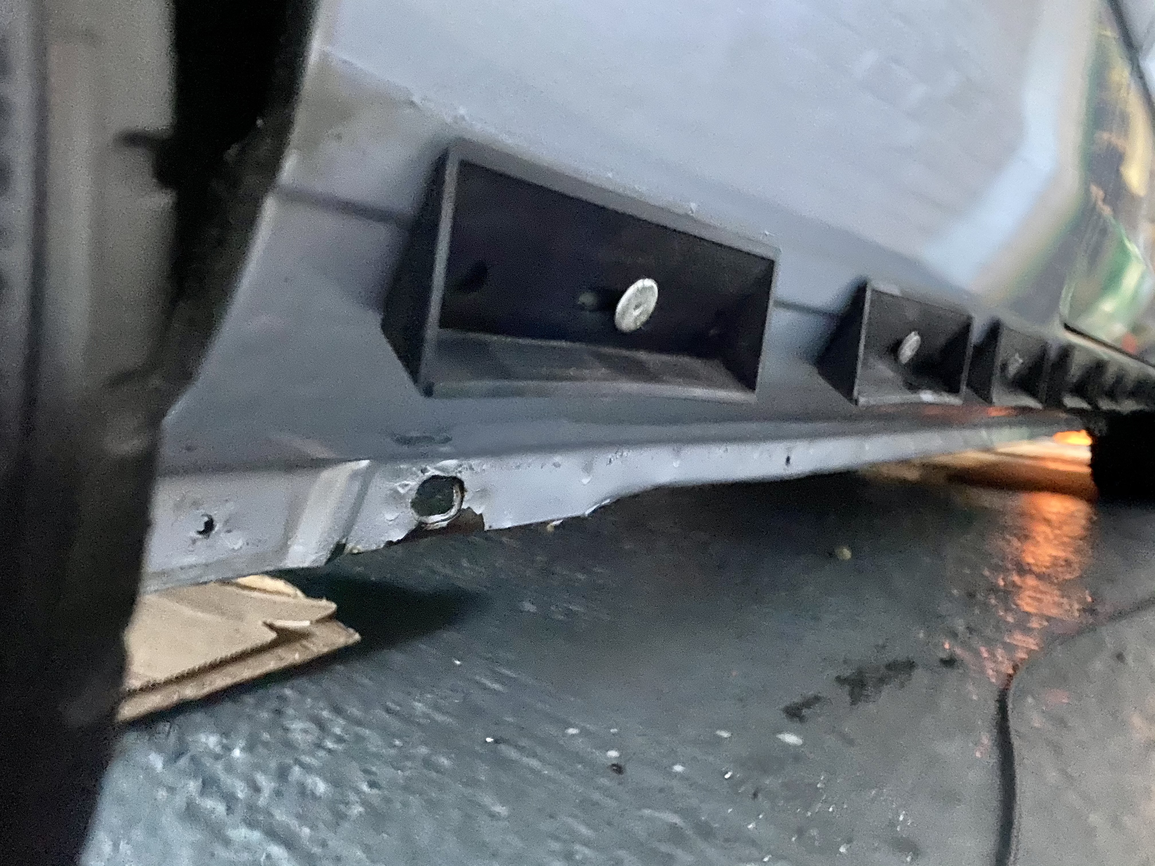

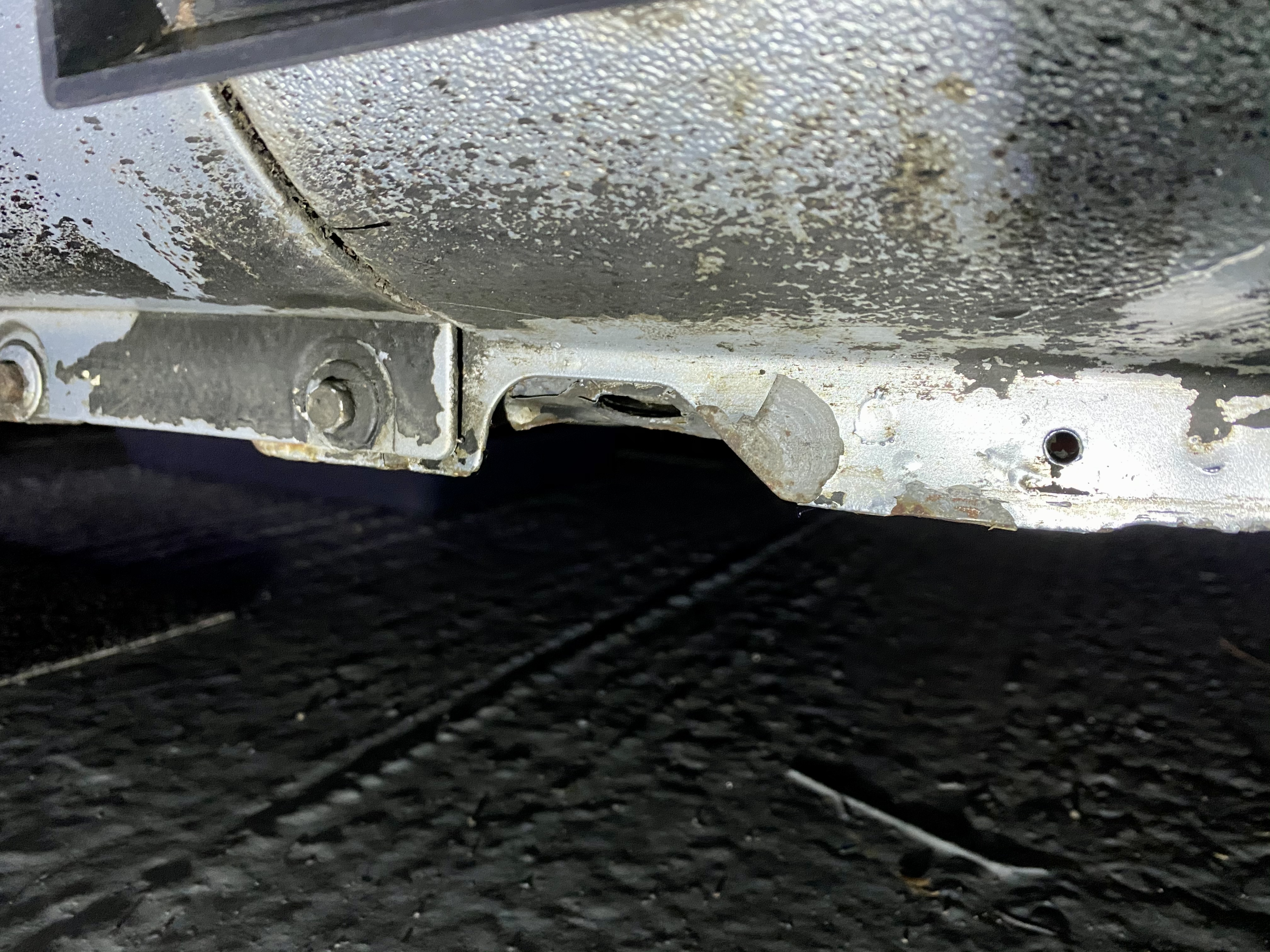

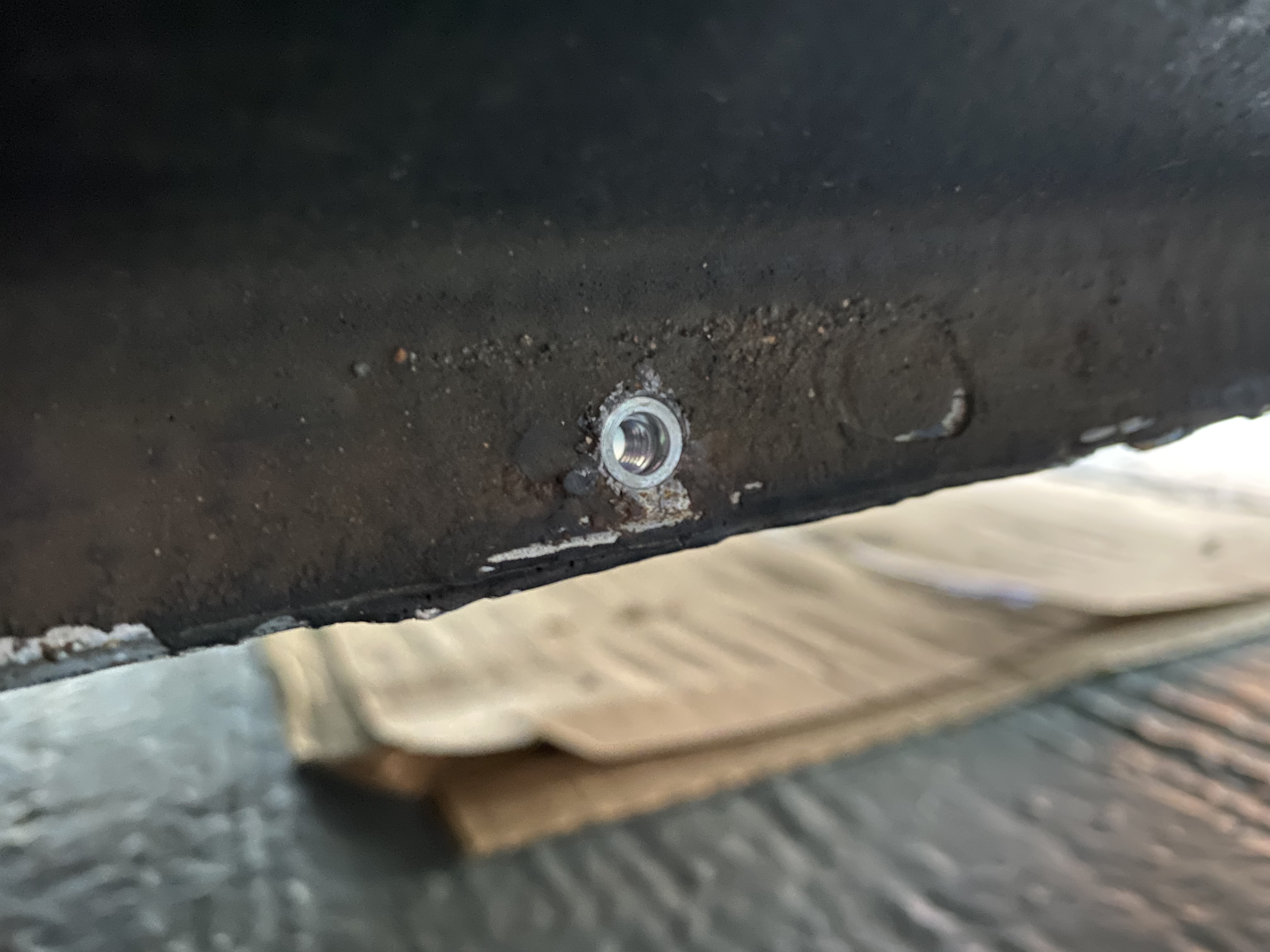

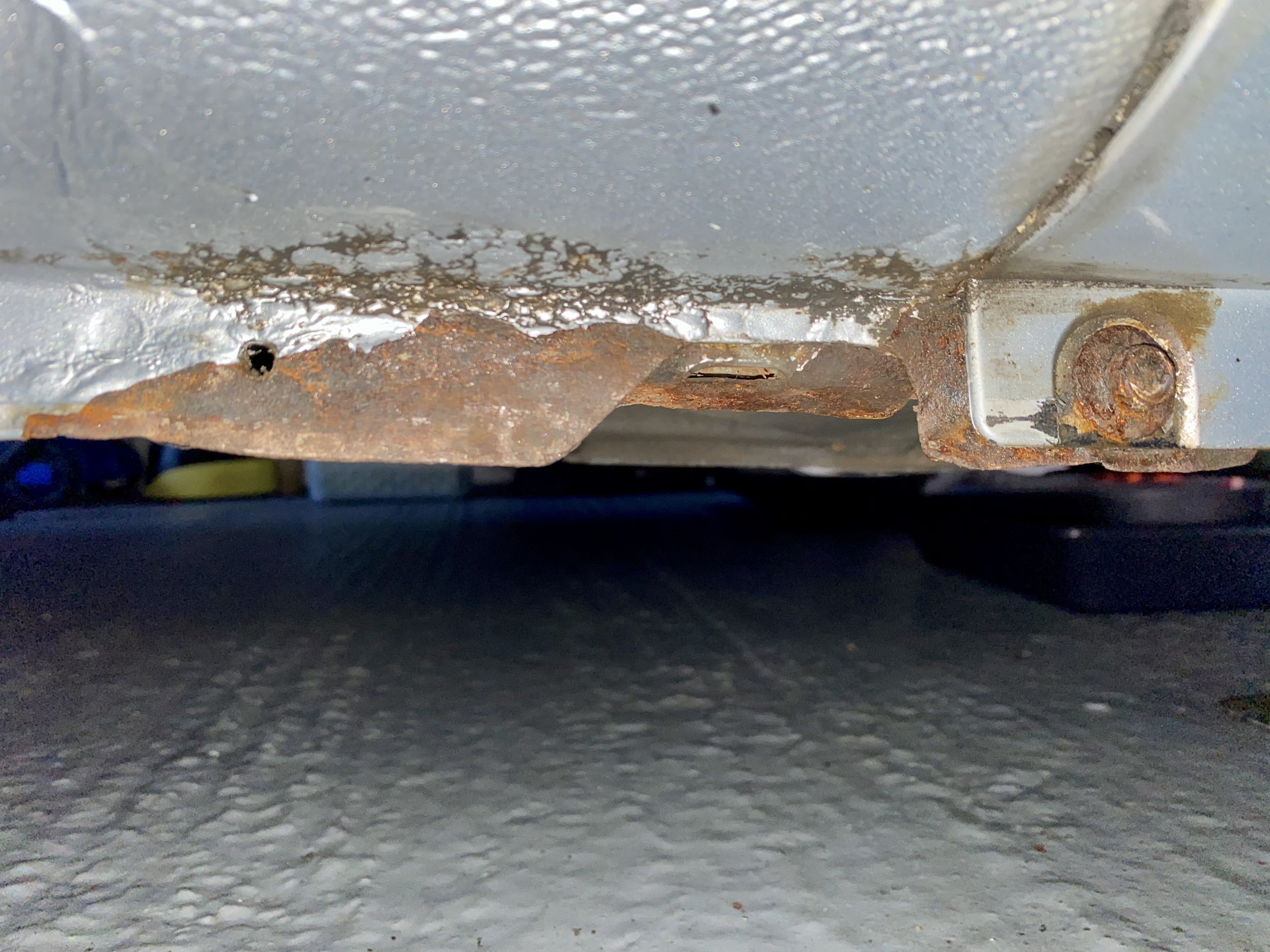

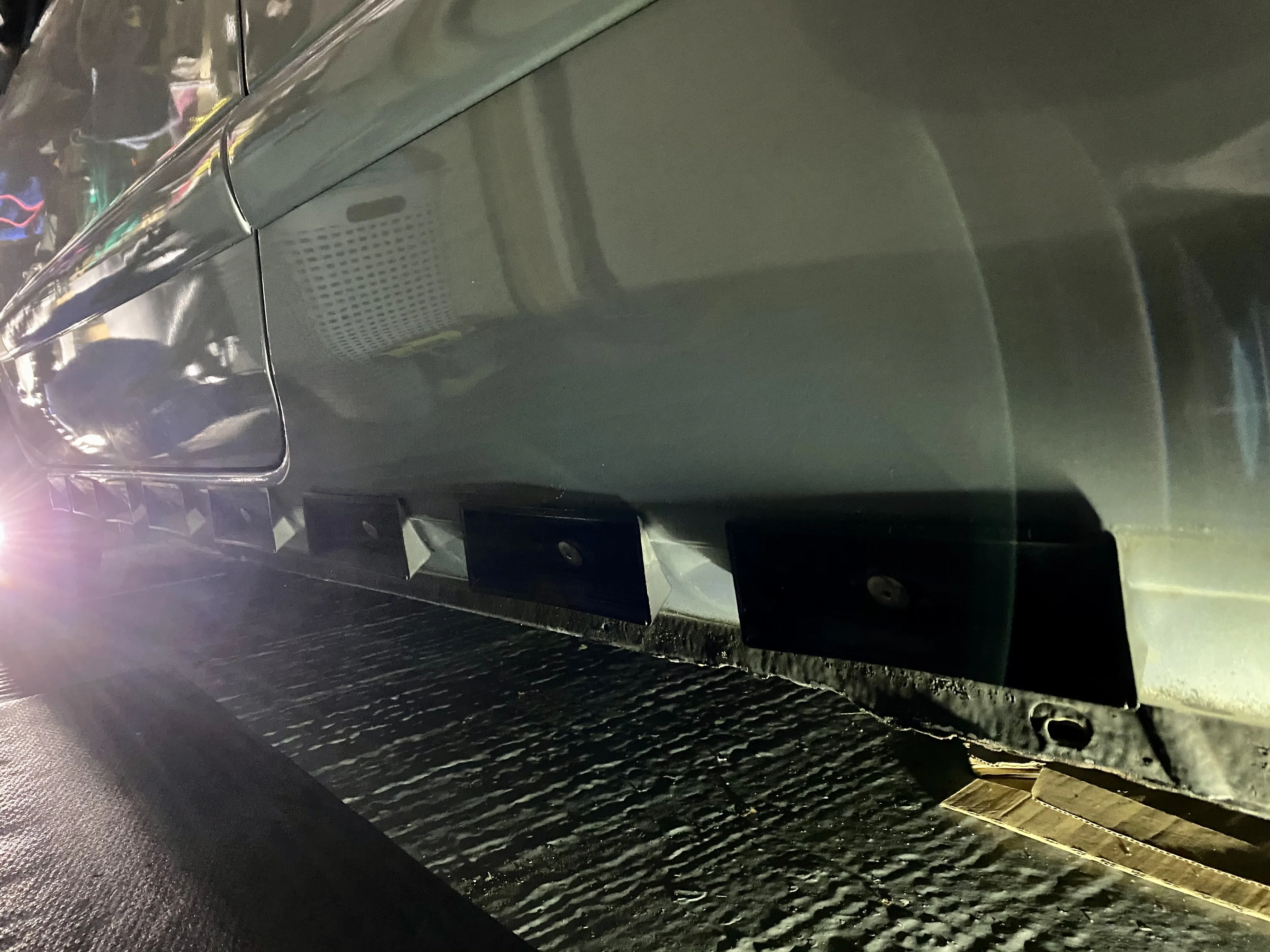

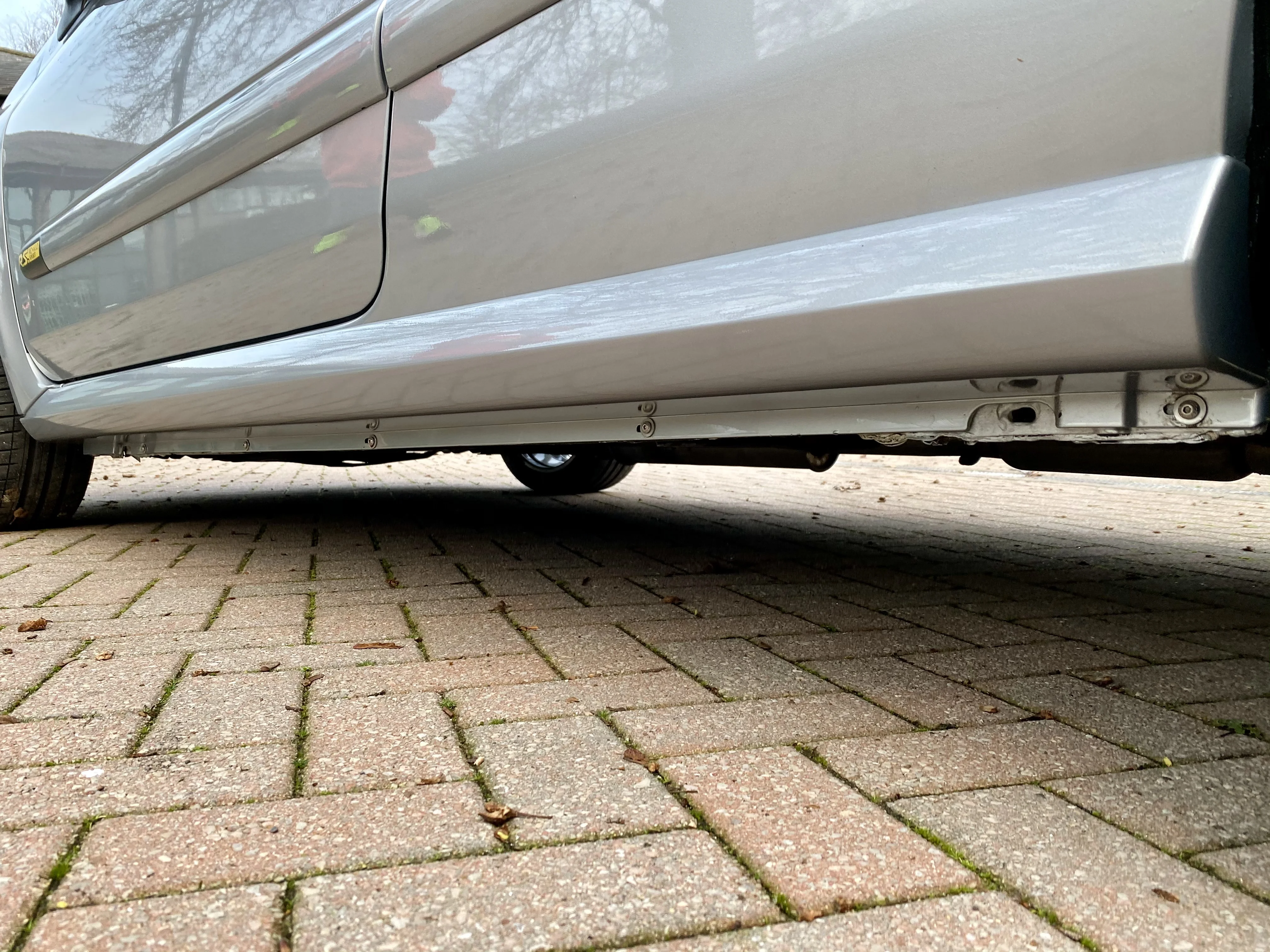

Skirts off today. Good news is that the sills appear solid and rot free. Kinda knew that from looking at them when the car was last in the air. Not so great was trying to straighten the front jacking points as they were crushed almost flat. Driver’s side hasn’t come out too badly but passenger side fought me. Rust treatment applied to the worst bits, lick of silver Hammerite to the bits that weren’t rusty and skirts will be put back on with rivnuts.

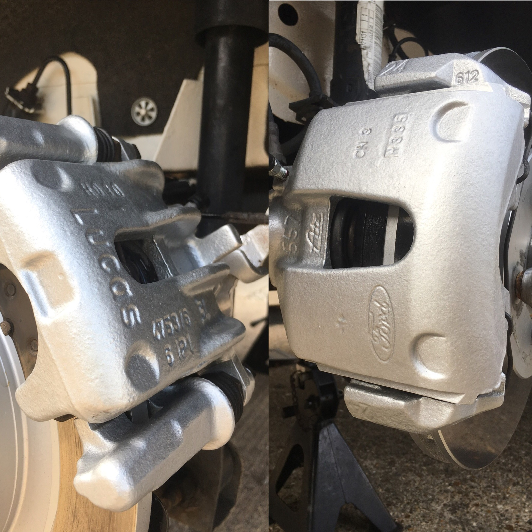

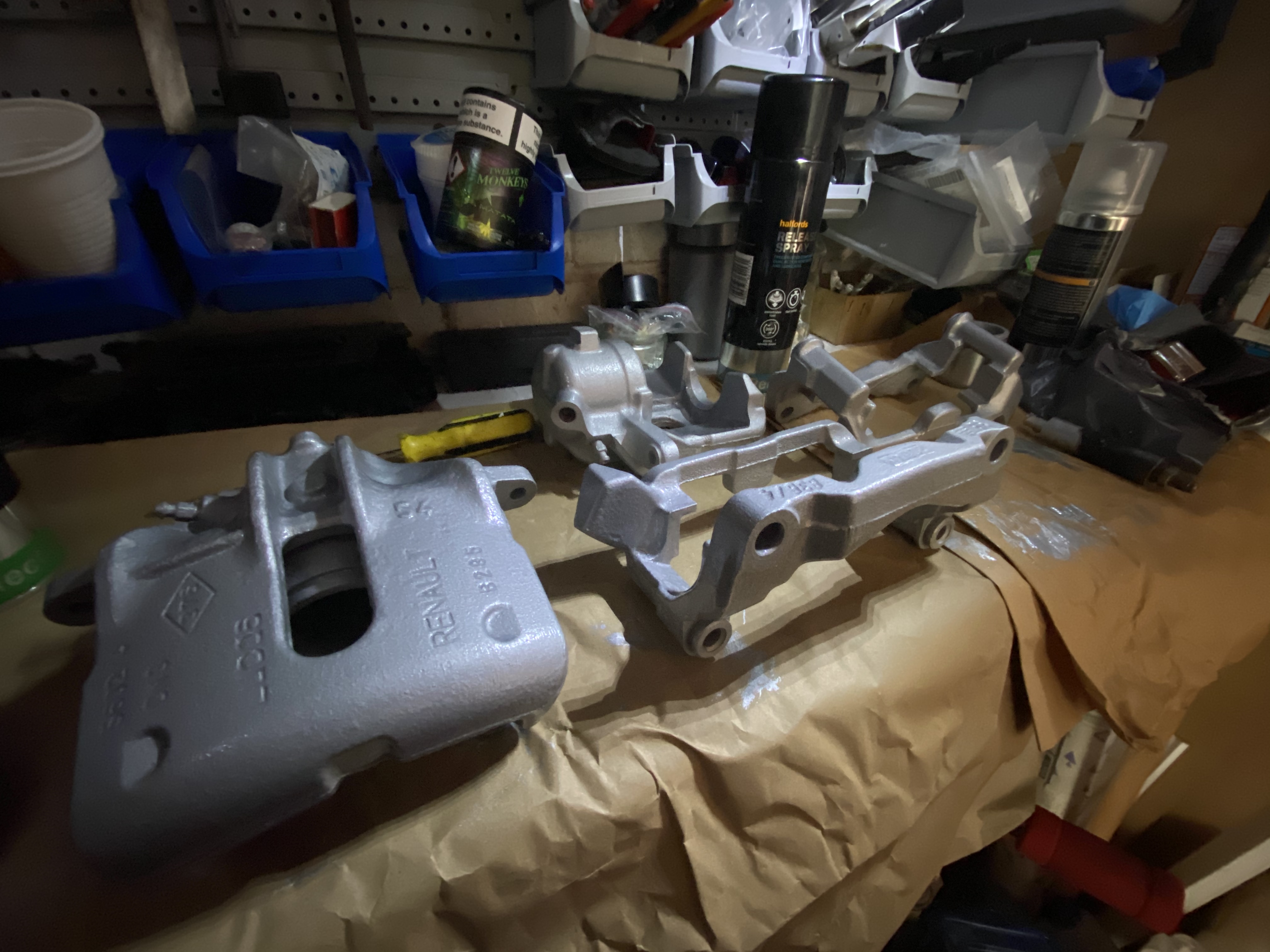

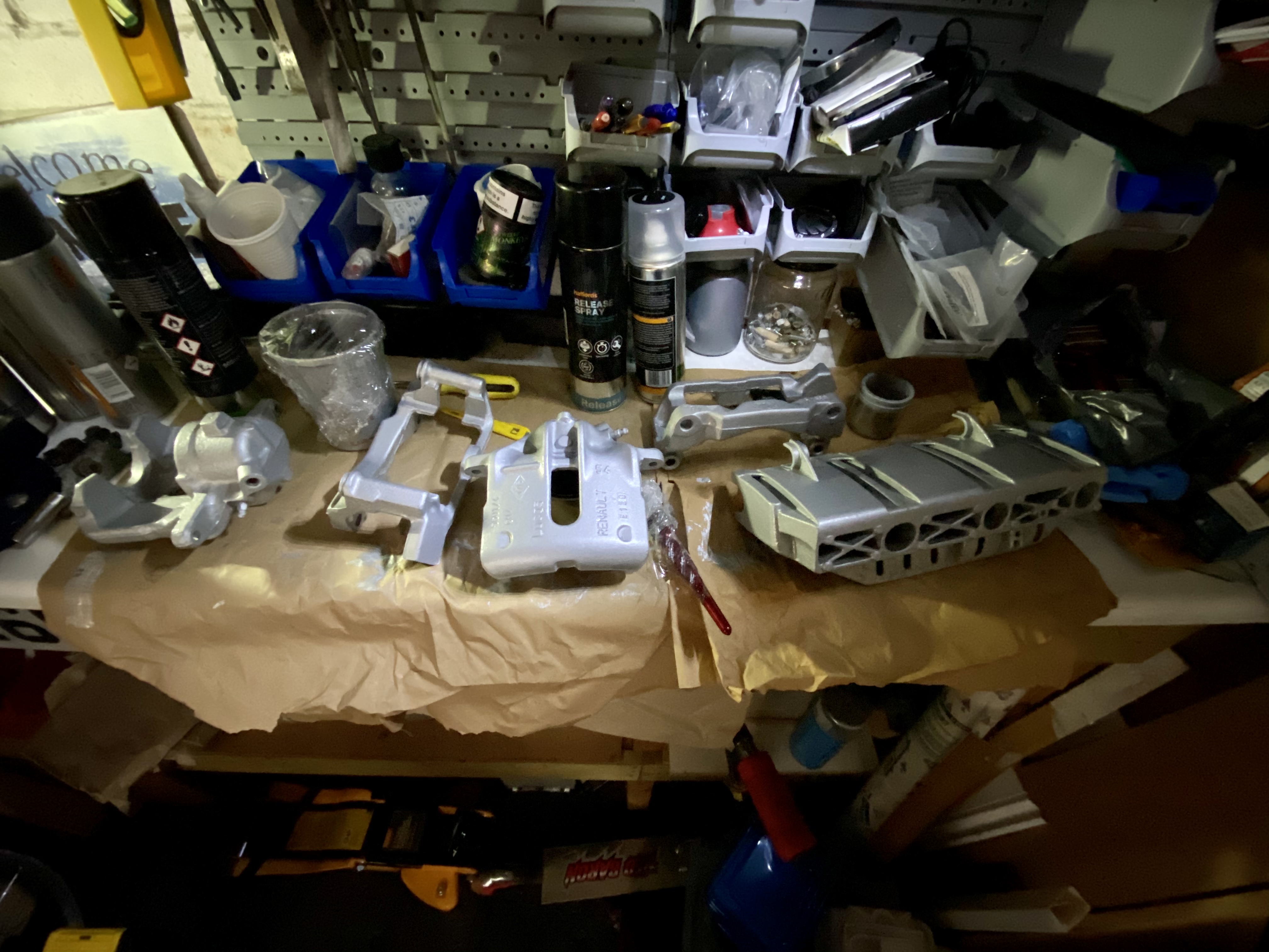

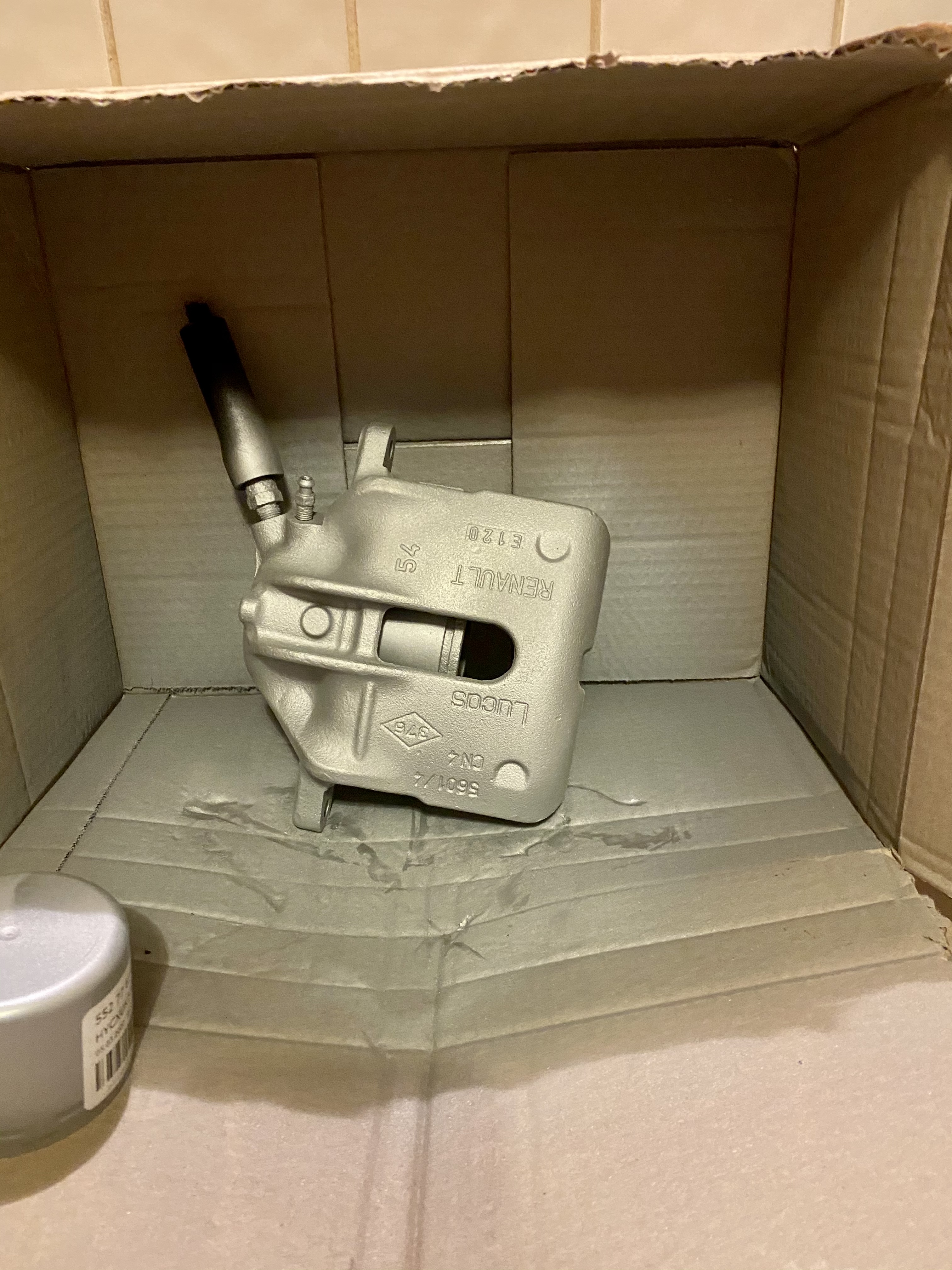

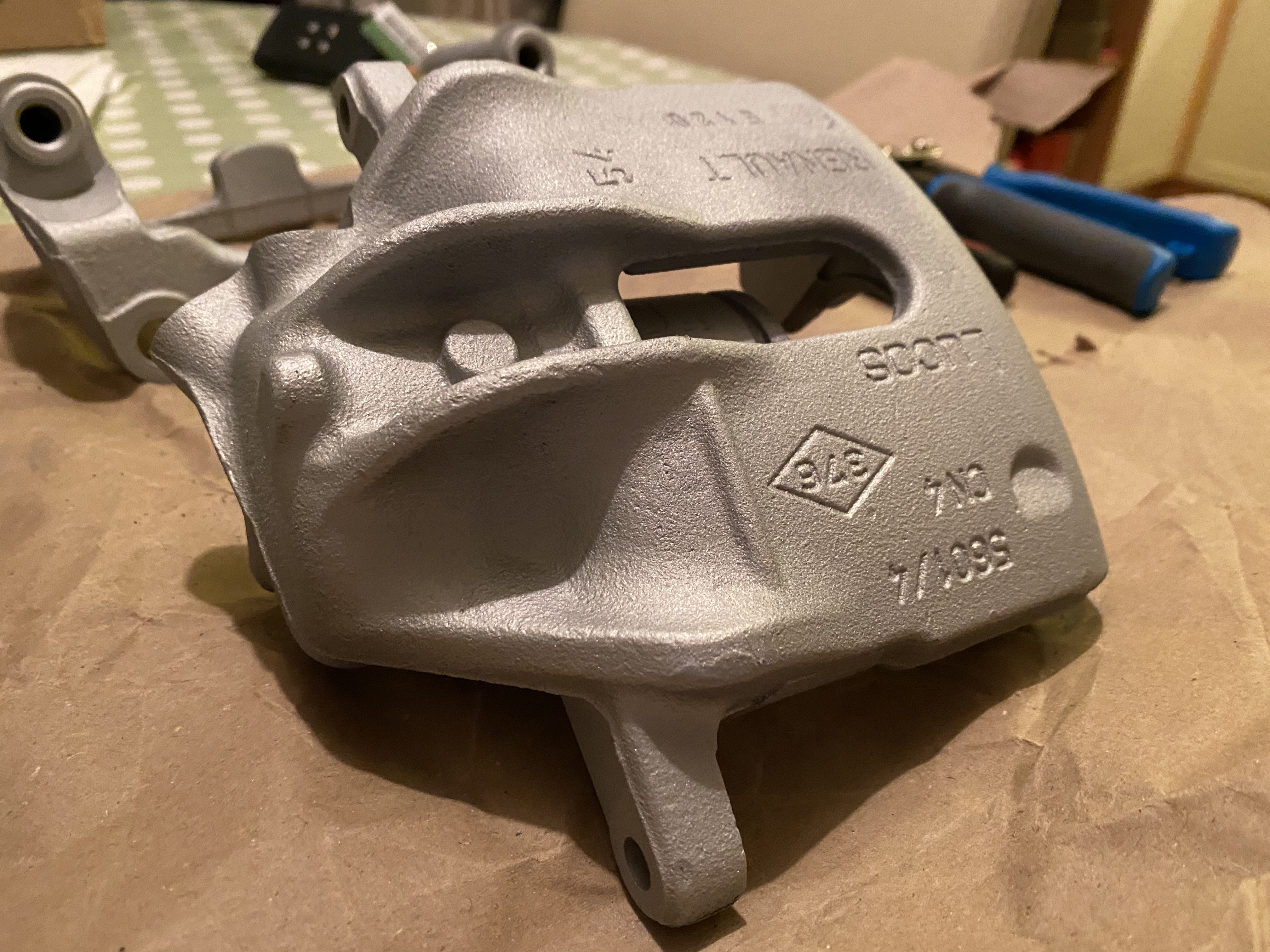

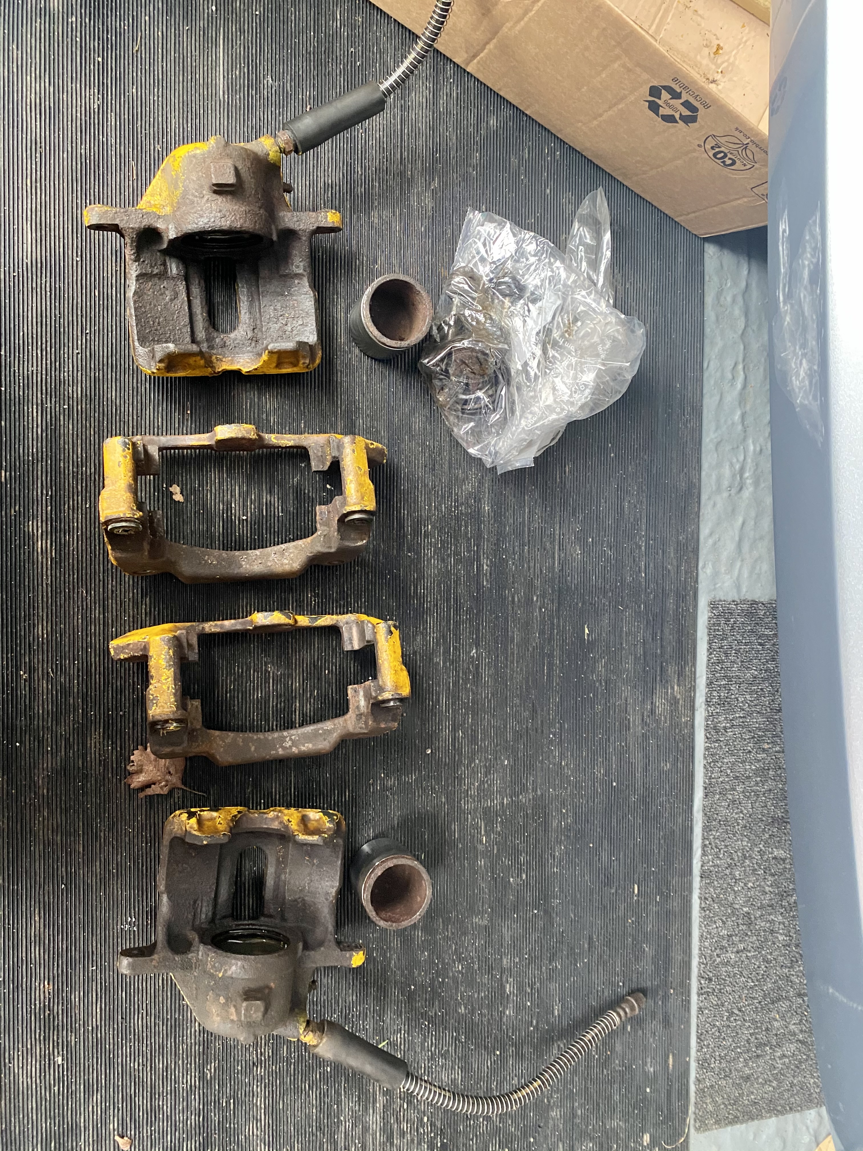

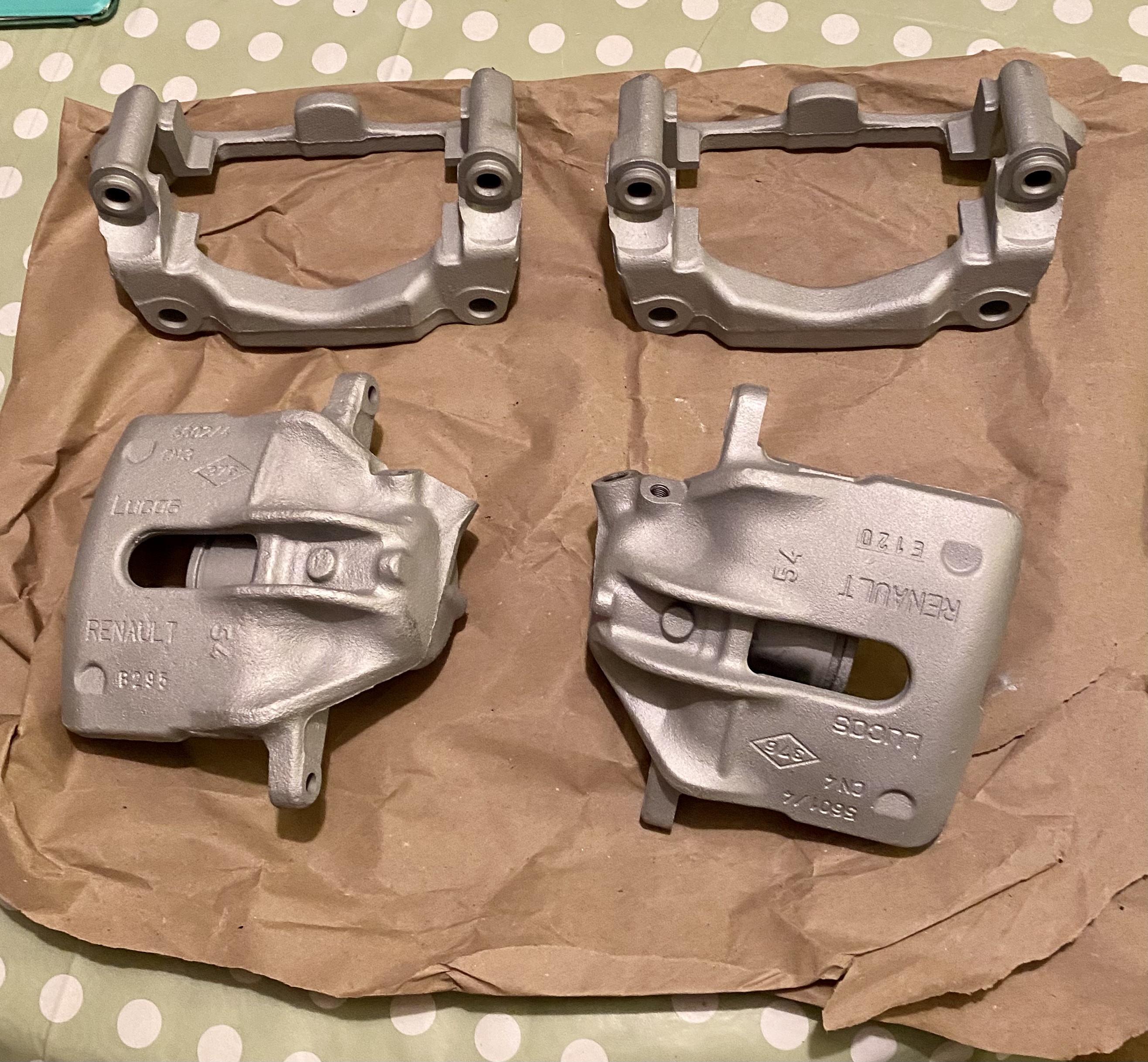

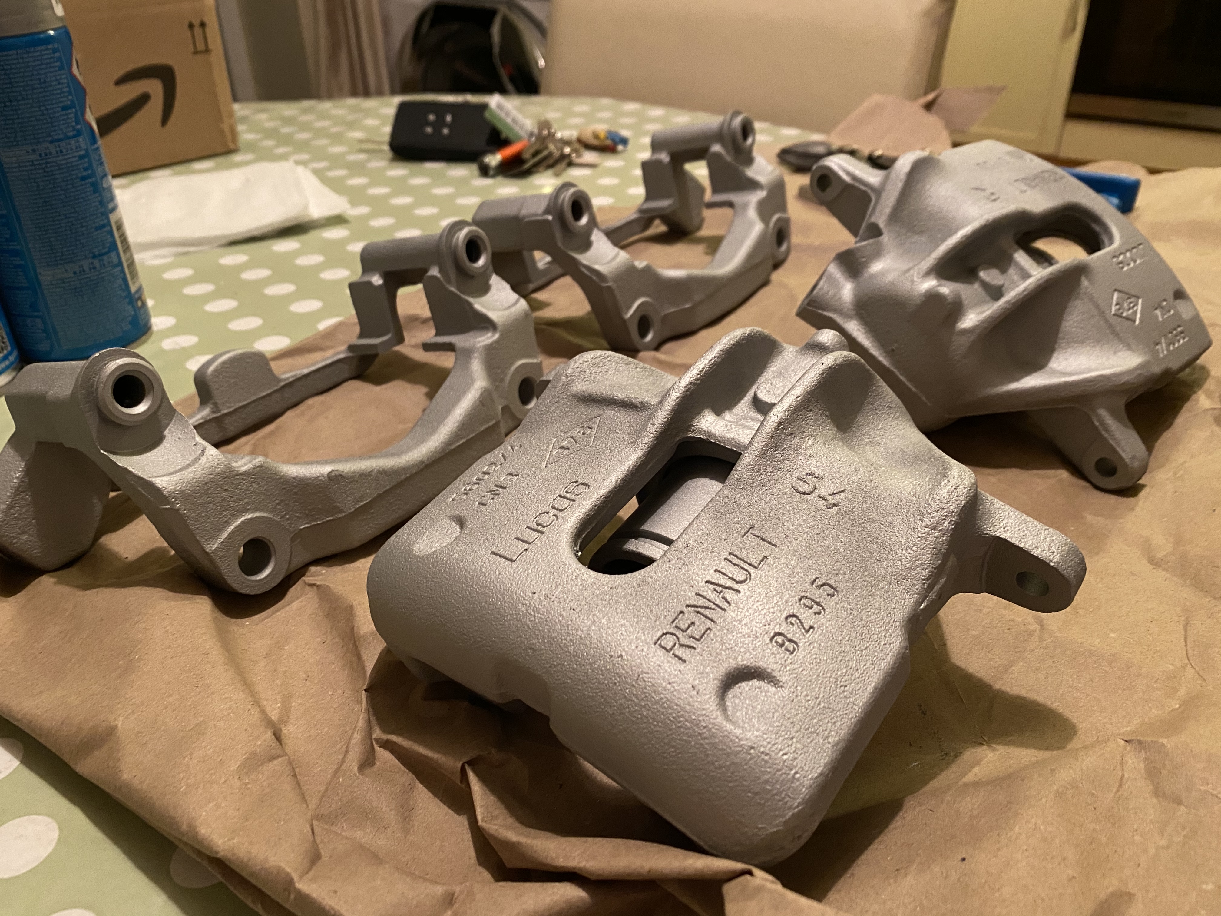

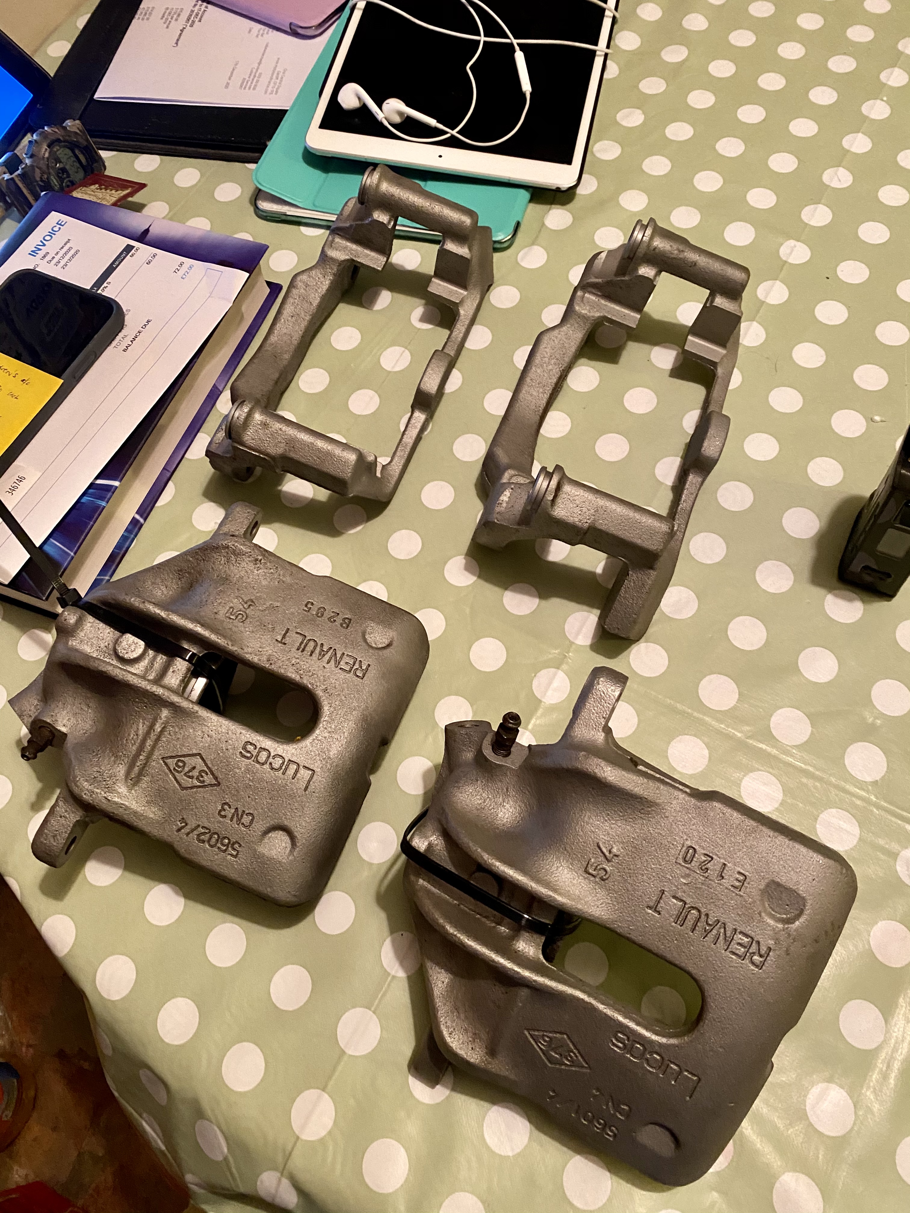

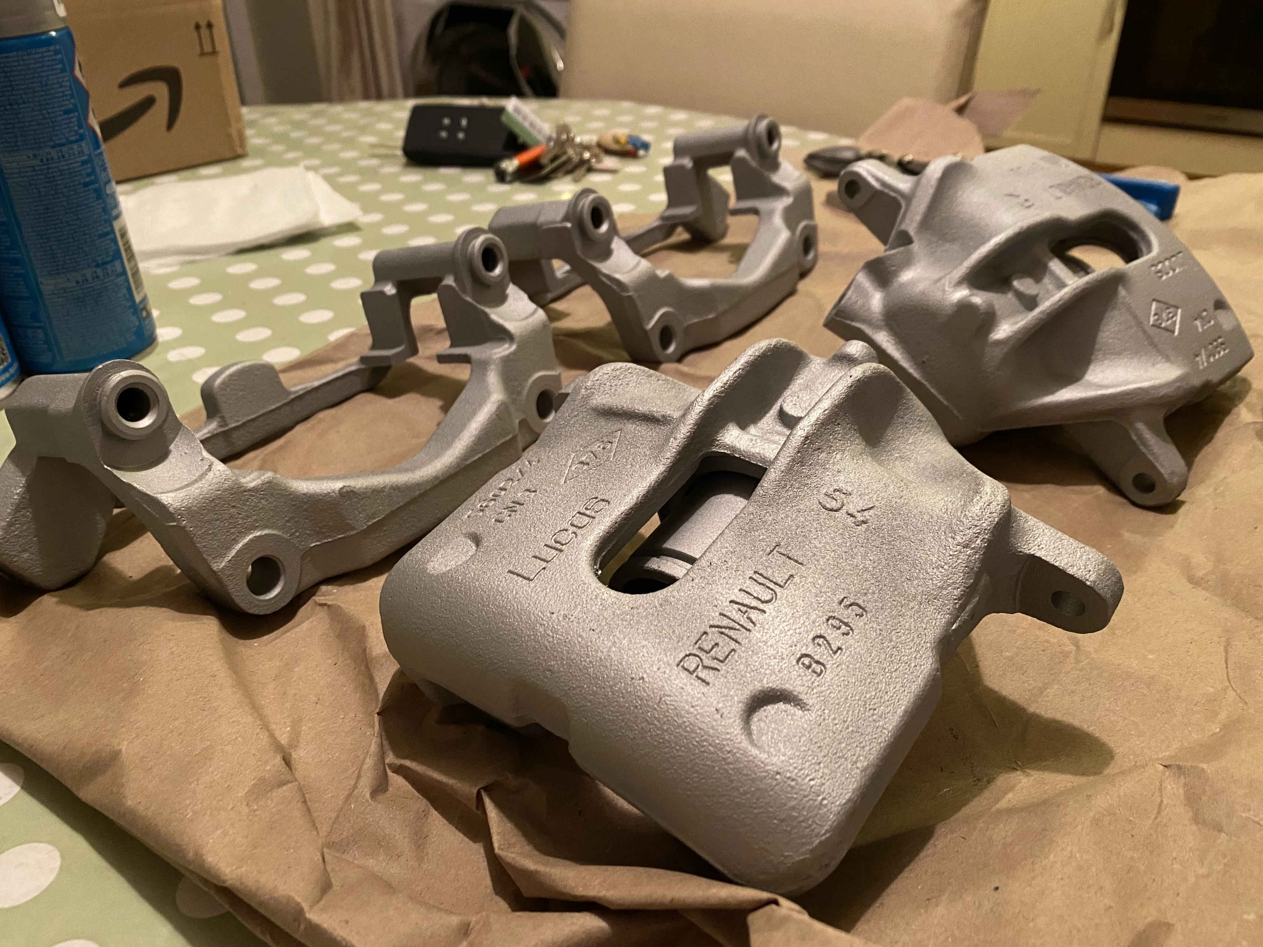

Firstly the front calipers. Mine are Hammerite’d and look OK but I bagged a set from here, had them acid washed and vapour blasted. Picked them up today, chucked them in the oven for a few minutes then 2 coats of VHT silver. Makeshift paint booth was even rubber stamped by the boss 👍
I’ve ordered a rebuild kit and will be upgrading disc and pad and adding stainless bleed nipples and hoses before refitting.

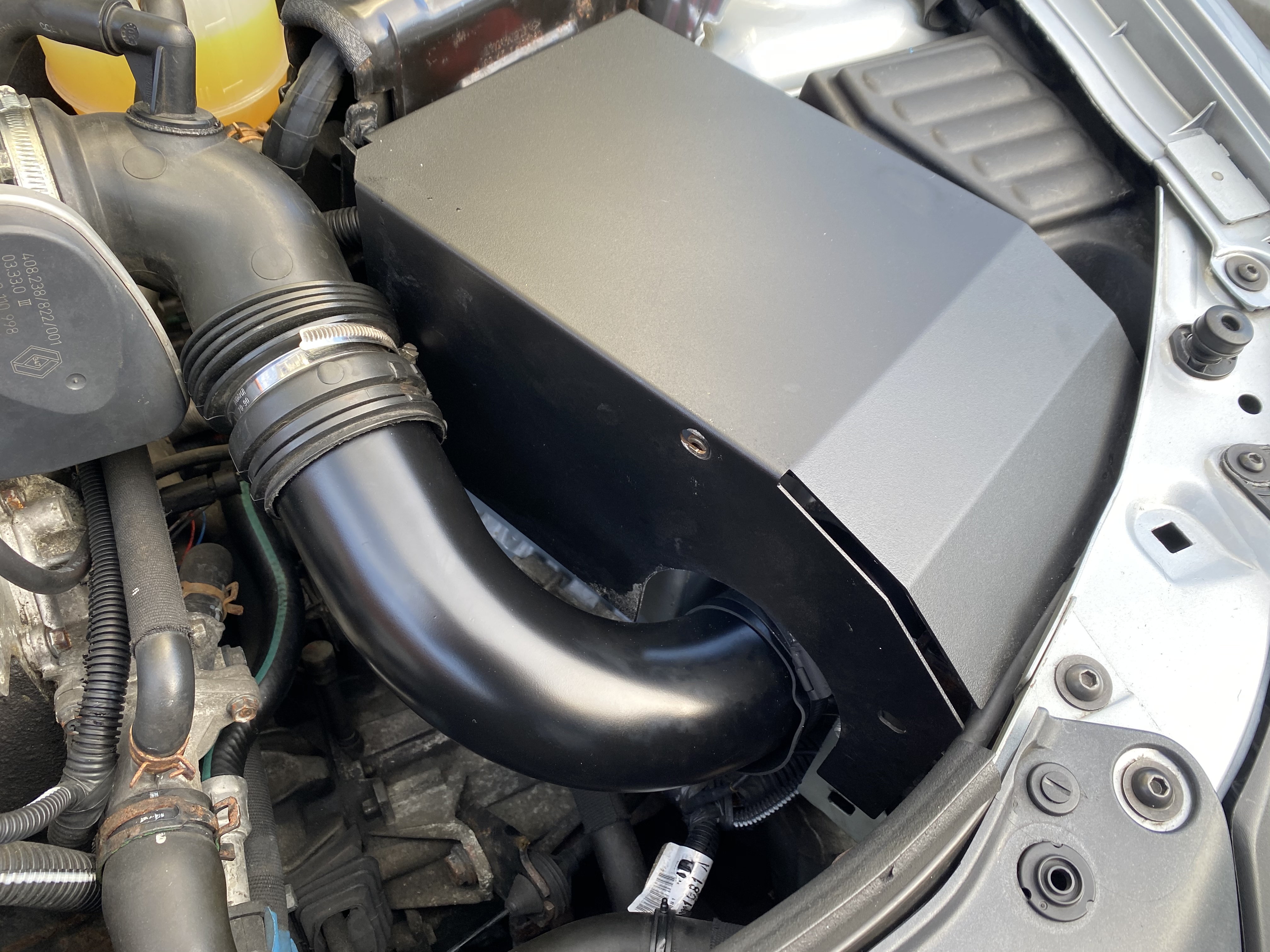

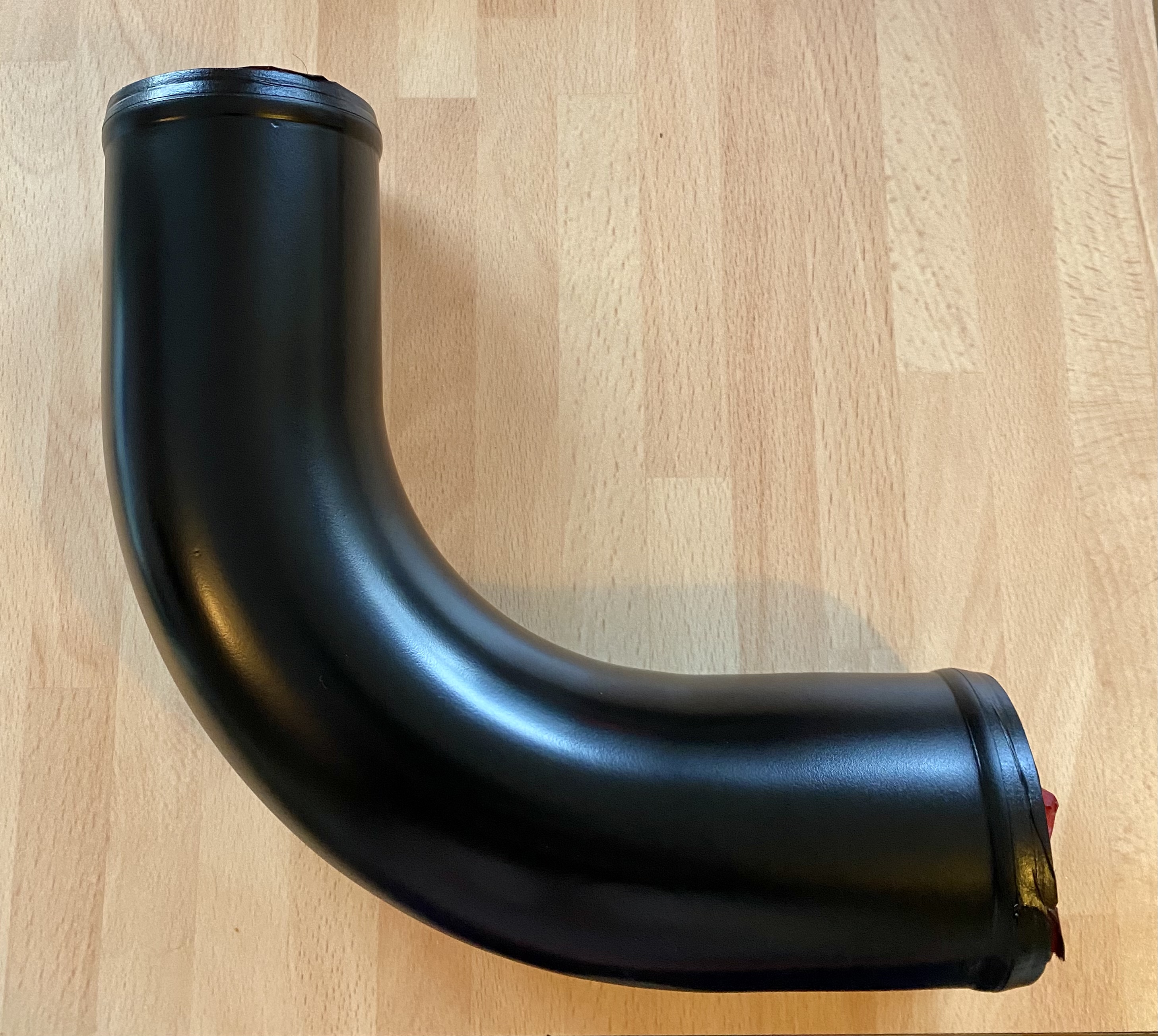

I’ve also painted my fatty induction pipe satin black. It was looking a bit sorry for itself and I hate polishing metal so took the lazy route. Etch primed and 3 coats of paint.

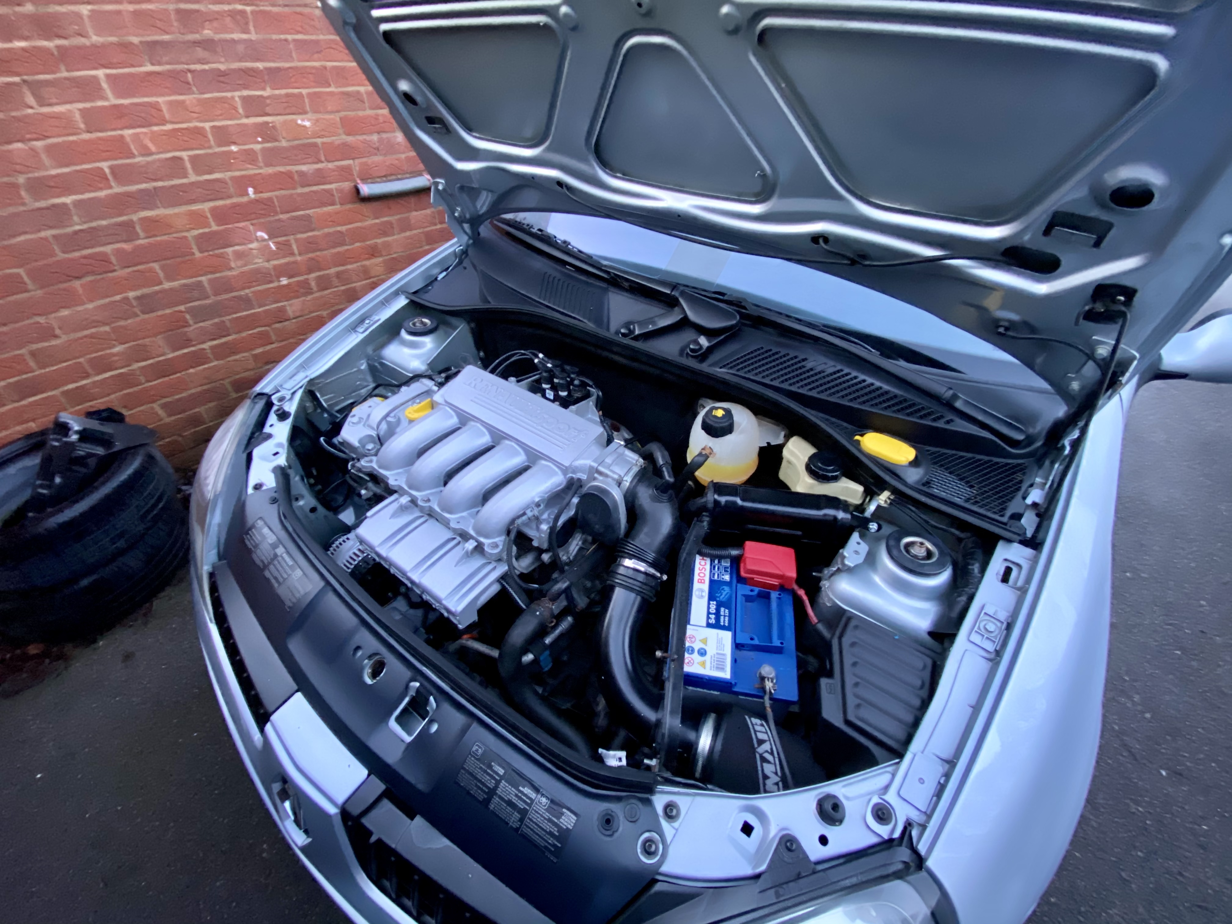

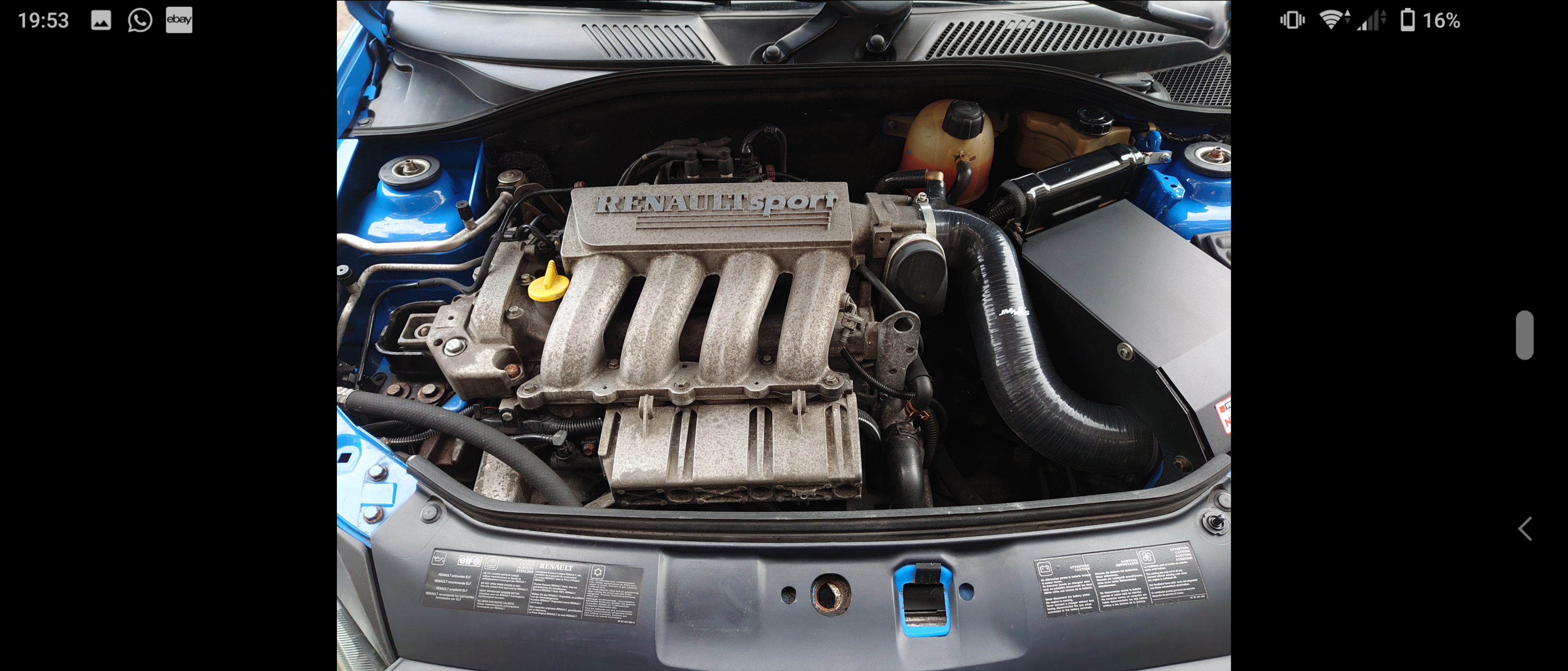

Repainted intake pipe fitted - looks neater. Took her out for a quick spin around the block at the weekend as she hasn’t run in a while. Now back in the garage as lockdown v3.0 looms. Engine bay tidy up will be the next job.
Ignore the sorry engine bay. I bought the jmrs pipe in black think it tidied up the bay nicely

I hope you have better luck with it Andy, but i found VHT silver just let the calipers rust through in no time. It looks beautiful when applied but is porous and just lets moisture in to the freshly blasted calipers and they rust in a couple of weeks.
Ideally you want an enamel paint for the calipers,even if just Hammerite.
Foliatec caliper paint kits are good,with a good choice of colours to pick from.
Cheers bud - I haven’t fitted yet but will bear that in mind. I have silver Hammerite 👍
I didn’t know that sir - thanks. As above, not refitted yet so hopefully I can rescue with a couple of coats of Hammerite!

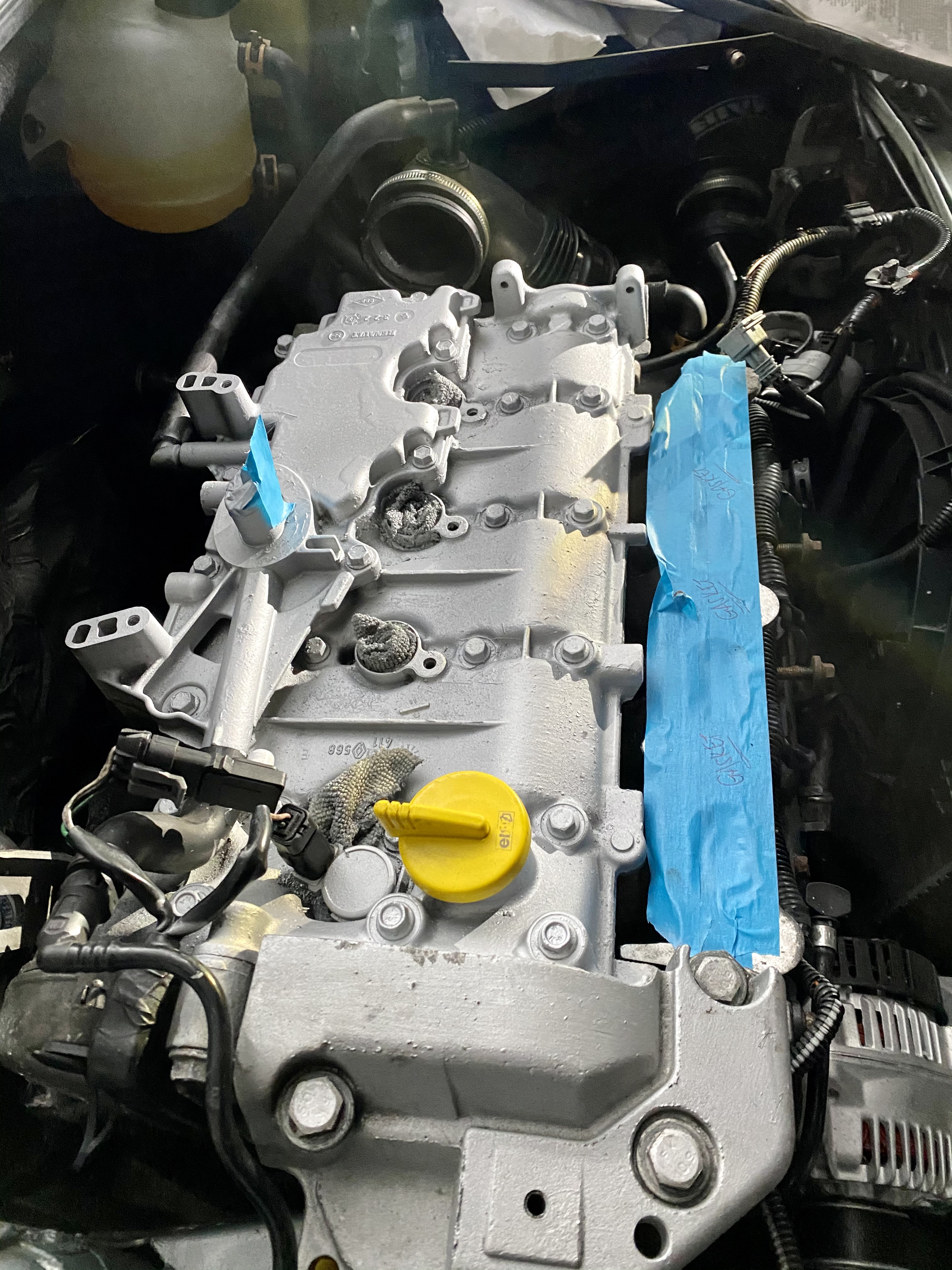

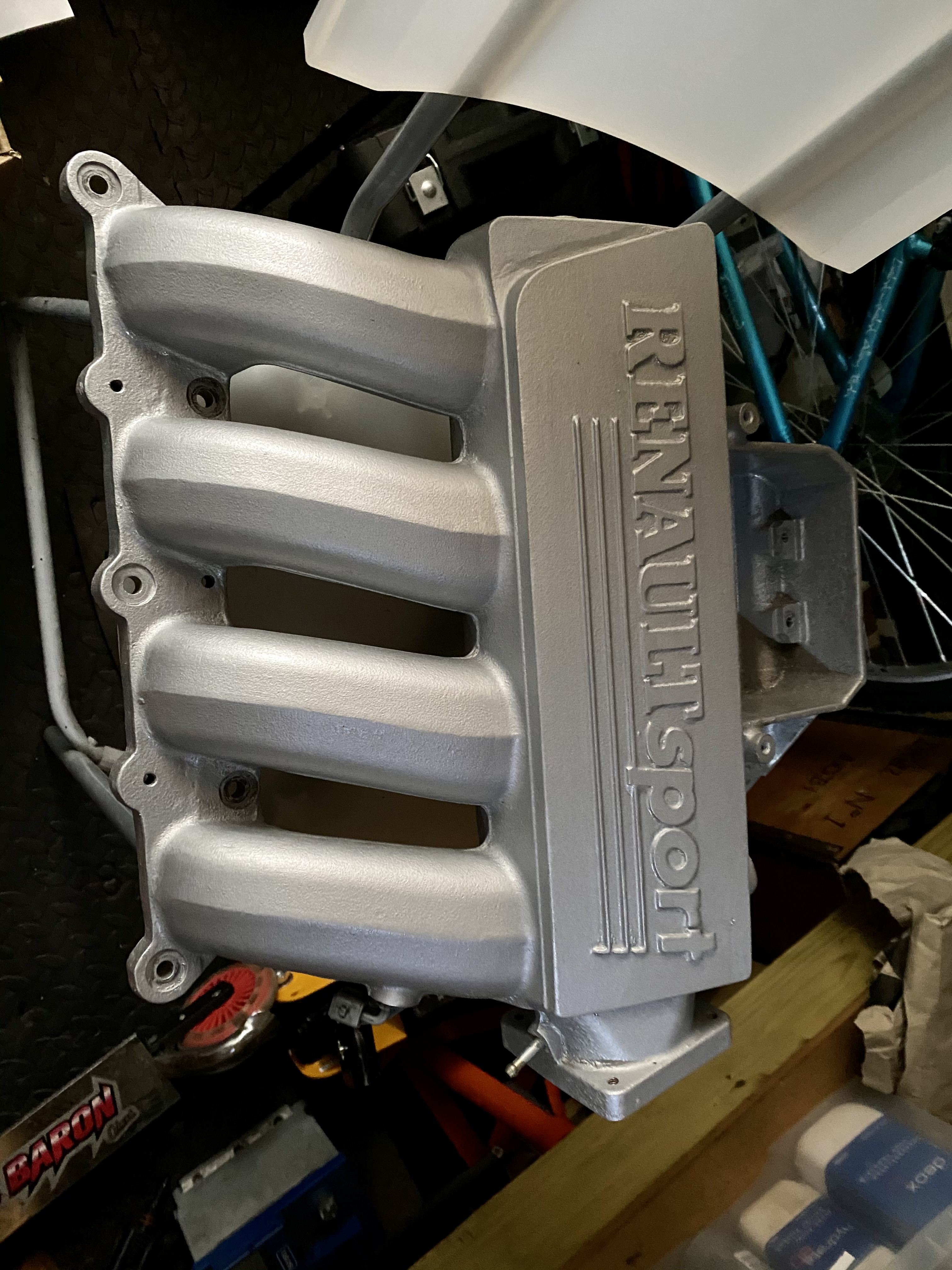

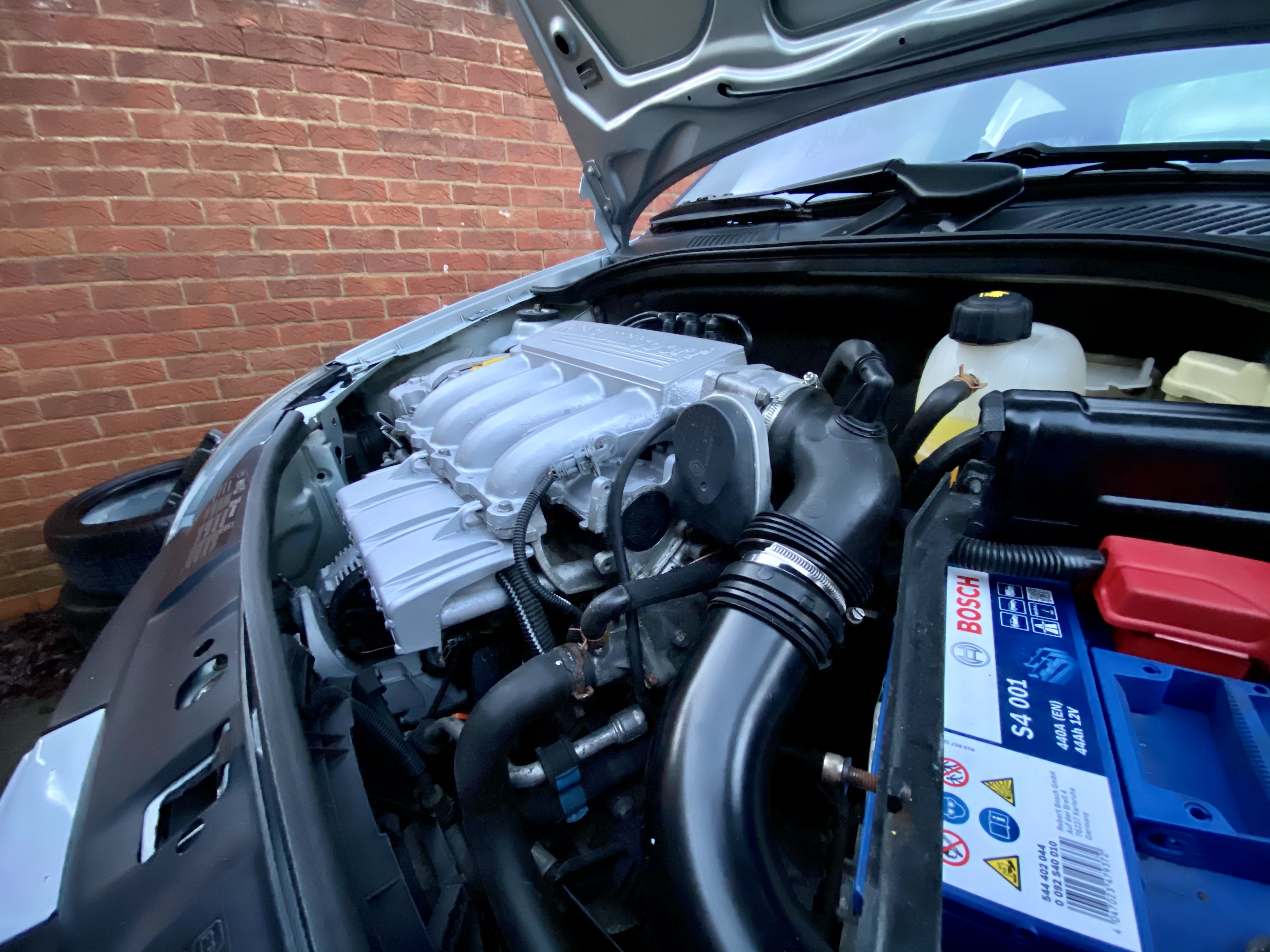

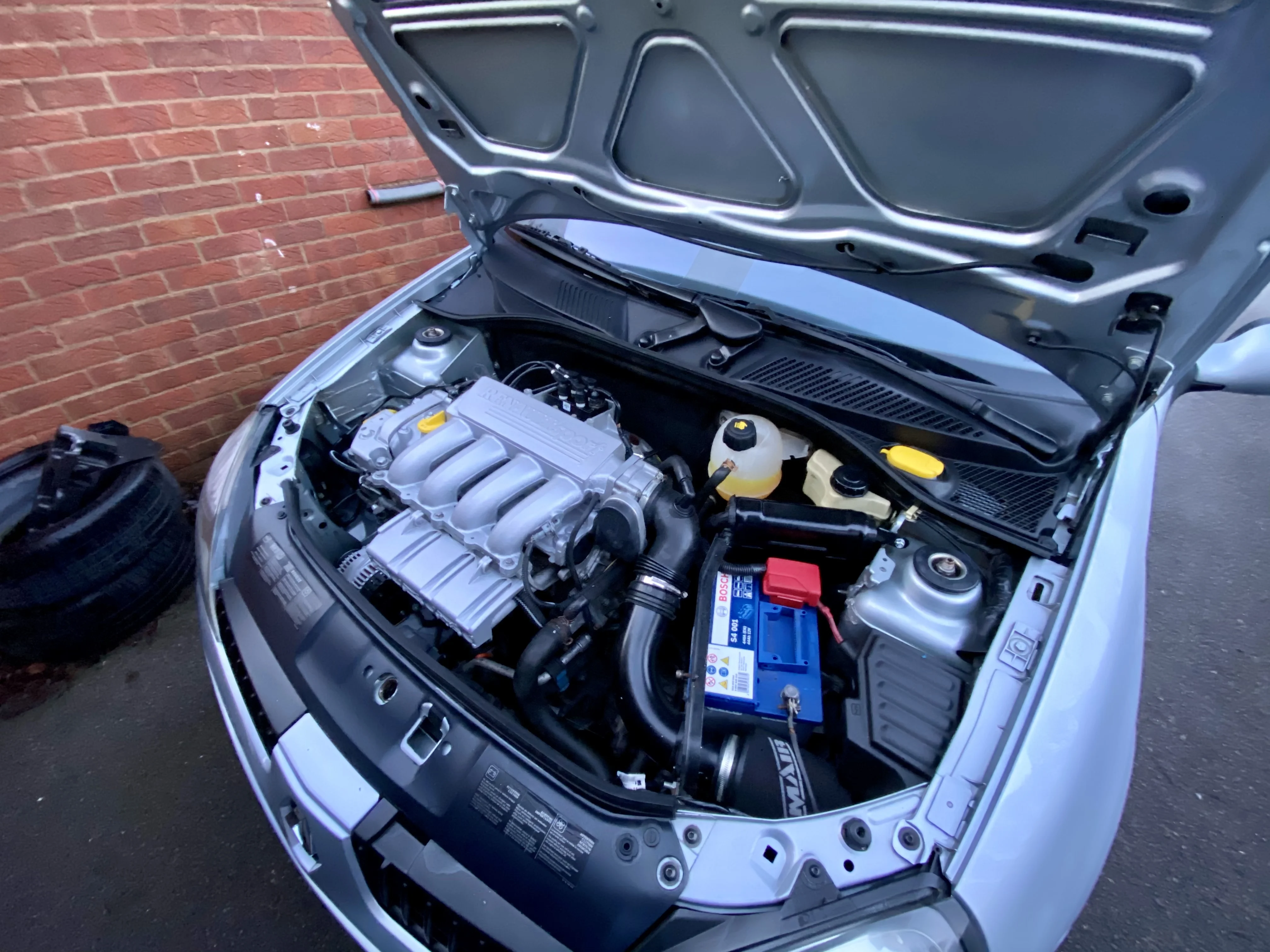

So with bugger all to do in the way of driving it, started on a mild tidy up of the engine bay. ECU cover painted, repair bracket fitted, inlet manifold, fuel rail and can cover painted.
I’ve also started repainting the spare calipers in Hammerite per @frayz suggestion - thinned it down to give a half decent finish.
The more I do the more needs doing 🤦‍♀️

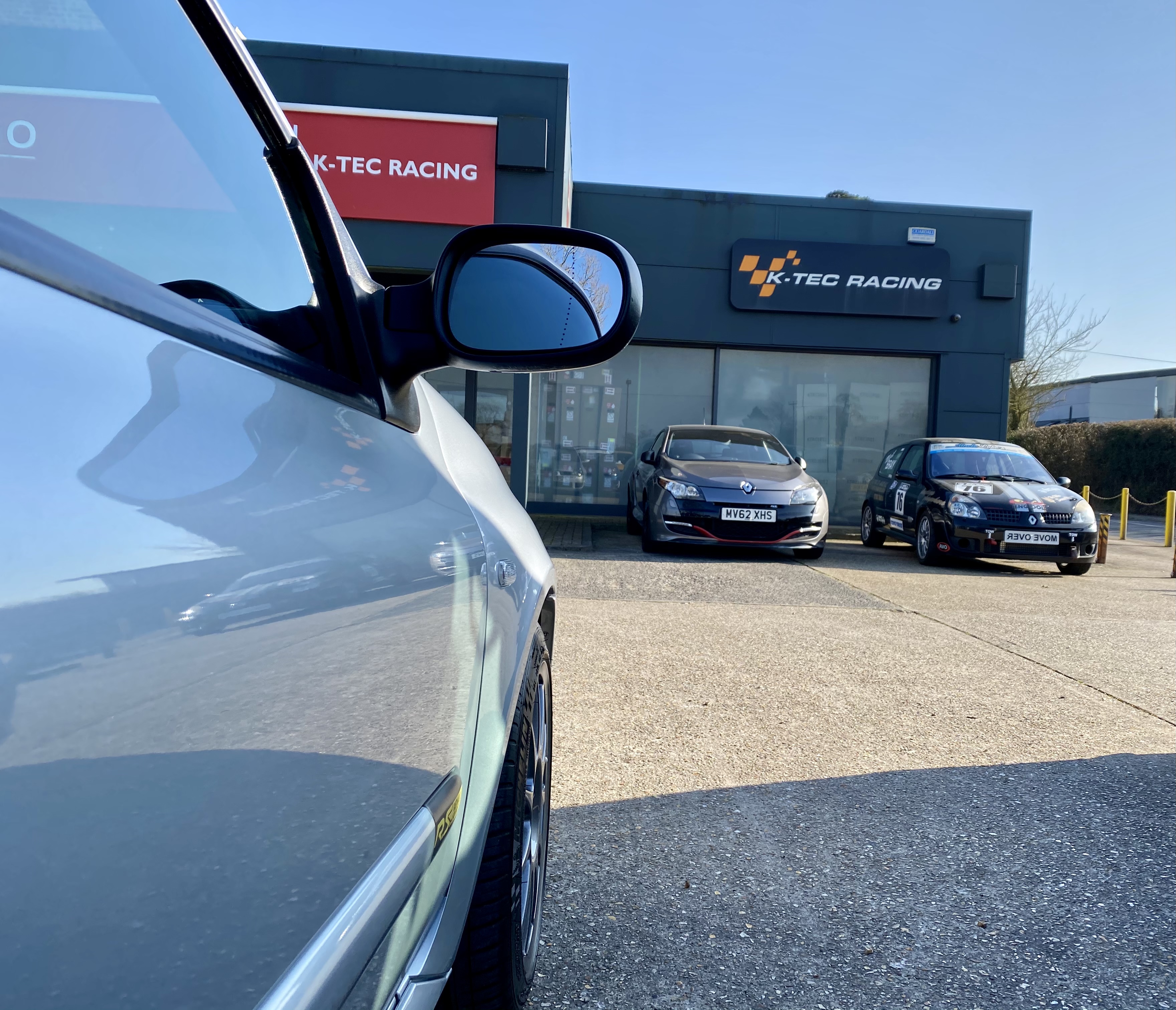

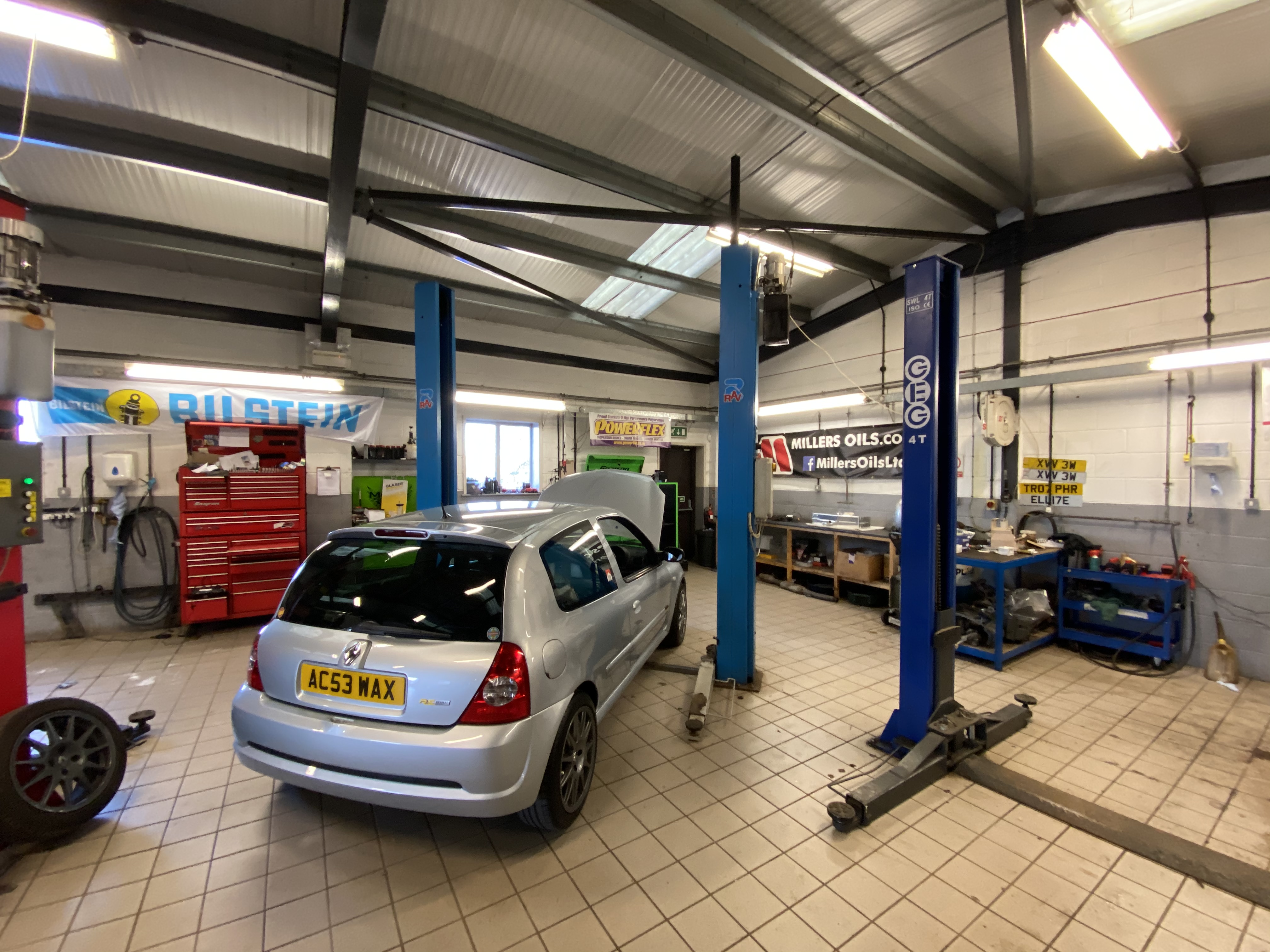

Headed to K-Tec yesterday for the car to be assessed and valued for my insurer.
Had a nose around some of the cars they had including a 172 Cup which I’d love to have a play with 😳
Assessment is that it needs a refresh underneath which I knew already - waiting on their valuation.

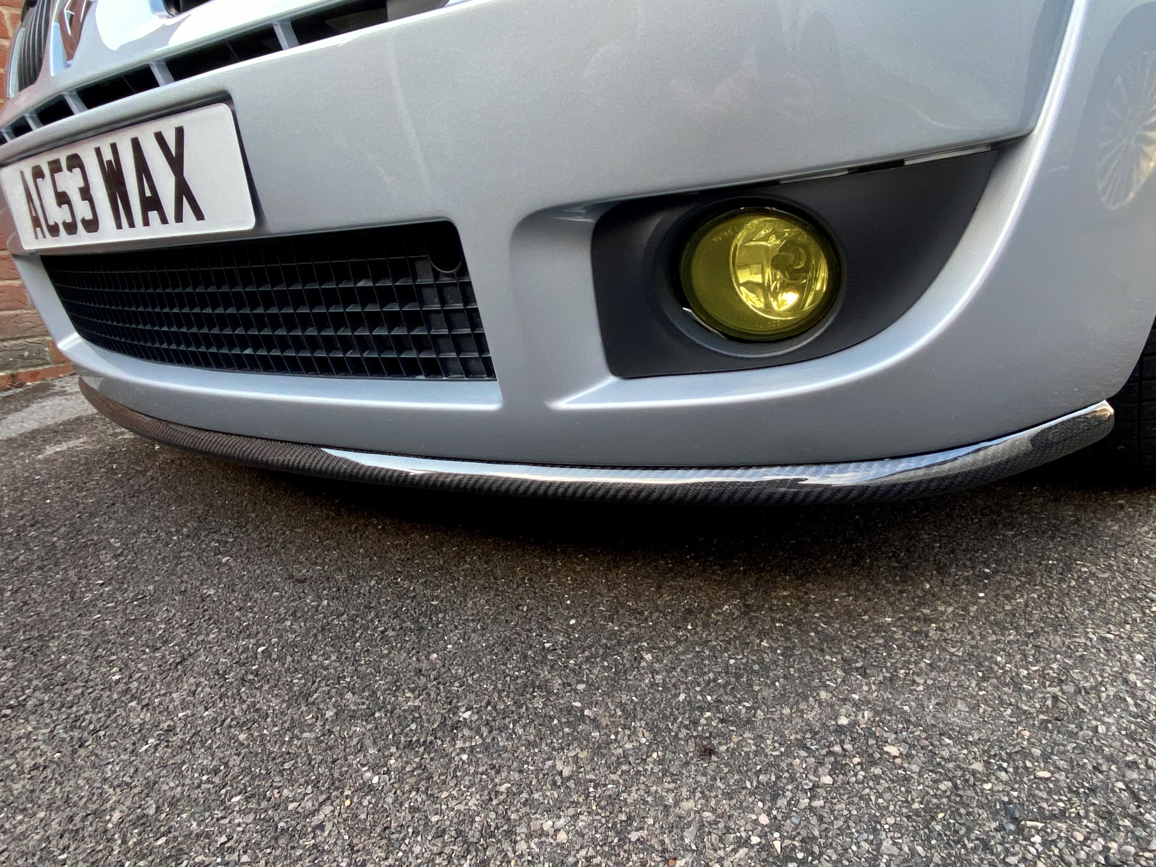

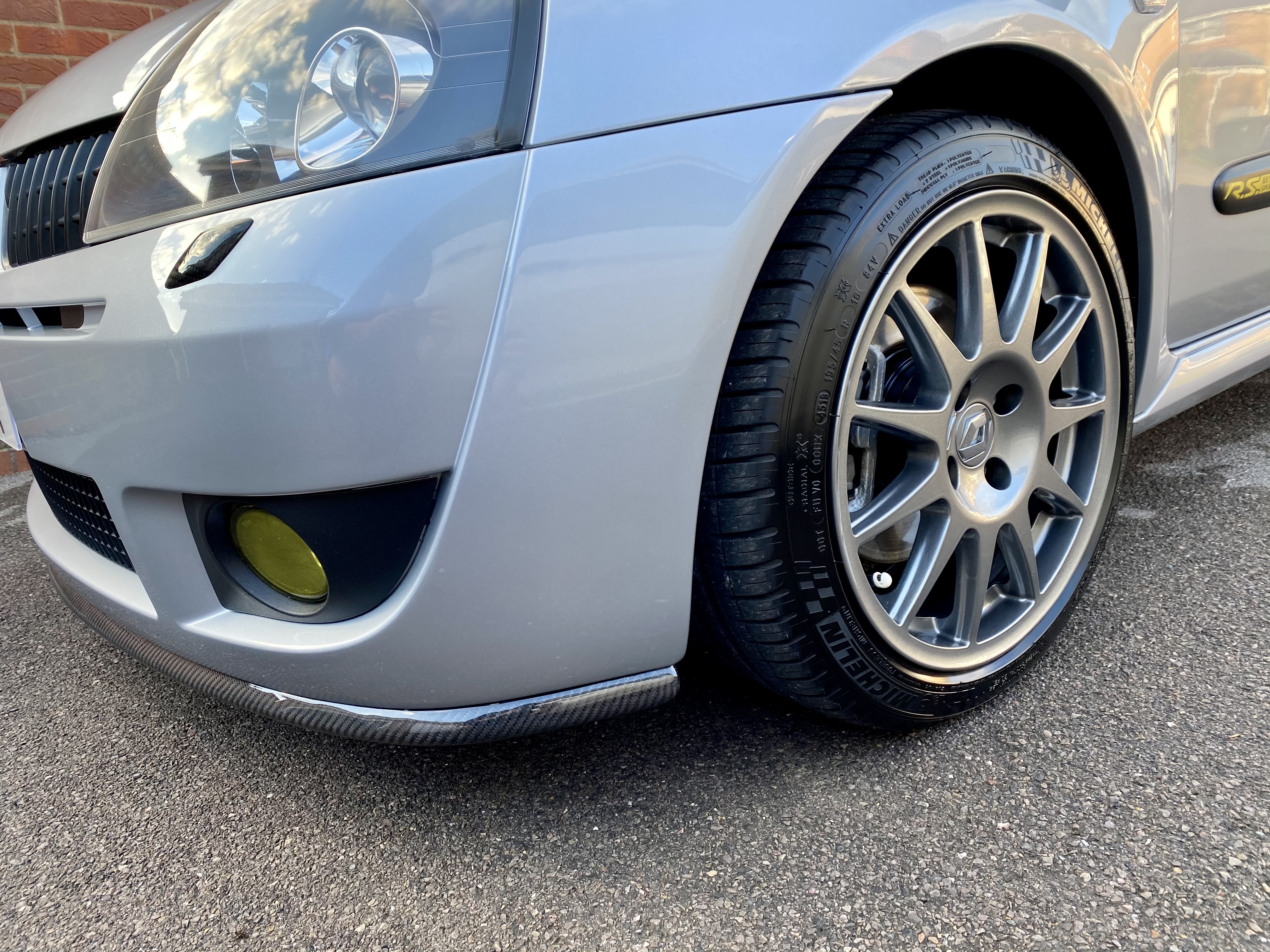

KTec carbon splitter fitted today - really happy with that. Next job is to start refurbishing the various bits I’ve got sitting in the garage.
Looks amazing. I love the splitter. That is a fairly reserved valuation in my opinion.
Thanks chap. I guess the difficulty is that under the obsessive polishing, it’s an iceberg 172 with 125k on the clock. I’d just about be able to recreate it for £4k if the worst happened and once the chassis and engine bay are done I’ll get it revalued.
They're going up in price now, that's for sure. i think you'd struggle to get it back to that standard for 4k, but i might be wrong. But i guess you get the brunt of it bag.
Carbon splitter is sick! on the list hehe

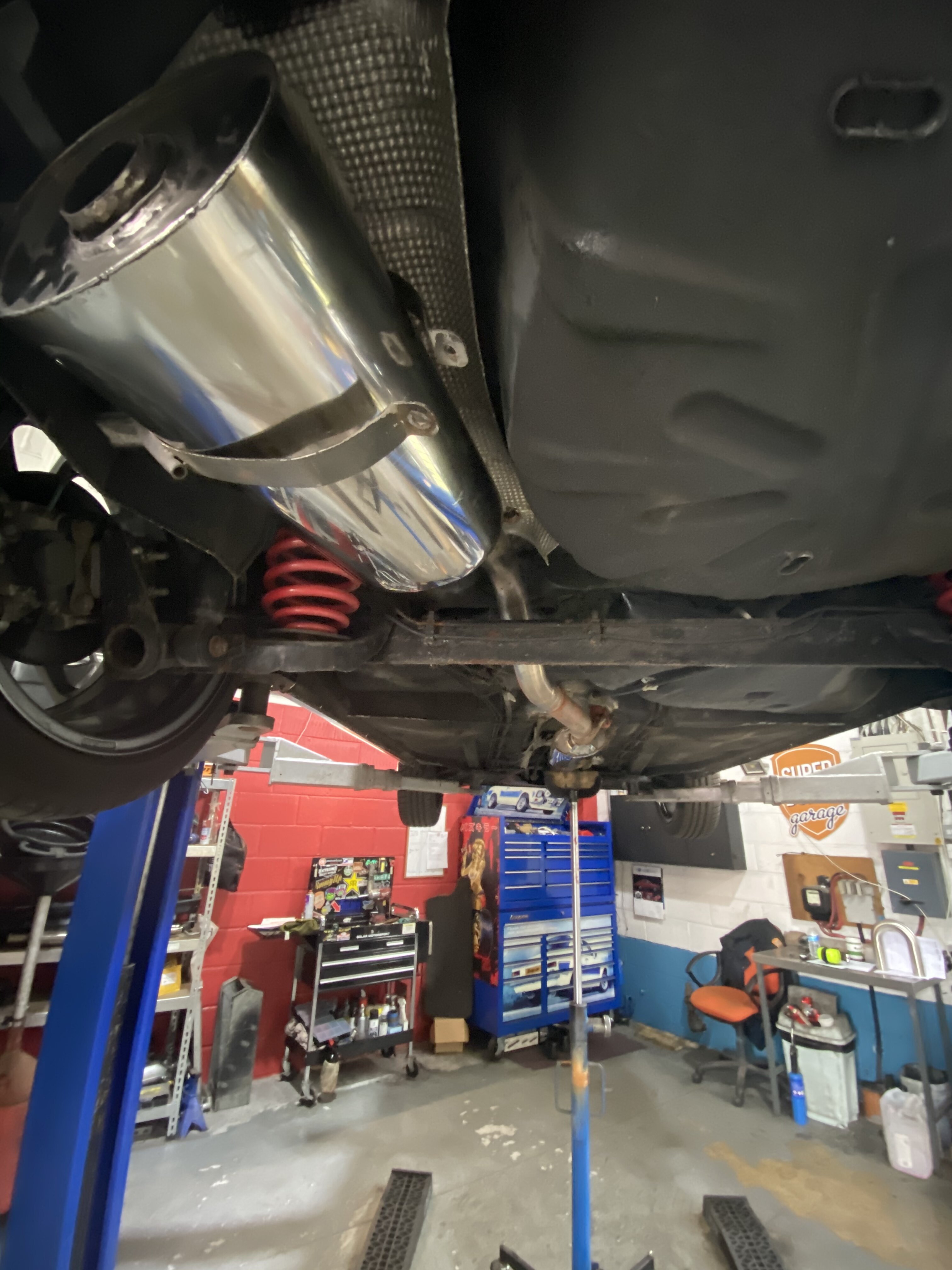

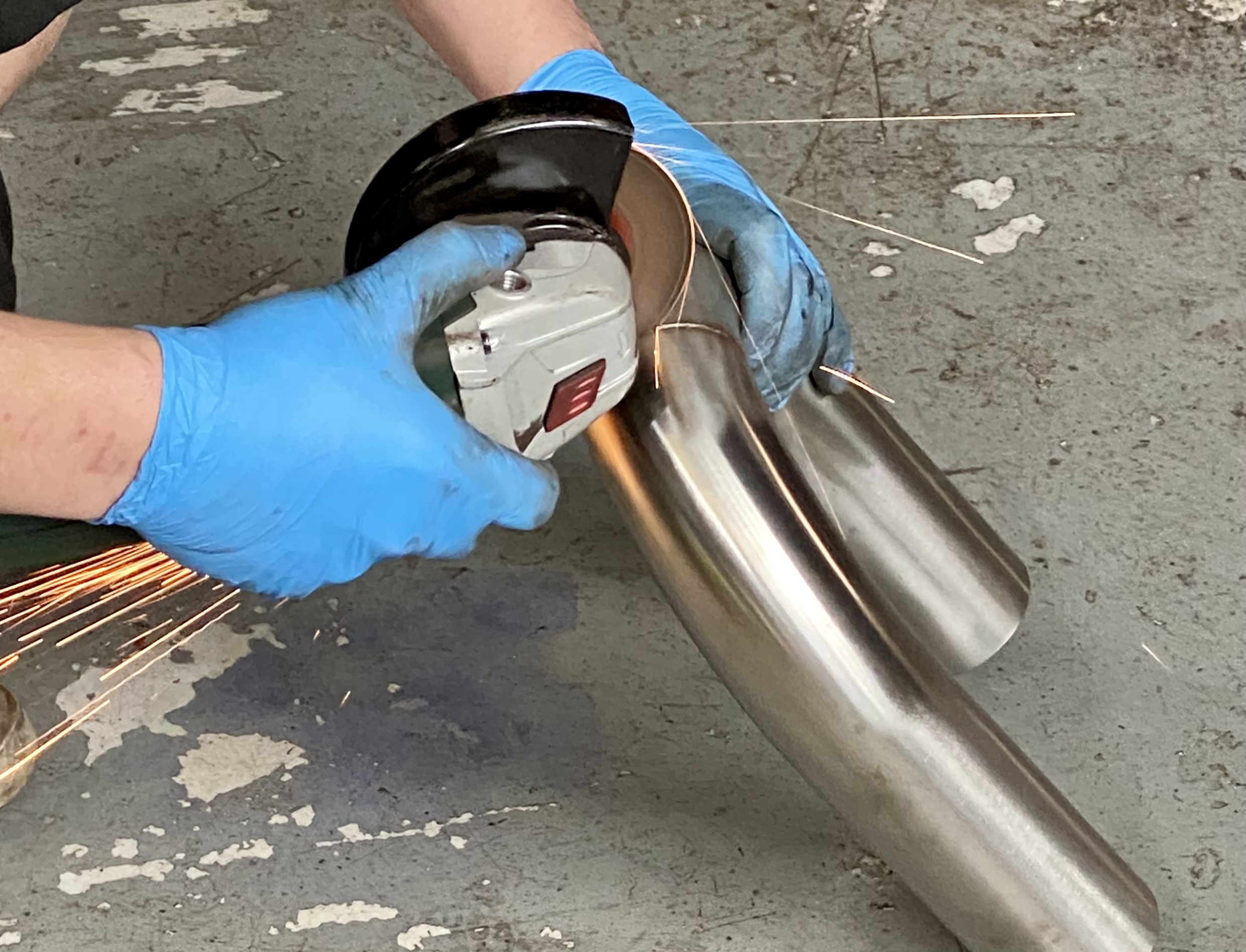

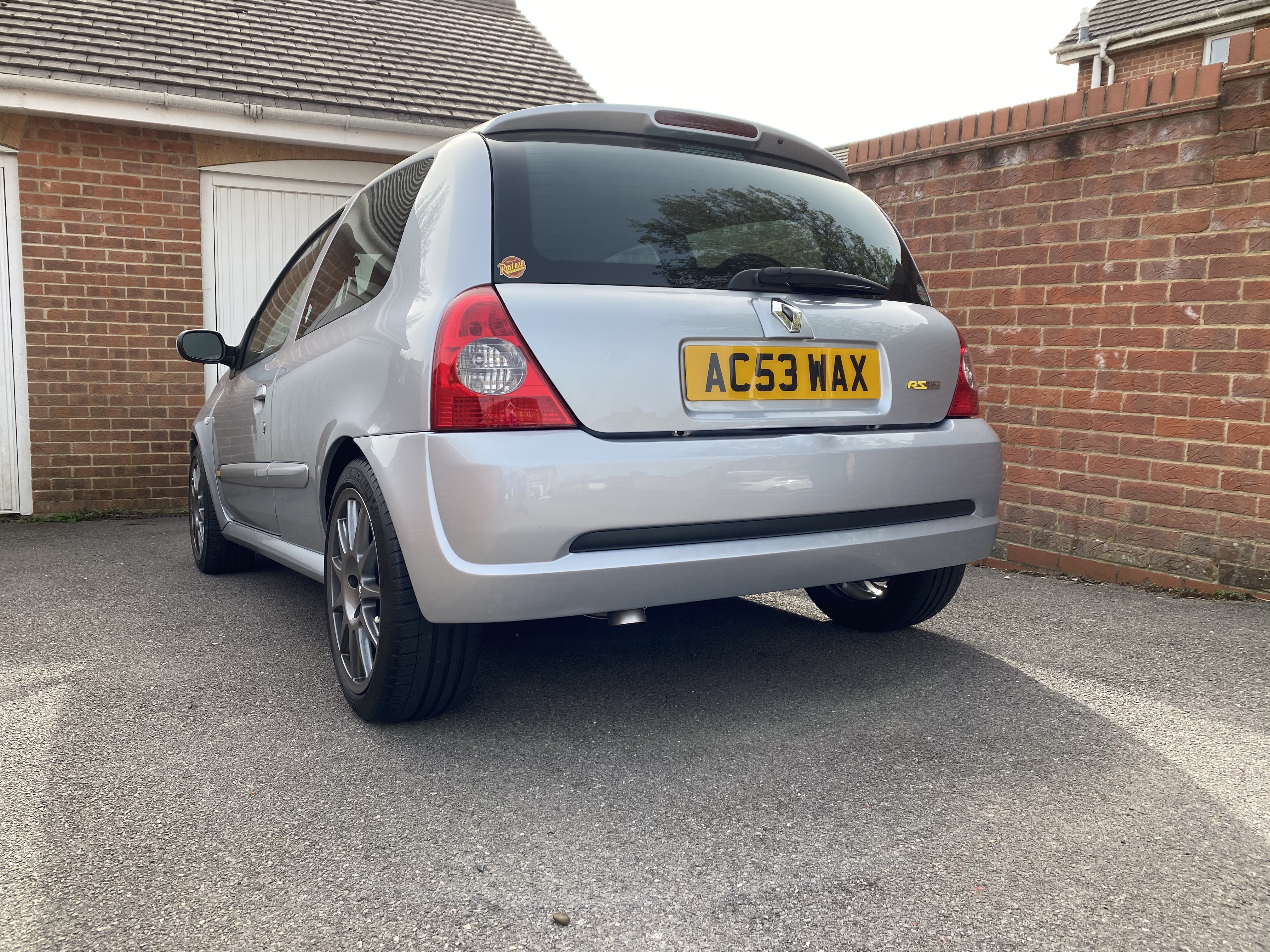

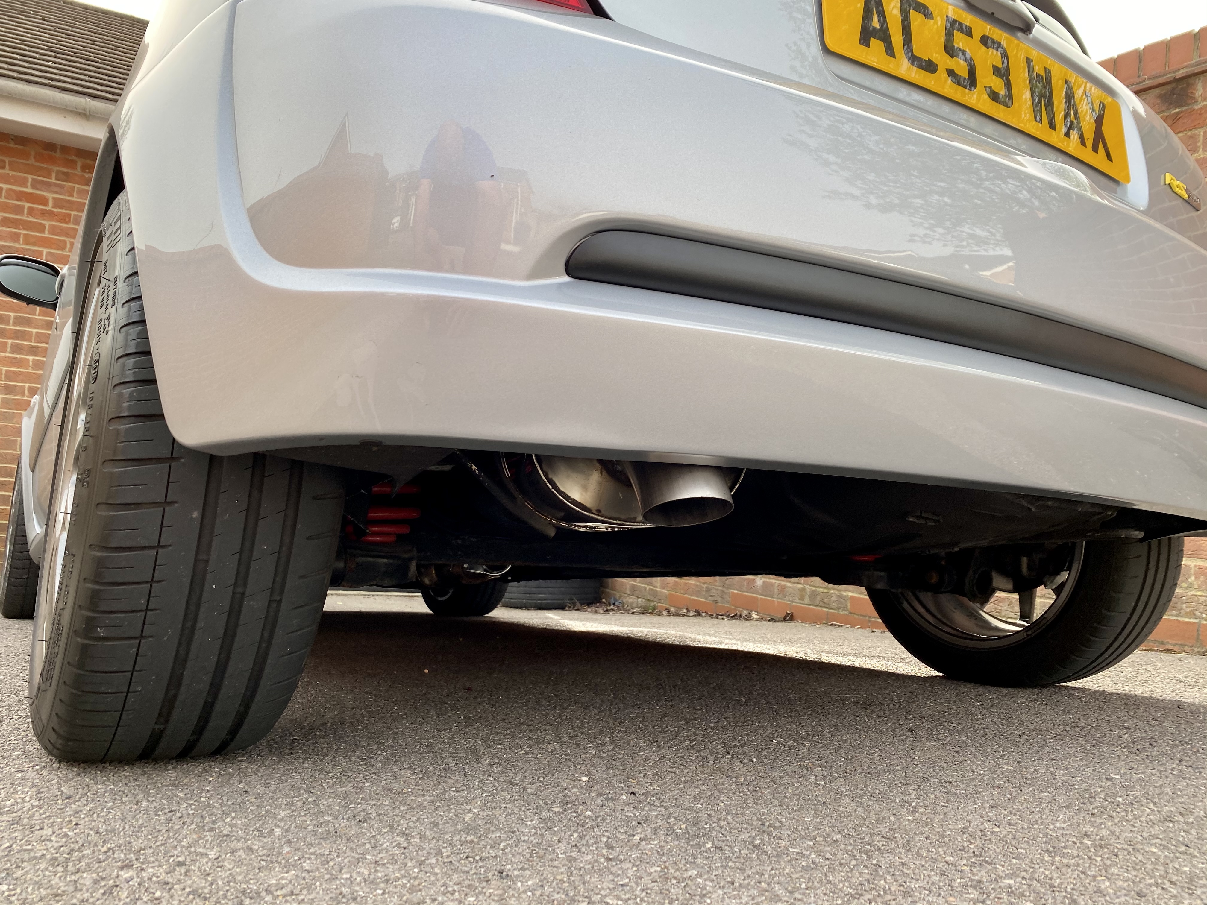

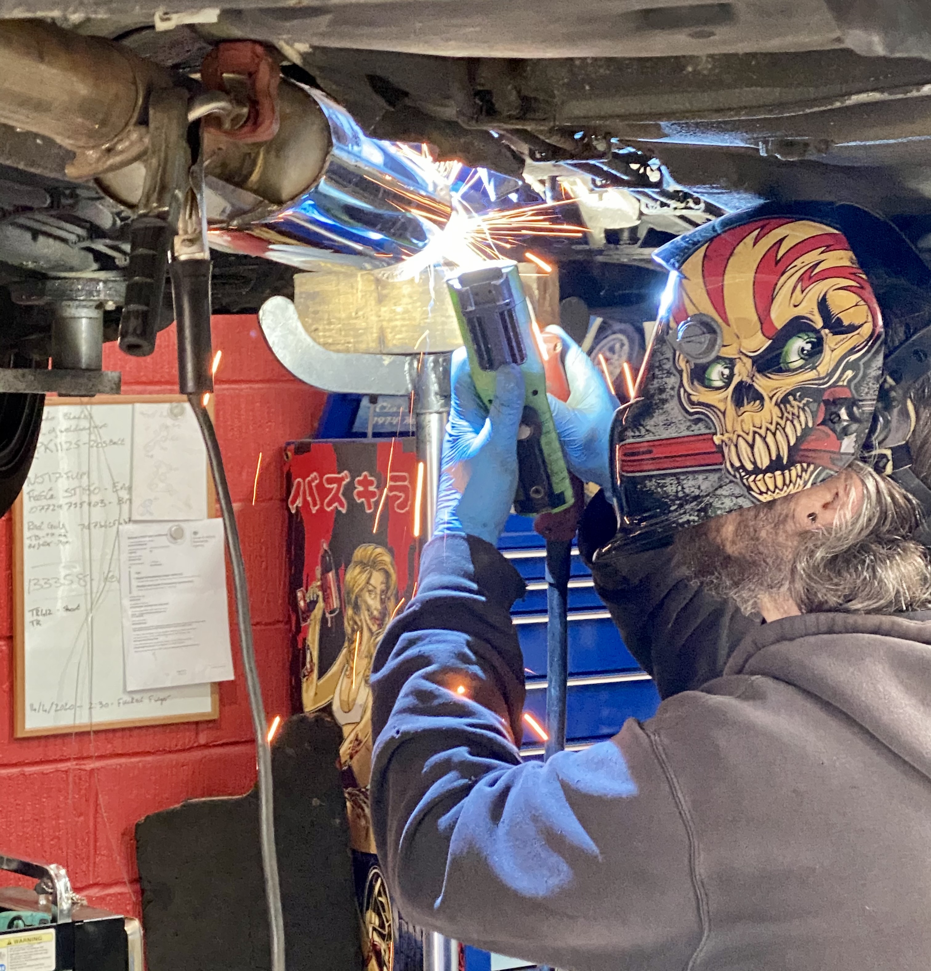

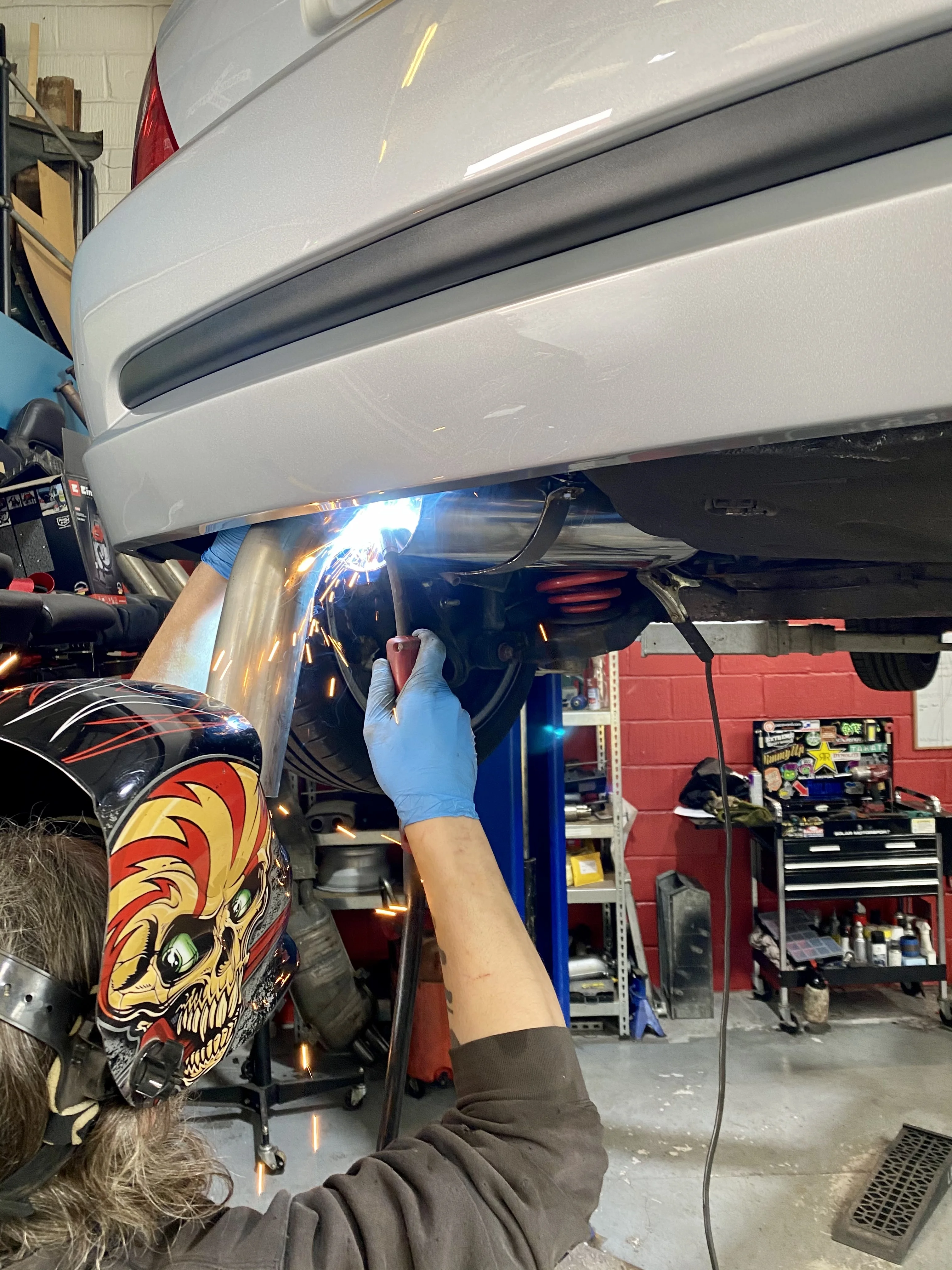

Old manky exhaust be gone. Ktec on and happy. Picked this up from @Mbeau at the weekend and had it fitted today. Ended up going for a stealth tailpipe - wasn’t worried about chopping the bumper but couldn’t be doing with a 3” tailpipe sticking out. Bit of fiddling to get it fitting just right and it sounds exactly how I wanted - quieter than the old system at anything other than giving it the how’s your mother. Spot on.
Looking good, how's the noise levels at motorway speeds? Any drone? I'm looking at going the other way and getting a straight through the bumper...
Not done any motorway driving yet but at lower speeds where it was noisy before it isn’t as bad. Not scientific but it’s a lot better.
