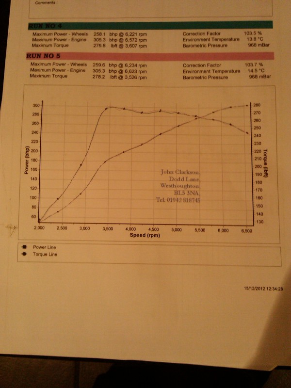

Well done mate, very impressive results!
Guess you'll wait for the internals to do something interesting before changing them or are you whipping the engine back out and getting them changed? Did Andrew do your mapping?
  182/RS2/ Turbo/Mk1
If the sump will clear the subframe swapping rods can be done with the engine still in.
That said if the box has to come out anyway then might be easier to just pull them out together.

Wow this is great! Seeing this it would be a very small step to use an engine with lots potential and parts available!
Shame i already have a fully built Renault engine, however it's a bit of a challenge too ofcourse!
  172 cup, Impreza P1
How do you get the cir clips and Gudgeon pins out of the pistons? I presume the pistons stay in the bores.

Pretty much perfect power and power delivery to suit the car IMHO, will still be fairly useable, and must go very very well.
Epic result IMHO.
Lets just hope you manage not to copy my bent F4R rod, as the VW ones arent much better, lol, should be ok as you have kept the boost levels sensible.
Epic result IMHO.

Great result indeed. And for the amount of money just seems far more sensible then turboing a F4....
could have a bit higher rev limiter though, power seems to keep climbing.
