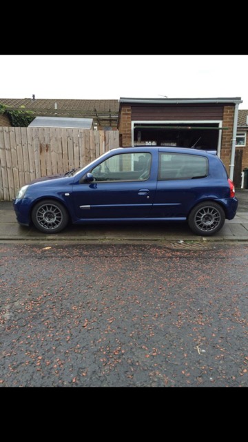

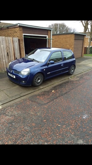

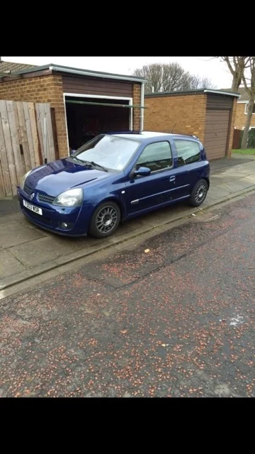

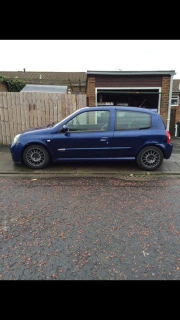

Picked up this Monaco Blue 172 from a former member in Edinburgh last week. This is the second 172 I've owned, I had a Pearl Black 172 while I was living in Australia and I've definitely been bitten by the Renaultsport bug!
It's currently on 85k and it's current spec is;
-Cooksport springs and fairly new standard shocks
-Trophy Turinis
-15mm Rear spacers
-KTR braided lines
-Ktec stealth
-Cup spoiler
-Belts done by Rentec Edinburgh in Aug '13
I only managed one trackday in my last car but I had a great day and it's something I definitely want to get more involved in now that I'm back in the UK and have more tracks in a close vicinity. Interior and exterior will remain as standard looking as possible as it will still be a daily driver - but we all know how we say these things in the early stages!!

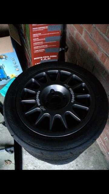

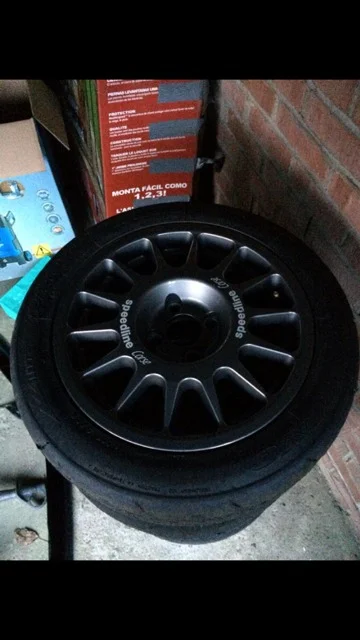

Just last weekend I made a trip to Workington for these bad boys
2118s with Toyo R888s :)
