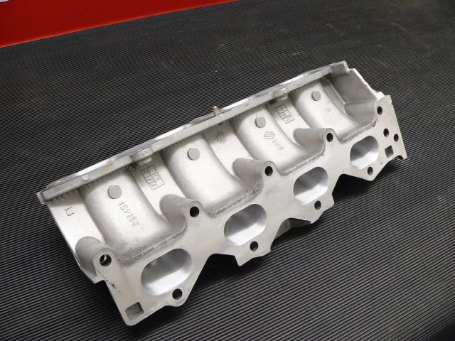

As some of you might remember, i ran a group buy for the inlet manifold modifications i offer.
Anyway, matt kindly paid for his own before and after RR runs as he wanted to see the gains and thought it would be of help to me since we've never done a straight before and after, it has always been with other modifications.
Whilst i modified the exchange manifold, matt skipped down to mass racing, got his RR test done and popped back.
blah blah blah, swapped over the manifolds and we went back down for the after test. Before we did any modifications i spoke to matt and explained that i was being conservative with the modifications due to the fact that no fueling alterations were going to be made and i wanted to play it safe. So on a std engine with maxogen intake and magnex catback (still has cat), the only change between runs was the bolting on of the inlet manifold.
Here is the before/after run comparison.
http://i13.photobucket.com/albums/a300/BenRAWT/matt172-maxogen-magnex-manifold.jpg
We were pleasantly surprised!
Conditions were horrible as you can see by environmental adjustments, but they only equate to under 3bhp........but still prooved great.
just for information, the work was concentrated to the manifold elbow and 25% of the plenham runner (sorry, no pic :().
Just so people dont flame me, this isnt a sales pitch, i'm not asking anybody to buy one, and your quite within your rights to take results with a pinch of salt. Its just as interesting to me as anybody else as i've never carried out back to back on a std car, its always been with cams/remapping/filters/exhausts etc.

matt got it at the group buy bargain price of £126 fitted (not doing that again lol)!! regular price is £180 fitted.
sorry, people keep thinking 3bhp gains lol.
Gain was 13bhp, the environmental changes only add 3bhp to the figures, but cancels itself out as it was done for before and after runs, so the gain from the mod stays the same.

no i don't think Ben means EVERYTIME, as he says some inlets are crap from factory, whereas some are good
the engines with bad inlets will see larger gains
no, sorry, i cannot say that as i cannt gaurantee it.
I normally quote 5-8bhp for this sort of modification, but i had never done a back to back test on a standard car before, and i am posting the results as they are surprising even to myself.
Not all cars are equal, some will have better std manifolds than others so gains will vary. But i feel that the results give an indication of what is possible with proper attention to detail.

sadly modifying the F7 16 valve engines intakes results in zero gains, they dont suffer from the same problem, they are actually too large in stock trim.

The same type of work could be done to both the 1.4's and 1.6's as they both have half ally, half plastic manifolds. I'm not sure of the gains though.
