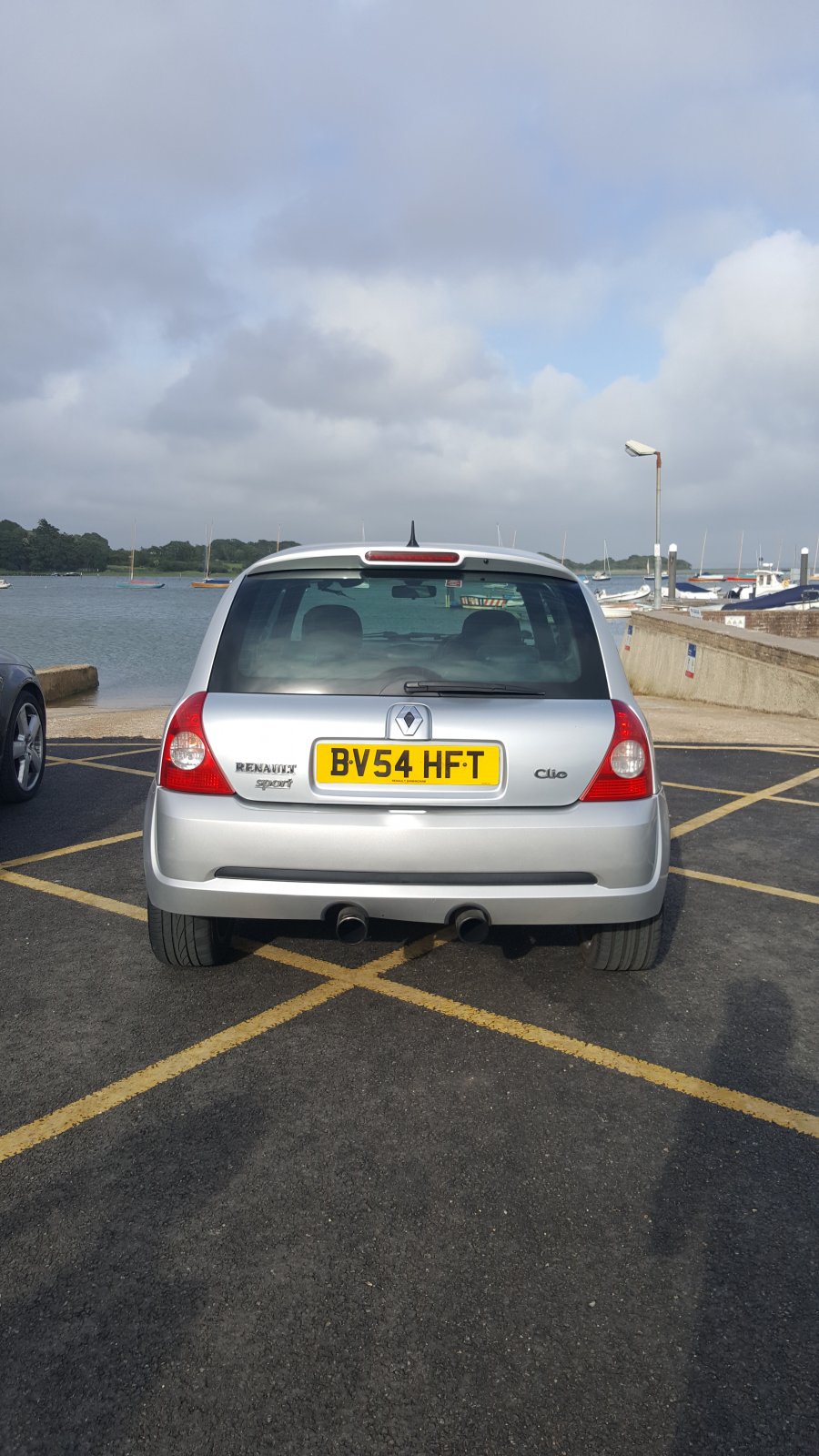

I know the Clio 182 exhaust is pretty notorious for never sitting right, but I've read a load of threads, replaced all the mounts with powerflex mounts, and whilst it no longer sags, its sitting way off to the right. I've noticed the exhaust sometimes touches the bumper and vibrates it too, so I imagine it'll be a matter of time before it starts melting the surrounds. Picture for illustration:
Any other ways of adjusting it a bit? It's a Yozza exhaust if that makes any difference. Thanks in advance!

i'd normally say look at bending the hangers on the exhaust to move it over a bit but yours is bloody miles out!!

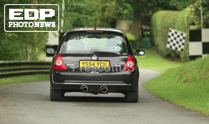

this is whats always put me off 182's!! my trophy runs the factory system with fresh mounts and sits perfect but ive yet to see a 182 with an aftermarket one that sits properly!

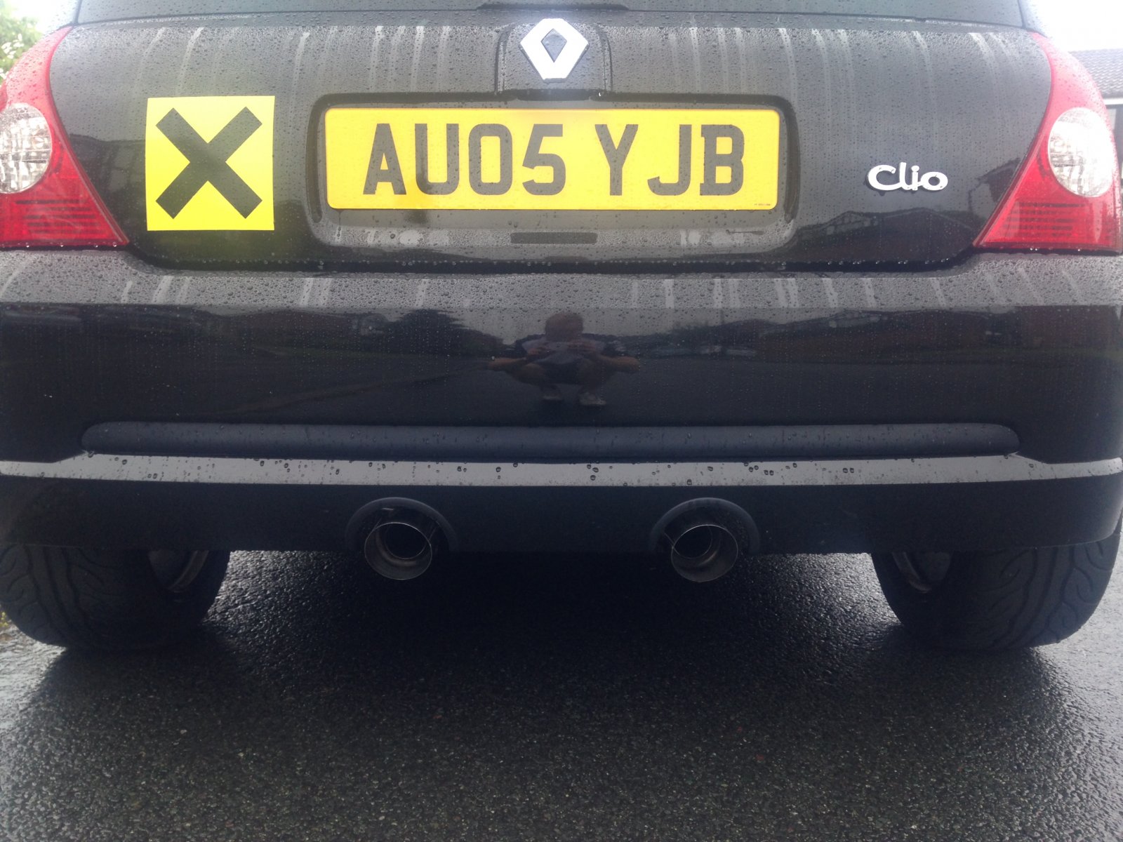

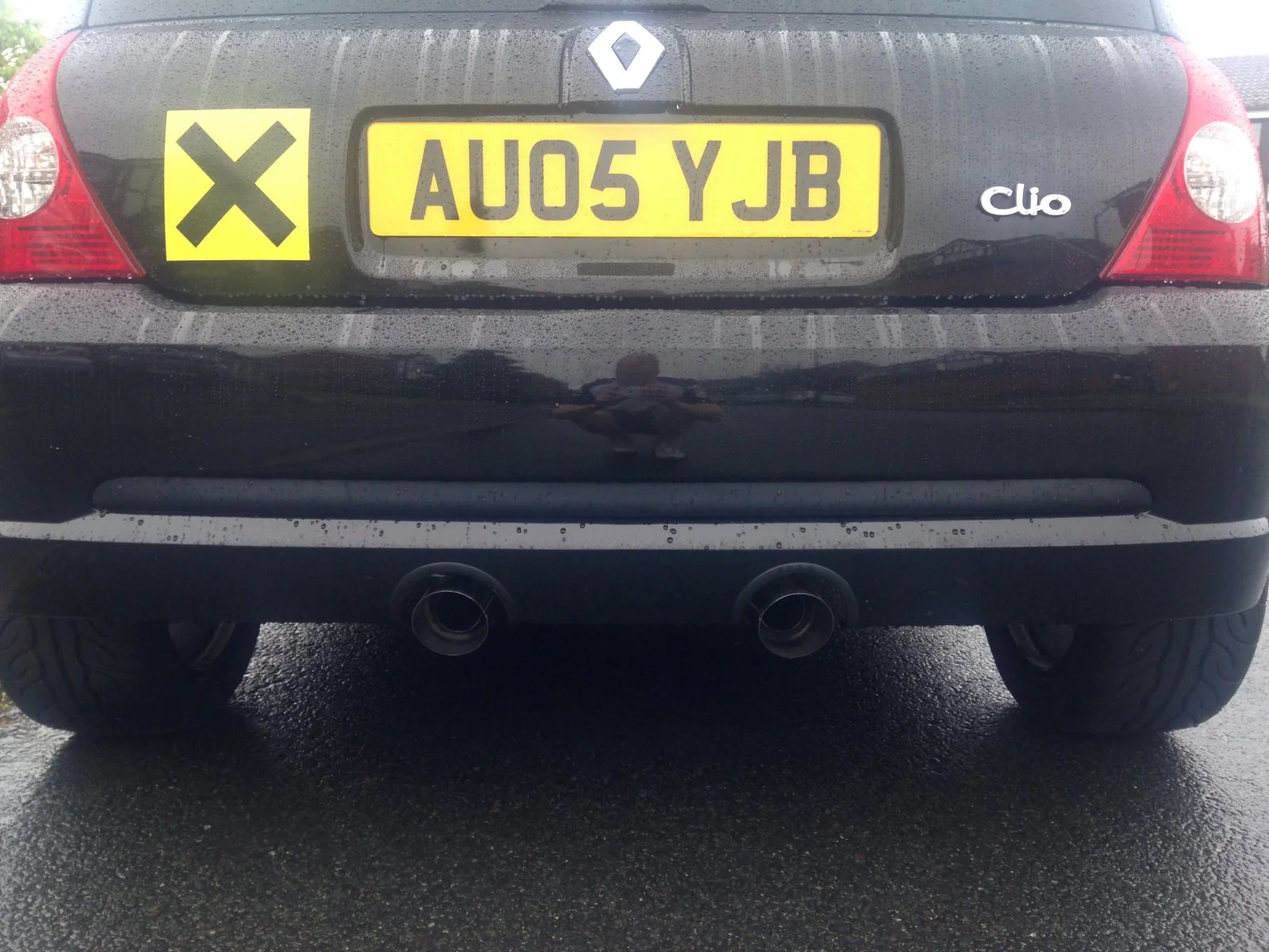

I fitted a KTR Centreline to my BG yesterday and it comes with all new mounts that replace the standard setup and it sits perfect so far!
Unfortunately I'm pretty happy with the Yozza otherwise, so replacing it just for the purposes of hoping to fix the alignment seems costly. As bloke said, it's pretty far out so I'm not sure any sort of bodge would work, but other than the backbox hangers, what else affects how it sits? I can't see anything obvious.
EDIT: Lee, that IS perfect compared to mine!

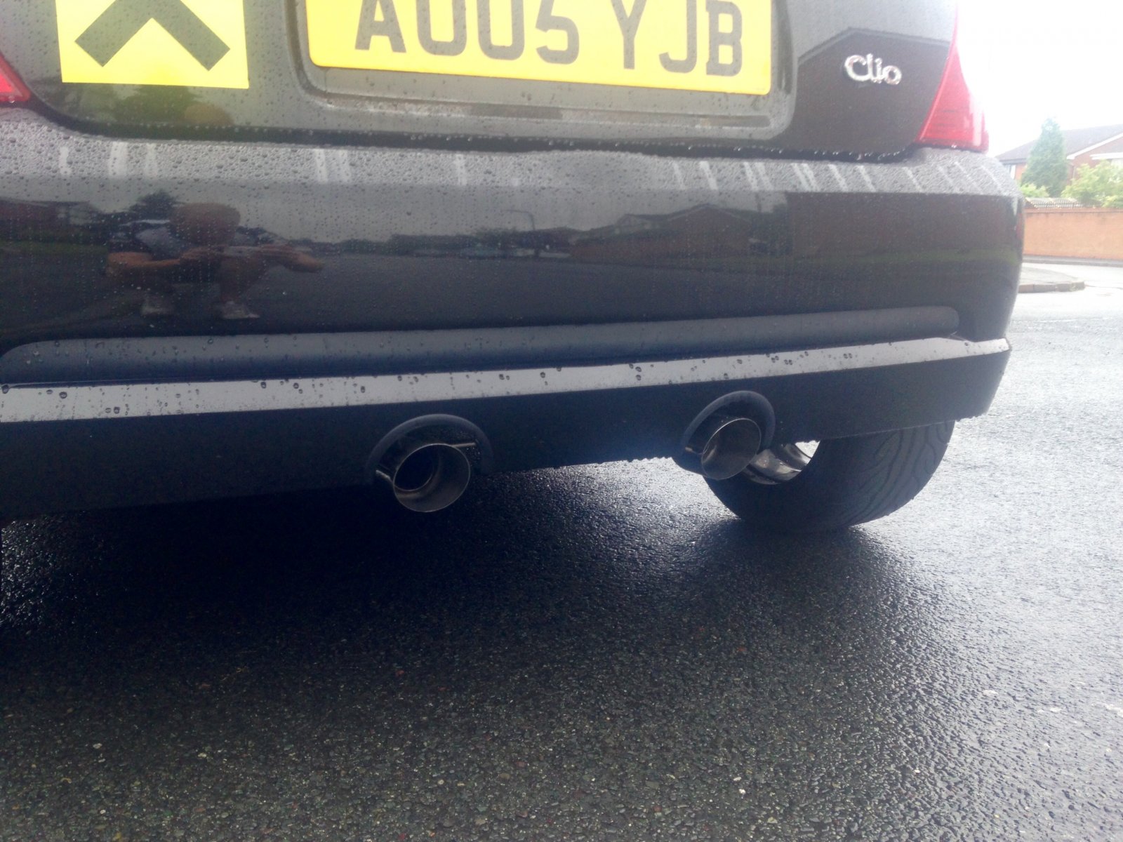

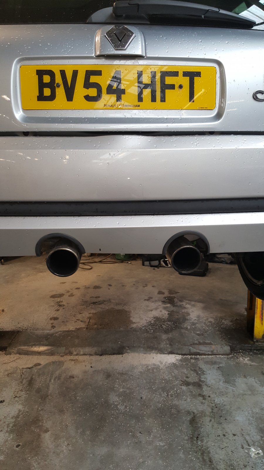

@burneyC Just finished! All lines up so much better than before. Really pleased! Needs tweaking but i ran out of time. The right mount (i put through the wrong hole) is sitting a little low. You (hopefully) can see the before and after photos below!
Wheres the after picture lol?

Mine is a miltek which I think sounds great. As I said above, wen I bought the car it has been in a minor rear. This is probably why the difference doesn't look huge lol......okay so I'll admit, it's not a huge change. But I'm happy!
