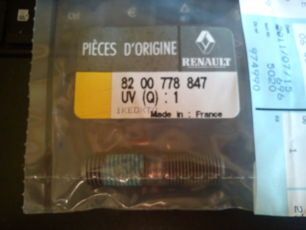

How do i torque the stud???

There is no stud to torque, the stud is factory fitted to the exhaust camshaft, you never touch that. Just torque the nut on the exhaust cam, and bolt on the inlet cam.
The stud is user changeable as its a stretch stud... works in the same way a stretch bolt does which is why we always check them for signs of tapering when the exhaust pulley is removed and replace if necesary. You will need a good stud extractor/insert set to put it in properly though or you can go to pikey method 'A' which is to use two nuts and turn the outer one until it reaches the end of the cam.
