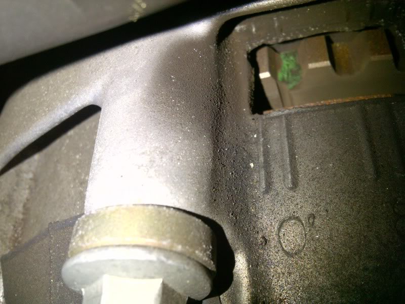

the timing is out. got crank pin in correct place and cant get the horse shoe in at all. got to have a new cam in anyway so ill put it right
STOP!!!
You'll ruin your pulley if you're not careful - Rotate the crank back a few degrees (this is to allow the valves room to open slightly if required without risk of them bending) then insert the camshaft pulley lock tool and imobilise the pulleys. Loosen the bolts securing the pulleys to the camshaft then carry on.
Retime the bottom end once the new cams are in and the camshaft locking tool is correctly in place. PAY CLOSE ATTENTION to the position of the camshaft locating bosses for the lock tool as they're not central and it's very easy to fit the cams 180 degrees out!!

i havent got the cams yet mate but i know what you on about. the cam locating bosses are offset towards the bottom on the cam.

ive got my tension bang on now. so is it now just to torque all the bolts up before turning engine over twice???
  Monaco Clio 172
well here is all the things gone wrong,
cams were no good (fred sorted me out wid a set)
ripped the stud for the cambelt tensioner out the head
snapped the crank bolt.
but all is good now and she running better than she ever was, timing is bang on and idle is sweet.

The notorious genius Fred thinks that my engine has suffered a serious injury being a snapped belt. No pulley tool being used to repair it causing the chunks out the cams.

Its suffered something at the hands of complete moron(s) that tried to use the camshaft locking tool as a camshaft pulley imob tool, hence the damage to them... see this all the time on 1.4/1.6 16v units that use a similar setup. Still, all done now and should be good for another 5 years service.

just noticed with the engine running there is a very very small wobble on the crank aux pulley.
Its normal for them to do this a little as they never run 100% true due to the assembly design but how much "Wobble" are we talking about; More or less than a few mm?
