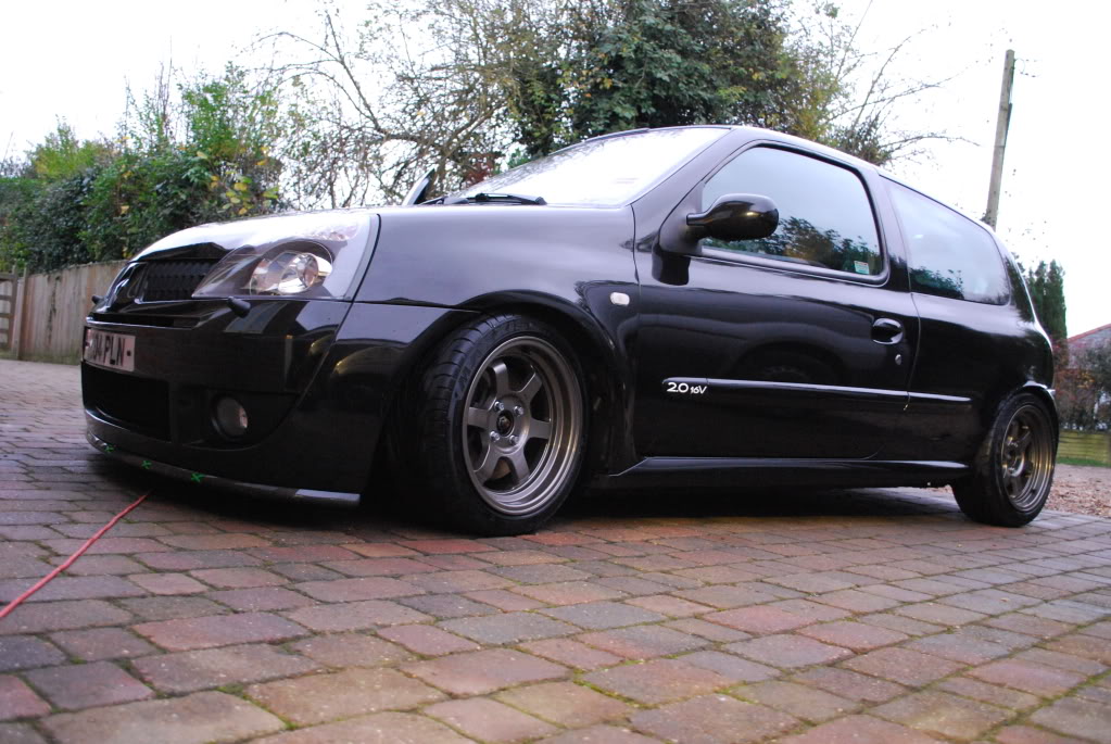

Ok so I had iv been a member for years but never a paid up member , so I bit the bullet and signed up properly. Was looking for a fun/economical'ish daily as my main hobby is drifting and the Sport ticked all the boxes. Bought it looking like this ,
Decent, honest base car. Standard bar a Ktec stealth,powder coated wheels with suspicious centres and a 4x4 ride height. Plan from the start has been stance with no extra camber (hate big camber on clios)

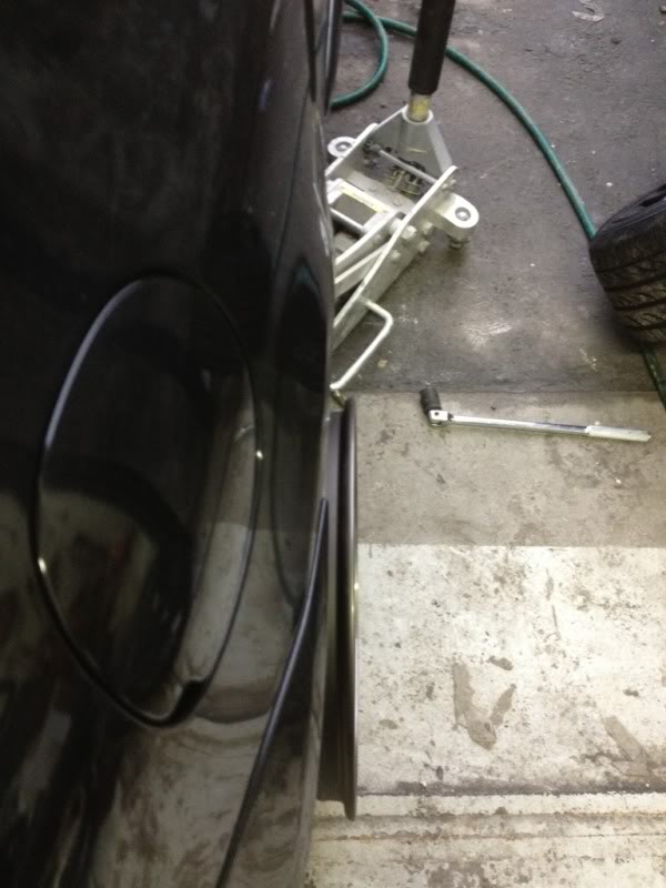

Also I didn't want to follow aaaall the clios iv seem dropping a wheels size so stuck with 16" with a sensible stretch using 195/45's. Here are the results..

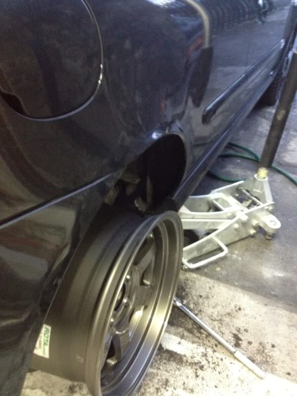

Before roll/pull/flare

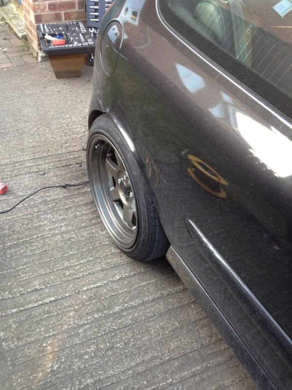

After
Absolute pain in the arse lol, 5mm slip on's all round, plus rear arch grind/re-locate front and rear bumper brackets/modify s**t guards/massive 1" flare and roll on the rear. Also had to modify the front inner arches slightly to get Lows. My own fault for choosing to be different with a 16x8 et20(now et15 with spacers) but after 29houra graft there on with no scrubbing :)
Il try and get some better pictures but light was fading fast by the time I was done , opinions good and bad always welcome :)

seen these wheels on another clio and was not a fan at all, but on this they look quite cool. just the rears that i cant get my head around! does look funky though, fair play.
  BMW 330ci
Looks good, I would get a new plate for the front, preferably a 3/4 one, only thing that spoils it. Apart from that I think it looks great.
Probably one of the few clios that looks alright with these wheels on mainly because of the arch work making them fit better. Only things thats bugging me atm is the actually amount of people buying these wheels, there must be at least 7 clios recently fitting the exact same wheel. Would be nice to see someone fit some decent/different non rep wheels for a change.

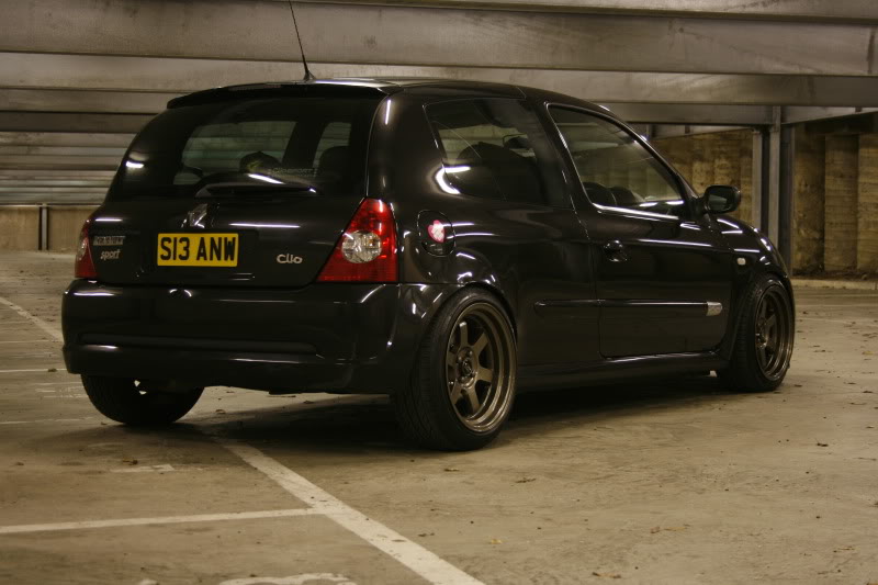

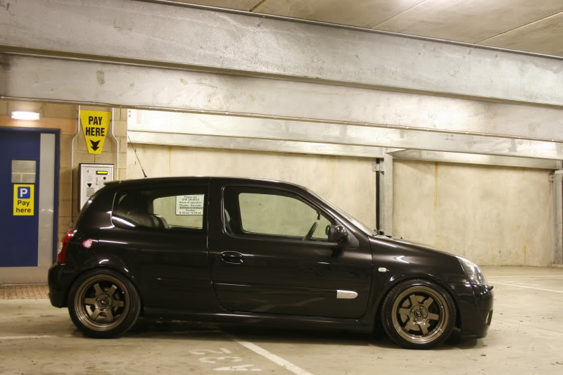

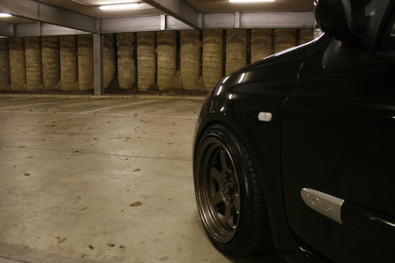

Here's some fresh pics courtesy of Stu 'lad :)
Need to try and find a cup spoiler,stubby ariel and smooth a few bits... Then probably a colour change as it will only cost me in paint. Nothing OTT, something dark .... Opinions ?

these alloy's are really growing on me if i get another 1*2 (probably will lol) i'll seriously be considering these. also i reckon you should spray your bullet's gold to match the wheels...
  1eight2
That looks epic! I'd consider colouring the 2.0 16v badge on the trim in the same colour as the grids.
