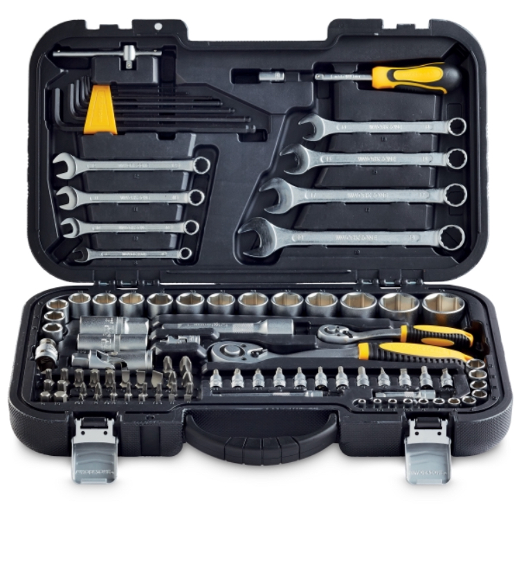

I use regular sockets. I bought this Lidl socket set a couple of years ago, it has been such great value, and has had everything I’ve needed for everything I’ve done on the Clio so far.
I think it was £40. I am Mr Budget :tongueclosed:.
