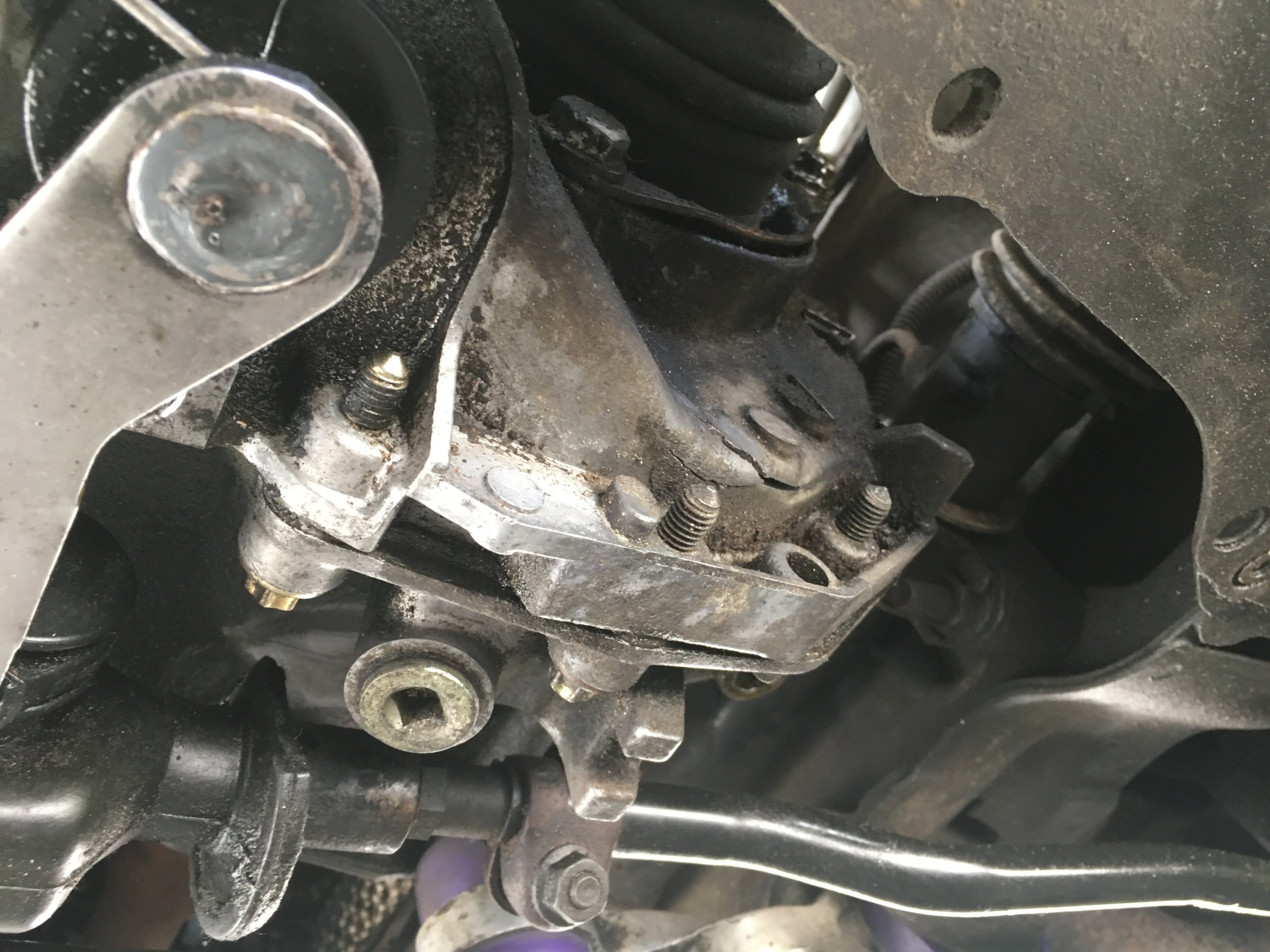

Two months in to owning my first hot hatch, ph2 172, 125k on the clocks. Gutted.
Limped it a mile home. Fair to say this box is dead. Anyone hazard a guess as to what the cause has been? I’m not clued up on gearboxes I’m thinking it’s been cv or bearing related based on where it is ??‍♀️
It`s a bit academic really, but probably the mainshaft bearings.

Kinda what I was thinking, yeah cheers for the quick response man ?? Might chase adey up if it comes to it. I’m speaking to someone local at the moment about a 182 box to see if it’s still available.

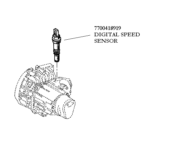

The thing to check on yours is if it's a speedo drive box or not. If it's not a 182 box is fine, if it is then you need to make sure you get another speedo drive one if you want to know how fast your going!

This may help, also @Adeyspec has a 130.
https://www.cliosport.net/threads/which-gearbox-do-i-need.816040/#post-11563937
This picture shows the location of the speedo drive on a 129 or 089.
Ah it’s fine you can tell from the revs and gears... kinda ? one of my motorbikes just runs a rev counter that I’ve marked to indicate rough speed. Kind of need it in the car though, more chance of getting caught out.
Haven’t checked the codes yet but it’s a ph2 sport with abs and esp so I’d assume the speedo is taken off the abs. I will double check though.
Would of thought it was and yeah much appreciated Steve ?? I’ll have a quick read of that.

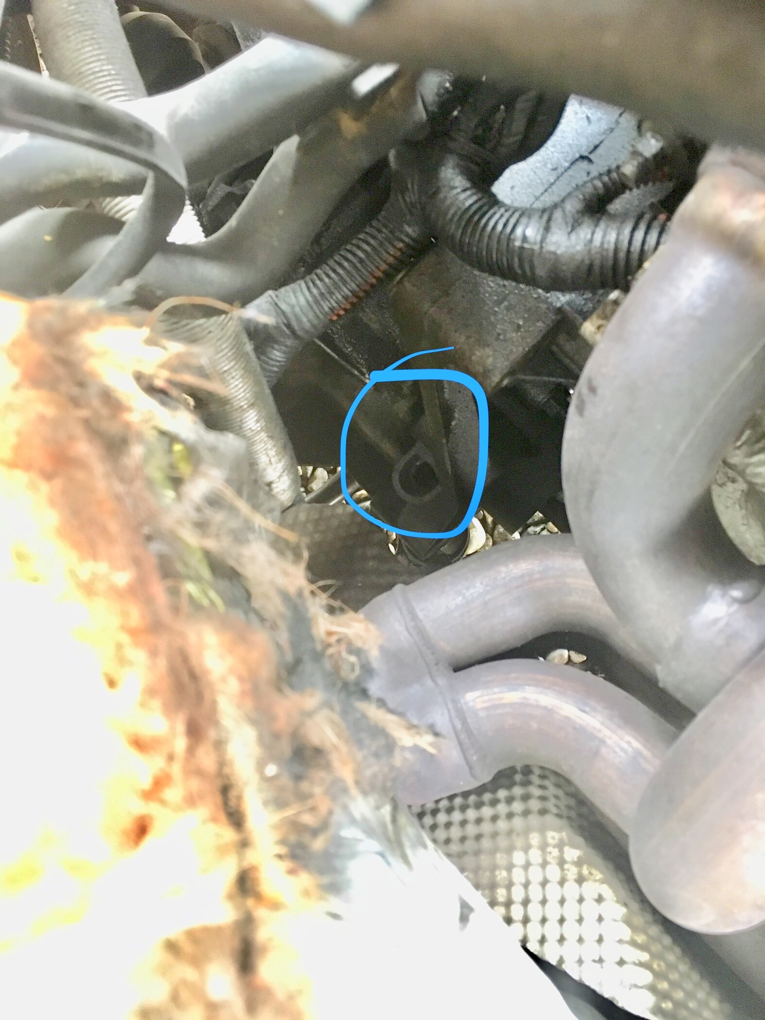

Just physically checked for a speedo drive [1am pitch black with a torch] and I don’t have a speedo sensor plugged into anything. ? there might be a connector on the box but I just couldn’t make it out in the dark, wasn't anything plugged in anyhow. for all intensive purposes the 182’s 130 will do the job as it must be taking signal off the abs.
Once again cheers for the input guys! I thought it was only the ph2 cup and ph1 that used a speedo drive. Didn’t consider that it could be an issue, Good thing is this local ish box is from the 182
  Clio 172 ph2 / bikes

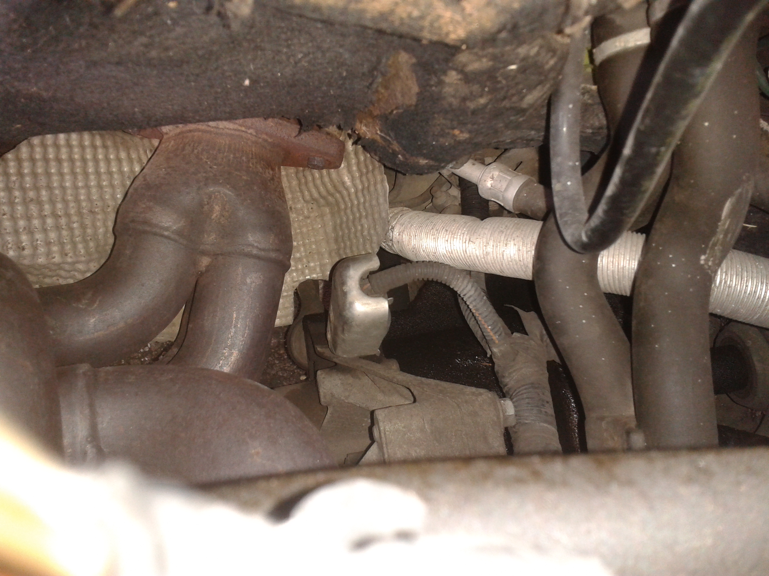

@STEVE.M that’s the connector for the speedo drive isn’t it? So odd that my speedos still working.

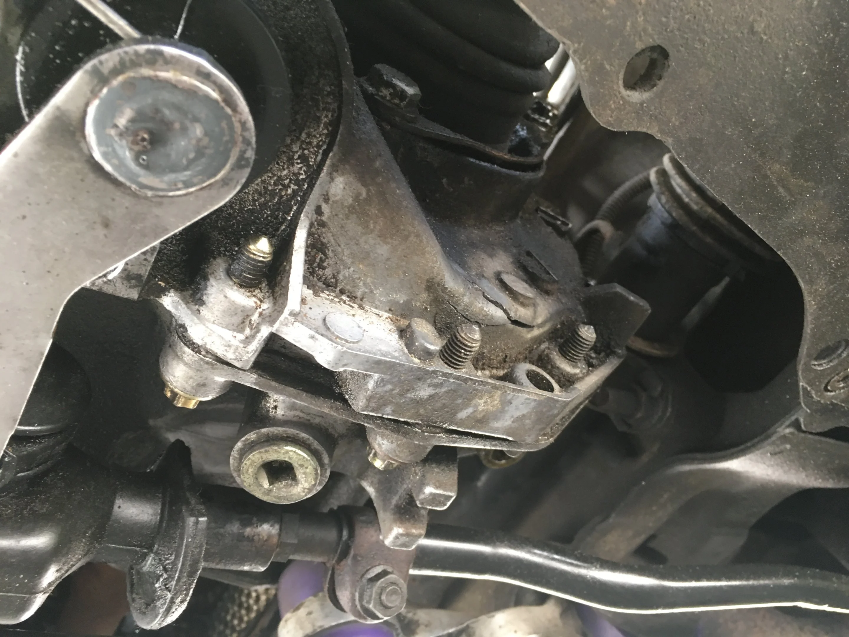

That`s where it would go.
As it`s not throwing oil out, you must have a 130.

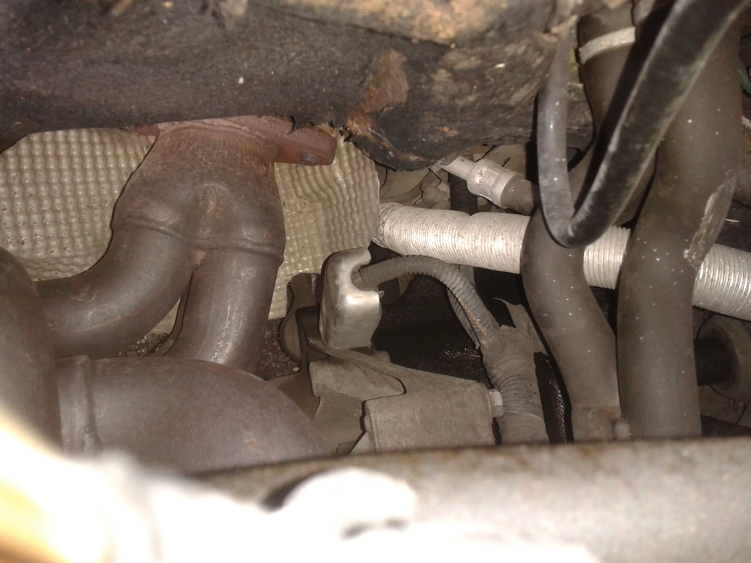

Couple of things to note, watch out for the heat sheild Bolted to the rear upper subframe. Remember to disconnect the crank tdc sensor on top of the box too... seriously. The snap ring on the rhd drive shaft is a cnnnt of a thing. Expect the subframe retaining nut clips to spin. Front nuts are accessible from the outer sides, pry the broken clip out and use a 16mm spark plug socket as there’s no access for a ratchet. If you have to drill them make sure you’ve got fresh drills as it’s brutal.

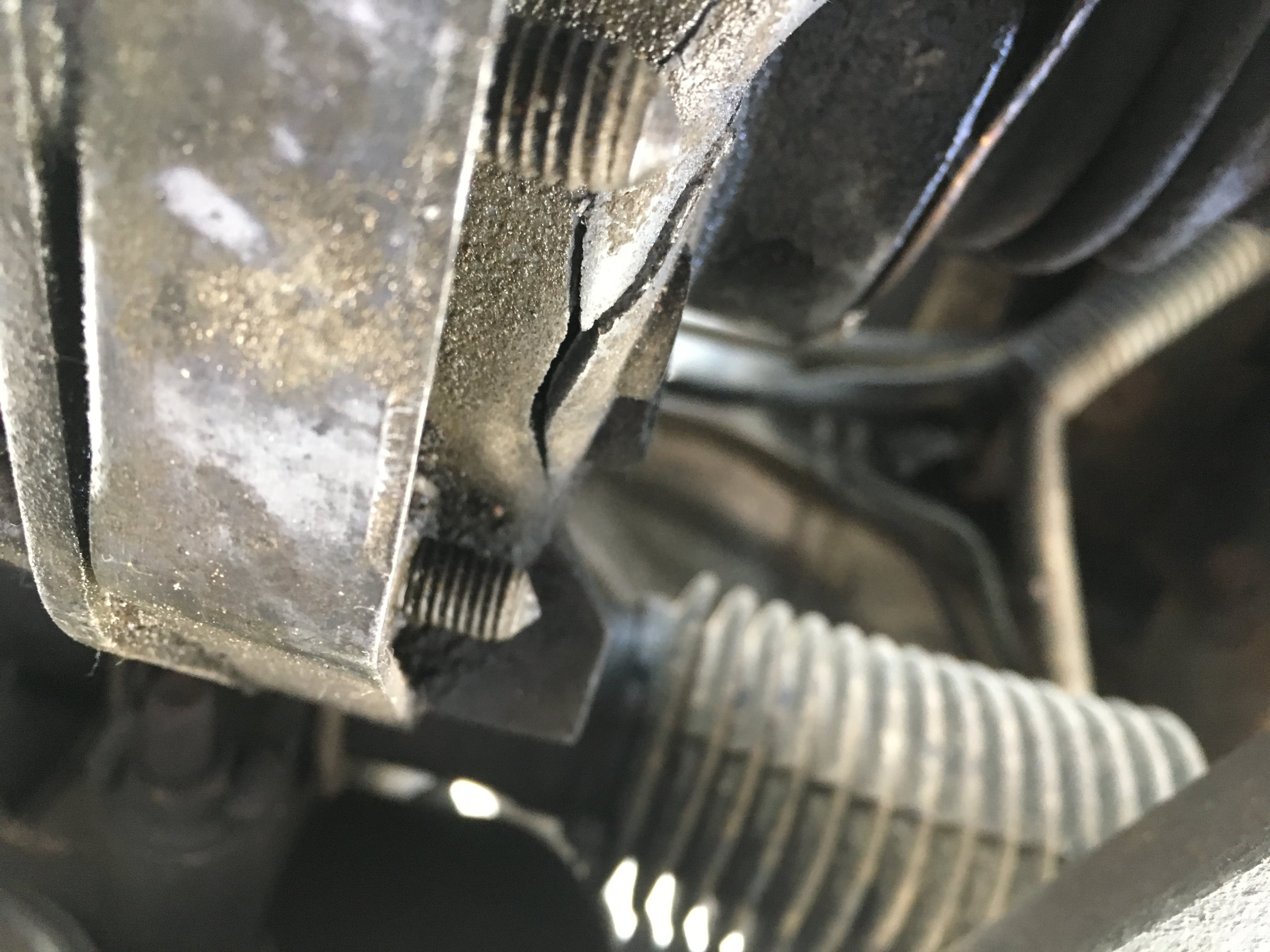

Everything imaginable went wrong for us. Including the OS top engine mount breaking whilst on a jack trying to haul the box off the engine... ? lucky I had a mount ready to go on but that was genuinely scary whilst it dropped and floated on the jack. Every captive subframe nut spun, felt like the front nuts were rotten down to about 12mm but finally realised the clips need pryed off first because you just can’t see in. Gearbox top mount main bolt had to be removed from underneath, top nut completely stuck on, couldn’t get it off with impact or in a vice with a breaker bar, so had to refit it temp with an ahnniliated mount until I get a fresh bolt. Won’t list every issue faced but the car isn’t a rotter, it’s in very good shape underneath and it was ridiculous the amount of things that went wrong.

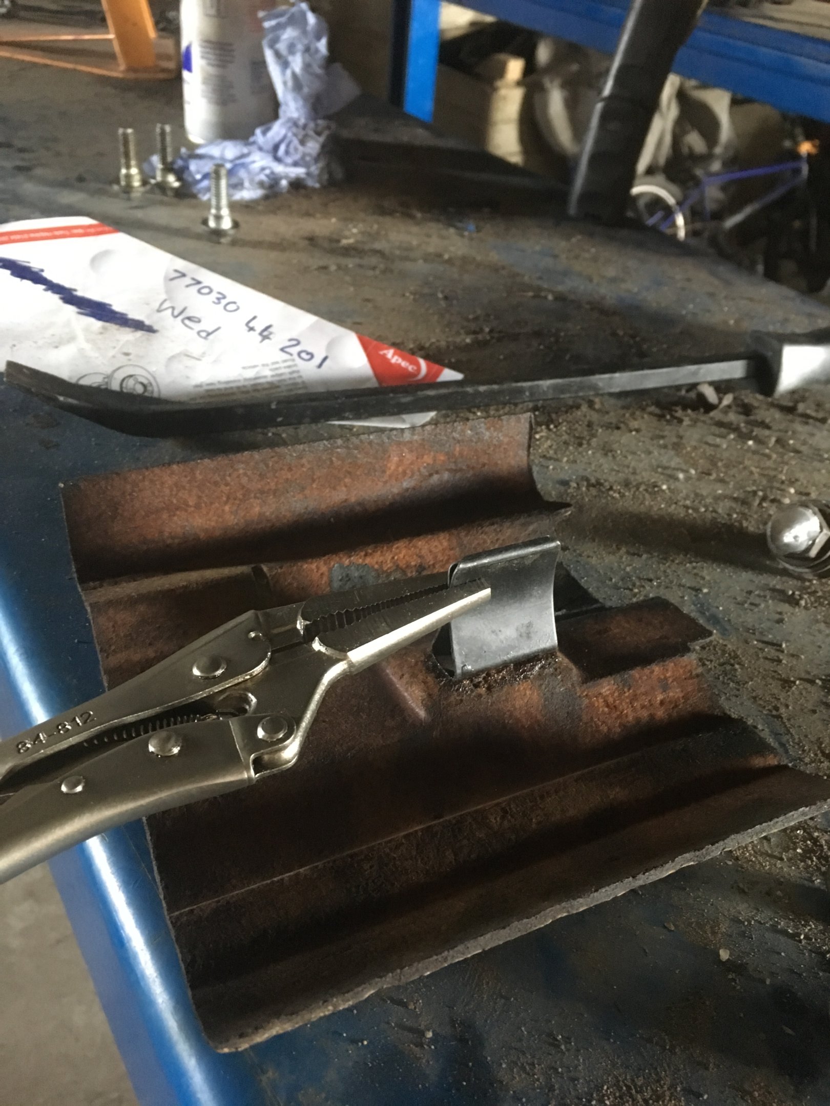

If you’re stupid like me and remove the starter heatsheild. this Method works for getting it back in... without removing the manifold ?. Just make sure you don’t put it in the wrong way like I did after taking the pic ? then break the clip off pulling it back out. Superglue is a magical thing though ?

no comment on 39 hours ?
have you glued the clip back on the heatshield?
Tell me about it, I stopped counting after that but probably close to 60... everything that could’ve went wrong or have been awkward, was. Not being Clio familiar didn’t help but it got beyond ridiculous. It’s like oh it’s only so many bolts, you do this you do that, subframes off, drop the box and fire it back together. I get that and it should be a half day or maybe a day at most. But yeah I know how obscene the hour count is but every aspect of it turned out to be “one of those jobs” in itself. So relieved it’s done.
And yeah I superglued it on haha and got it squeezed into place under the manifold somehow with needlenose vice grips. I doubt it’ll break free but if it does I’ll hear it in about the driveshaft pretty quickly I’d imagine and panic at the noise. It’s underestimated just how strong it is.

Noticed the two front cup shocks were oily and not returning although very firm. So they need done.

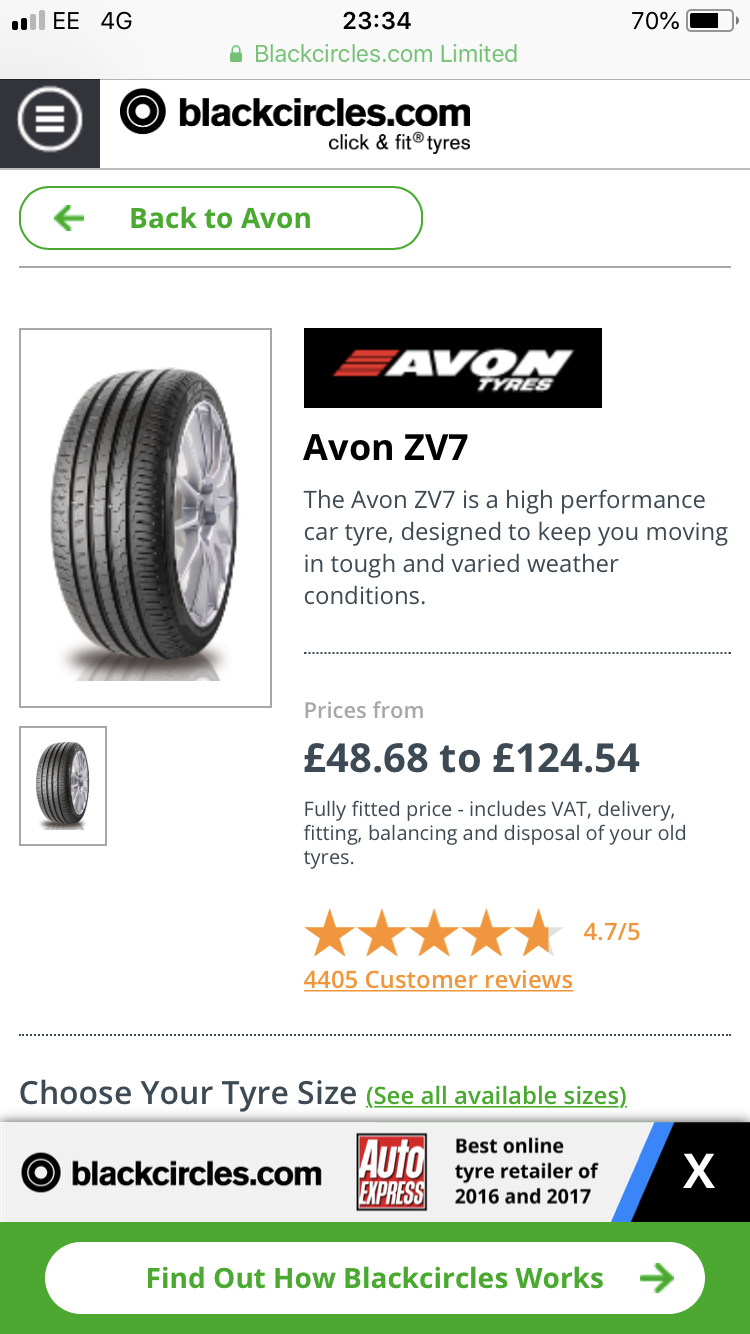

After spending 39 hours get decent tyres, t1r’s are crap. I rate the Avon zv7, £40 online. Great in all conditions.
40s not bad, I’ll have a look nearer the time. Agreed there are much better tyres out there but I just think they’re hard to beat for the money. Money being the issue as I just spent my tyre budget doing the box and all the little bits. I’m a fan of the sportcontacts and Falken ziex 714 I think they were, can’t remember now actually. T1rs are like the default unless I can find a better deal at the time.
Not hard to beat, quite easy lol.
I’ll agree to disagree ? “for the money” being the key phrase. T1r’s knocked down to 130 for 4 is dirt cheap. Represents good value for what they are, not to say they’re exceptional tyres but they’re good for the money. Tyres are such a personal thing. Those av7s seem to generally get a bad to average review. Doesn’t really mean much does it if they’re fit for your purpose.

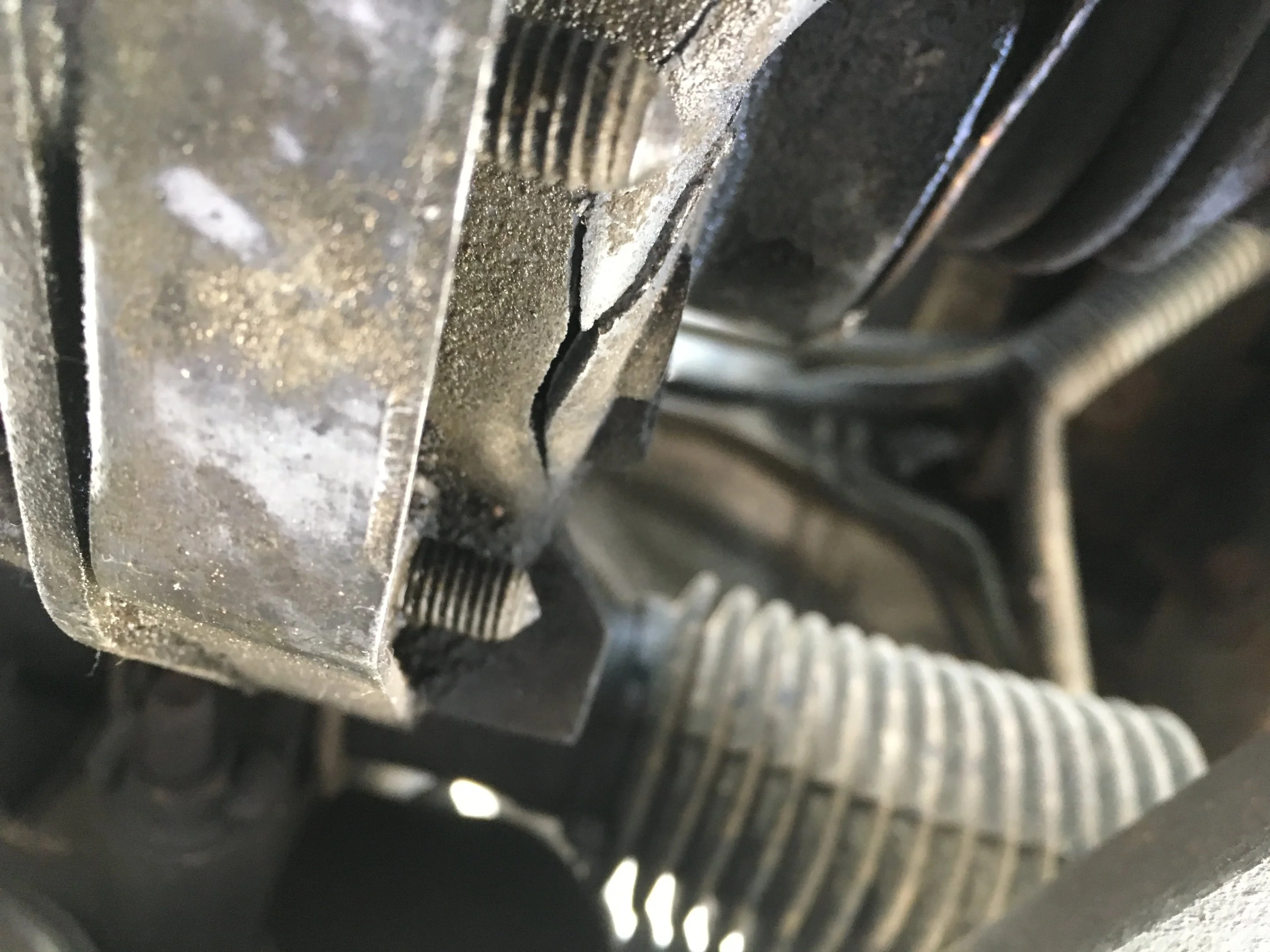

That sucks and yeah it’s just a time bomb isn’t it ? I got lucky, my box cracked clutching out from the parking space at my house and I didn’t notice till about a mile down the road so was able to limp it back. If that had happened on a trip my wallet would’ve been in a much worse state... might actually get an rac membership when the finances are back flush because... Clio sport life ?
