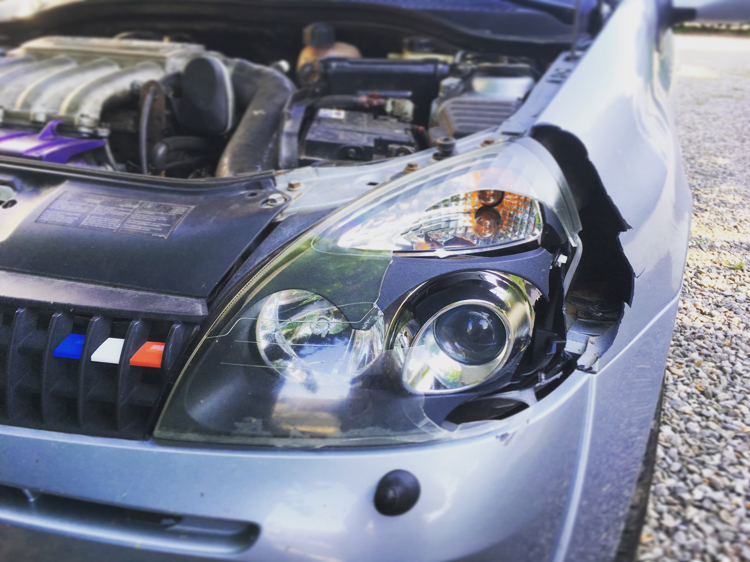

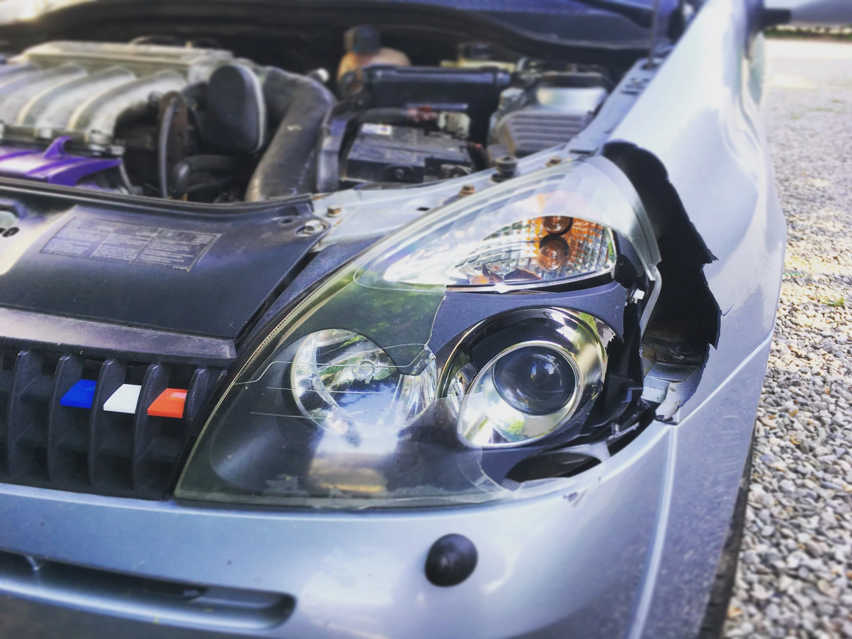

So about a week back on the road after doing the box and an oncoming learner picks up a rock about 3x the size of a tennis ball in their wheel and pings it across the road at me... ??? sourced a headlight already but waiting for breakers to be open tomorrow to hear back about a nearside iceberg silver wing at “not eBay prices”.

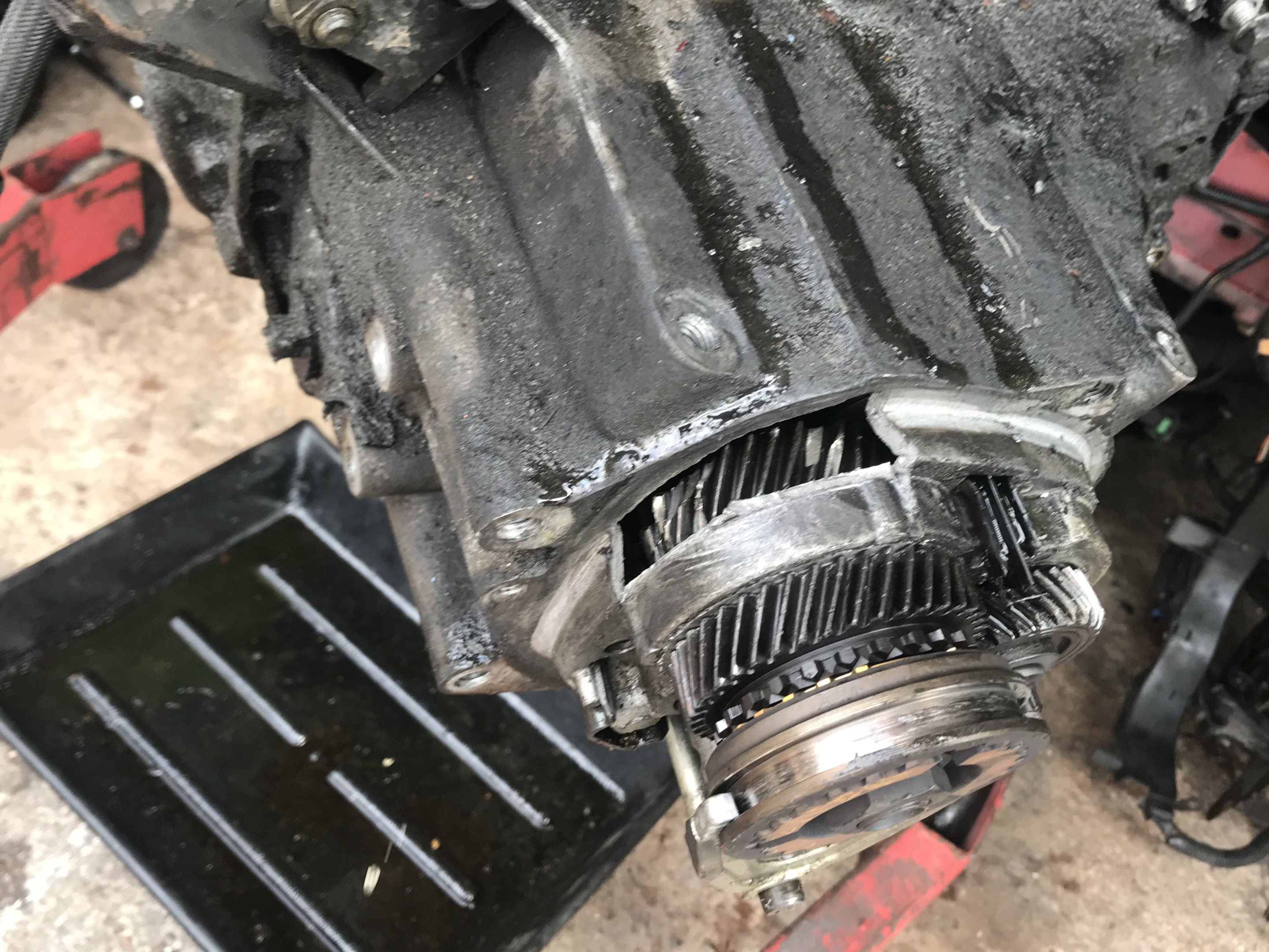

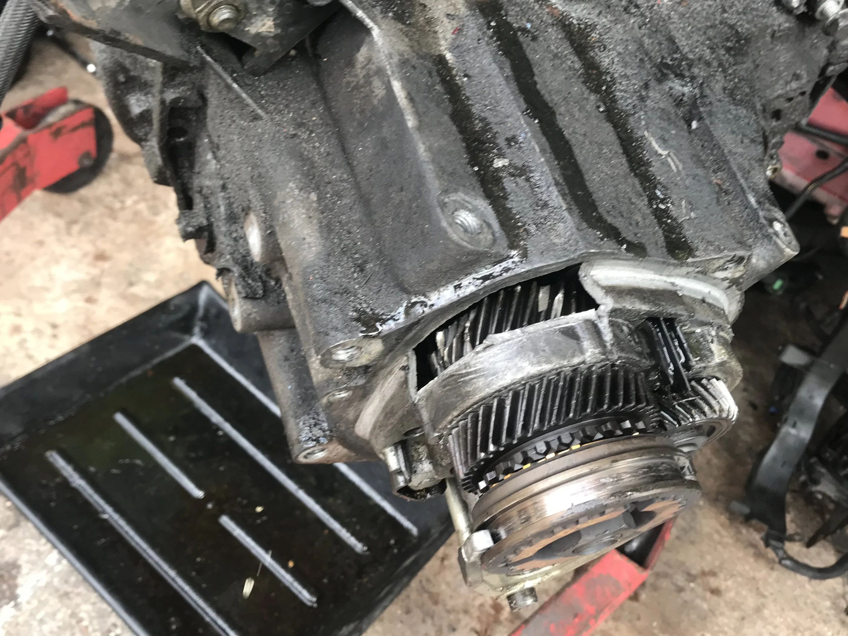

Can’t believe this is my first post here. ?? hoped it would have been the (wet side) cv boot but no joy.
Two months in to owning my first hot hatch, ph2 172, 125k on the clocks. Gutted.
Limped it a mile home. Fair to say this box is dead. Anyone hazard a guess as to what the cause has been? I’m not clued up on gearboxes I’m thinking it’s been cv or bearing related based on where it is ??‍♀️
I’ve just started doing the gearbox on my clio (used to be mine years back but bought it back in May with a ruined gearbox).
I was hoping to get the box rebuild but amazingly the case has cracked on that one too but just inside the 5th gear cover

been ran low on oil, no plastic left on 5th selector fork, straight in the scrap ?
Yep, had about an egg cup full of oil in it if that.
My original plan was to get it rebuilt until I got the 5th gear cover off... have now found another box though.
I like the way it’s created it’s own inspection hole so you can see the gears you normally shouldn’t be able to see though ?
Seen worse, had one that had busrt open like an alien had popped out of it!!!
That was down to an incompetent build though.
That’s brutal Neil. I wonder how many of these boxes will be left in a few years... almost everyone I’ve spoken to has had gearbox woes with them. Shame there isn’t an easy alternative box swap.
Mines could probably do with a rebuild, getting a bit of bearing noise from it I think. Wee rotational kinda rattle on decel. Going to wait and see if it gets any worse and hope something else shows itself.
I’m reluctant to just scrap the old box, does anyone know if there’s any parts worth salvaging from it?
