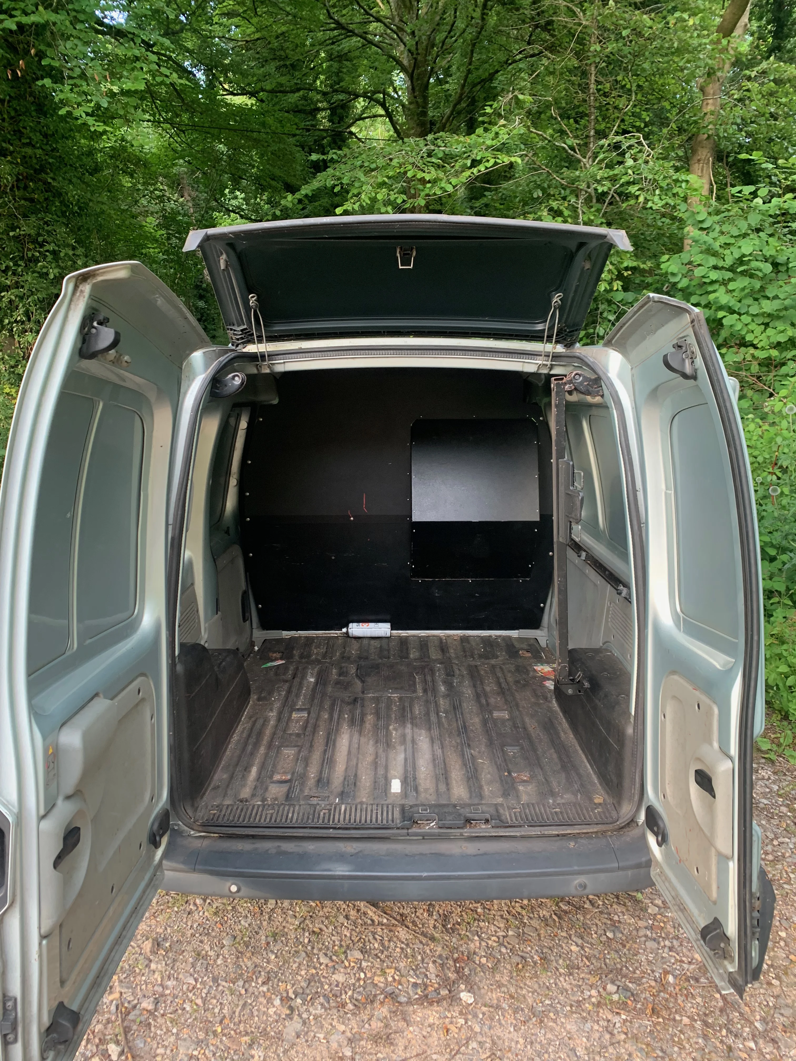

So i Have taken the plunge and started to build a 172 Kangoo,

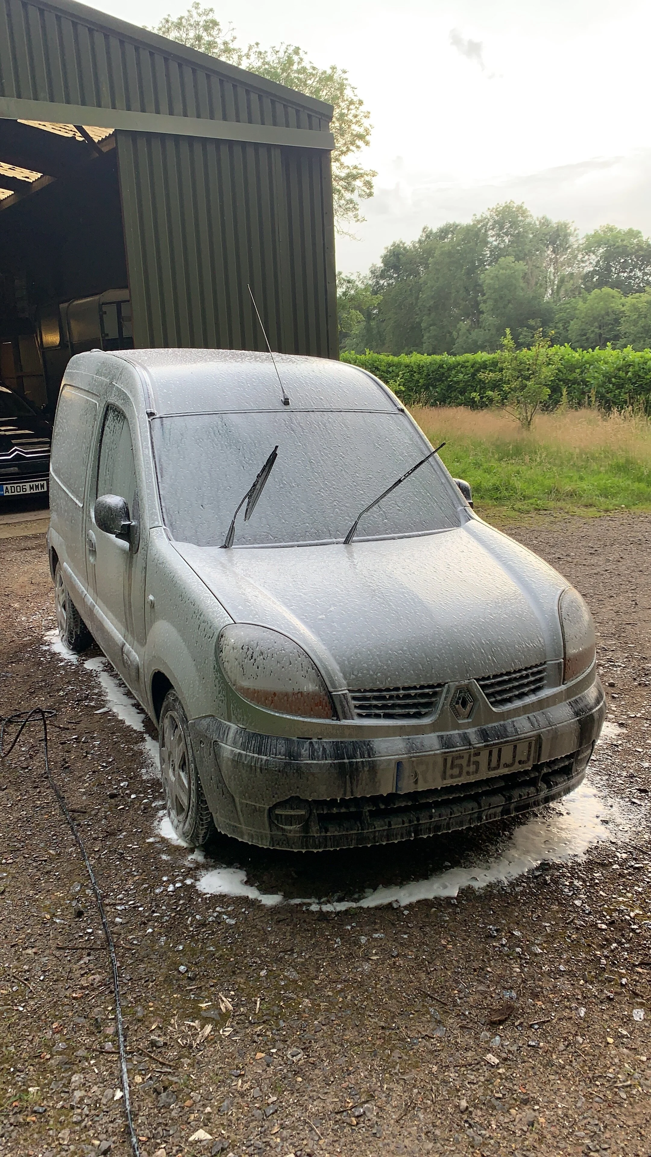

This originally came from driving around treating my current car more as a van than a car and a van probably being more useful to me day to day....started looking at vw caddy's and similar couldn't believe how little my budget would actually stretch too with vans in general (200k mile snotters was very much the theme) went to players classic a couple of months ago and saw a little white kangoo...seems odd to be here...looked under the bonnet, started chuckling to myself this is the solution to my problem, got home straight on google looking for info on the said conversion, ended up looking at some of the build threads here, the hunt for suitable donors started....

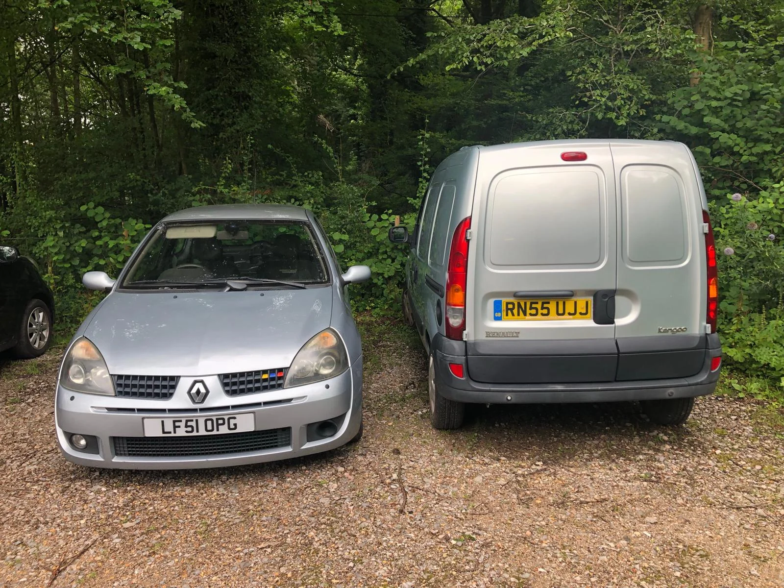

a few weeks later found and bought this, bit of an oddball in that its a 1.6 petrol auto, but most importantly had A/C and as a bonus the plastic flap in the roof for carrying longer things (or rudimentary aero device)
Also a non runner due to an immobiliser fault, overall no rot but in need of a bit of bodywork on the drivers side but nothing major.
The hunt then turned to a clio, a couple of weeks later picked this up

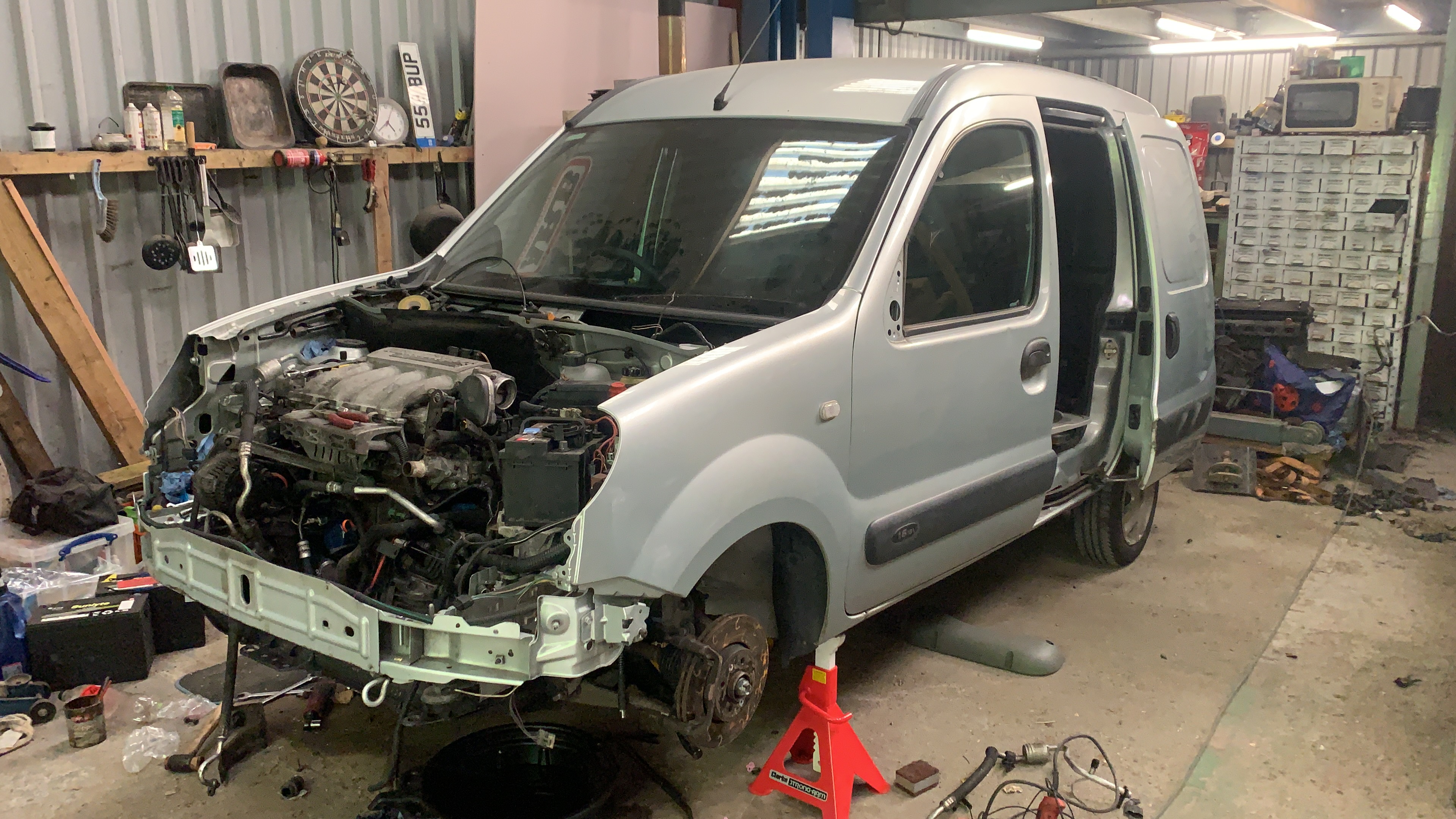

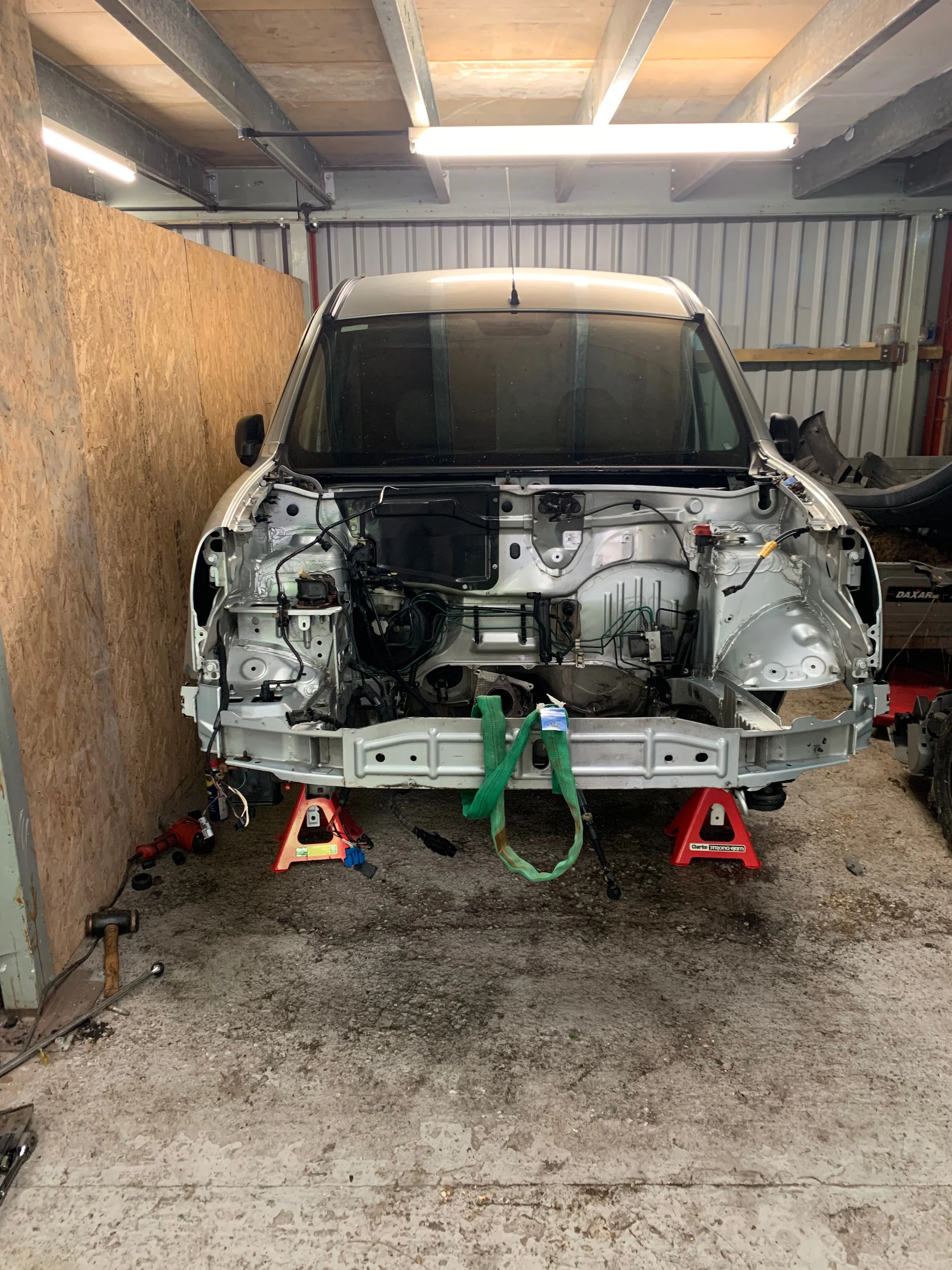

started on monday stripping the kangoo out first,
face off

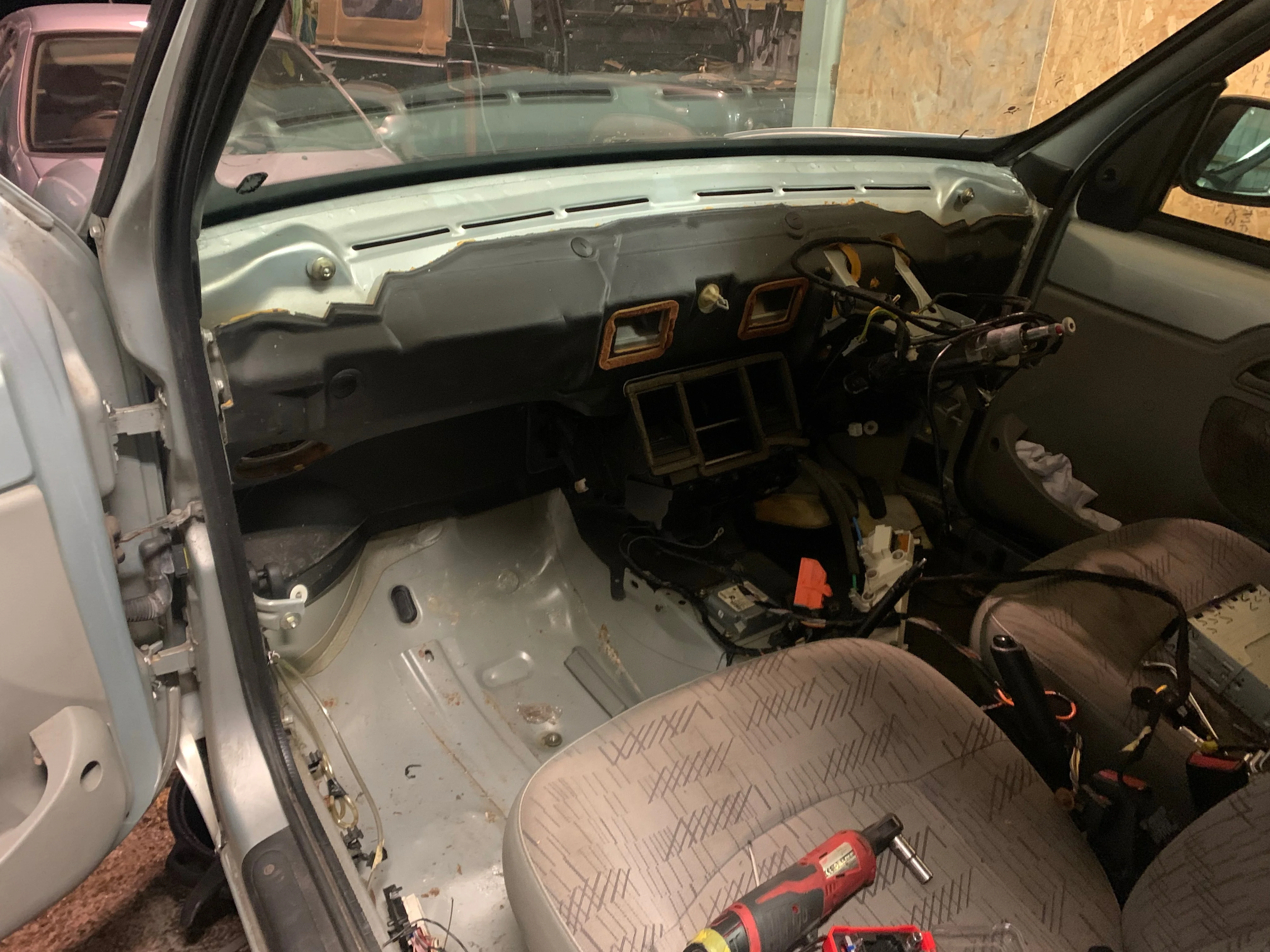

Dash out
guts out

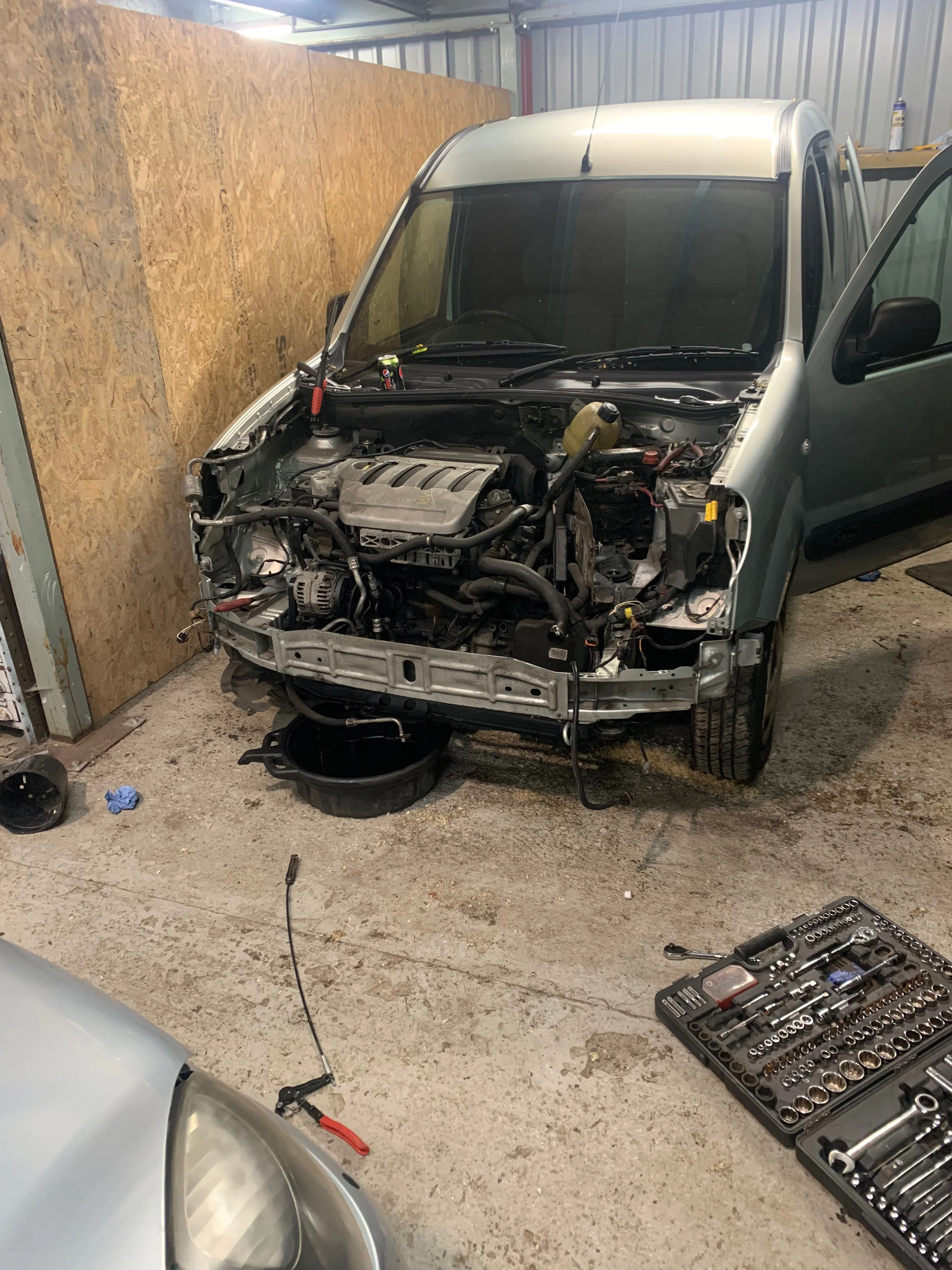

Took the opportunity to valet the engine bay whilst it was empty
The van back in situe, have since removed the medal box and exhaust, this is progress up until now, next up to break the clio, i presume i am using all the bits that would be of use to anyone on here but if anyone spies any bits that might be of use to them let me know!

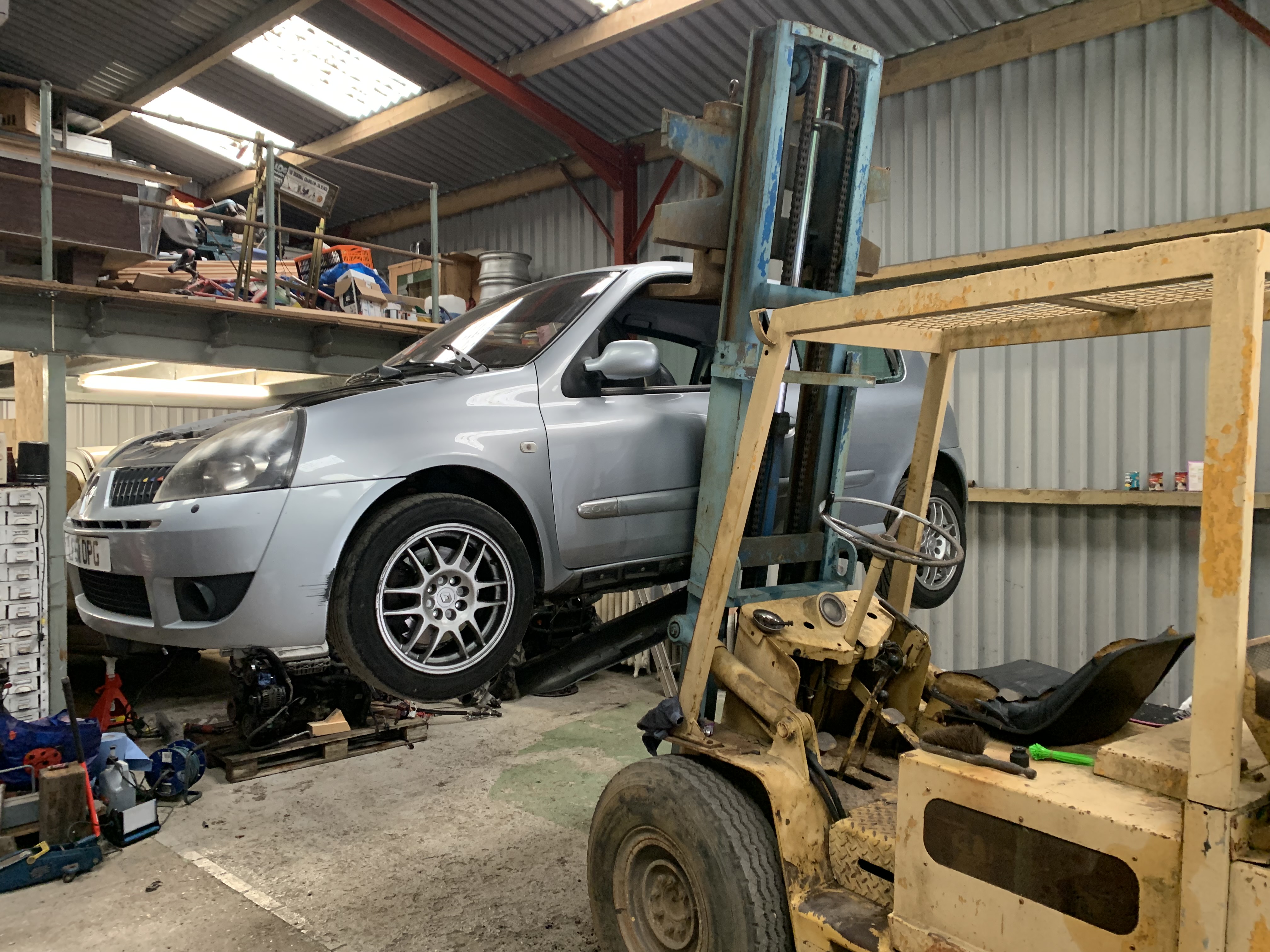

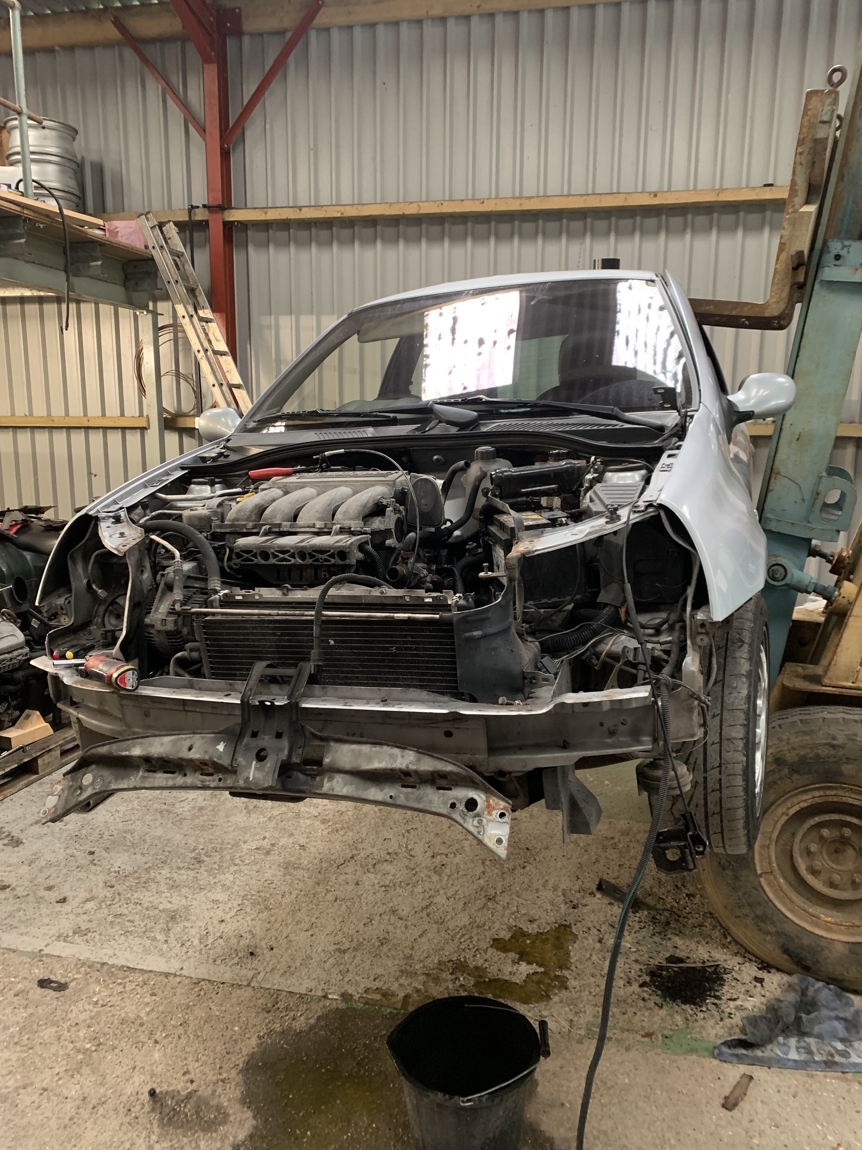

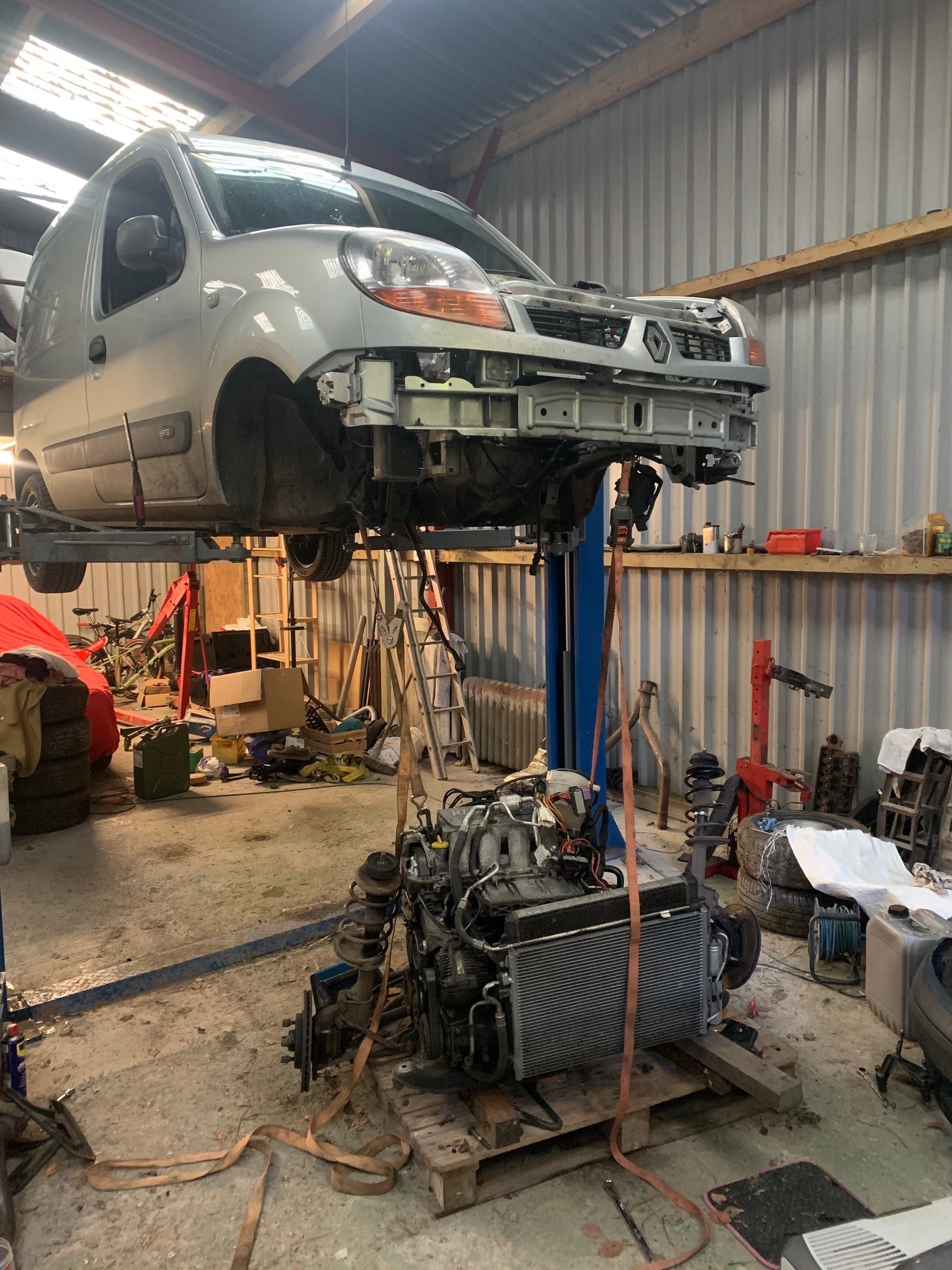

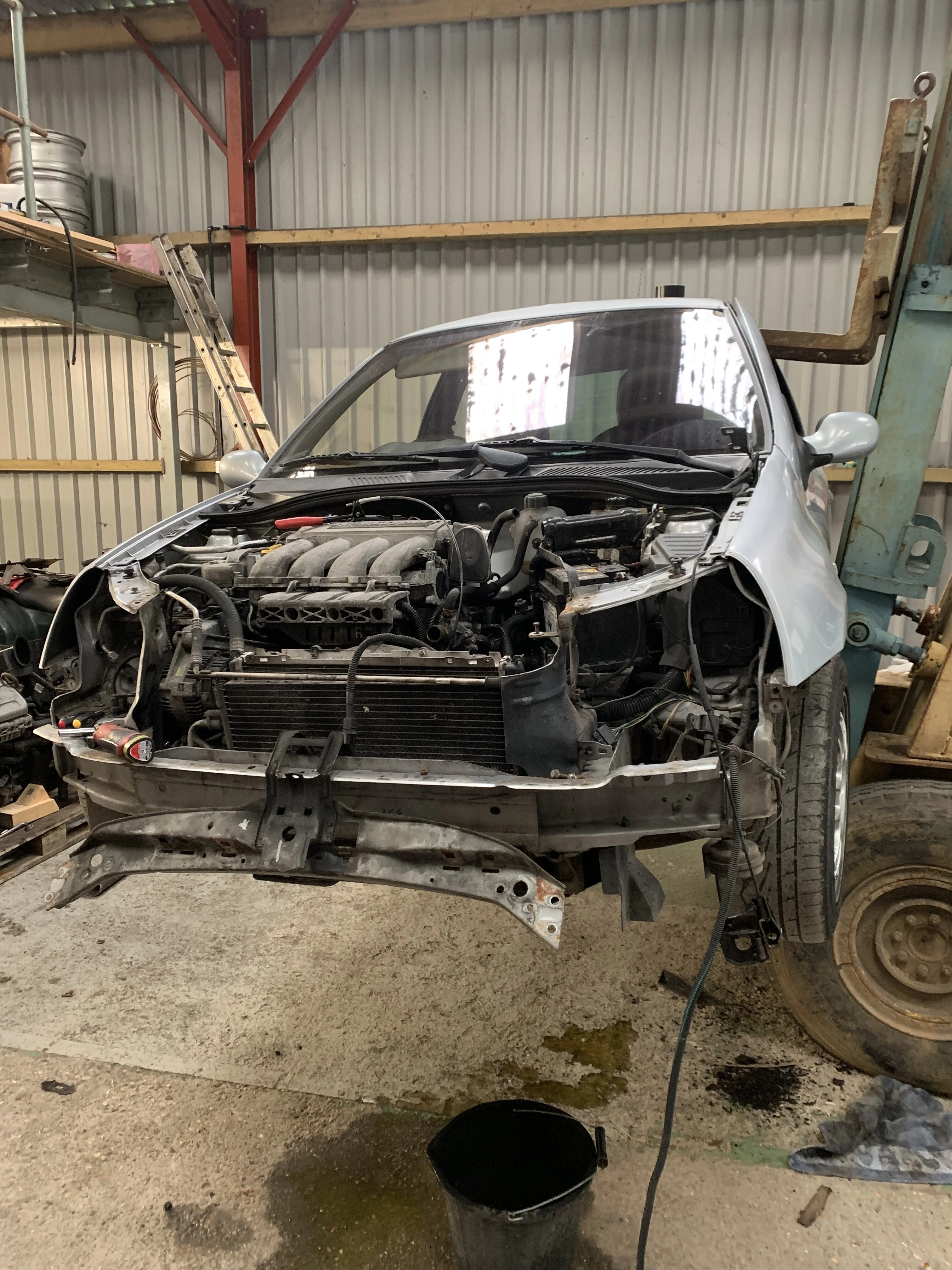

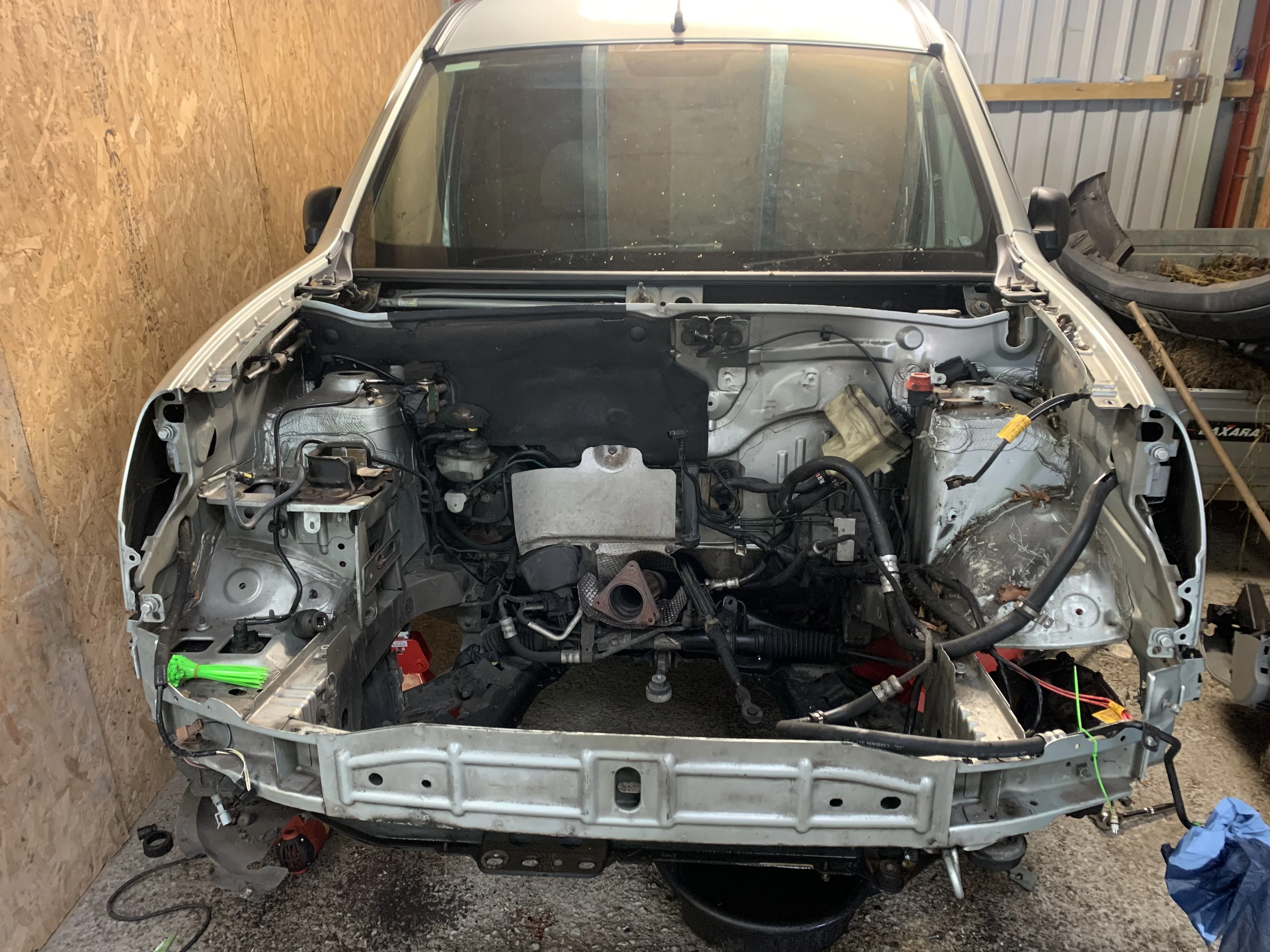

Anyway I actually had a weekend off for once so no progress over the weekend, managed to make a start stripping the clio on friday though
On the hillbilly car lift

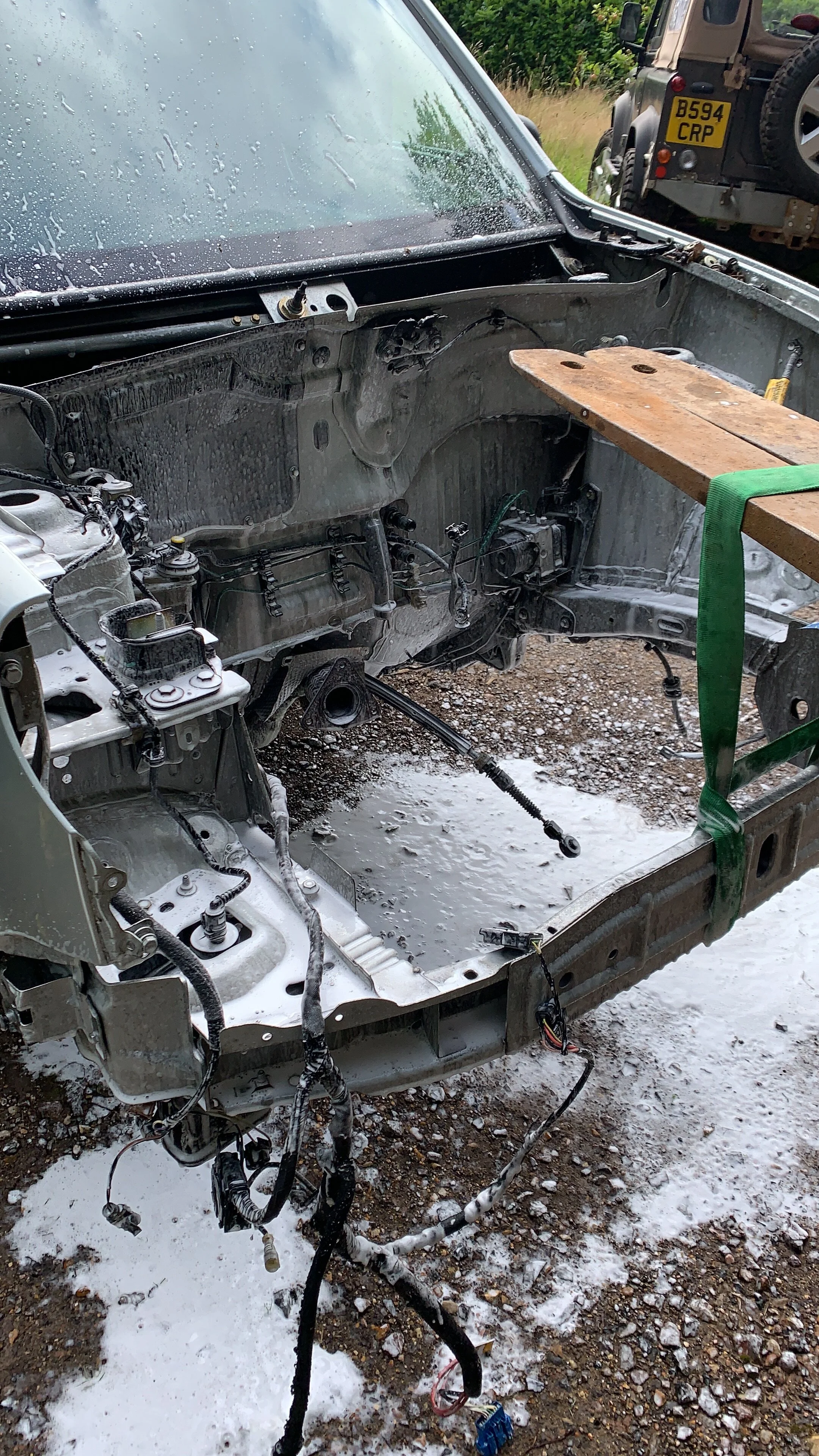

With its face removed and drained of fluids

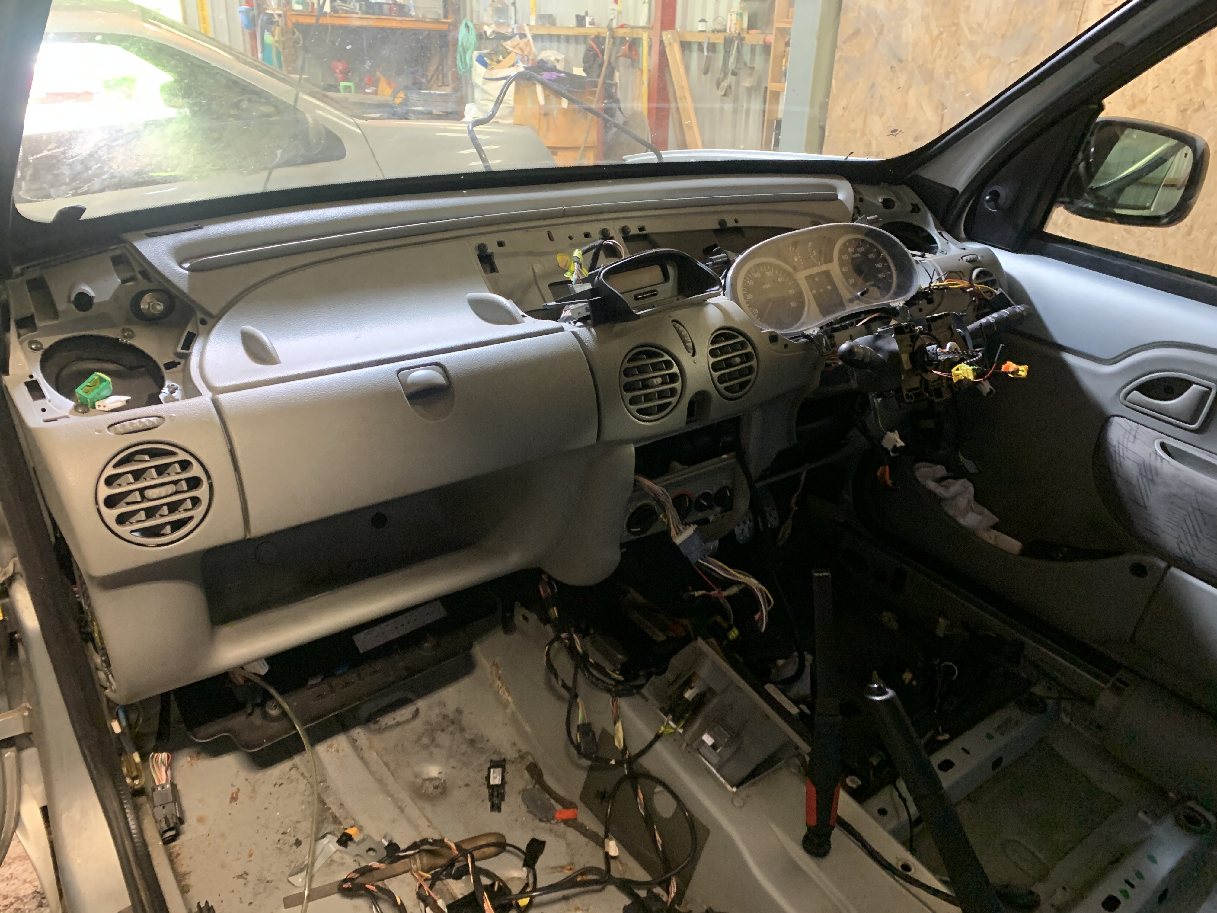

Managed to get the dash out too, looks like previous owners have been in there has a (what was probably expensive back in the day) aftermarket alarm which i need to work out how to remove! and also the red and black wires in the steering wheel (anyone know what these do?) have been cut. will try and carry on with the teardown after work tonight!

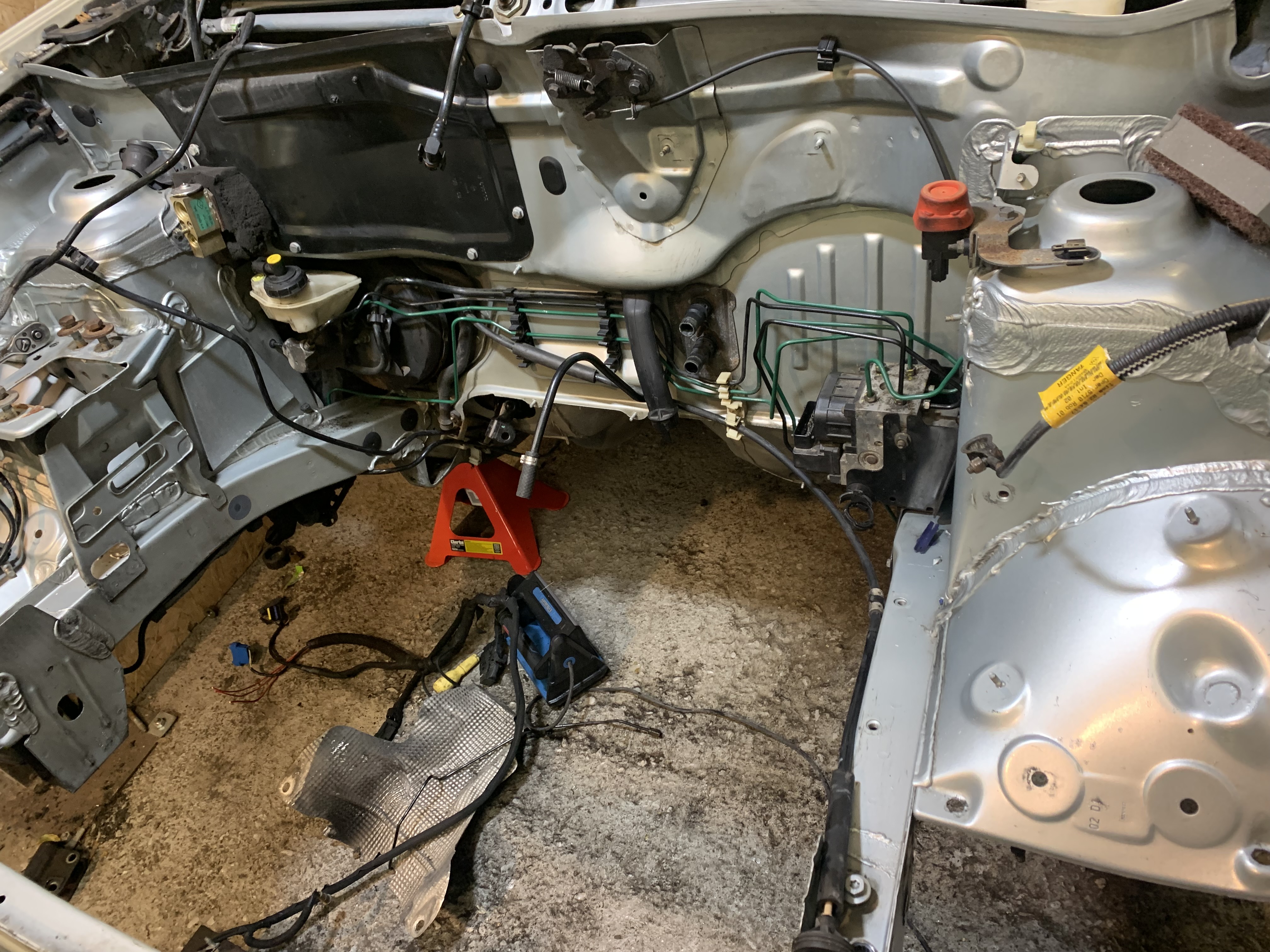

Managed to move it along a little more in the last couple of days, the square hole for the main electrical connector has been transplanted from the clio to the kangoo, interior loom has been moved across too, this has thrown up a couple of bits, the two door plugs are different so i guess the pins need swapping from the clio type door plugs to the kangoo door plugs (I'm sure I read somewhere these were plug and play but oh well!) and then the main loom that runs down the passenger sill has male pins on the clio dash loom and the kangoo loom that goes to the rear of the car, is the norm to make up an adapter plug or just re pin one of the plugs with female pins?
Also managed to get the alarm system out of the loom (hopefully!!) what a lot of faff for what was ultimately a system that re joined two wires via a control box! well at least hopefully anyway!
clio now has the engine basically ready to be removed, pulled all of the front hubs struts and driveshafts so i guess that's the next job as the lack of pedal box is what's stopping the dash in the kangoo going back in

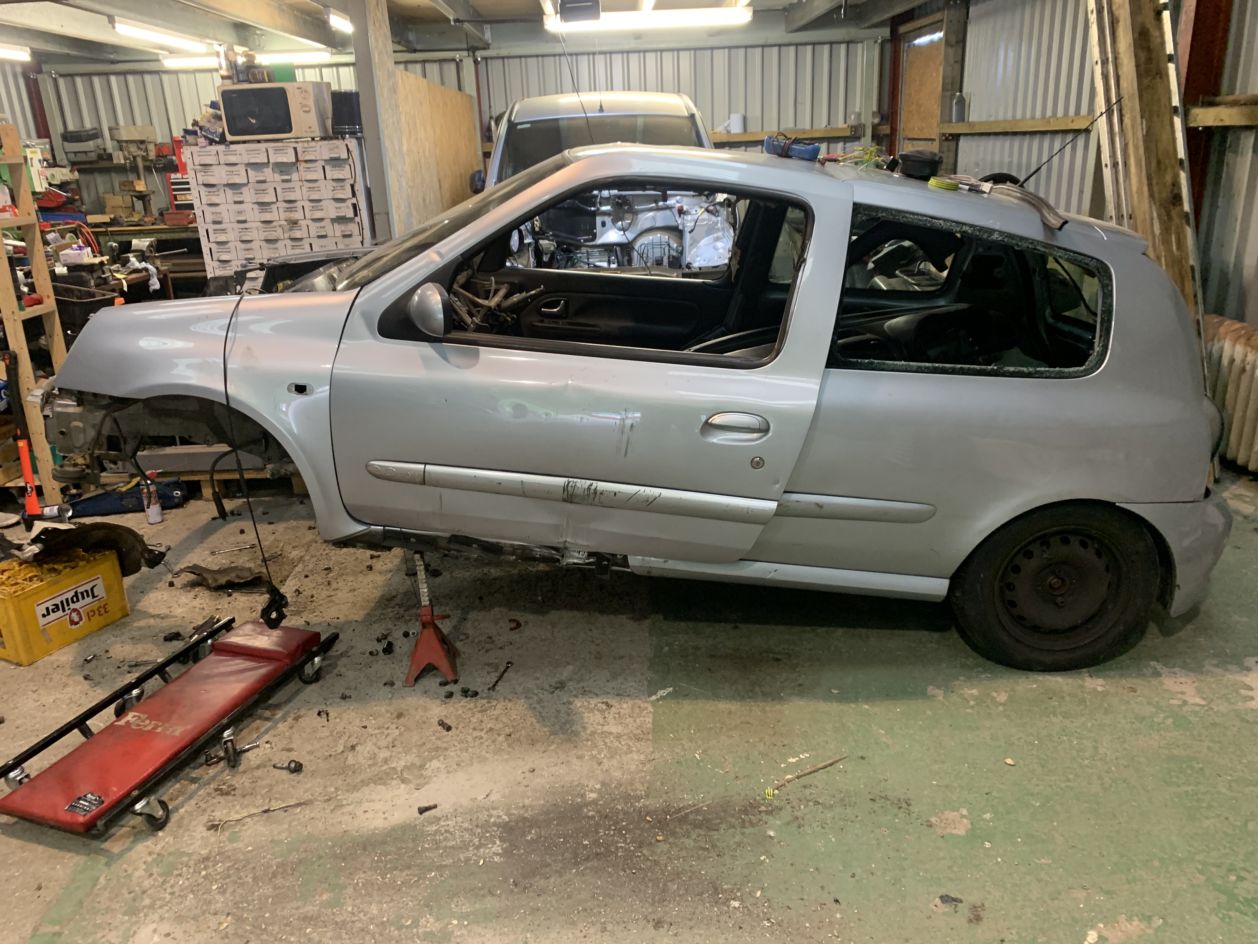

clio now looking pretty sorry for itself, need to strip the rear hubs at some point then its ready to go to the scrappy, foolishly cut the loom to the rear (the correct side of the plug without realising the clio uses the same colour for a few different things, does anyone have the pin outs for the black connector that is at the front of the passenger side sill? and even better if anyone has the pinouts for the kangoo loom to make a patch lead from?
Next job is get the engine and box cleaned up and find someone who will do the cambelt on a loose engine any recommendations in the portsmouth/southampton area?

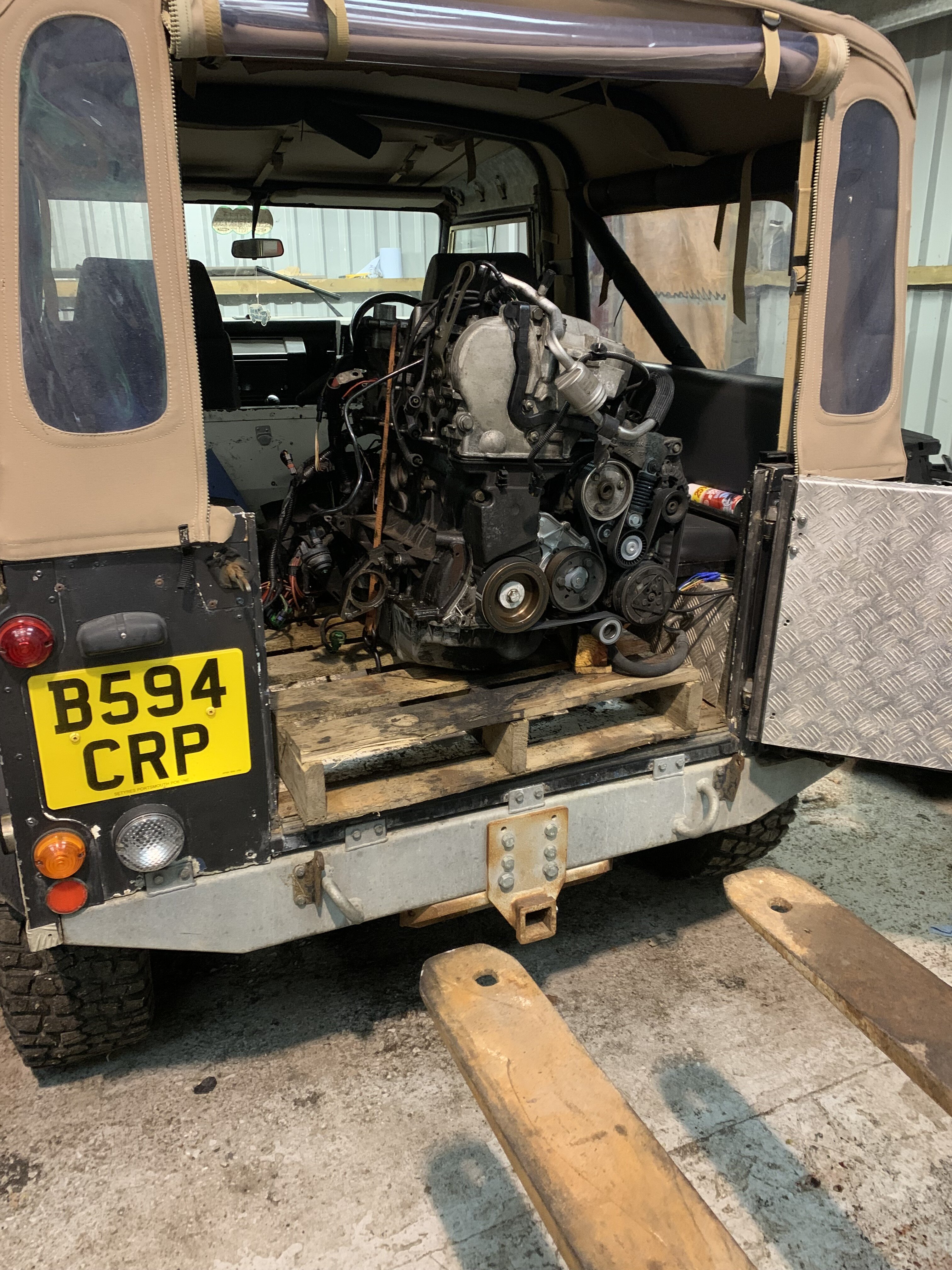

Nice pile of cambelt goodies, loaded up the land rover with the engine and took it over to the clio man, as per recommendations. Gary was great and has built a few of these vans himself too!
came back, and with some new found enthusiasm started putting it all back together
Engine in, started going through the wiring between the clio and kangoo looms, something of a headache but i had expected that!
Finally put some power to it nothing especially untoward, go to turn the key...nothing...
looked around everywhere and found an earth on top of the gearbox not attached, attached that and it fired straight up! excellent! cooling system all needs to go in next, then the main big jobs to do are tidy up the wiring rear brakes and make up an exhaust.

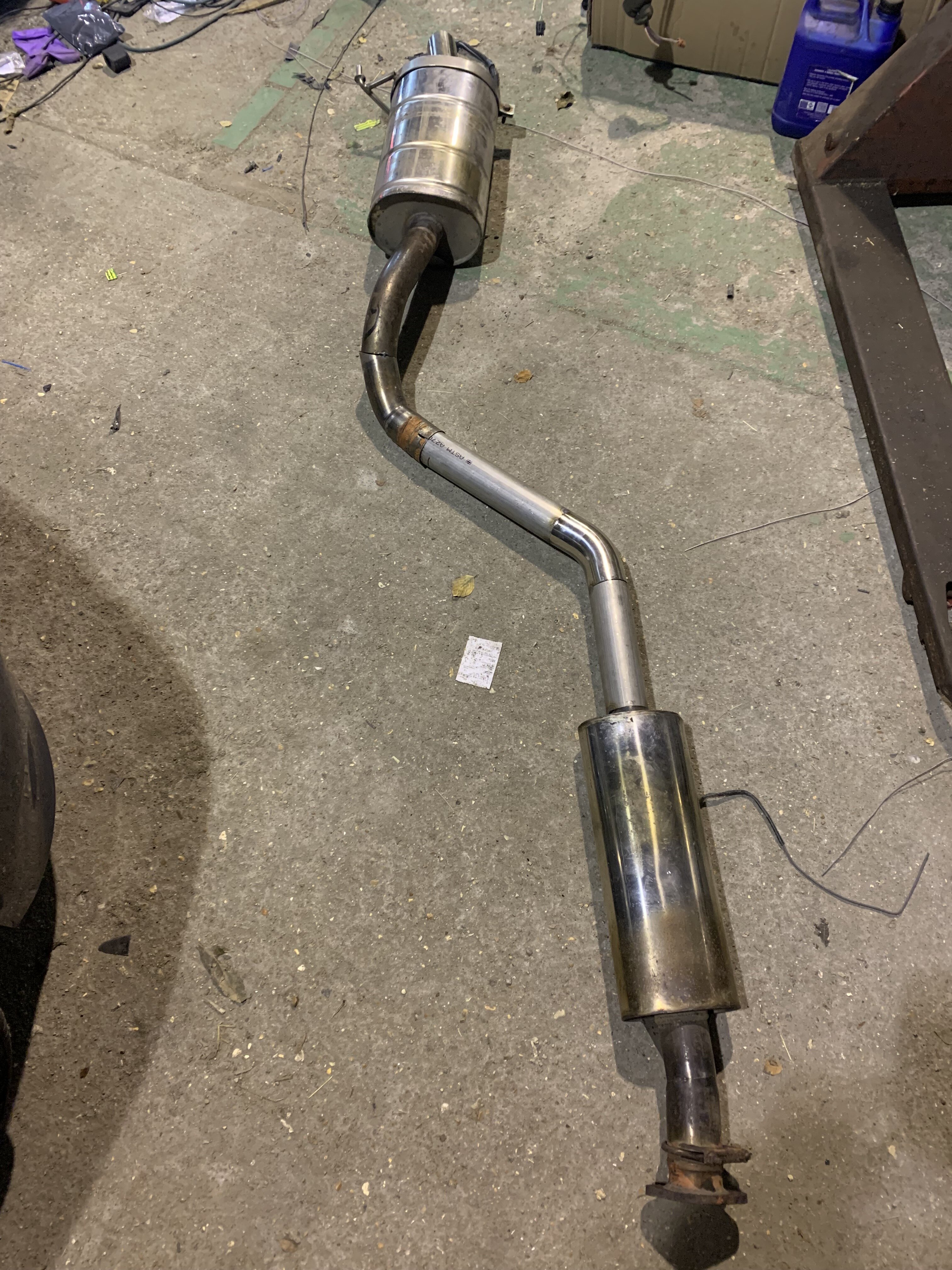

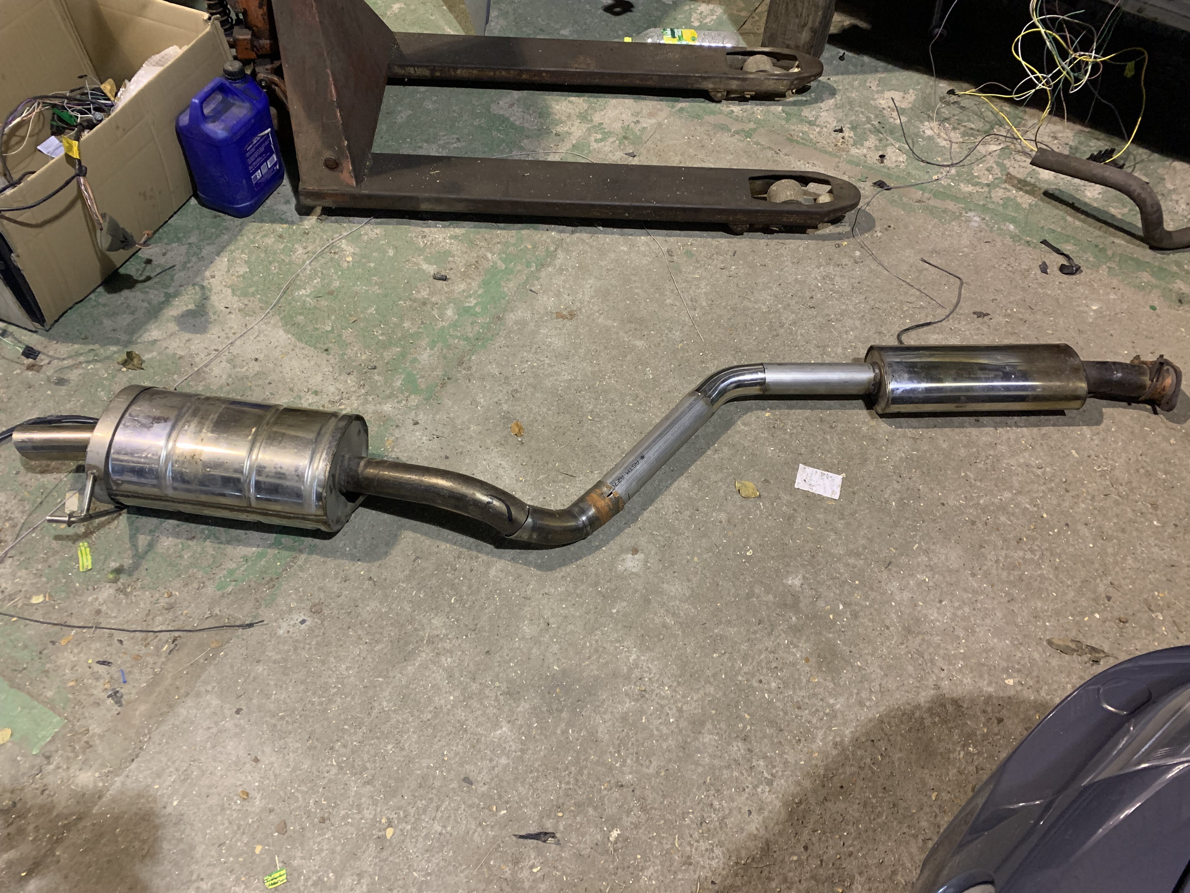

got on with the exhaust last night, a few cuts and some welding and the purchase of one bend (handily had some 2.5" stainless pipe left over from doing the land rovers exhaust) and the Ktec 172 exhaust now fits!

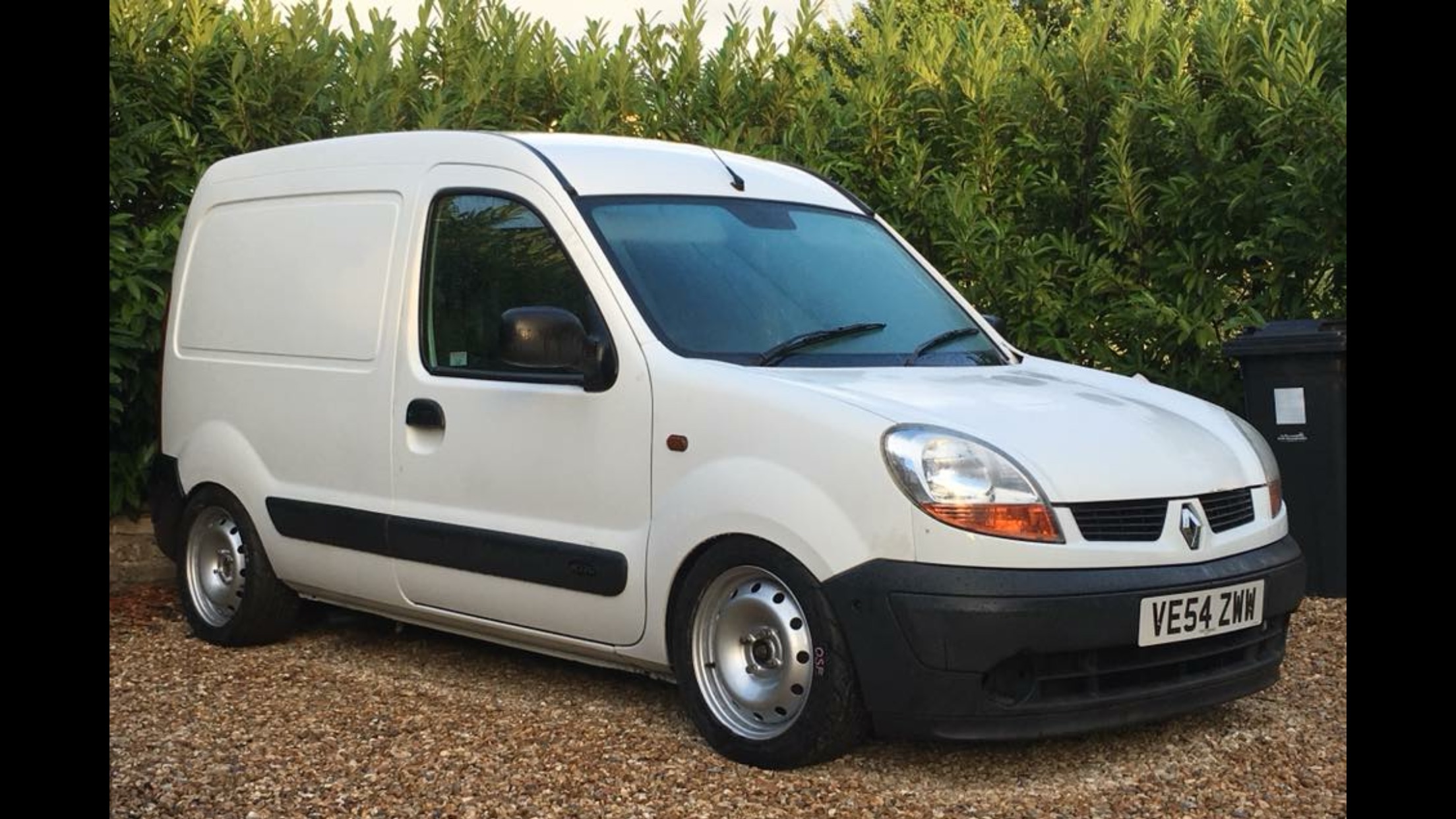

I was reading the spec on a 172 van that was for sale back in August that I had missed and the guy who had it seemed to do have done a lot more work on it after he had bought it from previous owner. maybe he has some tip s and advice that may be of use to you even though you are doing a great job and the exhaust looks awesome!!!! Hope you managed to solve the front suspension issue out

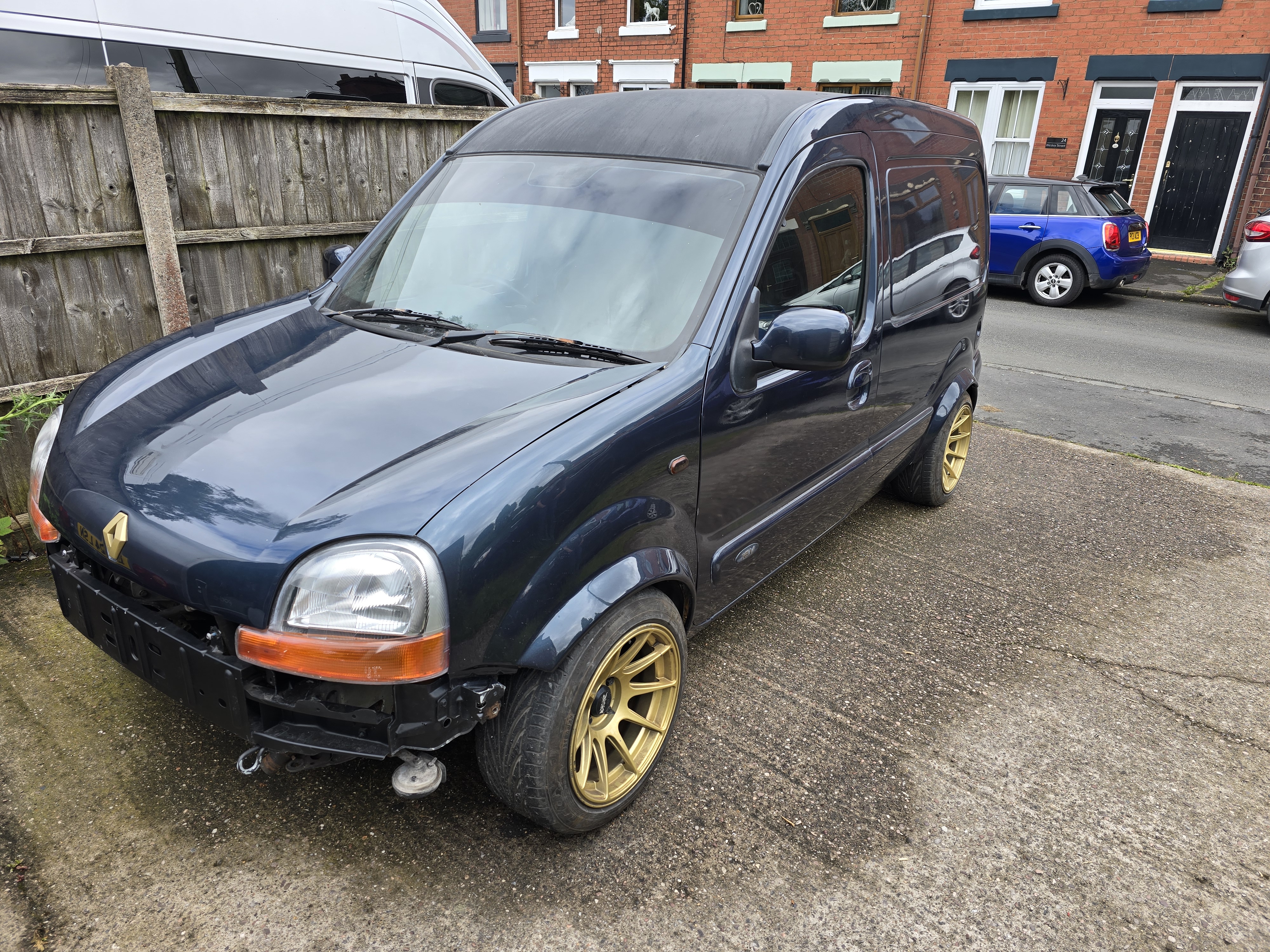

Now its down on its wheels pretty happy with the overall look! just waiting for its mot new week and should be good to go!

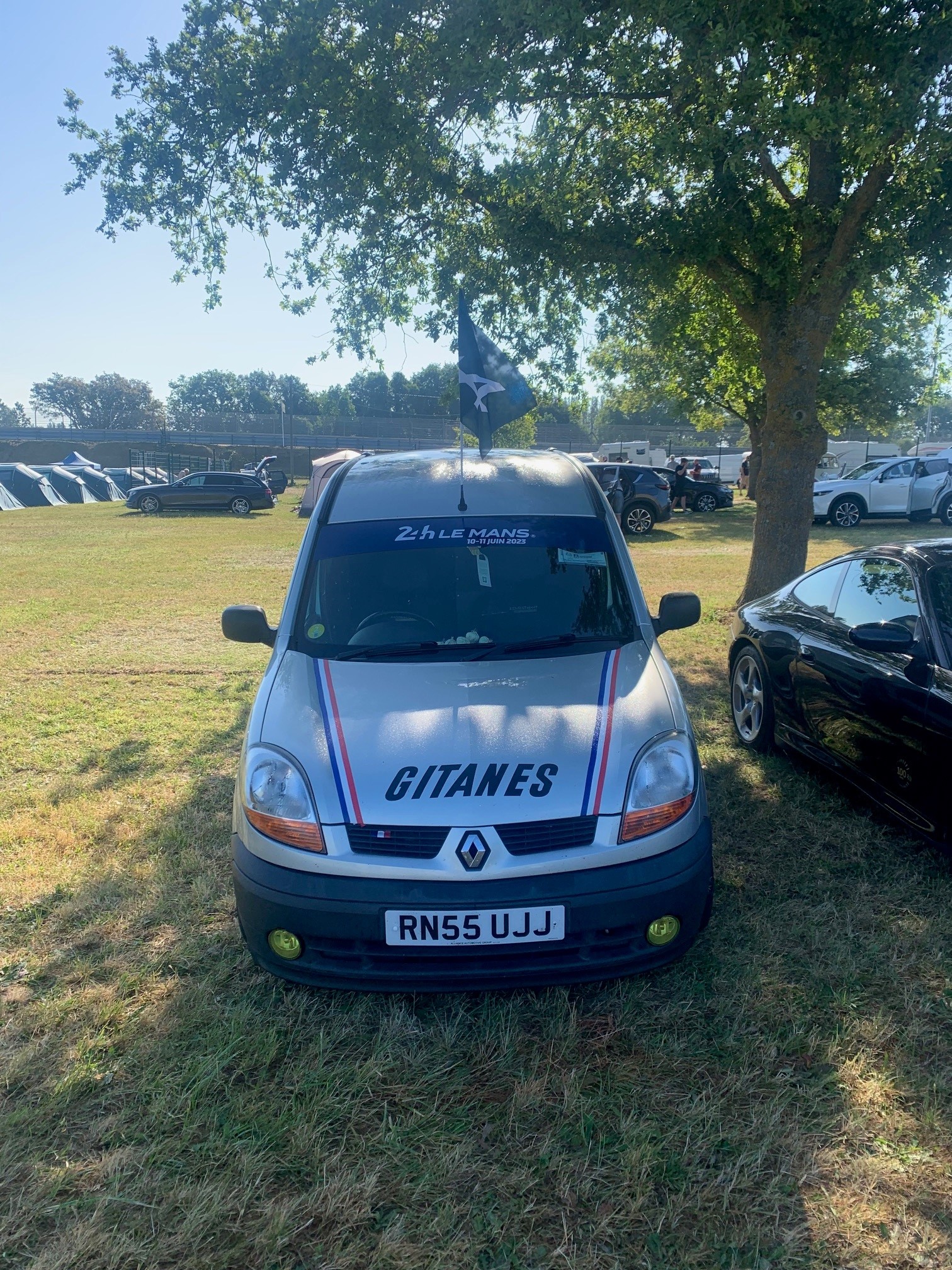

So I have been running the van for a little while, overall loving it so far great mountain bike/tat hauler and people are constantly surprised by how nippy the funny little french van is, didn't realize i hadn't posted an update of it passing its MOT! have since added an earlier grille (i just think they look better) been working through some niggles finally got all the interior courtesy lights to work as they should (i missed an earth! doh!)
things that have come up on the to do list
an abs sensor (right rear) has gone dud
lambda sensor also throwing a code
the brakes seem to have developed a weird feeling to them like a caliper is sticking or a disc is warped as there always seems to be more travel the first time you press the pedal
airbag light is now on, guess i need to go through it and double check the resistors I put in
other than that no major updates really!
