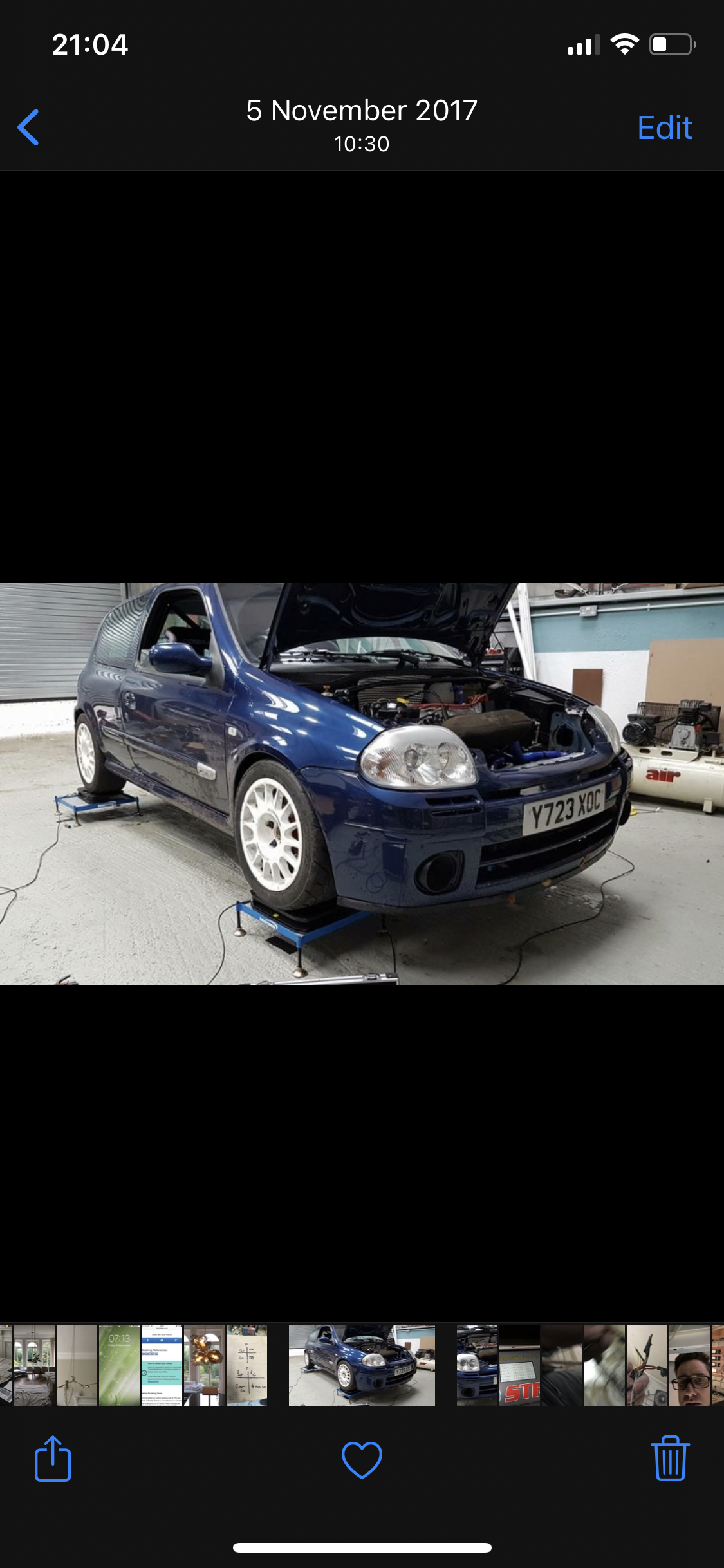

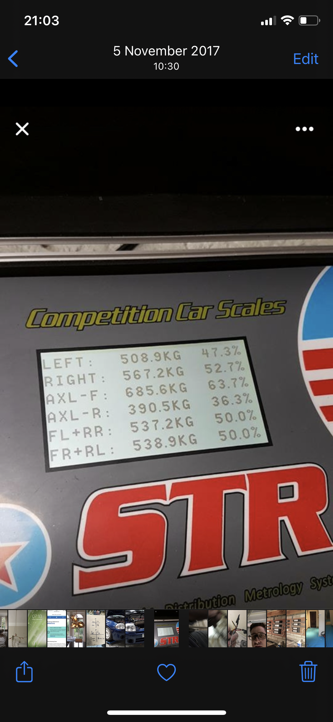

I did similar to yourself (I left the standard passenger seat in, but removed a few engine related things to offset)...and that removed 117kgs from my 172 Cup.
I’ve removed all seats for 2 cobra evolution buckets and harnesses
All sound deadening gone, all rear plastics gone. no air bags, no carpet
still have head lining and radio
All surplus metal gone
Track door cards
6 point safety devices cage
No air con
Throttle bodies
Small gel battery
Deep dish steering wheel
Brembo 4pot conversion
And me at 82kg
Overall weight 1076kg
If that helps
Track door cards
No air con
Throttle bodies
Small gel battery
And me at 82kg
If that helps
How much fuel did you have in at the time, ish?
