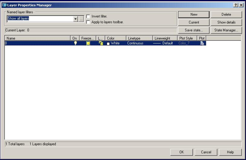

In the layer manager, you can select which layers plot or not. By default, we have every layer turned on to plot bar one, usually called the defpoints layer, all your viewports should be drawn using this layer. Alternatively, select the layer that you have used to draw your viewport in layer manager and turn it off to plot. Pic below shows the column under which youn can turn the appropiate layer on or off to plot

That will only turn the layers on and off in AutoCAD, the layers will still plot regardless of whether you hide them. You can freeze layers but in this case it would hide both the viewport box and whatever it is displaying from model space
thats pretty much what we do, i have a layer called viewport, and have it set not to plot. so you can see it on screen and adjust the size etc but when it plots it doesnt come out, simple :cool:
