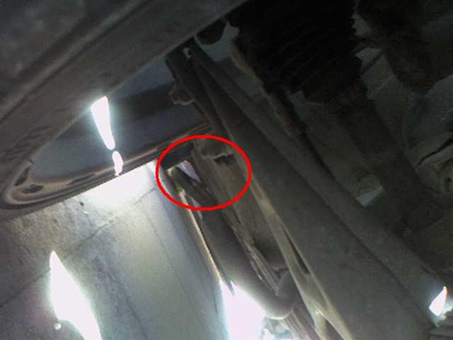

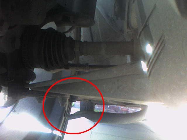

i beleive i have lost a pin or a nut n bolt from my anit roll bar.
i need someone to confirm that what i am talking about is in fact my anti roll bar?
some (bad) pictures below:
anyone know where i can get whatever is missing?
yep that is ur anti-roll thingy lol and u r missign a bolt and a few rubber washer things if i am correct, nearly certain as mine r quite bad
ok then now i know what it is, where do i get a bolt then? or what are the size of it?
P.S.
Thanks for the quick reply.
just so i dont go in and ask for the thingy ma bobbers on the anti roll bar lol
whats the right name for it then?
You want the front anti roll bar ,end bush and clamp. And a M8 ny-loc (nut) and bolt, to clamp it back together.

thanks people, ill have to get it fixed ASAP as there is a loud droning rubbing noise.

ill run by coatbridge renault dealer and grab the bolt n bits tomorrow after work, fit it and if the noise is still there ill get me mechanic to check the bearings.

i get it constantly and more when i turn left it disappears when i turn right.
i think this is due to the bar vibrating off the subframe and its within milimeters when turned left and its a fair bit away from the subframe when turned right.
but ill replace the anti roll bar bushes today after work and if the noise is still there then it'll be the bearings on the drivers side.
i check the beqaring on the passenger side and it's fine.
Paul
my fiver wopuld go on a bearing caused by the allignment being way out due to the anti roll bar link and bushes being missing ;)
check your bearing when you change the the link, just turn the wheel slowly it should move smoothly, any non-smooth movement or grating sound and its your bearing. Also check for uneven tyre wear, because as I said your allignment will be out, also as your lowered 60mm, you might find that with the allignment out you may have been getting rubbin on the arch liner, tho not sure on that last point.

put on new thingy pin...easy.
and noise is reduced but i got a mate of mine to check the car and its the REAR PASSENGER SIDE wheel bearing!!! :O
