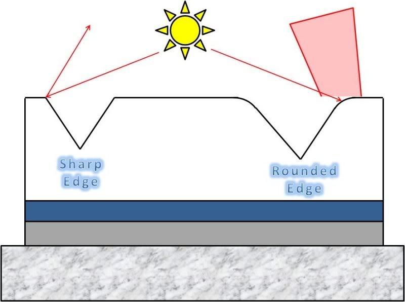

If its gone through the clear cote this is what you are trying to acheive:
(courtousy of DW)
if you round the edges of the scuff it wont show up as bad! if your lucky you may even be able to cut the paint back a bit and remove it completely
You want to get a cutting pad with a medium abrashive/abrasive cutting compound (ssomething like menzerna intensive polish or power gloss) it will need quiet a few passes to get it looking well but just keep persevering.
Even though it looks s**te at first keep passing over it (being carfull not to get it too hot and damage the paint). If its not removed/looked better after 2-3 passes then start been REALLY careful! maybe step down to a weaker polish to refine it a little.
