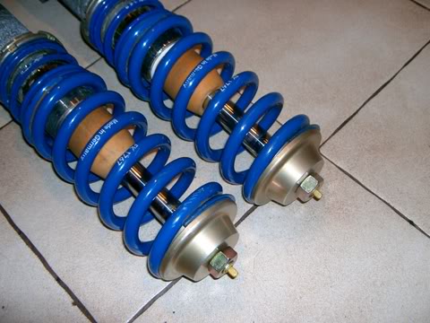

any one got a picture of an FK shock
Need a picture of an Fk front Coilover fully built - preferably showing the top.
Where the hell does the black rubber piece go??
easy peasy, follow bellow, i'm starting from the bottom up
REMOVE the large nut on top of your coilover, this is just a "postage" nut
top of coilover you have the "golden hat"
the bearing goes onto this (make sure you put it on the correct way up, flat side down)
then the large rubber doughnut goes over the bearing
insert the brass spacer lug
and srew on small 17mm OE nut
wack on car
job done
(oh and be careful setting up your camber)
there are 2 washers, a flat round one and a round one with raised bits on it - do these go above the bearing or below and does the rubber doughnut look like a dome (wider at the bottom than the top)
you have the coilover, then the metal hat as fred called it, then the big "washer" which is the bearing it has one flat side and one with a curved face the flat side goes at the bottom, then the bottom rubber donut then the brass coloured spacer goes in the middle followed by the shallow nut then the whole lot goes up into the arch and you replace the upper half that you can see when you lift the bonnet. Where are you based fella ?
cardiff mate - one of my mates is supposed to be fitting them on saturday but he has only ever fitted Spax coilovers - just want to make sure we know where the parts go - was gonna get fred to fit but Im skint til next weekend plus Im workin that weekend so it would be a few weeks before I could go and see him.
A little far for me (swindon) its pretty straight forward though you basically refit all the parts in the same order you remove them from the original strut.

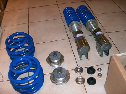

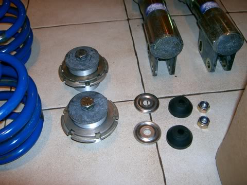

???? there aren't any washers in the top mount
i'll get you some pics of the parts
nice 1 fred - i would come and get them fitted with you but I am skint til next week and working next weekend so it would be a few weeks before i could get up to you - I meant there were washers supplied with the shocks - there are 2 big ones, bout 2-3 inches wide - another 2 then about an inch smaller with raised bits on it and I also had 2 washers with slits in them which i presume go under the locking nuts. I am sure my mate will know what he is doin but just want to make sure!
I will send you a picture tnight of all the parts I have if thats cool.
i have now realised half the nuts etc I was on about were for the rear - tosser eh!!
anyway here are some pictures of what ive got
nice 1 fred - haha
