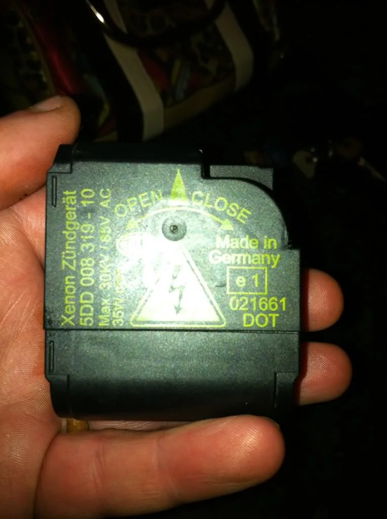

Any one know what this is
Car  172 sport
Hey guys anyone know what this is and how to tell if it's faulty or not changed my lights today and driving him hit a huge pothole light went out just thinking is it this or another part I need to check thanks in advance guys
Are they prone to failing mate or is their Amy way to test of its gone apart from swapping igniters around to wet to dark right now lol cheers for quick reply mate
what lights did you change? xenon bulb? should twist onto the back of the xenon bulb. there also should be a wiring connector that plugs into it.

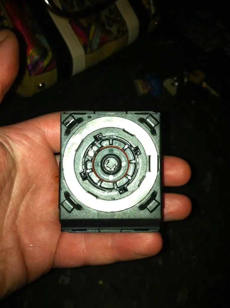

Well I've tested it by just plugging the wires into the igniter nothing I take it the bulbs just pop into the igniter in one way there is no upside down side to it I take it
when you plugged in the wires, was it fitted back onto the bulb? or just in your hand... the igniter needs to be fitted onto the bulb for it to work. Yeh in your 2nd pic, thats the right way - arrow up

Swapped the ignitors over one that was ok works both sides the other one is knackered well te hunt for a ignitor begins
Also quick question when putting the igniter back in with the plastic ring does it slot in in any particular way as mine does not feel right if that makes sense cheers
