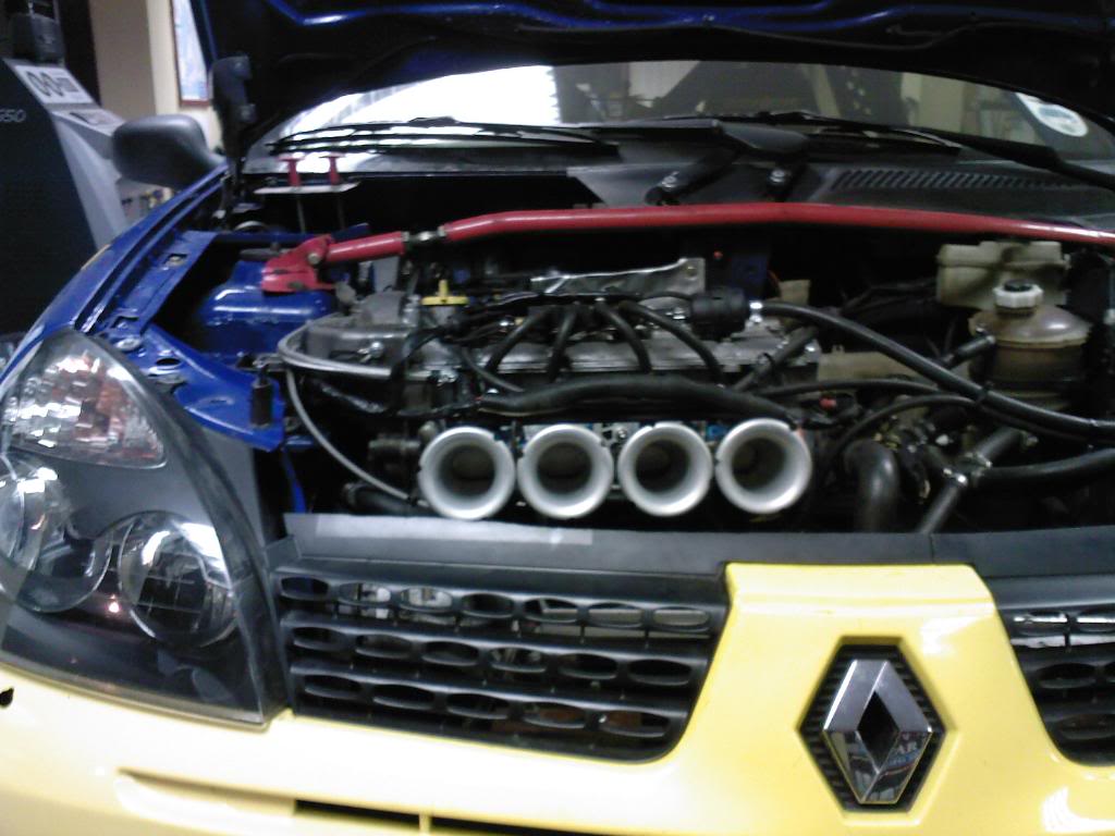

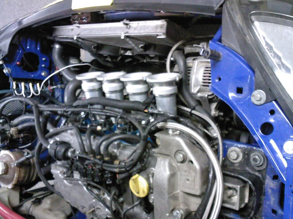

They do look good. Hear are mine. 70mm extensions and 60mm ram pipes.
AT are making me up some 20mm extensions collars so I can play with induction length. And still keep my alloy air box.
  Clio 220 lpg
Are you using straight or tappered? they have sent me both to try.

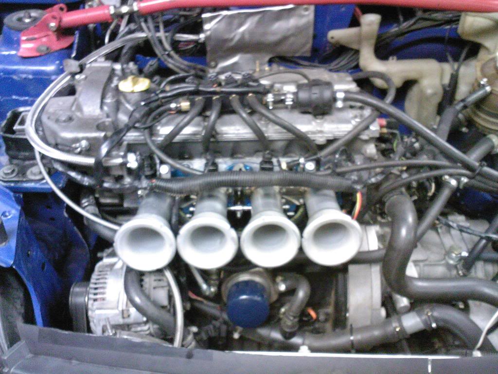

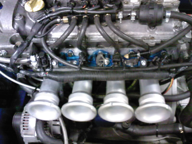

Only had a ride up the moor road but good god does it pull.
Thought this week I would put the car together enough to give it a run with the new throttle bodies on and the 197 injectors and before we have tryed to tune her yet, a run up onto the moor has proved that the pull from 3500 has improved loads over what we had on before.
The sound from the front when the cams start to kick in is very agressive, and then when we hit 7400 (which is were the shift light comes on) pull back the stick and it just sings all the way upto 6th.
The trumpets are tappered at the moment so after this weekend going to tune it on the road with them and then try the staight, save both maps and then head to the rolling road.
