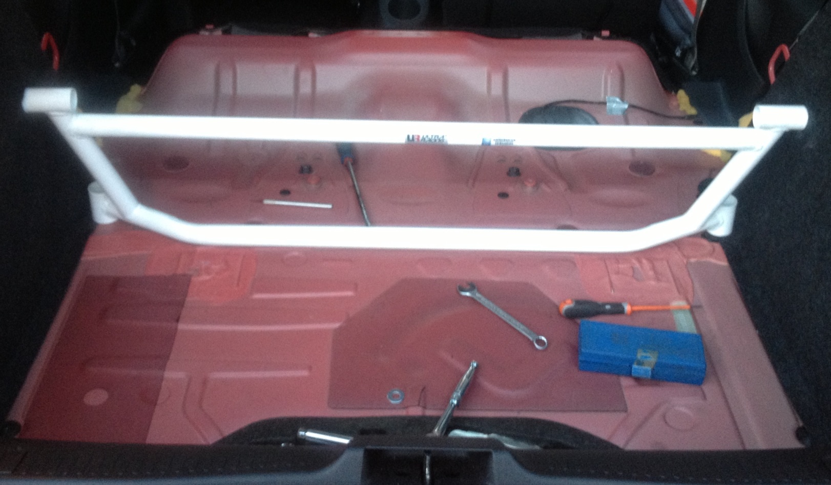

i have RS200 and fitted a rear boot brace by URacing. However the top mounts for the brace dont seem to line up with anything? Bottom ones line up with the pre drilled holes in the floor fine. any help would be ideal. :dapprove:
You need to trim the carpet rearwards of the little loop where the seat back clips into. There is a hole each side for it to bolt in to.

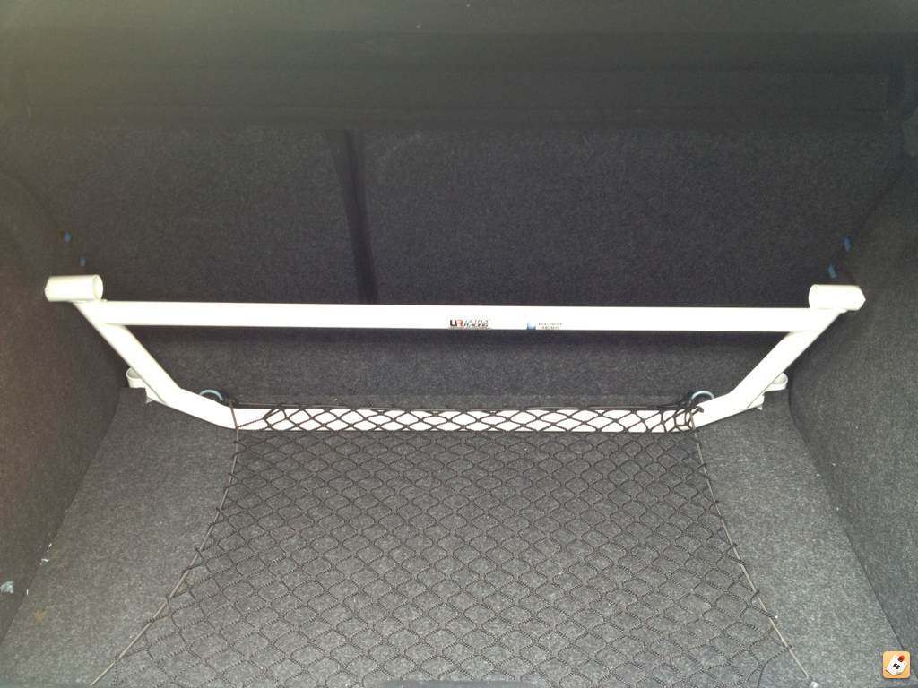

I haven't got car with me so can't get any better photo than this one. But mine seemed to line up easily and quite straight forward :s
Yeah, they bolt into that flimsy bit of tin at the sides that you can flex by hand and do sweet fa.
Managed to fit it once I have figured the sides. Nice bit of kit and looks good too !
