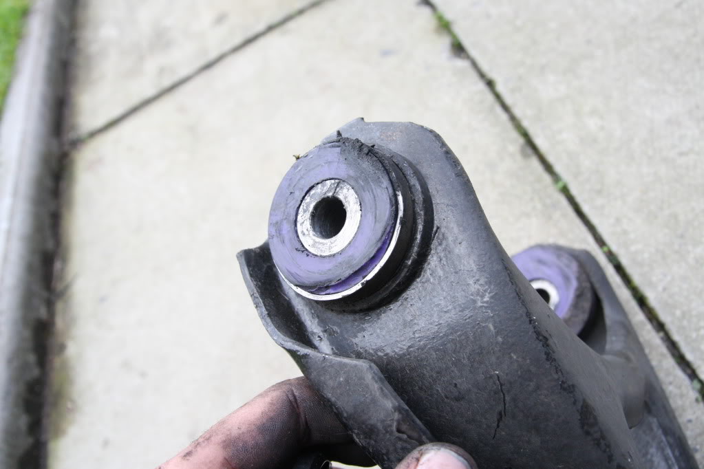

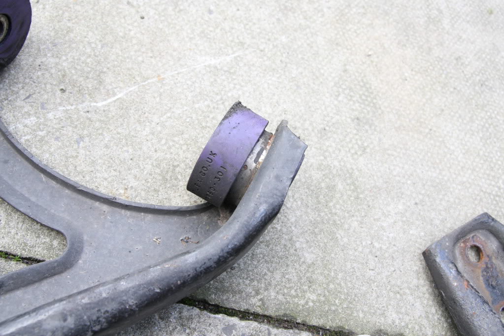

The sleeves do move quite a bit if not tacked, mine did over a years use on track. Although it sort of shows some (well, a lot) of the stuff on this forum is b*llocks as I was told not to bother, then this happened. Whipped them off, adjusted, welded and refitted. Done another 16 months without issue. They looked like this once moved..
The sleeves have moved in my pics (i.e. they are in the wrong position)
The sleeves should be flush up with the inside of the wishbone, then tack welded on the outer edge. I just ran 3 x half inch welds equally spaced round the wishbone on all of them. Then the bush goes in and sits flush on the inside against the wishbone :)
