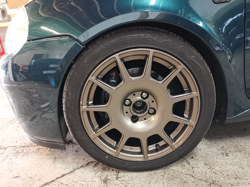

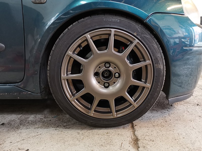

Noticed straight away the passenger side wheel looked to sit further forward
Driver:
IMG_20190813_105120 by B-shaw55, on Flickr
Passenger:
IMG_20190813_105109 by B-shaw55, on Flickr

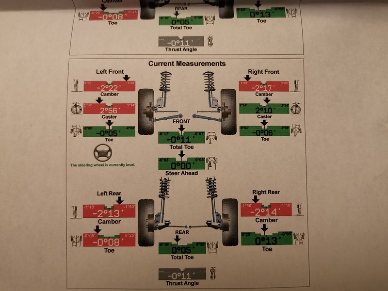

Got tracking done, and the chap was like, passenger wheel is almost 5mm further forward
IMG_20190813_221839 by B-shaw55, on Flickr
I'm not sure if that is 5mm, could anyone confirm? is that bad enough to cause issues?
On driving back I noticed the steering is very heavy and the wheel doesn't return to centre.
I checked the tracking from before and the castor is almost perfect, so I'm putting it down to something I've fitted.

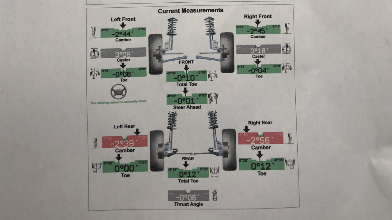

Dunno if this helps you. My car is a Cup and definitely has the right wishbones. I have K-Tec solid mounts standard Hubs and running Ast5100s. Black bushes were tight getting the washers in on mine too. What I have noticed is after I had a Gripper diff fitted the steering is a lot heavier but does centre ok. Anyhow. Here is my setup sheet and I seem to have more caster than you.
Driver:
View attachment 1430002IMG_20190813_105120 by B-shaw55, on Flickr
Passenger:
View attachment 1430003IMG_20190813_105109 by B-shaw55, on Flickr
View attachment 1430004IMG_20190813_221839 by B-shaw55, on Flickr
All I can think is its an issue with the wishbones.

How much castor should cup wishbones have? which side is actually closer to being correct?
Nah the hubs are very much plug and play buddy. You need to have a look at the subframe to see if the rear bolt holes have elongated. Definitely check your wishbones though, but the drivers side looks to be giving the correct cup castor offset.
