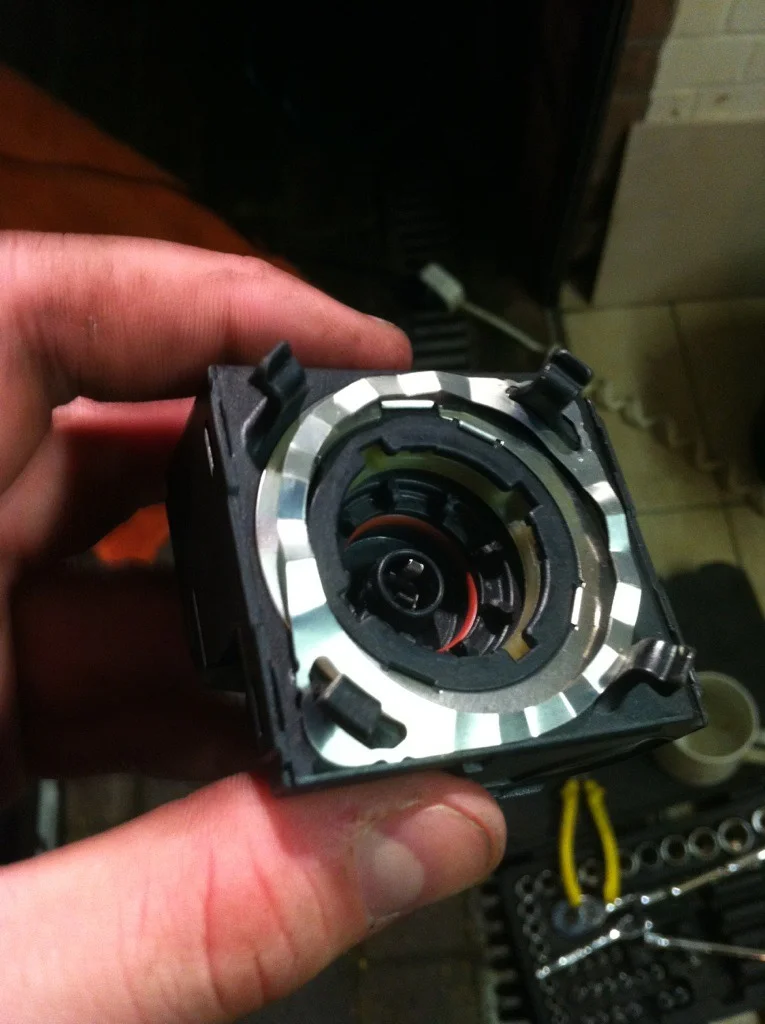

However a few questions. Initially after I turned them on for the first time the passenger side ( the one that was faulty before ) Didnt start up first time.
I turned off and on and they both started. I took the starter back off and adjusted the contact inside slightly. They both seem to be working absolutely fine now. Could this just have been because it was a new bulb?
I doubt it, I suspect there is an issue still, maybe the passenger ballast on its way out.
Also, on the passenger side starter, it's missing the corrigated washer, what's this for? The earth? The light works fine now but I'm wondering If it was the cause of the last failure.
Pic below attached of the washer that's on the drivers side.
Yeah they seem fine to be, considering the price from hong kong I might get a 6000k set as a backup / swap.
Still interested in the washer though?
