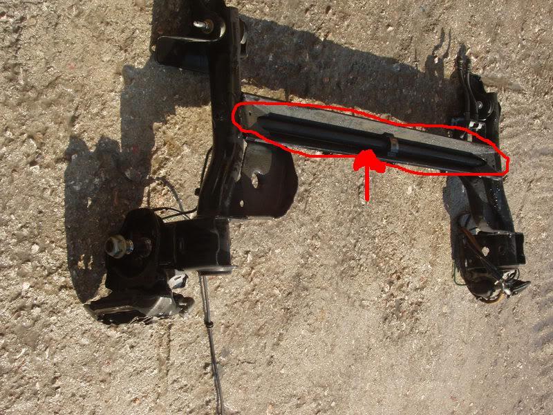

Some further research indicated that the rear bars might not removable, so it seems that it's a moot point but good to know though.
Seems that the Whiteline is the only way forwards...
Yes.Rear arb,is built in, the axle beam.

I'm considering getting a 182 rear beam for the 172, as it's running 182 Cup springs and dampers on the rear anyway (in combination with 172 Cup front stuff), so may have a spare 172 rear beam to put on my 1.6, to suit the 182 Cup chassis that's on there :)

To answer my own question. Non Sport 1.6 16v has a 25mm diameter FARB and ~19mm RARB in the rear beam. I believe that the 1.2 has a thinner FARB but have not got one to measure...
