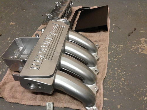

Silver FTW.
IMG_3776 by Arran Bell, on Flickr
Yes Dave i agree they do look nice, but a decent paint job can look just as good.
