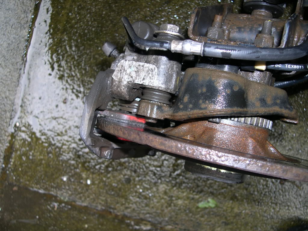

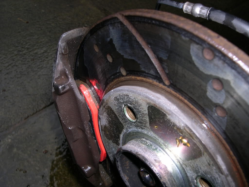

Right. Come rain, hail or snow - one of those rears is coming off tomorrow and I'll get a decent pic put up. I want to get the peeps view on the thickness (oo-er).
D.

Just checked them now - I think it was right to fail the MOT! ;)
Outside edge isn't too bad.....
But the inner pad is more worn down. Got a nice etched groove from something as well. Probably a trapped stone or something. :(
Oh well. I ordered a replacement set yesterday anyway.
D.
