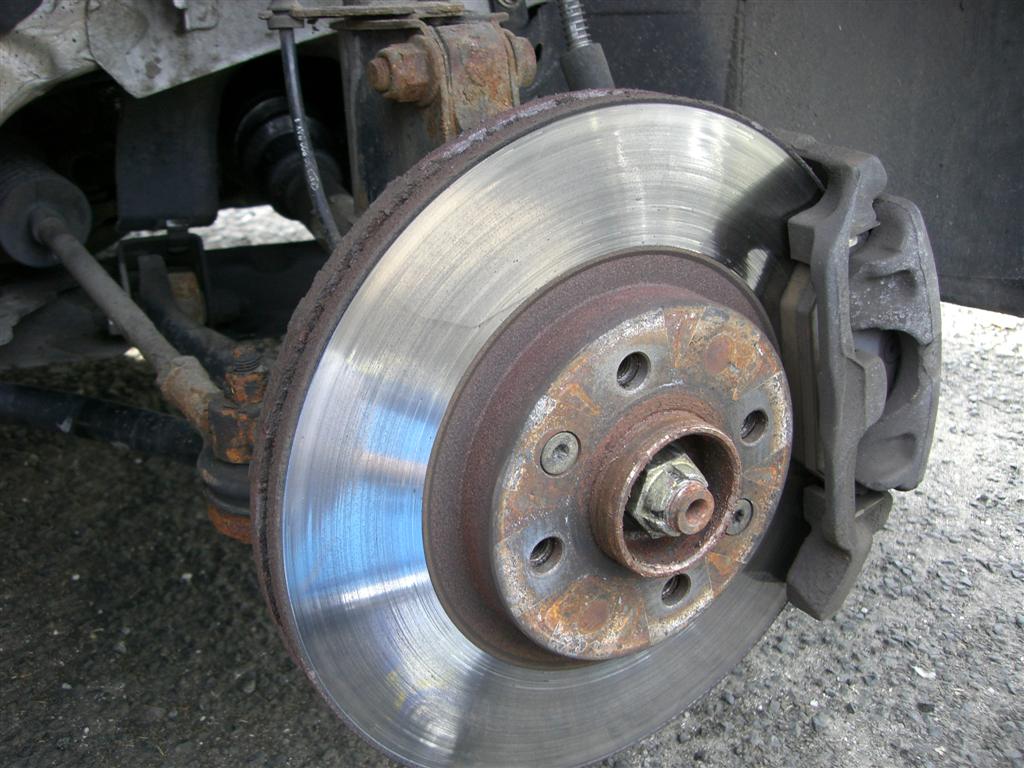

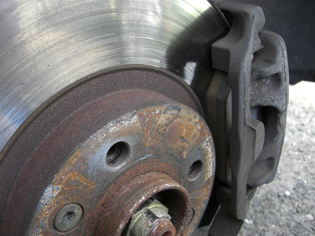

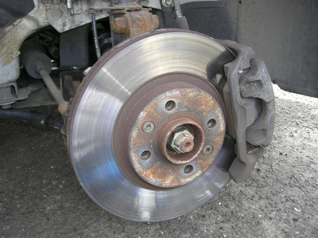

are my brakes buggered pics....?
hi everyone oics of my standard pics and pads are they about buggered if not how much life do you think i have left? also if i bought new discs will the pads i have on now be ok or will they damage the new disc? cheers thanks

Its hard to tell how much of a lip that is but the pads look fine to me and disks are ok I reckon.
If you buy new discs you should also buy new pads, but you can replace pads without changing the discs.
They look fine to me buddy. The pads look like they have about 75% left!
Not much of a lip on the discs either as John said.
I've literally just finished changing mine and to be honest i prob had a fair bit left in the discs and about 2-3 k left on the pads but i wanted the upgrade.
cheers guys thanks for that i am going to buy the parts and get it done later on around july/august time i think cheers everyone for your help
looks like you discs are below min. legal limit. hard to tell. measure the thickness and check it's not below 18mm
