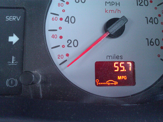

Ricardos
  LY 200 EDC
My peak average MPG ;)
WP_000754 by Ricard o1, on Flickr
