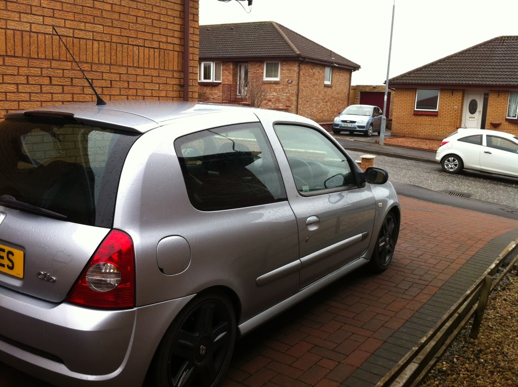

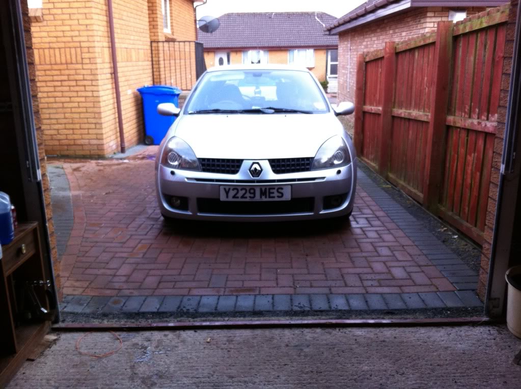

Hi guys. thought I might aswel post up some pictures of the car I picked up a couple of months ago. I bought it off a guy from Edinburgh and not to sure he looked after it too well as you will see. Please excuse the pics they are from an I-phone
79,000 on the clock
It has a cat back scorpion exhaust
It had a K&N induction kit of sometime which has been replaced with a standard airbox and soon to be panel filter
Lowered on apex springs and koni shocks(rear only for some reason)

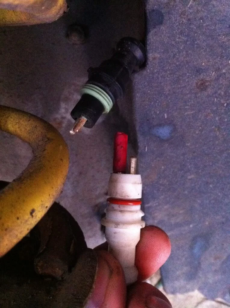

Bodged N/S/F ABS sensor
Whoever done this has fitted the wrong sensor and fitted insulated metal sleeves to try and make a contact, which didn't work so due to this the light should have been on however it wasn't and I soon found out why

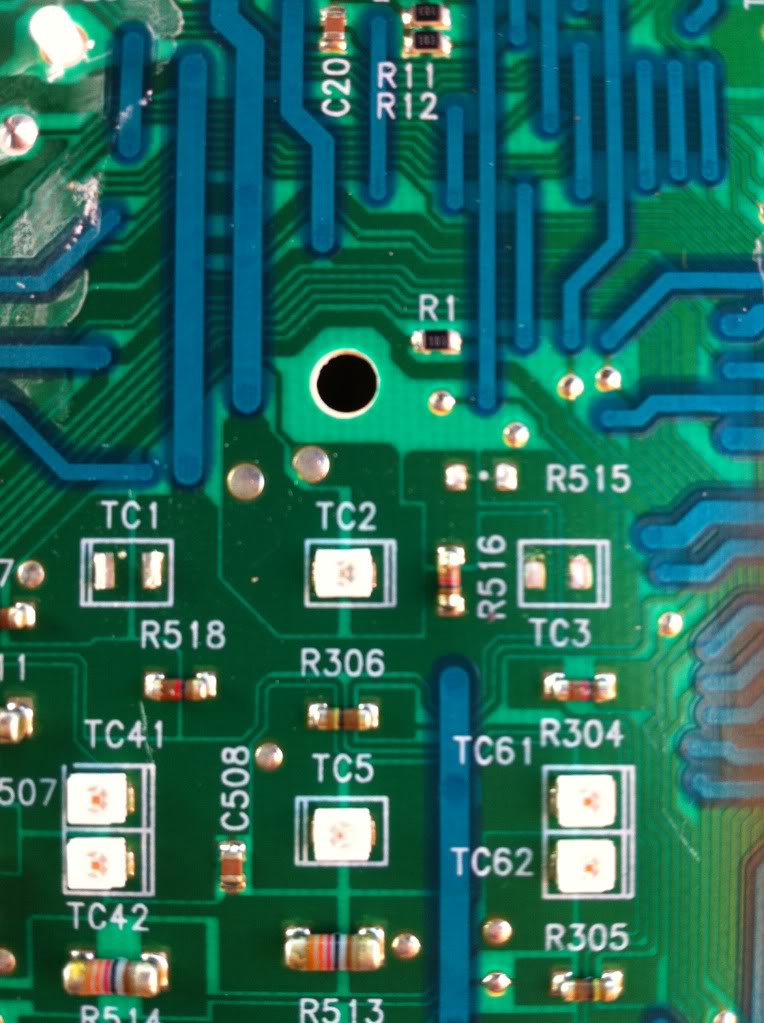

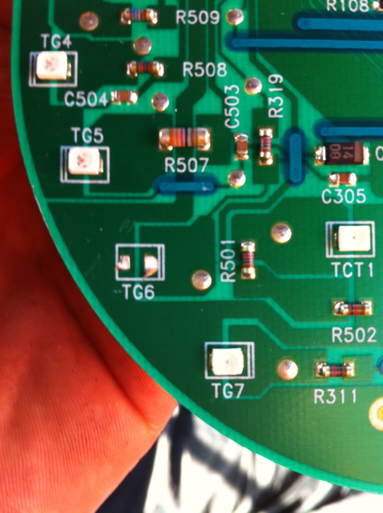

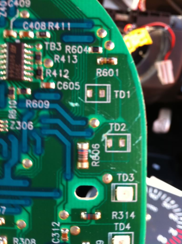

The guy has snapped off the bulbs and soldered joints, the lights that are missing are; ABS, SERV, STOP, Airbag and Passenger Airbag off light.
Knowing the airbag light is missing I guessed there was some airbag faults so I went investigating and found the passenger seat had been replaced and the wiring multiplug had been cut off completely and all wires were just left hanging, I have since connected this so that is now by with just waiting on an airbag computer coming in the post soon.

Wow thats a proper bodge! The previous owner of my old phase 2 172 had done the same thing with the airbag light, I got another set of clocks fitted.
Good luck with the car.
Yeah I know I've got another set of clocks in on a temp basis just now as they are higher mileage so looking for a set as close to the original mileage or i'm going for mileage correction

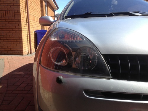

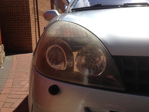

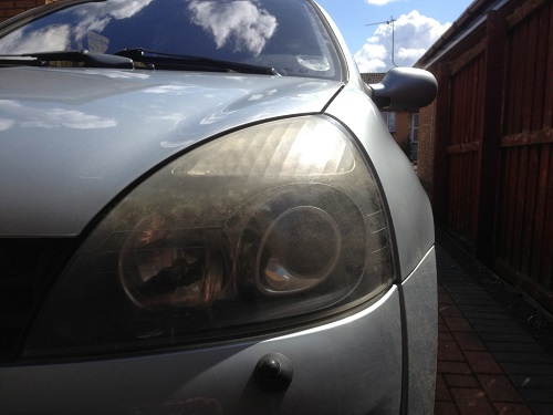

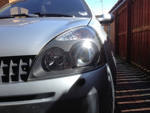

What did you use to the headlights? I used a Quixx kit today and they just still look pants lol!
Only had 2000/3000/5000 superfine grit and some rubbish scratch remover!:(
i Used the 3M kit worked wonders it uses IIRC 500/800/3000 grit and a polishing compound.
Worked a treat for me good bit of kit for the £18 i paid for it and i still have some of the sandpaper left over
Ahhh right okay then! I could probably do it by hand with a hell of a lot of work? Because the kit came with just 2000 as the lowest grade, and I thought I might need about 800-1000 to start with, I'll try again lol!
Yeah it will take a s**t load of rubbing, if you get the 3M kit you get an attachment for a drill, it saves a lot of hassle, time and no sore arms
