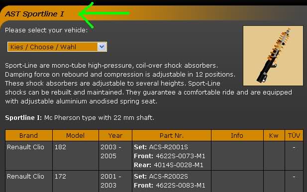

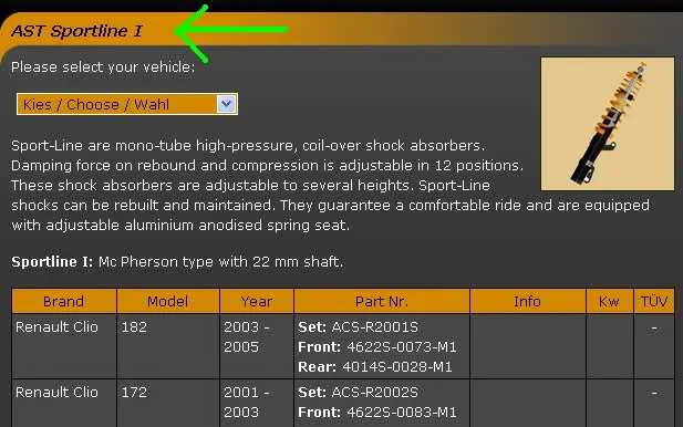

ASTs and sportlines are a different thing.
Sportlines are a spring kit made by Eibach, AST are a fully adjustable coilover set.
Oh Rly....
