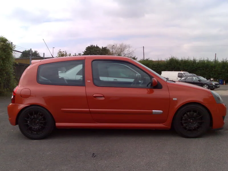

I remember seeing your car Dan outside the back at powerstation when u had them fitted! I wasnt jealous!;) Was having my car rolling roaded that day before i started modding it. Curtis said he could of done me a little deal on a set as i would of been the first 172 to av it done! Should of said YES!!!!! Hopefully you get a good price for us on the group buy!;) The mrs is thinking about it, would mean no more mods for me for ages! The ride height in this photo i took of your car that day looks spot on!
