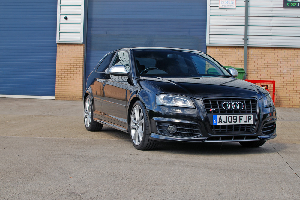

@Slammed172 what's the black optics kit? Standard badges are going on as soon as I have positioning measurements to place them.
The grille and fog surrounds, as per the below. Factory option. Not sure if it came with anything else.
dsc_0291_zps5g5y5wzv-jpg.1289609
I think it may look a bit s**t against the colour of mine.

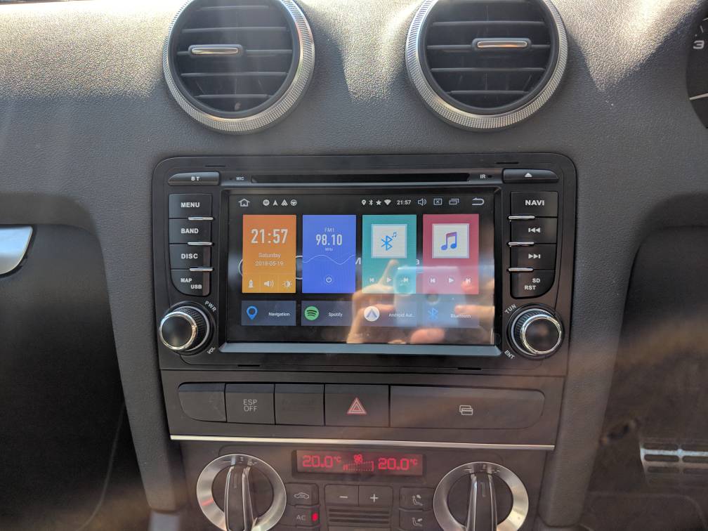

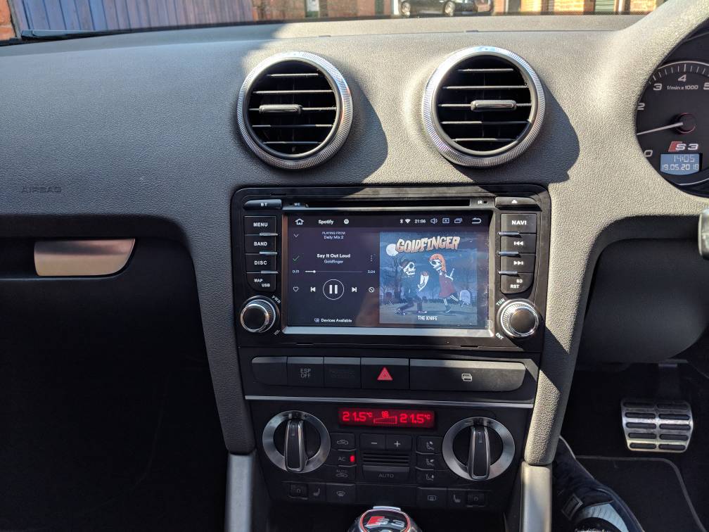

Small update, haven't done anything to the car performance wise yet, just enjoying it to commute and blast around when the time allows.
It's a superb car, but the big standard headunit without Bluetooth streaming annoyed me so I purchased and fitted an Android unit. Simple enough to do, not perfect but well worth the money.

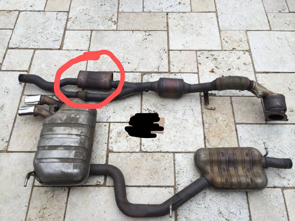

Not my picture, but could anyone tell me what the circled part of the exhaust system is, after the cat...

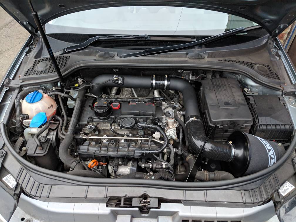

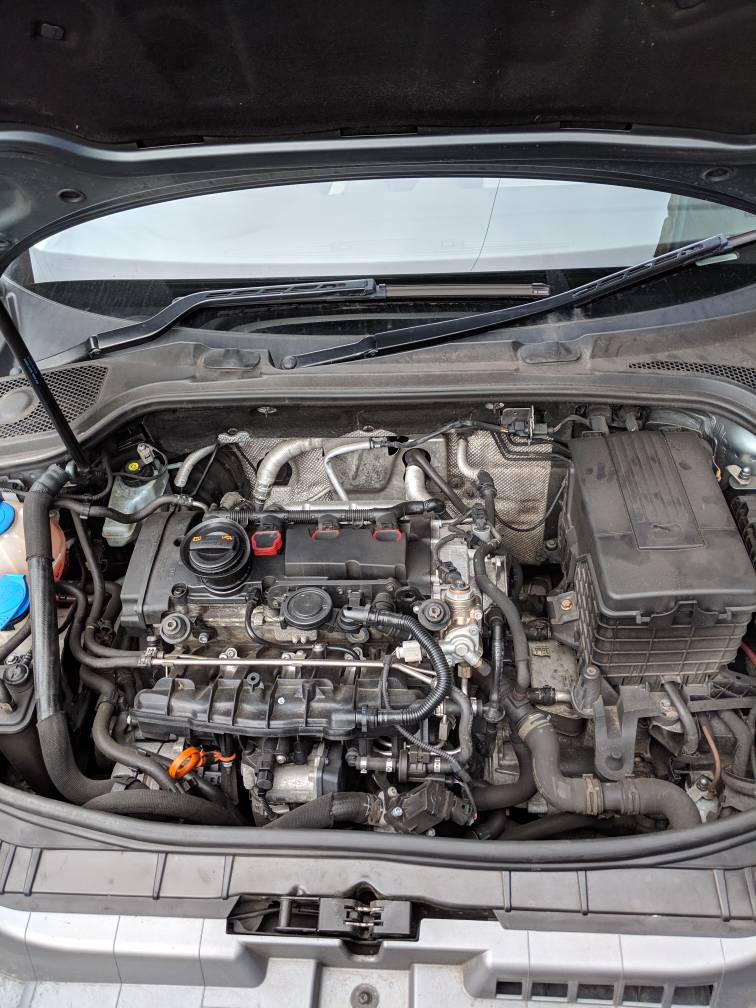

Made the most of 20% discount on eBay this week and ordered a Ram Air intake. Looks very similar to the Revo one but half the price.
Got it fitted this afternoon. Very good quality and easy to do. Could do with confirming whether it's already been mapped, if not that'll be next.
Certainly not a good looking engine.
Certainly not a good looking engine.View attachment 1408536View attachment 1408537
I've got the same intake. Sounds surprisingly different to the Revo.
Sent from my ONEPLUS A6003 using Tapatalk
This sounds more like Darth Vader, rather than a a normal cone filter. Sounds strange at first, but the turbo noise is quite comical.
Rojer

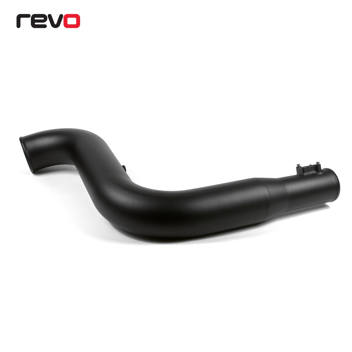

Doesn't look like that one scales the pipe properly in the MAF area? That could reduce power and cause major fuelling issues according to Revo
Also get the diverter valve changed to the GFB one, makes a nice difference, get the PCV blanked as well.
Rojer
@Rojer I don't understand what you're saying with the MAF sensor and scaling the pipework?
On the Revo intake, the pipe diameter shrinks so the MAF doesn't get confused. On your intake it looks like the pipe is just one size. See how it gets smaller?
1408855
roberto.
  S4 Avant
Yes, I get what you mean now. I know that ramair do a similar kit to mine but with an oversize pipe that tapers down, similar to the Revo. This kit only has one bore diameter throughout though. Same size as the standard pipe that connects to the OEM airbox.

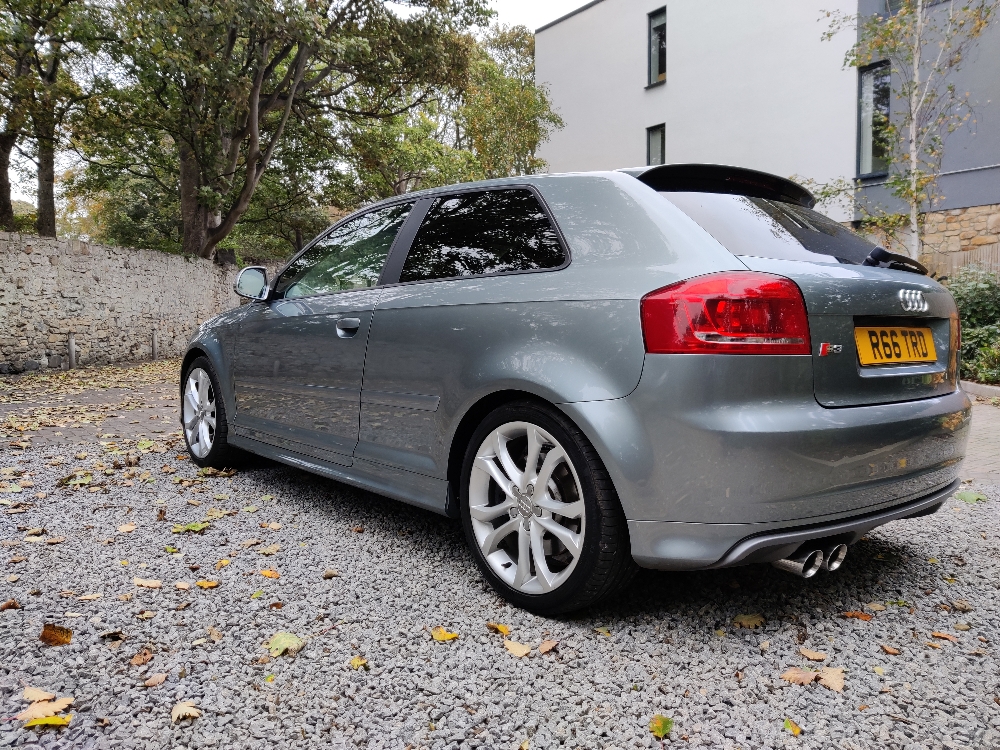

Took the intake off as I didn't like the sound after a couple of weeks. So that will be up for sale.
Exhaust stored now, stainless straight through section fitted to replace the flexi. Not any noisier but glad to have the small leak sorted.
Also went for a remap and was dynod. Turns out it already has an APR map on so just got it checked over. Running 320bhp and 310lbs/ft. Saved myself a couple of hundred quid, but I was looking forward to the extra power. Now I want more.
