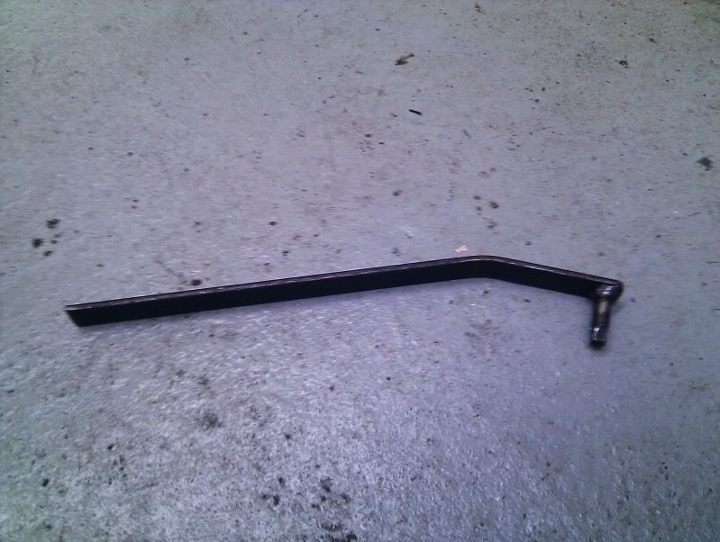

My self made tool. no off the shelf tool comes close. I've made a few for people

All the other special tools I've tried havn't fitted, or have been impossible to move once in the slot, or similar. That includes the snap on one I tried. They may have changed something but the one I've seen on the van recently is the same still

Snap on tool works spot on. You guys must be all fingers and thumbs...

Yeah, all stripped off. It seemed the 1/4 part wasn't long/deep enough so the bar handle hit on the tensioner spring part. Maybe I should have tried it in a fewer positions but I'm 99% sure it was the tool and not me being a t**t

Thanks for all the replies guys! gonna be doing this tomorrow if the bits turn up! and fred that is the tool i was hoping people were talking about as we have one of those at my garage :)
