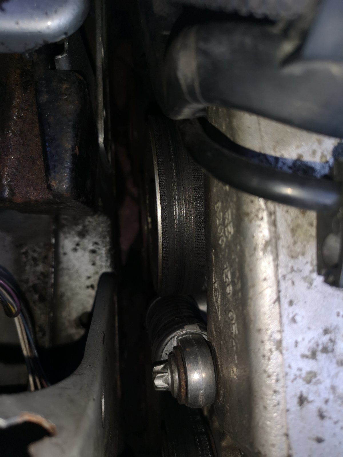

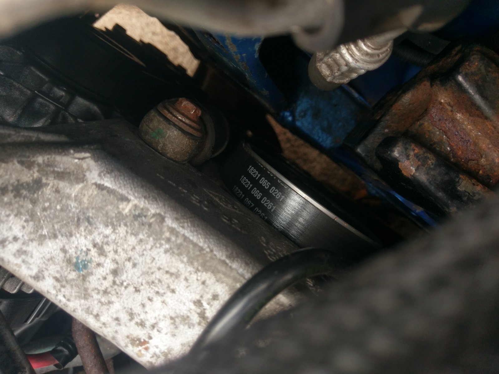

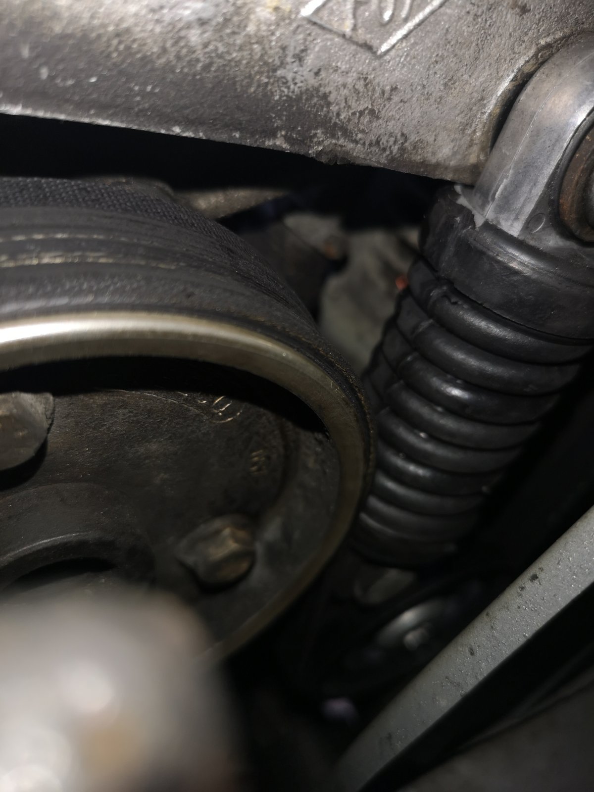

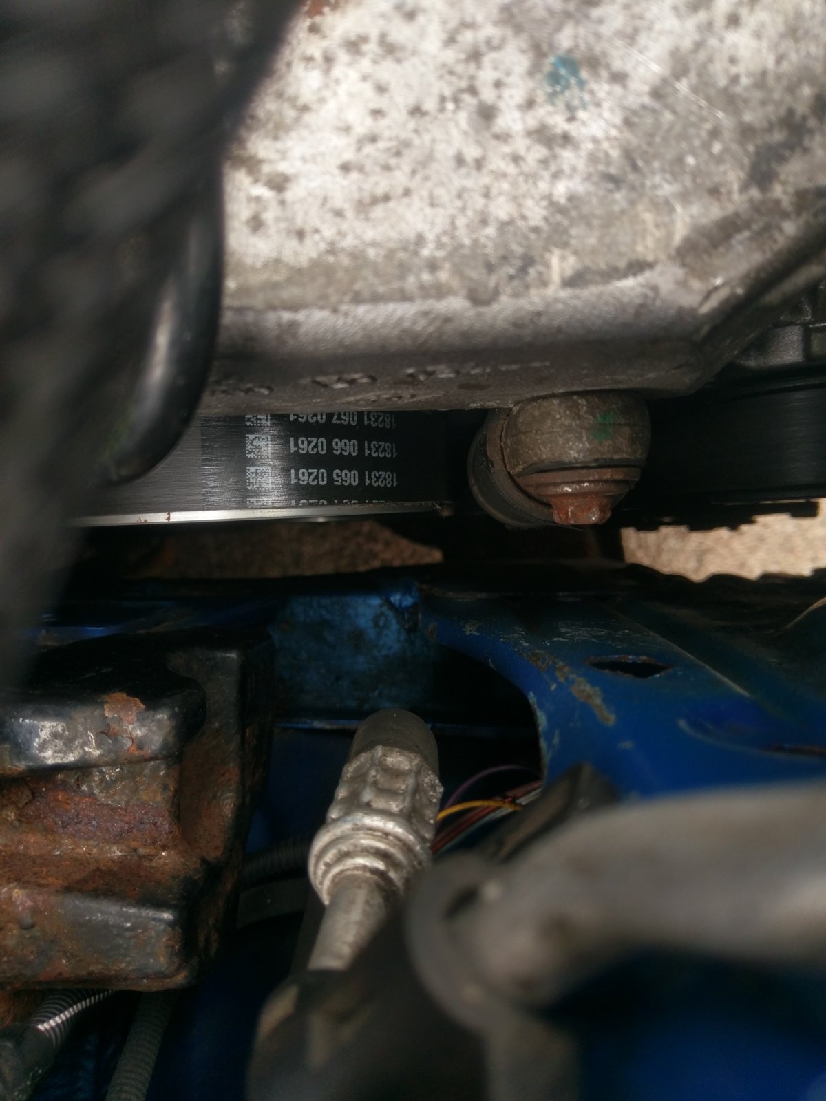

Brand new aux belt and tensioner genuine parts fitted last week. What have I done wrong?
Belt is routed correctly as far as I know
Could the bolts on the spring be too tight? Thanks in adVance

No good guys. There just isn't enough slack in the belt. It's the belt from the kit I got from Renault parts direct. It's like the belt is too small. Any ideas or advice I'd definitely welcome

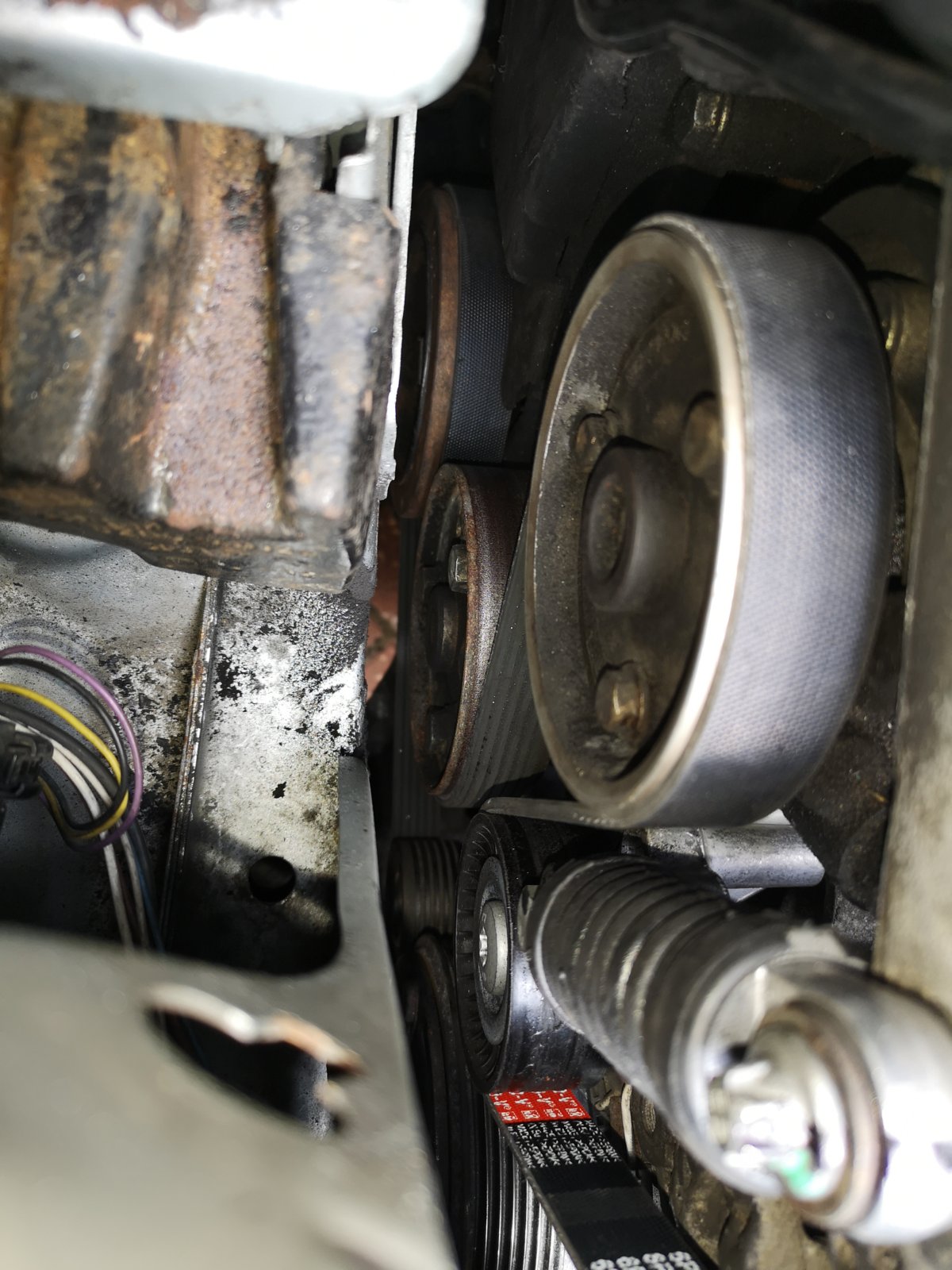

when I do the aux belt on these I leave hex on idler slightly slack. Same with Torx on tensioner spring. Then my home made tool for idler which is a cut 3/8ths extention bar held with a set of mole grips I adjust idler towards headlight and it should be tensioned.
torque all above rebuild jobs a good yin ?
I will let you know how I get on this eve but something can't be right so if I can even manage 1mm clearance I got another belt today that is 6pk 1669 so if I can't get the conti belt on then the longer one will fit and give clearance

my home made tool is a life saver as you won't need to take it all apart to put belt on.
Cut the old belt off.
slacken Torx and hex slightly.
Use tool and leaver towards headlight.
then feed belt round everything leaving the alt pulley till last.
Before fitting belt round alt pulley use the tool to leaver back to bulkhead this allows you to slip belt over alt pulley release tool and it should just tension on its own torque everything up that's it should look similar to mines.
That looks better 1670belt hope it's all ok now

Just got the front back together will test on the ground but should be ok as there still plenty in the tensioner
