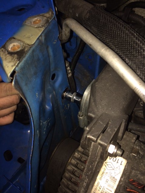

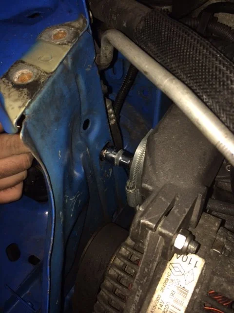

Make sure you have a few large quality jubilees around the 50mm size.. You won't be removing your tensioner without damaging your bolt/thread and certainly won't have an easy time replacing. I'm also sure I got my larger lever bar involved at some point, another essential.
I got the jublie and a large choice of different length bars what do you men about damaging the tensioner bolts ?
Ahh get it thanks glad you said that I'll be extra careful with it was planning on getting to it like this

What a nightmare had to give up at 6pm struggling to get tensioner on even with clip just kept jumping off
I'm sure that's where I rested the lever bar onto and put some weight on it while I put the bolt...
Bolts like this have to go in with fingers, because the alternative is, thread it using a 3/8 drive socked, then remove, spend ages retapping the hole, same for the bolt and finish by putting it in with fingers...

The top of tension is half an inch too high can't even attempt to get it in should I put the tensioner in before or after the belt ?
Took me from 10 to 1 what a c**t of a job and II dropped my bumper scratched it next time I'll pay the 200 for a garage lol
Damn, I was thinking of changing the belt myself and even making up a tool to allow me to change belt and idlers! I do have a welder after all...
The only issue is the tensioner remove the spring off tensioner put it all together and use a high quality jublie clip the cheap ones snap, to compress the spring then put tensioner back on you need to compress it a massive amount, I never has a vice so I used 2 shifting spanners to stop the clip sliding off, as said above careful you don't damage the thread on the top nut, my was a mess it had been drilled out before and I suspect will need done again next change because of the mess I made of it.
I have done a few of these now. I just use a high quality jubilee clip to compress the tensioner spring. Then I just put the belt on the crank pulley as much as I can then rotate the crank and let the belt rotate on. Works every time for me. I had no need for levers. Hope this helps a few of you. I have found this to be the easiest way. Then once on release the tension on the jubilee. Job done. I do the same on removal.
