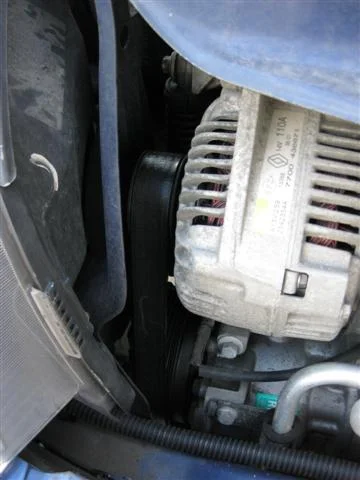

Is it easier to complete the aux belt by removing the bumper and headlight ? Ive taken the drivers side wheel off and the panel inside the wheel arch and now you can see the bottom pulley and AC pump.
I take the bumper off, it's 4 bolts and 6 trim clips and so much easier with it off IMO. It is the grille and slam panel that gets in the way but I find it more awkward to re-fit that in situ
well after a couple of hours hard graft skinless knuckles, blood and tears shes back together and I'm rather happy I did it as you can see from the pics.
Loads of room to fit your hands

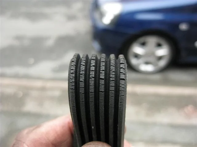

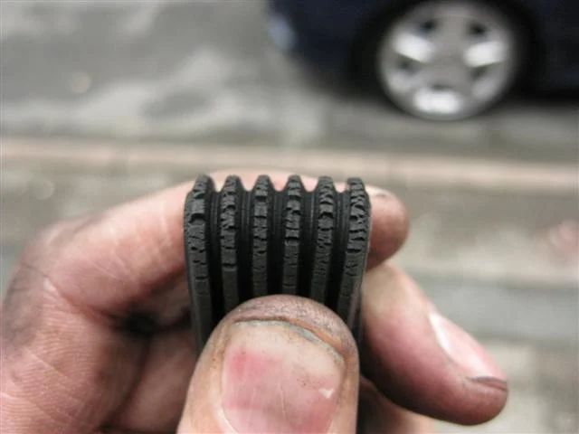

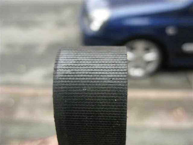

Worn belt
