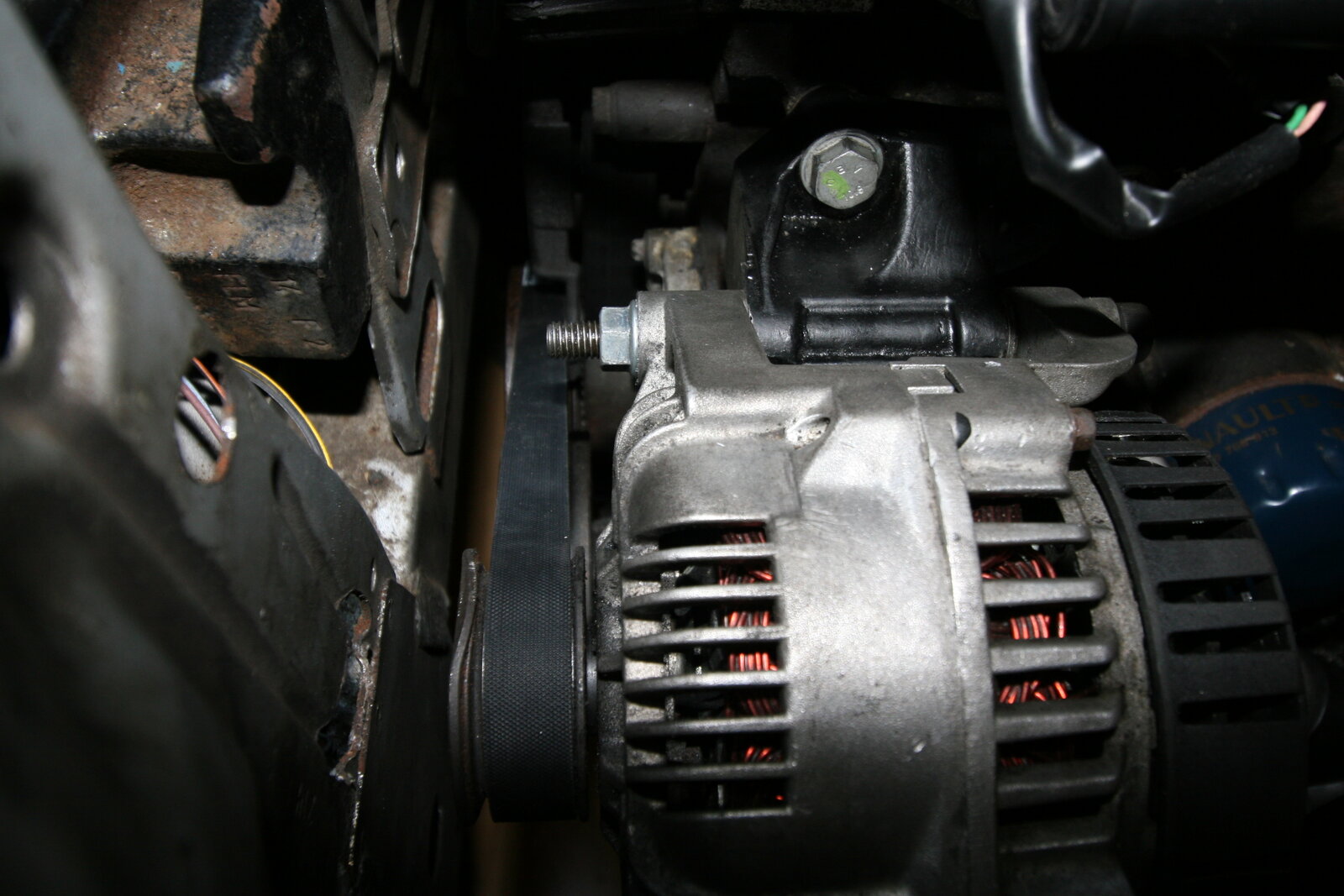

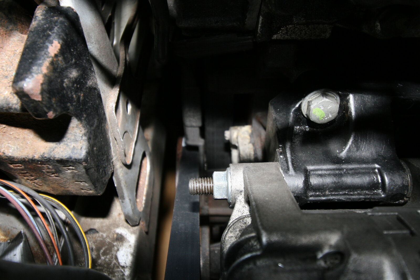

Just got this in the post, the pulley is bent a bit so I cant move it over, you can see the belt touches the plastic cover. I have my other 182 alternator but the pulley is a different size, does that matter? And how do you get them off with a gun?
Also regarding tension, how much movement should the belt have?

You need to move it over 1 rib mate
Like this
I'd try and take that pulley off the impact gun. If not I think you might be able to wedge the cooling fins enough with a big screwdriver to lock it off enough so that the gun bites

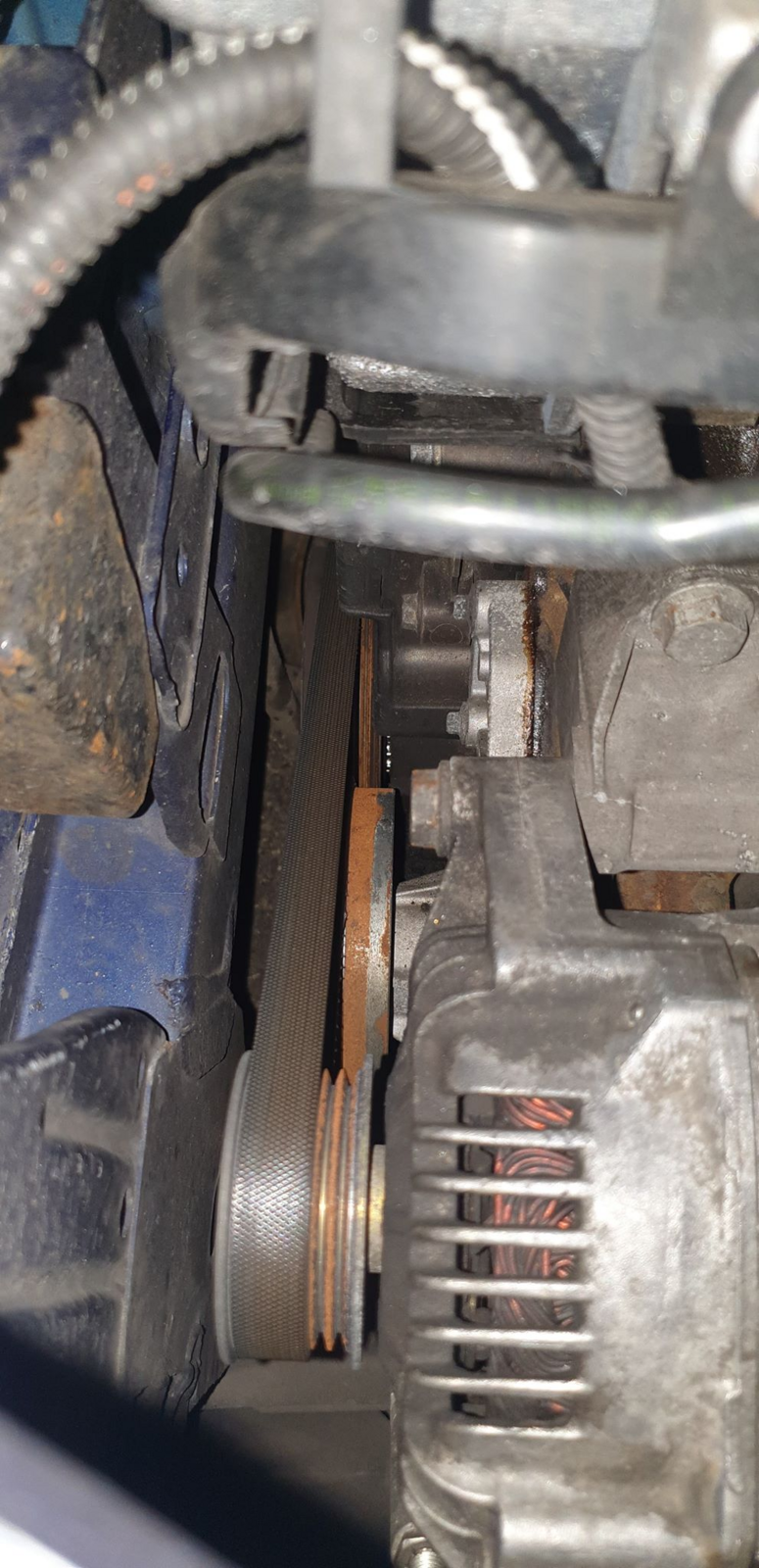

Getting real good at digging up old threads, can someone share the belt size you use for this set up? I have something similar on my build but have long since forgotten the belt size.
